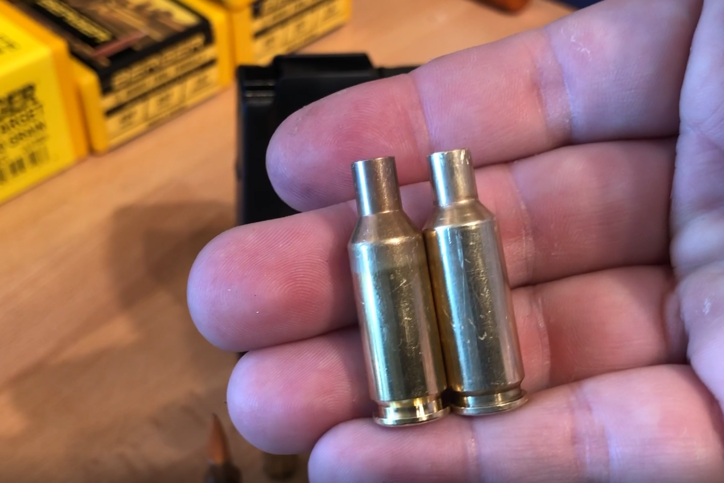

    I got my 6mm BRA last year and have been shooting the heck out of it. You can't get 6 mm BRA brass, so you have to fire form it from 6mm BR brass. The pic below shows the before (left) and after (right).
    Now, when I get everything just right with a fire-formed case, I'm able to get <.25 MOA at 300 yards and below. That's powder charge, seating depth, the right bullet, neck tension, and, yes, shoulder bump.
    When I fire form, I'm using a "random" (e.g. not optimized) powder charge with a crappy shooting bullet that's touching the lands (e.g. not optimized) - and obviously there is a LOT of "bump" in that shoulder. I will get in the neighborhood of .4 MOA groups at 100 yards. So, roughly 1.5x... with all the other crap that's "wrong" with the fire forming loads.
    Then, there's this shot that a friend of mine made with my rifle at his first time shooting > 1000 yards (1200). This was with fire forming loads going from 8x68S brass to 300 PRC. Talk about "bump" - it "bumps" the shoulder, case diameter...

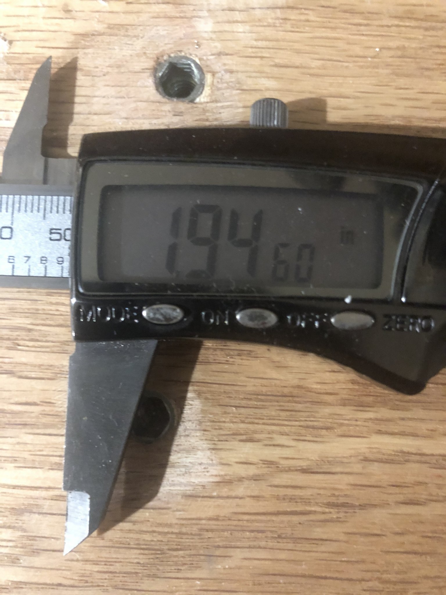

    Not saying my calipers are anthing special, but they’re measuring to the 4th decimal place with a +/- variance of 0.0005”.
    They display to the 4th decimal place. They are never going to measure to such discrimination accurately. The nature of their construction prevents it.

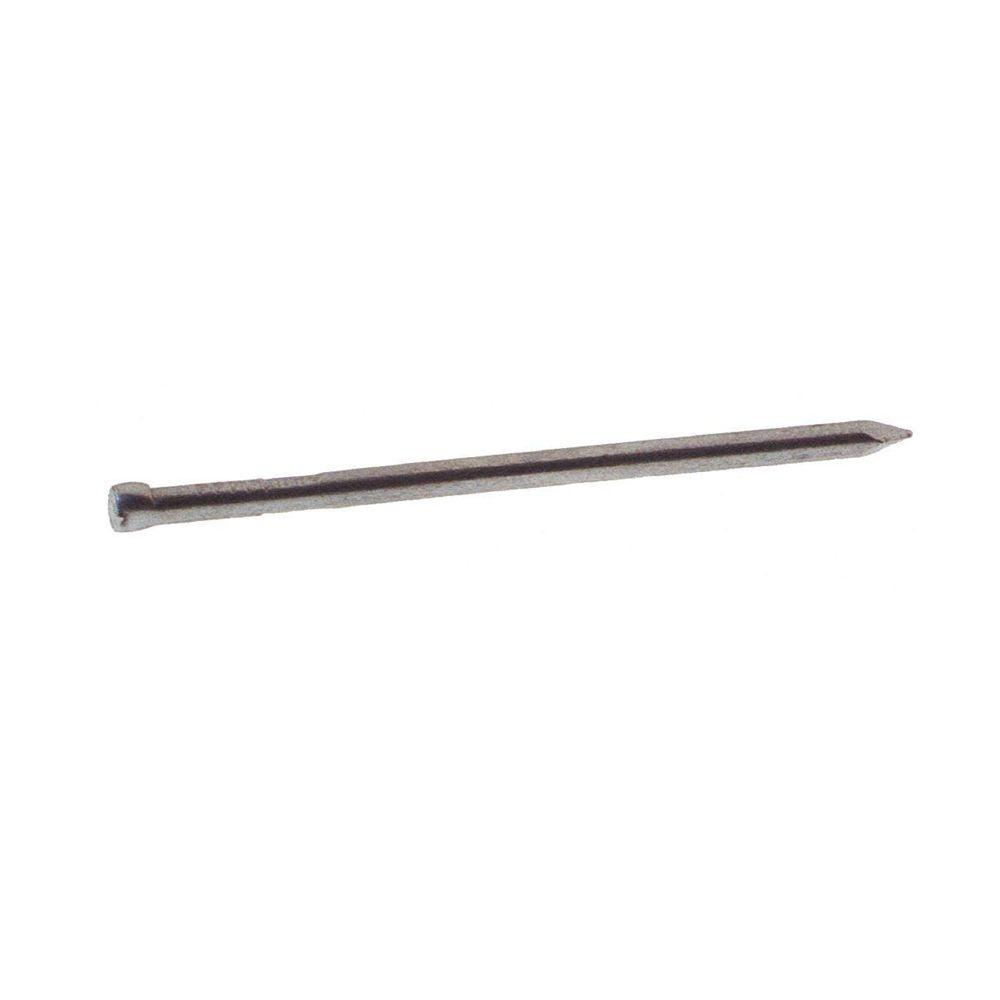

    Have a little nail or brad? Thats what I use, the box of small finish nails on the shelf is more convenient than other packed away tools.
