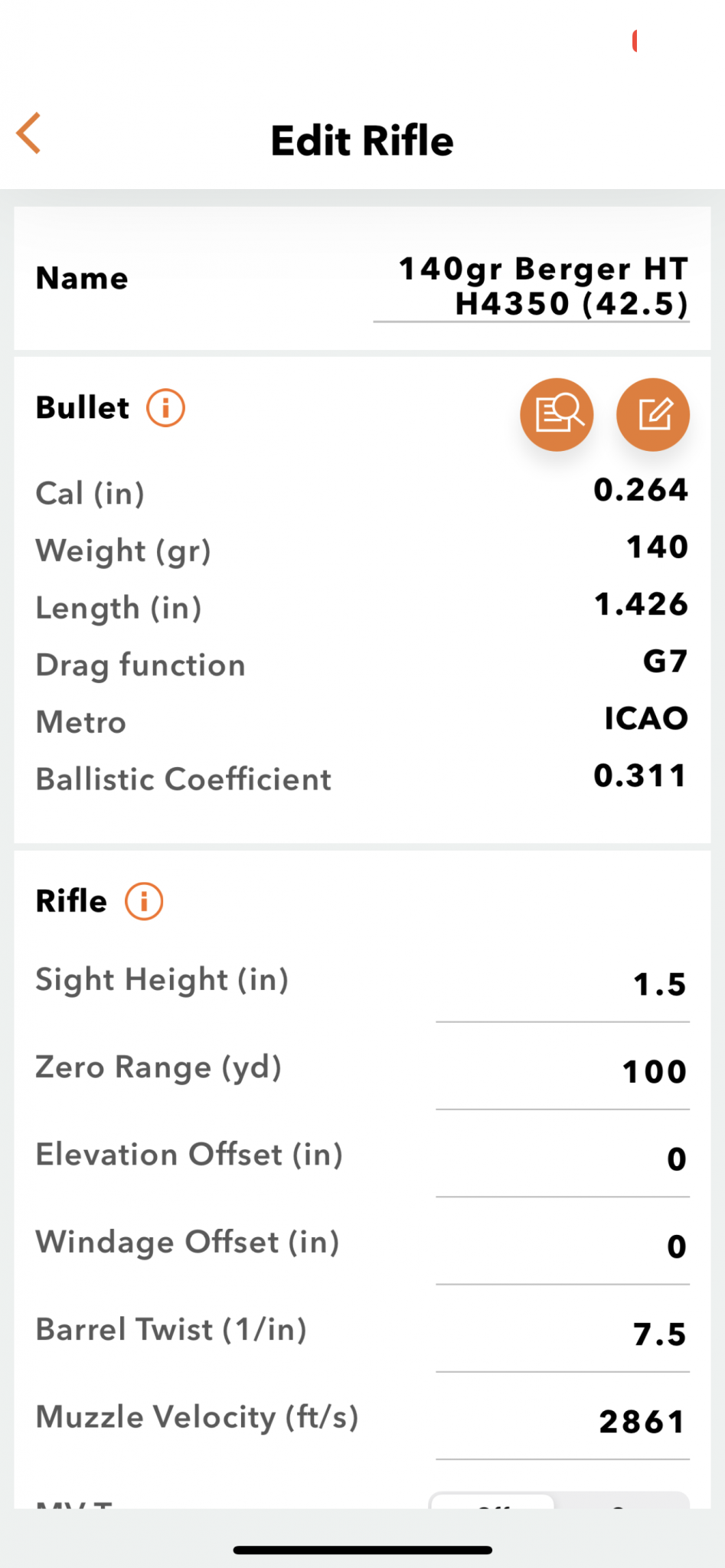

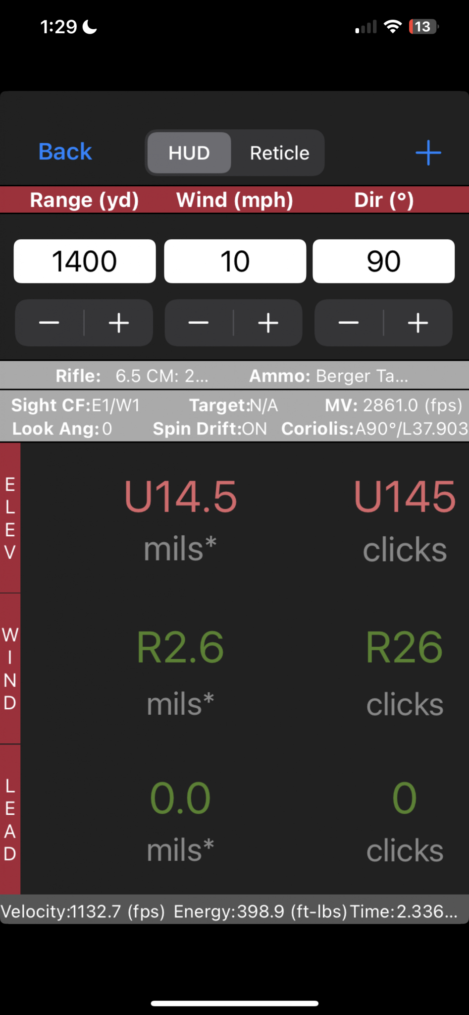

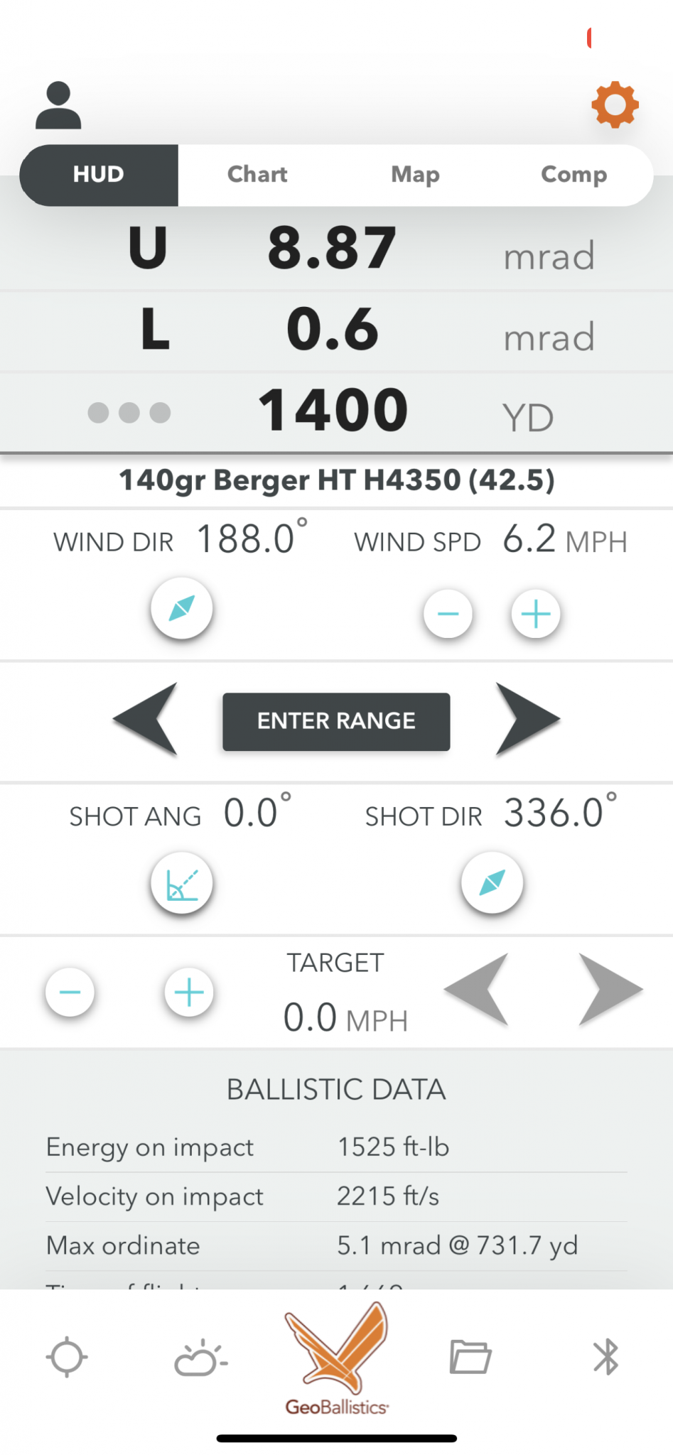

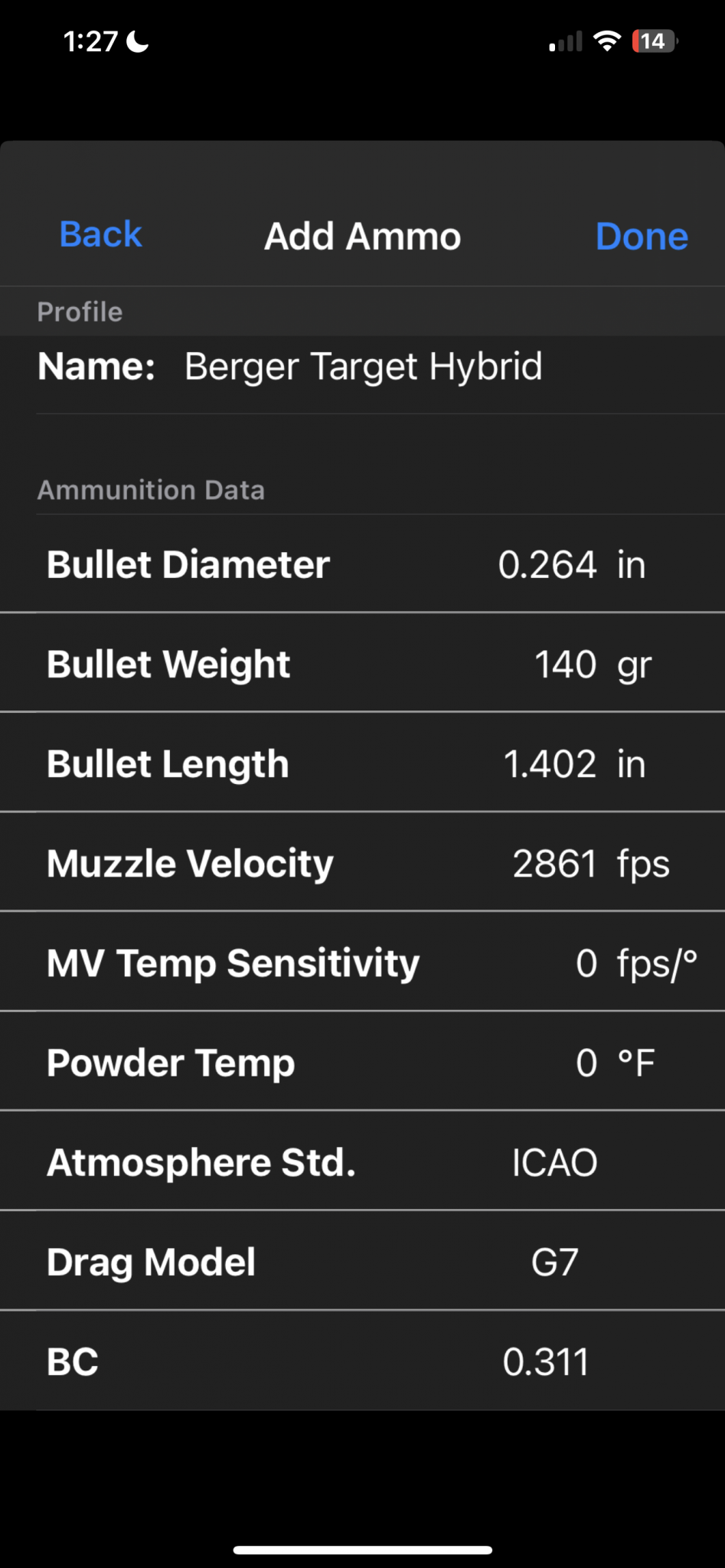

Ok. So I use GeoBallistics and wanted to try out AB…. I input the same parameters and everything into both apps. I then check to see the solution for a 1400 yard shot. The solutions are so far off it’s insane! I must be doing something wrong here and probably on the AB side…. Screen shots attached.
I am shooting 140 gr Berger hybrid targets at around 2861 ft/s. GB says U8.87. AB says U14.5!
WTF am I doing wrong?!

From what I can see here you have a couple of things different in the inputs.
1) The Firing direction on the AB App is 90 degrees with a latitude of 37.9 deg. The firing direction on the GeoB is 336 degrees.
2) The wind on the AB App is 10mph at 90 degrees, while in GeoB you have the wind at 188 deg and 6.2 mph.
3) The impact velocity and kinetic energy on AB is 1133fps and 339 ftlbs while on GeoB it is 2215fps and 1525ftlbs. This is a huge difference.
Something is very wrong with your GeoB inputs. A 338 Lapua 300gr with a G7 of 0.414 at standard sea level atmospherics has 10.5 mils of hold at 1400 yards. I would venture to say that your 6.5 with 140s shouldn't be out performing a 338 at 1400 yards.
