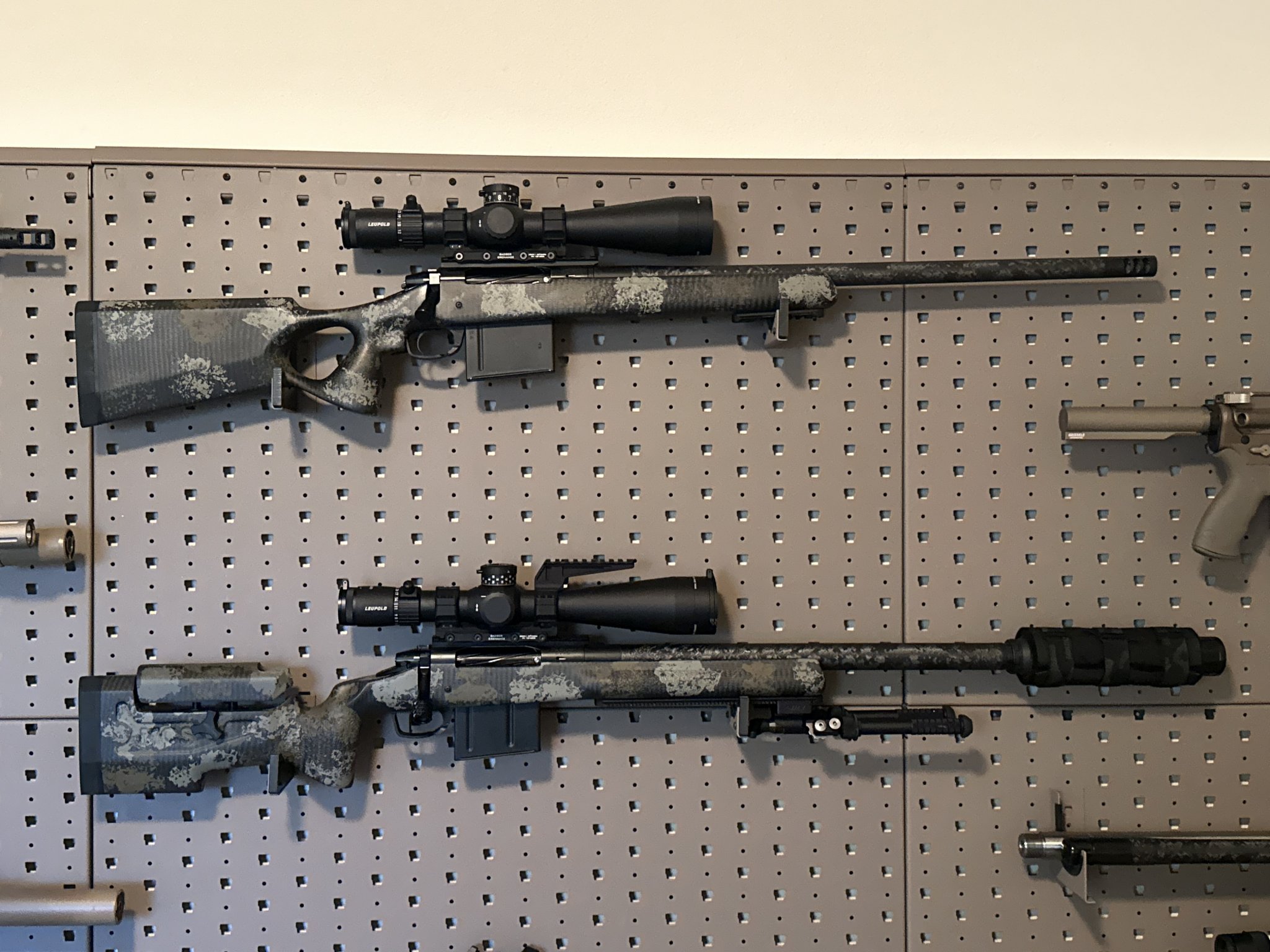

Long action and step up the caliber to prc. Cannot recommend the zermatt origin and a pre-fit proof enough.
Bottom is a 20” straight taper cut by Alex wheeler. Top is a 22” prefit

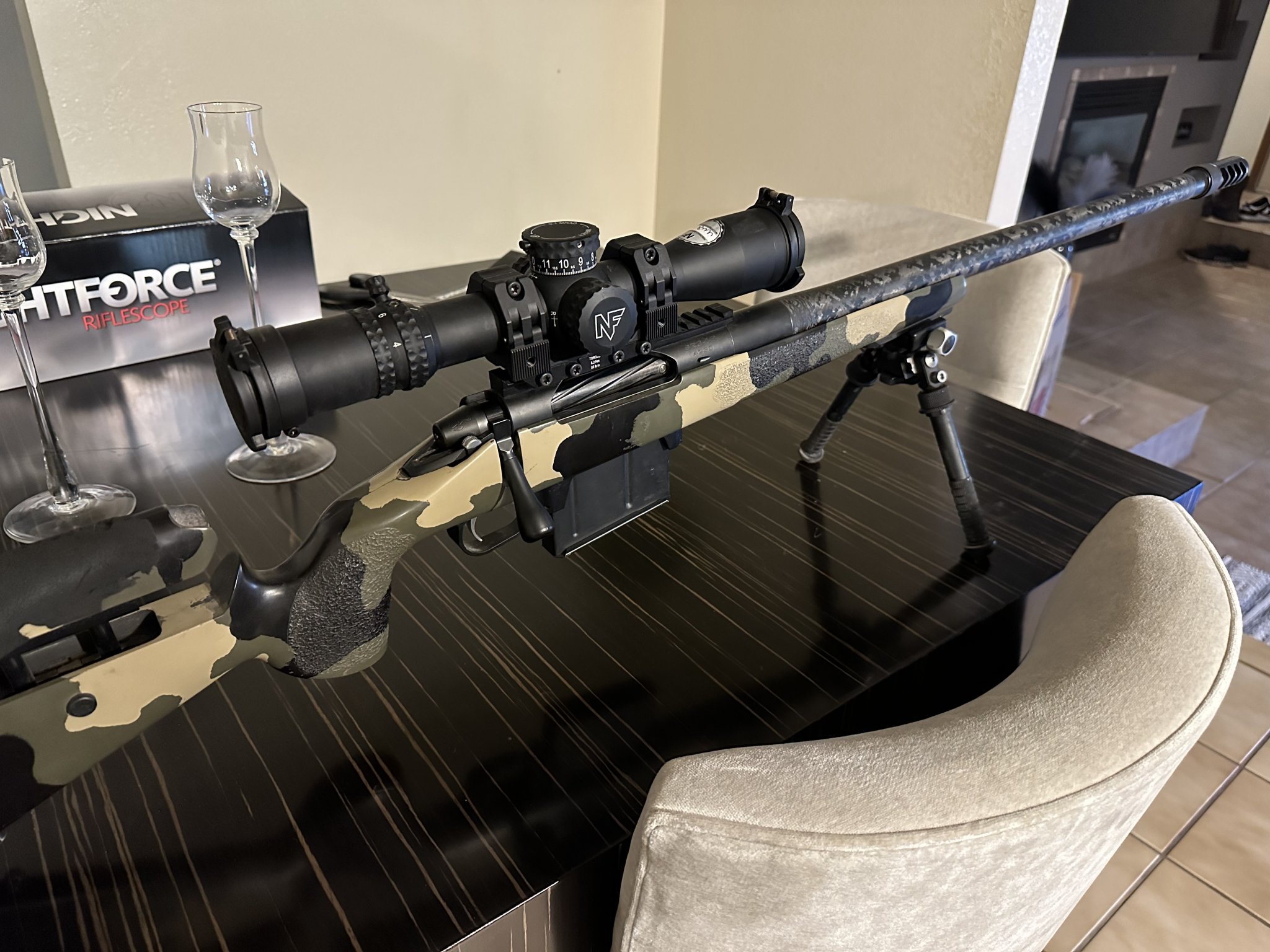

+1 on the long action from zermatt. I have a proof carbon 300 prc barrel, and long throated 7 saum bartlein on a sr3 action. Viper vice, an action and torque wrench, is all that’s needed for quick swaps. As for the 7saum on the long action, I’m easily at 3k with the 180 hybrids. Really wakes the caliber up.
