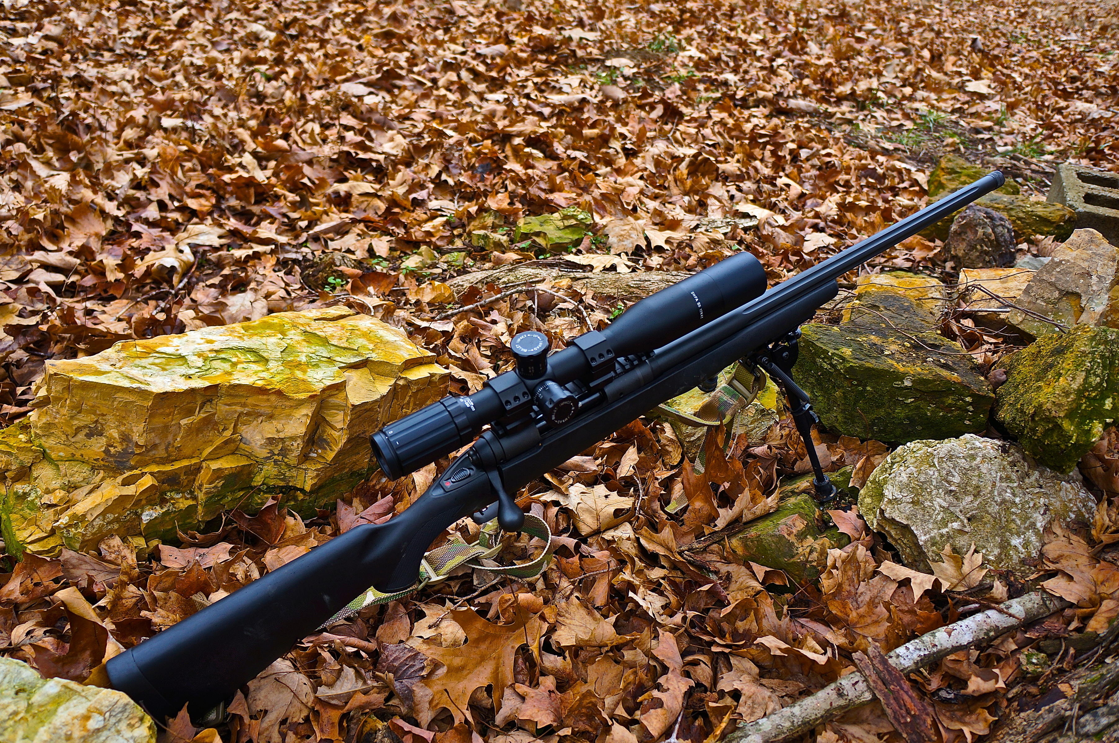

Been shooting just over a year now consistently working to improve and build fundamentals. Started with a Tikka T3 lite in 308 now have a Savage 10 FCP SR,5R 1:11.25 , 22 in Barrel .
SOO To get the most of out it I want to start reloading since I do feel I am Darn good with FGMM175 and BLack Hills Gold 178 out to 645yds as of December 20th which was a rainy windy day here in TN .
My question is how ot go about getting started ? a started kit with few extra things or by only desired equipment each separately. ? my main reason as I said is I want to search out the highest level of accuracy possible and this will take work I realize. I entered my first tactical match for next summer to give me time to improve but dont want to waste time or money. Thanks to all I have read so many things on SH and it definitely cut my learning time down.
