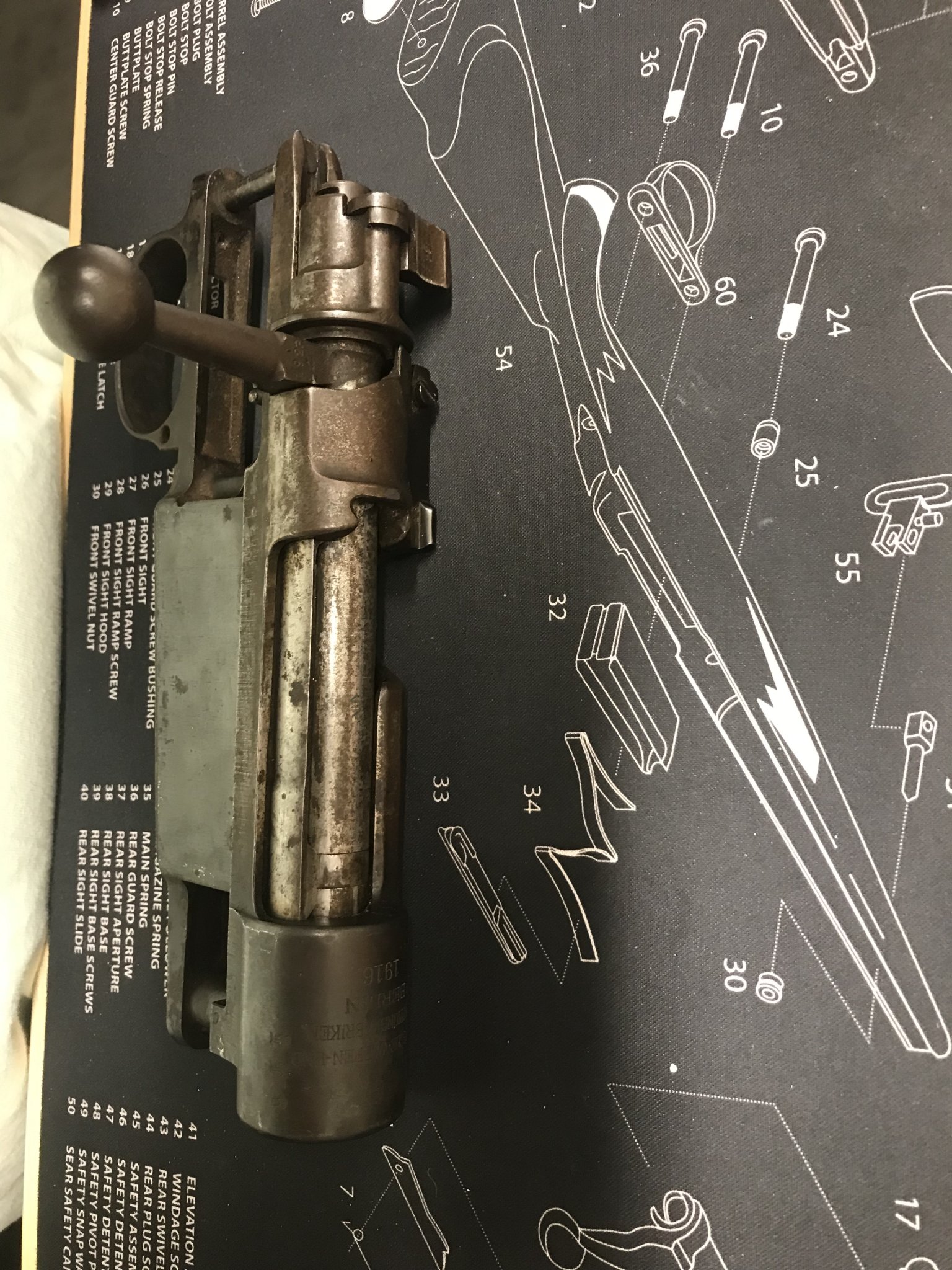

Recently took delivery of a German K98 (bare action) and would like to build a hunting rifle. I have lots of questions and need to find an expert Mauser gunsmith ...any suggestions?
I’m thinking something based on the Winchester 284 case would be safe to run in this action?
Also, I have a Bartlein 6mm barrel in 7.5 twist MTU contour sitting around, is this too big a contour for this action?

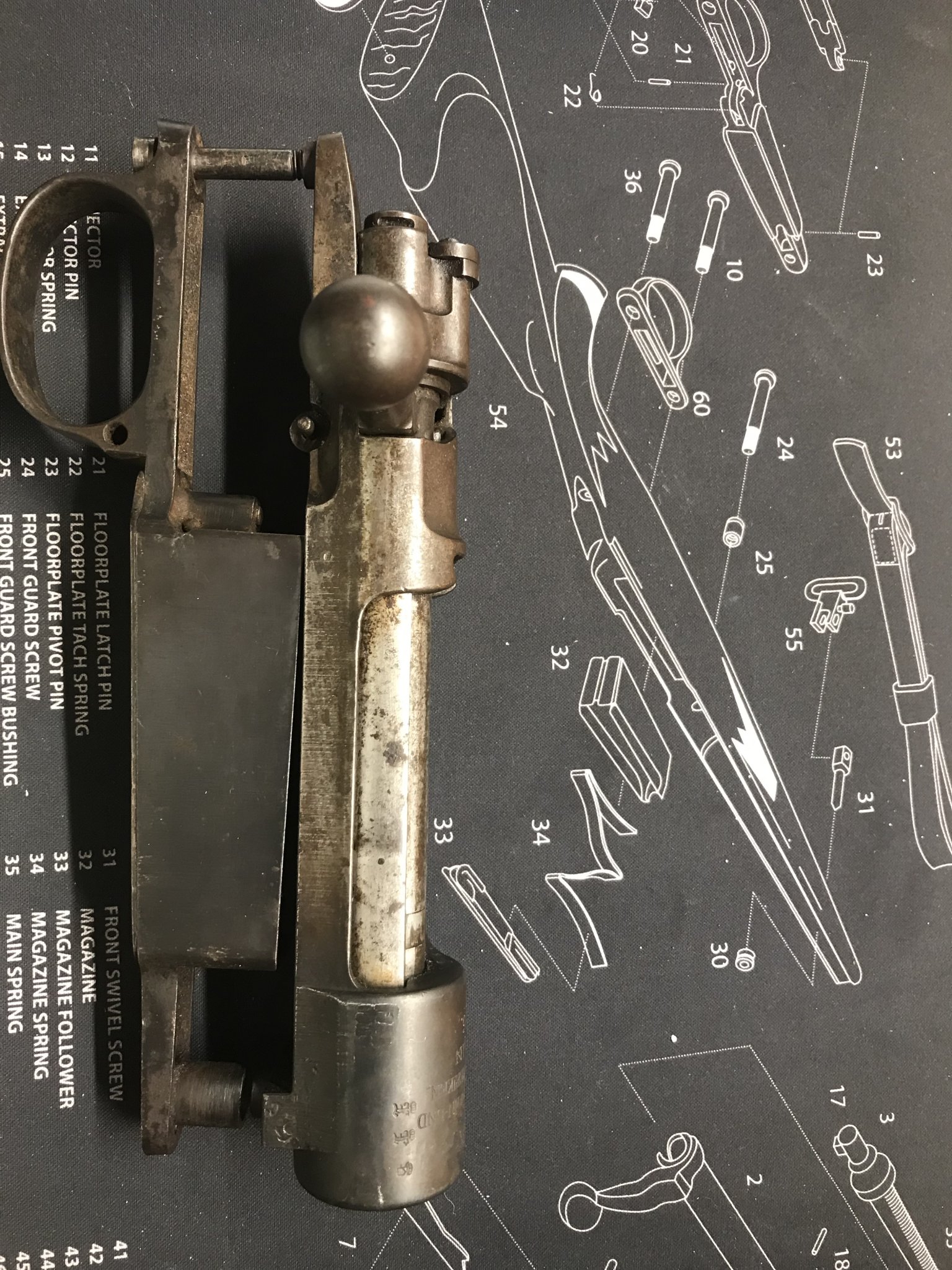

My apologies if the error. It was given to me by my father in law. He purchased it years ago so I am not sure on the bolt answer.
What are the differences between the German k98 and this receiver?
The straight bolt handle mostly.

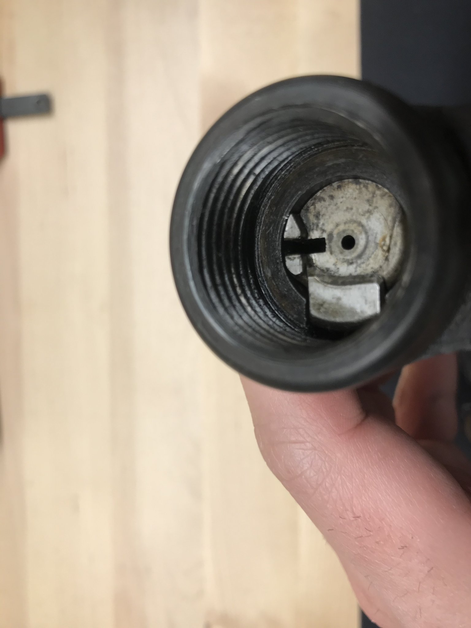

Since it isn’t in it’s original configuration it is extremely difficult to determine how many times it was rebuilt (the Germans stamped a number in the center of the buttplate, identifying the rebuild facility during the Great War and stamped the receiver in later eras). The receriver appears blued, indicating rebuild in either the Wiemar or Nazi era.
I have a few Gewehr 98s...one of them, a Danzig 1916, has a slight bit of bolt lug setback. If your heart is set on building on this action, get it checked out by a reputable smith before sinking any money into it.

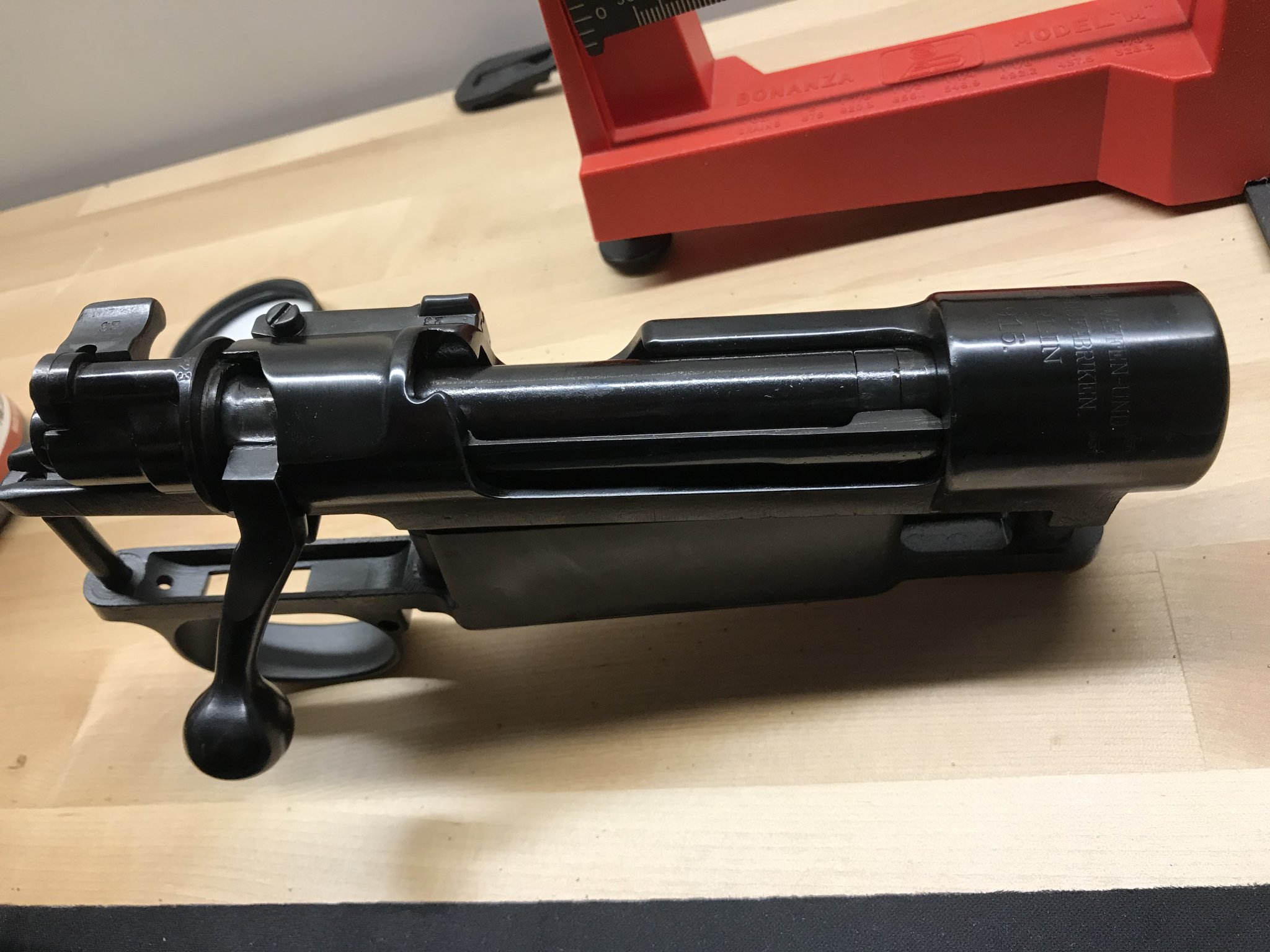

P.S. I'll post a couple of pix of Mauser's I bought over the past few years because they were too cheap not to....

Any recommendations how to clean this action to get all this old grease off. Or is it better to leave it to a pro.
Side note I spoke to a David Christman (gunsmith) from Louisiana...been told by Shilen barrels he is the person to speak with about Mausers.
There are a number of products that will get the grease off. The difficulty is getting the light rust off and not leaving too many marks. I've used mineral spirits, much quantities of liquid wrench and kroil, break free, kerosene and diesel. Wear gloves and eye pro, and use in a ventilated area. For stubborn spots use very fine steel wool with the solvents. Prepare for a little elbow grease to be spent.

To update the thread the action has been cleaned and blued. I am not familiar with the blueing process but it seems the action does not operate as smooth as before? Any suggestions?
The bluing and bolt being sticky type thing don’t sweat it. Some oil on the bolt etc...and once you start using it it will smooth out per say. Also keep in mind this isn’t a Sako or AI rifle action either but the action will build a decent rifle.
Bluing is basically a rusting type process. Don’t freak out on that word. I’m getting ready to send a barreled action out to Glen Rock Blue for a actual old rust blue type process. They do hot bluing also. Looks like your action got hot blued.
