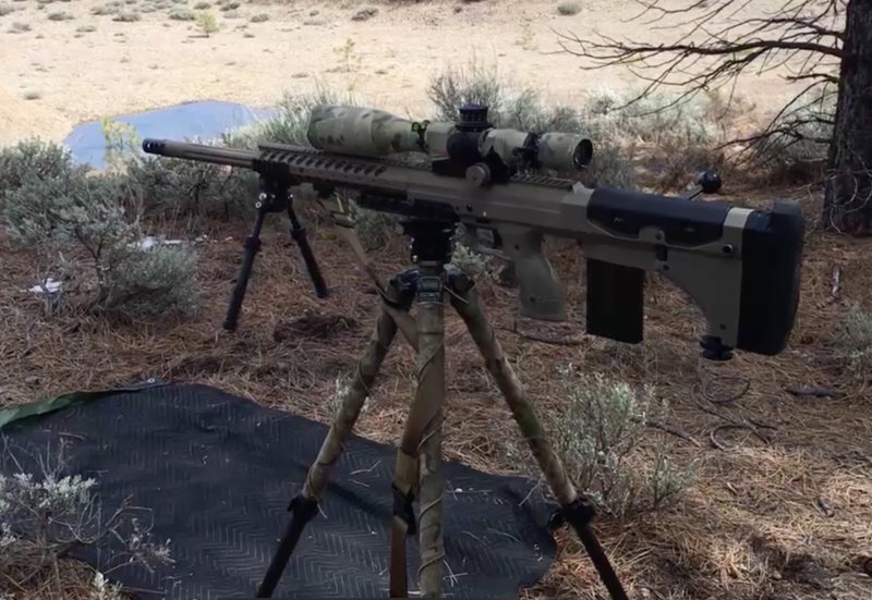

I'm in a similar situation, looking for a better tripod. Seriously considering the 3372. Also, these guys are right about the leveling base with direct attachment. I recently switched from the pig saddle to the RRS rail on my DT and just using the an old crappy photography tripod and the difference in stability is amazing.
crappy cell phone pic..
