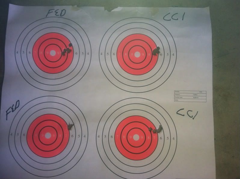

The same load, Virgin Lapua brass 45.5 gr Varget set to mag length? The only diffrence is primer, one Fed 210 the other CCI.
Thx Diego
Re: Give it to me Straight, Is this shooter error?
<div class="ubbcode-block"><div class="ubbcode-header">Originally Posted By: 5R milspec</div><div class="ubbcode-body">we need more info.but they look great to me. </div></div> The bug holes are great the other two not so much. 308 of the bipod in front, rear bag. 169 Amax. I felt I was pulling a tad but not so much to string? I was testing primers, all are 5 shot groups at 100 yards.
Diego
From what's shown, no way to tell the difference between perfection and blind luck. There is not a sufficient set of samples to see any statictical relevence. This experiment needs to be done repeatedly to see if any reliable trends develop.
Greg
Did you accidentally mix up the primers? I would hope not but it looks like the results are flip flopped. I agree with Greg, the only way to know for sure is to fire more groups and see what happens.
