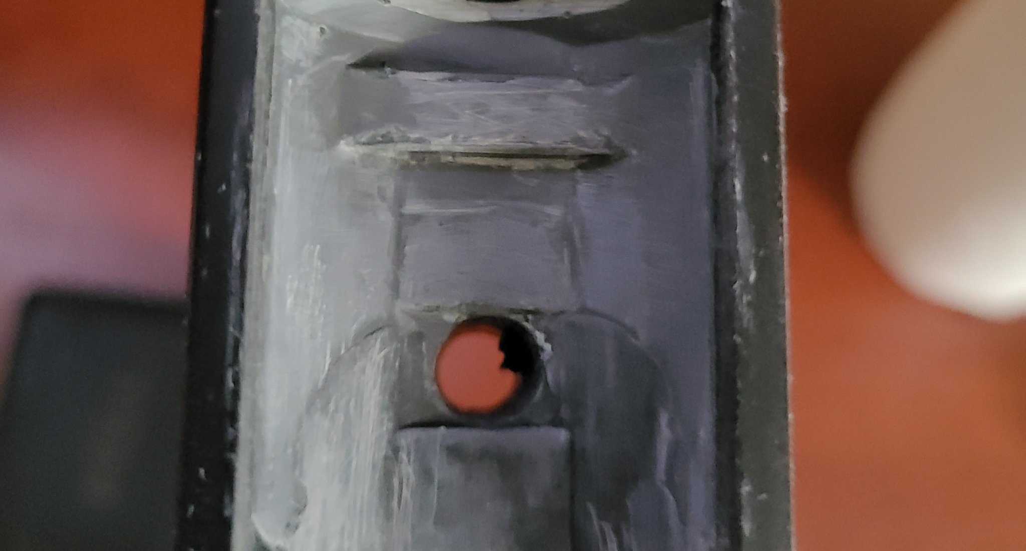

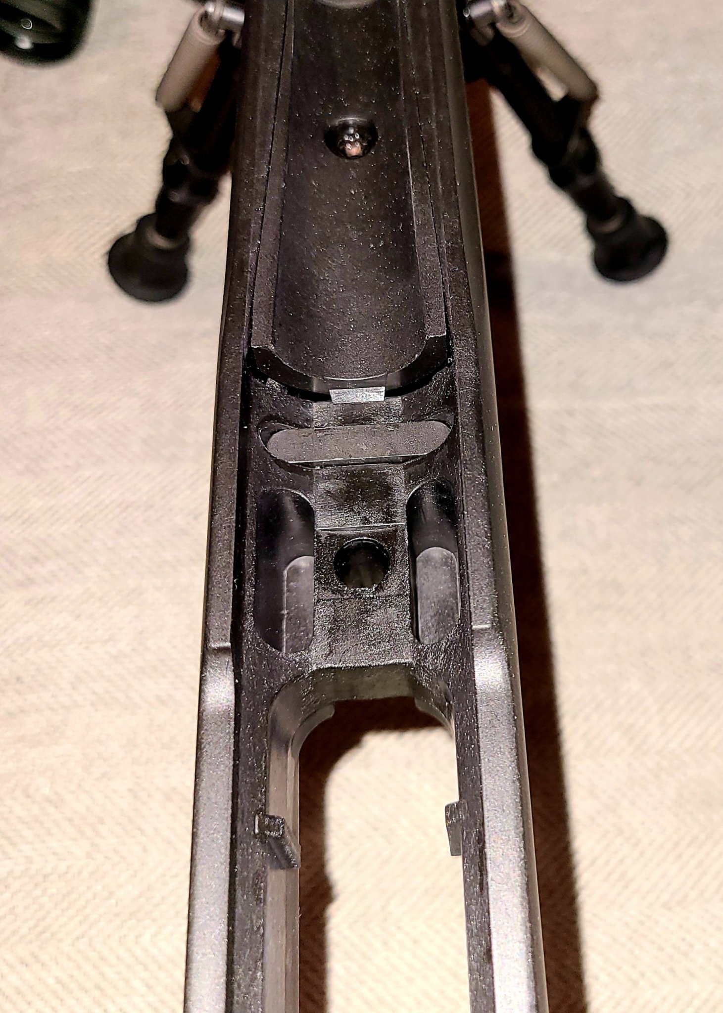

BEFORE
AFTER
I had to bed this twice as the first one wasn't covered completely, that's why it looks like 2 different colors.
But it fit amazingly well to receiver, and I cleaned up some of the edges where too much bedding compound got into.
