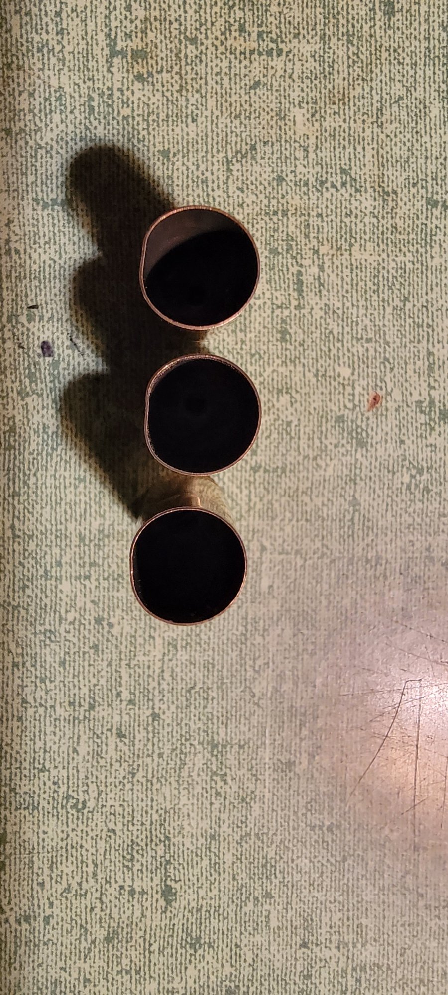

200 Grain Hornady Hollow Point (Hand Load to Book Max) - pics of deformed brass

It mostly fails to feed. Sometimes it doesn't fully go into battery. The brass is also scraping on the slide ejection port and shaving a good bit off and sometimes with the hotter loads it will actually deform the brass - see pics below.

Brass flattened on one side with hot loads is probably ejecting so hard it smacks the slide as it spins from the ejector and extractor. Not an indication of a problem by itself, just shows faster cycle of slide.
What does once fired factory brass look like? What does factory ammo loaded by dropping slide on each round and removed without firing it look like? Any Mark's? Can you do this through multiple magazines with no feeding issues?
