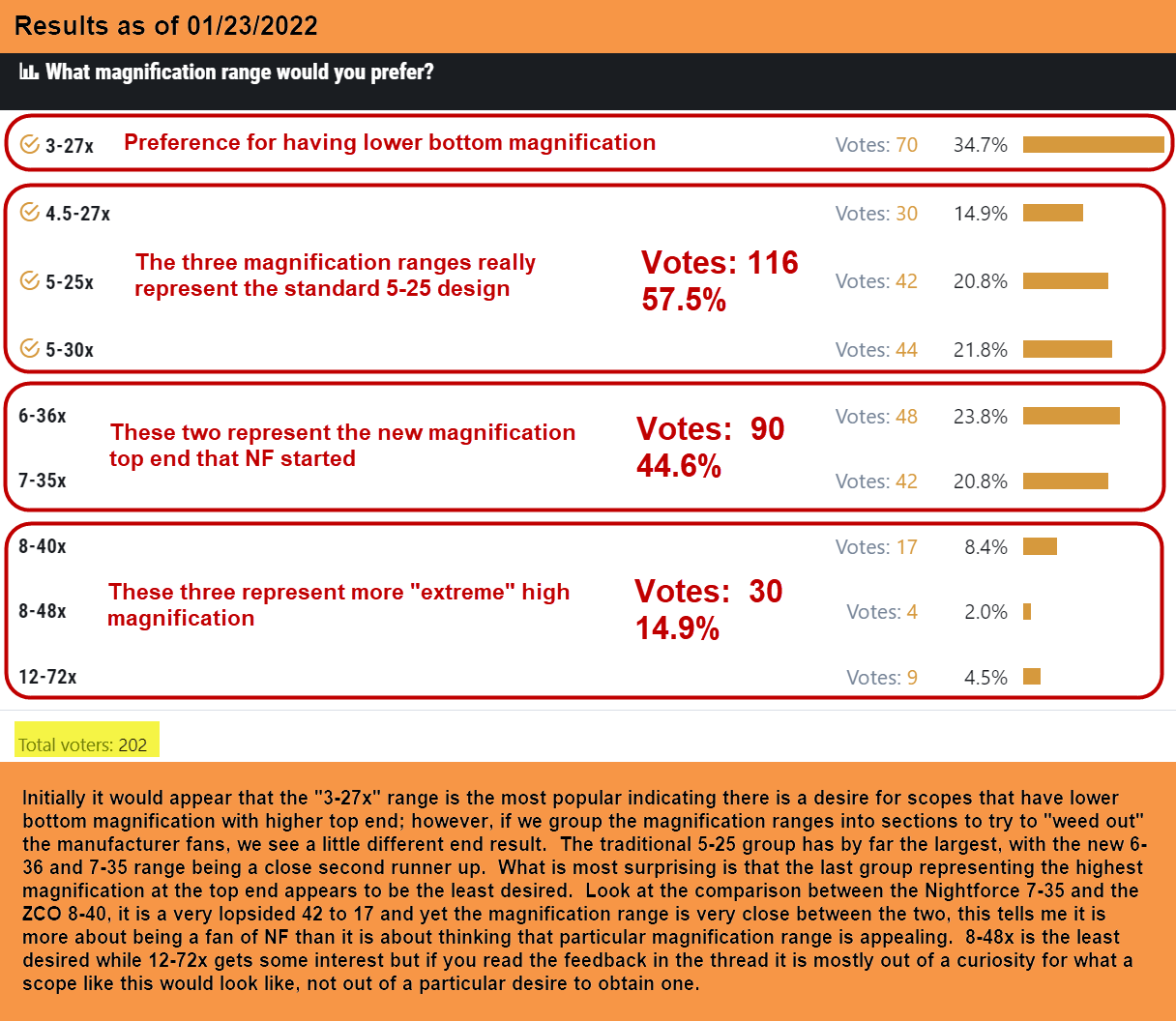

    Here's some preliminary thoughts
    1. Seems like more people would like an option that has lower bottom magnification.
    2. Seems like the traditional 5-25ish range is still the most sought after
    3. The new 6-36/7-35 shows great promise
    4. The 8-40 range received almost 2/3 less votes than 7-35 when they are very close in mag range, does this indicate a greater fan base for Nightforce vs. ZCO or is it representing something else - possibly that 35/36x is really as high as anybody prefers to go?
    5. Virtually nobody would like to see an 8-48 but a few would like to see 12-72 (maybe out of curiosity)
    Reactions: ArTeeKay
