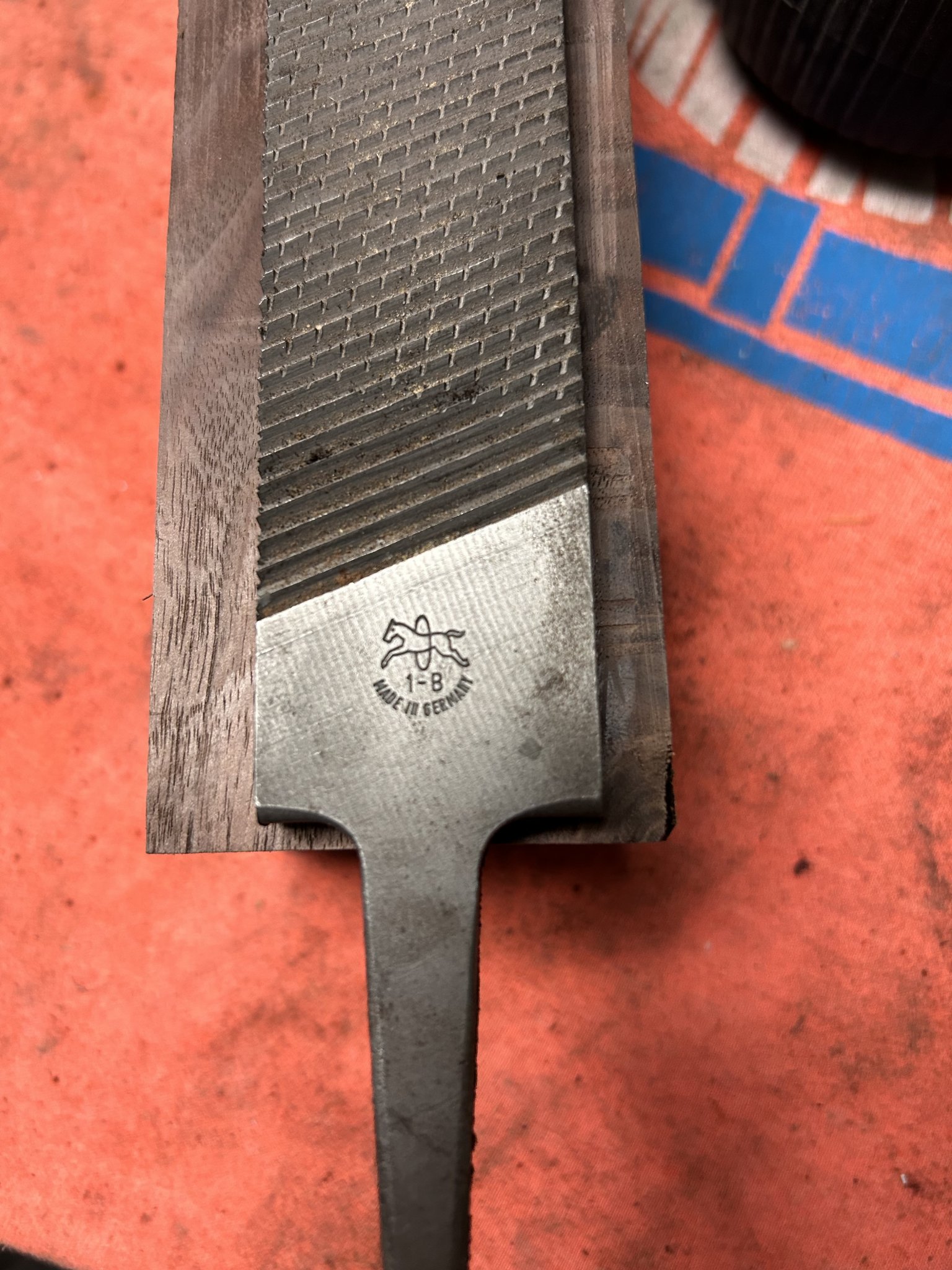

I’m at a point in life where it has become worth it to try and get the best possible tools money can buy, especially hand tools.
A few years back I bought a big Pferd brand (German made) flat file with weird square teeth that don’t look like they’d do anything but grate cheese, but it cuts like crazy. It takes “curls” of steel or chips like a sharp lathe bit rather than scratching the surface like sandpaper. It leaves a nice ish finish, but it’s way too big and aggressive for most stuff.
The only place I can find that brand is Amazon and it’s difficult to judge quality/cut size without holding a tool in person.
I have some made in India Nicholson’s and china’s best that have collected over the years. The nicholsons work but they gouge/scratch rather than “cut” it seems.
What brand do the guys who use files professionally go with?

Pferd, Simonds and Grobet are the GOOD file brands, but I've never bothered to buy one (or been able to inherit one). Though I really should I guess.
The shape you have is the "chip breaker" style, more specifically the chip breaker channels. I think they make varying widths of this, but it helps the cut because each tooth cuts individually to make a nice little chip, instead of trying to peel wide swath of metal.

Good files are worth the money. I know, I use them every single day in the shop on metal. The ones that dull quickly are not worth my time. Pferd are good. They have all types of files that you need and don't need.
OP, take a look and see if they have they file you want in a less aggressive cut.

A little more color to this may help: it isn't just the cost of a file. It is the steel, the temper, the profile, the tooth cut and how it is used. If you take a cheap Nicholson file vs a quality one and run them side by side (properly) the quality files are going to last much longer. That can translate into years of use. Now if you take a file that is expensive and price out the cost of each stroke across the life of the file you will find that for most files the cost may be more than a cheap file, but it really isn't that much. A good file is just a dream to use. A cheap file will come with uneven teeth, leave gashes in the work, etc. They really are a pain. I understand why people use them; my beef is with the people who make them, especially finishing files. A bad cheap file can take what could be a zen moment and turn it into a nightmare, especially when you are relying upon the file to do finish dimensions, whether it is a rifle or a leg on Momma's coffee table.
All my comments above are totally dependent upon an individual knowing how to run a file correctly for the task at hand.

That "properly" is another side of this worth mentioning - it disgusts me how many mechanics and self professed craftsmen scrub their files back and forth both directions across a part. (We're talking normal files here, not diamond stones or specialty stuff made for cutting both directions.) Files should be used in the cut direction only, never drag the file backwards over the work. It dulls files quickly, even high quality stuff depending on the hardness of the work piece. No point in buying high end files if one is going to do that.

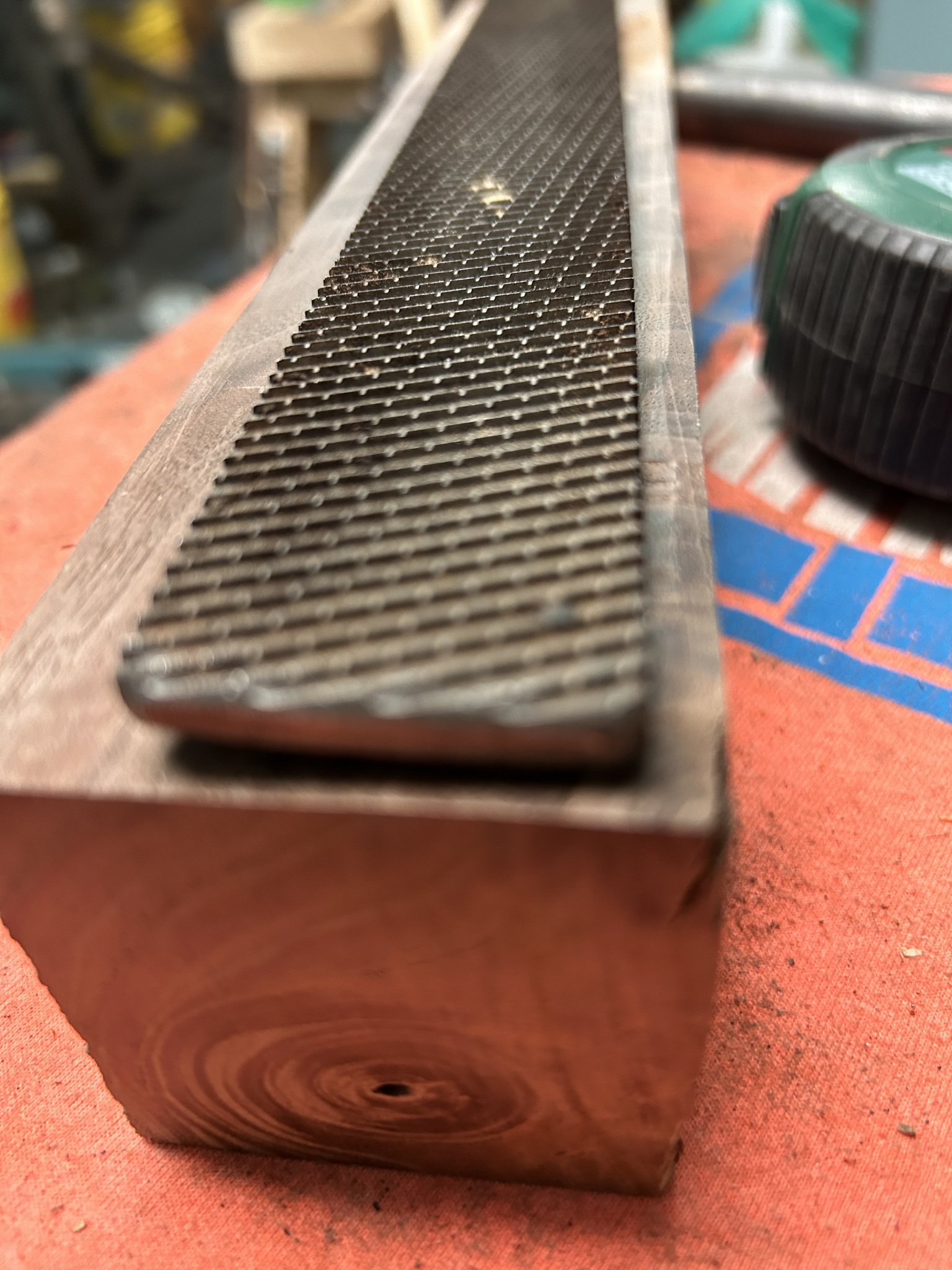

It's not a matter of theory, or thinking it "might" happen - dragging a file backwards can definitely dull the file. It won't always, because it depends on the material being filed, but it can and does happen. With evidence showing that it does happen, any test attempting to prove otherwise is a waste of time.
Here's a file my son damaged a couple years ago when he was learning. You can see the shiny drag marks, and feel the difference with a finger. Zooming in with a loop shows exactly what can happen to files , machine cutters, and knives when dragging a sharp edge backwards - the sharp edges are rolled over. In this case, there's no doubt about what happened; I saw him do it, and the file was fine before that - he rubbed it back and forth over the handle end of a knife blank while trying to fit a set of scales. No big deal for a kid like him in middle school learning how to use tools, but grown men and especially self professed craftsmen should know better.
