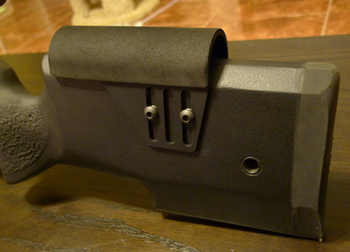

One way to reduce weight is by using a XLR Cheek Rest
BallisticPrimate - Agreed. I actually looked at going with a Manners Elite T4 w/o a cheek piece (2 lb). I looked at the NEAR Alpha mounts w/o a pic rail to get the scope down low as possible so as not to need a cheek piece. I even looked at what it would take to mold one in after the fact. In the end I felt that it was a more risky approach than just going with the Manners with the adj. cheek piece. Besides I didn't want to wait months and months to finish this project.
