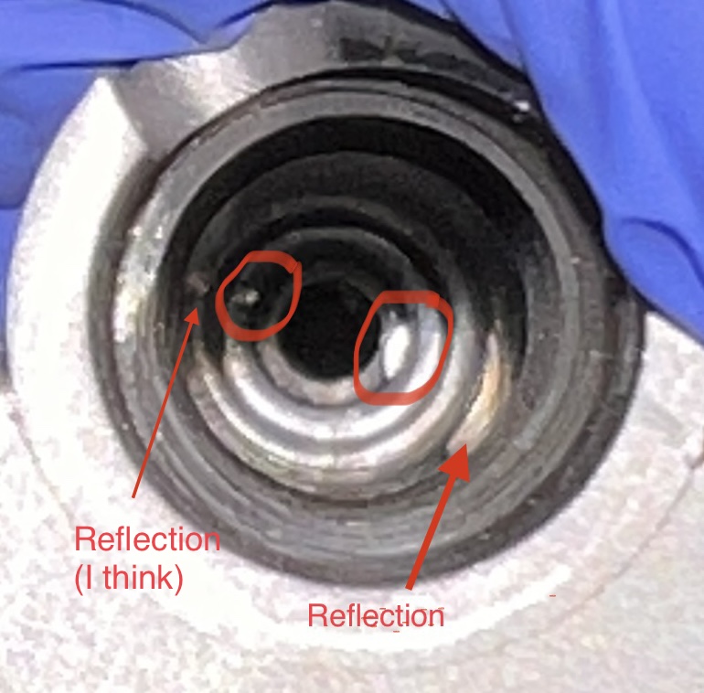

So, I figured it was oil/grease thickening up in the cold. I’ve disassembled the bolt (except the plunger) degreased it entirely. Inside the bolt body, I saw some “goobers” that aren’t present in my other Rem 700, but this is the first time I’ve ever disassembled a bolt and firing pin.
Here is the view inside the bolt body:

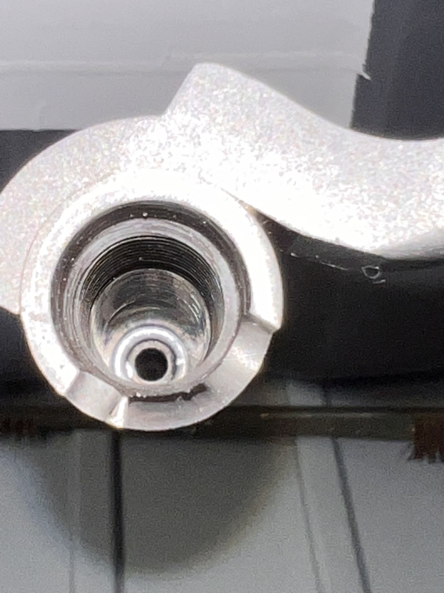

On the firing pin itself I saw a mark whose size corresponds to the big goober, but I forgot to eyeball if it lined up with the goober once installed. The mark is a finish sort of mark, with perhaps the very slightest indentation. Can’t feel it with a fingernail, however.
The firing pin assembly and bolt interior did not have any grease present, and in fact the firing pin had a little rust! Keep in mind this gun has never been used in the field, it’s just a range toy at this point.

Have you tried lightly scraping them off with a pick? Sure look like weld splatter, or lead.

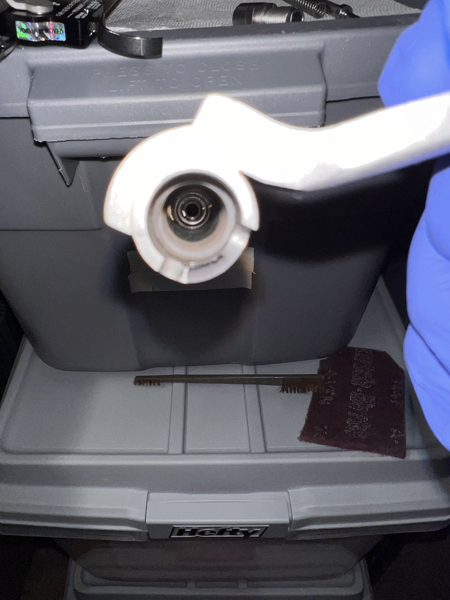

Tried with a pick, but the only long pick I have obscures my view. I “think” I got it into correct position once and felt it. But it’s so hard to get in there…I need to buy slender dental picks.

Not that I'm aware of. That area is cut with the reamer, upon chambering. I bet someone here has seen that exact issue, though.
