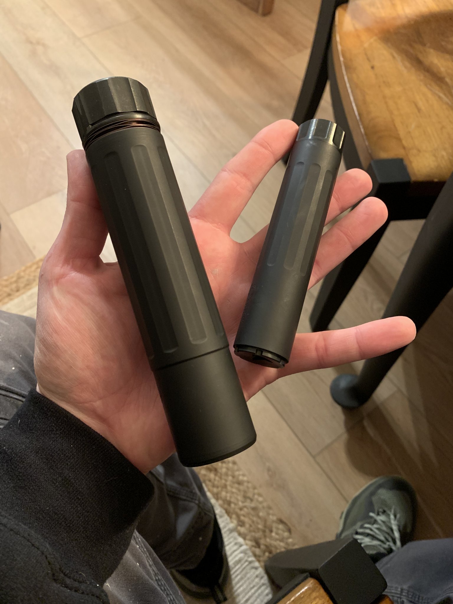

I went with a dead air Mask and a dead air sandman. Pretty damn happy, sandman works well on .223 stuff, better is you get the end cap and swap it when you need to. It’s decent with the .30 endcap too.
Mask is a great little can, no complaints
