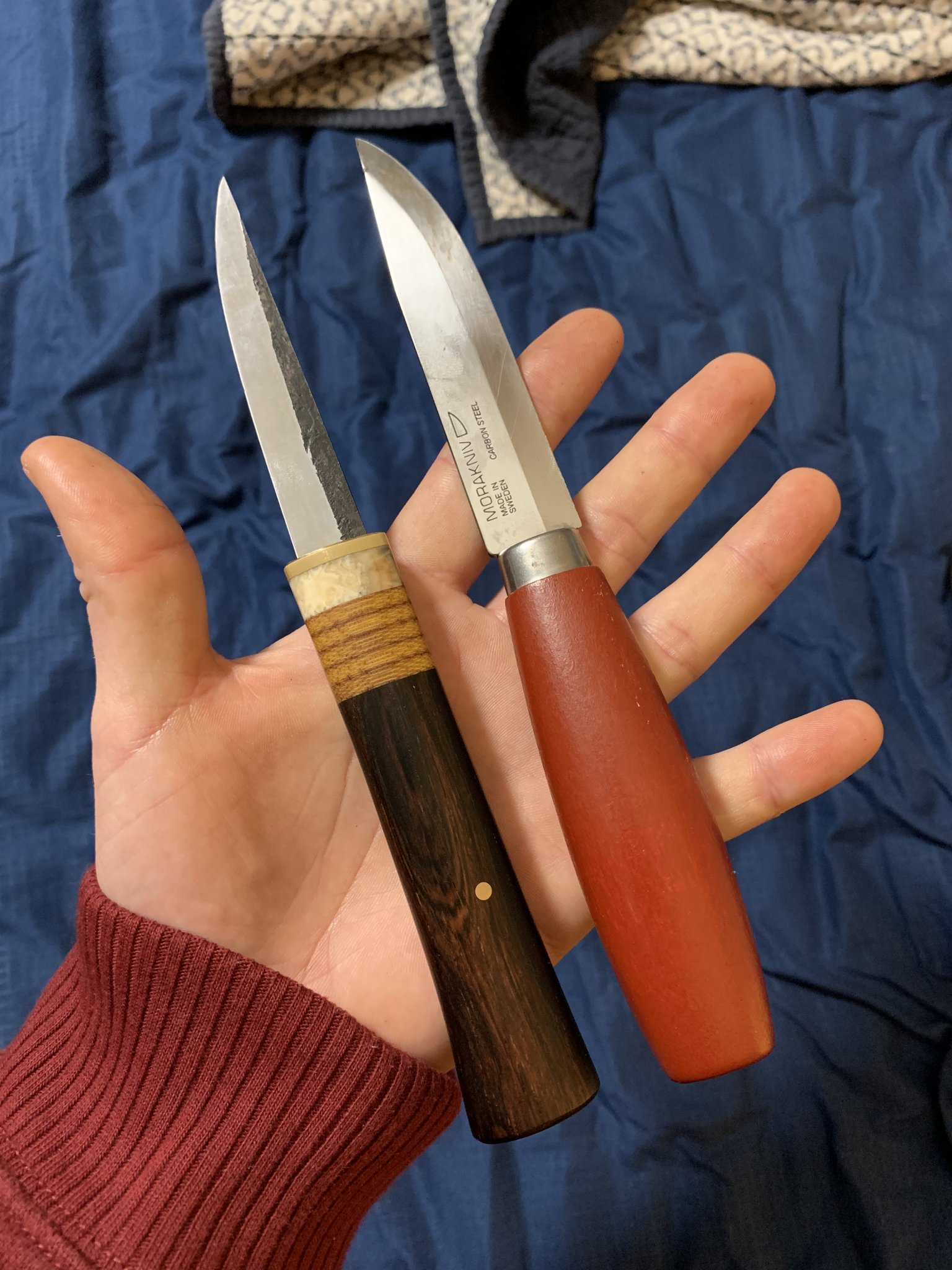

I’m a huge fan of Mora knives. They perform, they’re cheap, and I’ve never had one fail me.
I also enjoy making them. On the left is a sloyd I forged from W2, and fancied up with scrap pieces because of reasons.
