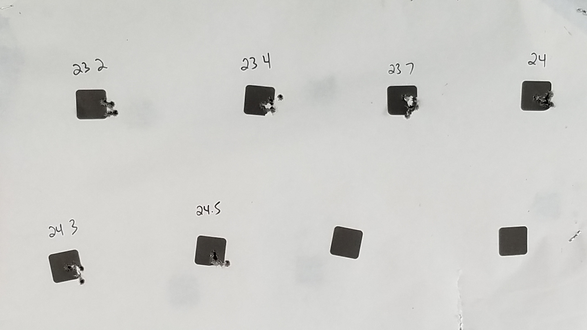

I just did a powder weight test today with 8208. Was shooting in a 20mph wind and my target was moving a little back and forth. Had a flier here and there. Had to walk 100 yes’s through mud to set up the target. Would have preferred better conditions, but I just NEEDED to go shooting.
Shooting 75gr eld-m out of a bolt gun.
I know sometimes the hodgdon data is conservative but for the 75 vld they list 22.7 as max and for the 77gr sierra they list 23.3. Did you have any problems loading up whats pictured?
