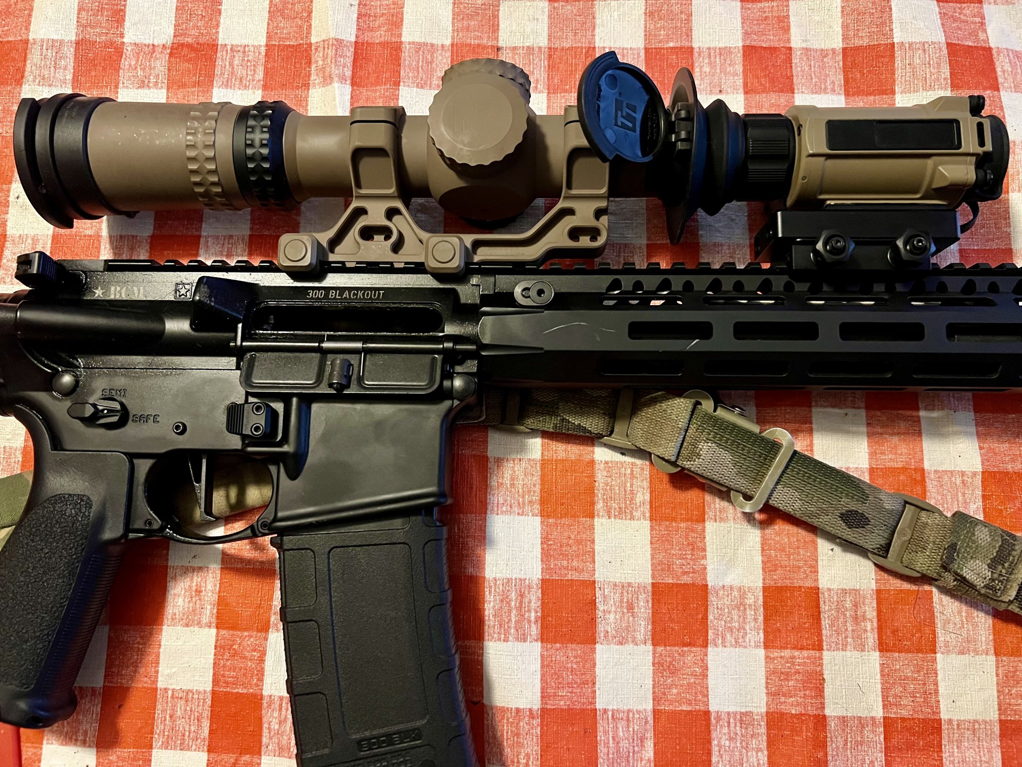

Rh25 with ac52 pictail and ac36 qd mount

Something is not right, the optical axis of the RH25 with pictail and in that mount should be close to 1.60".
Can you verify the height of the optical axis of your scope?
Another thing: you have your pictail rail mounted backwards on the RH25.
That mount is only 1.45”. And you are correct on pictail I already switched it. Getting the other vortex mount that is 1.59” should help. Ill report back. Thx for replying
