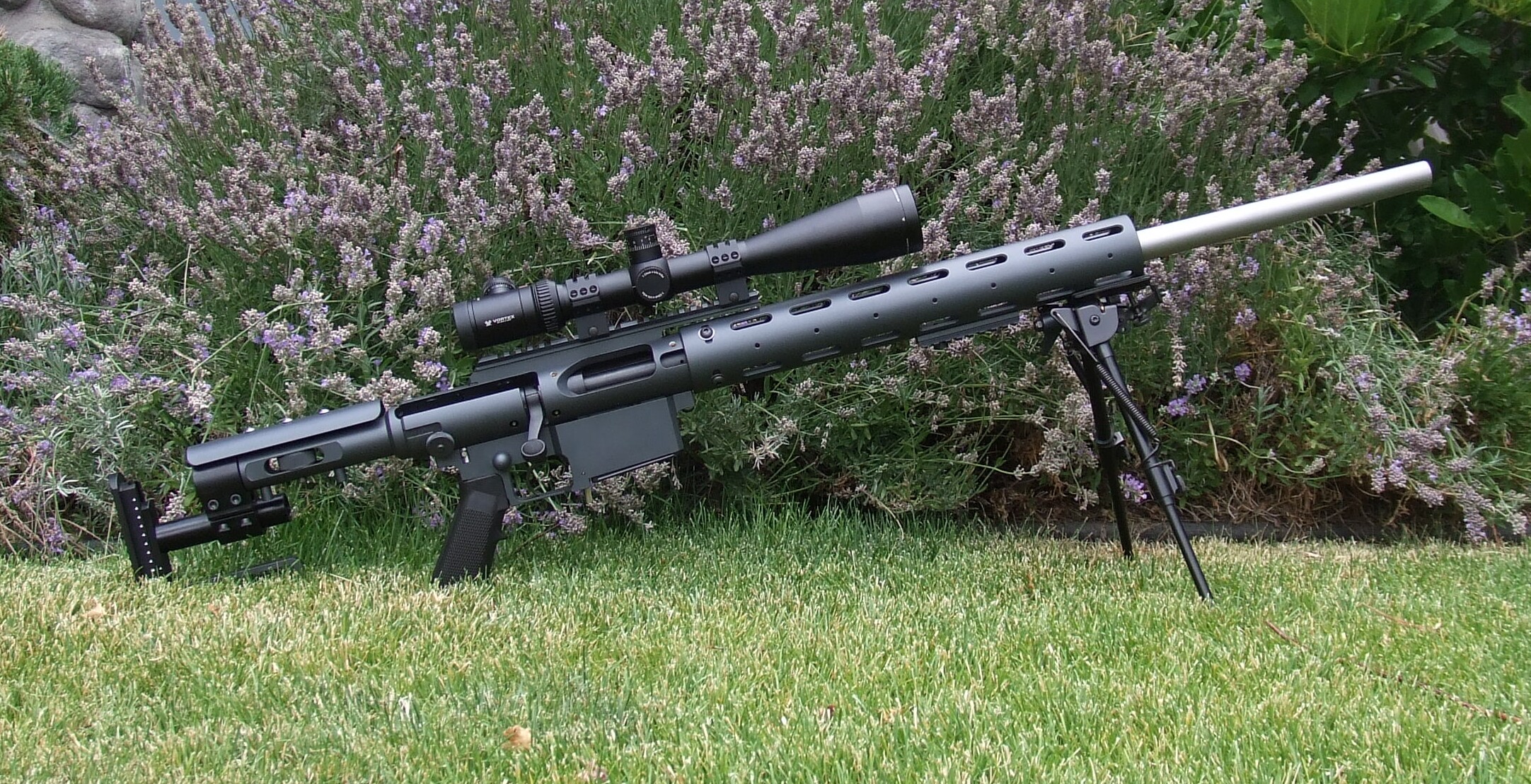

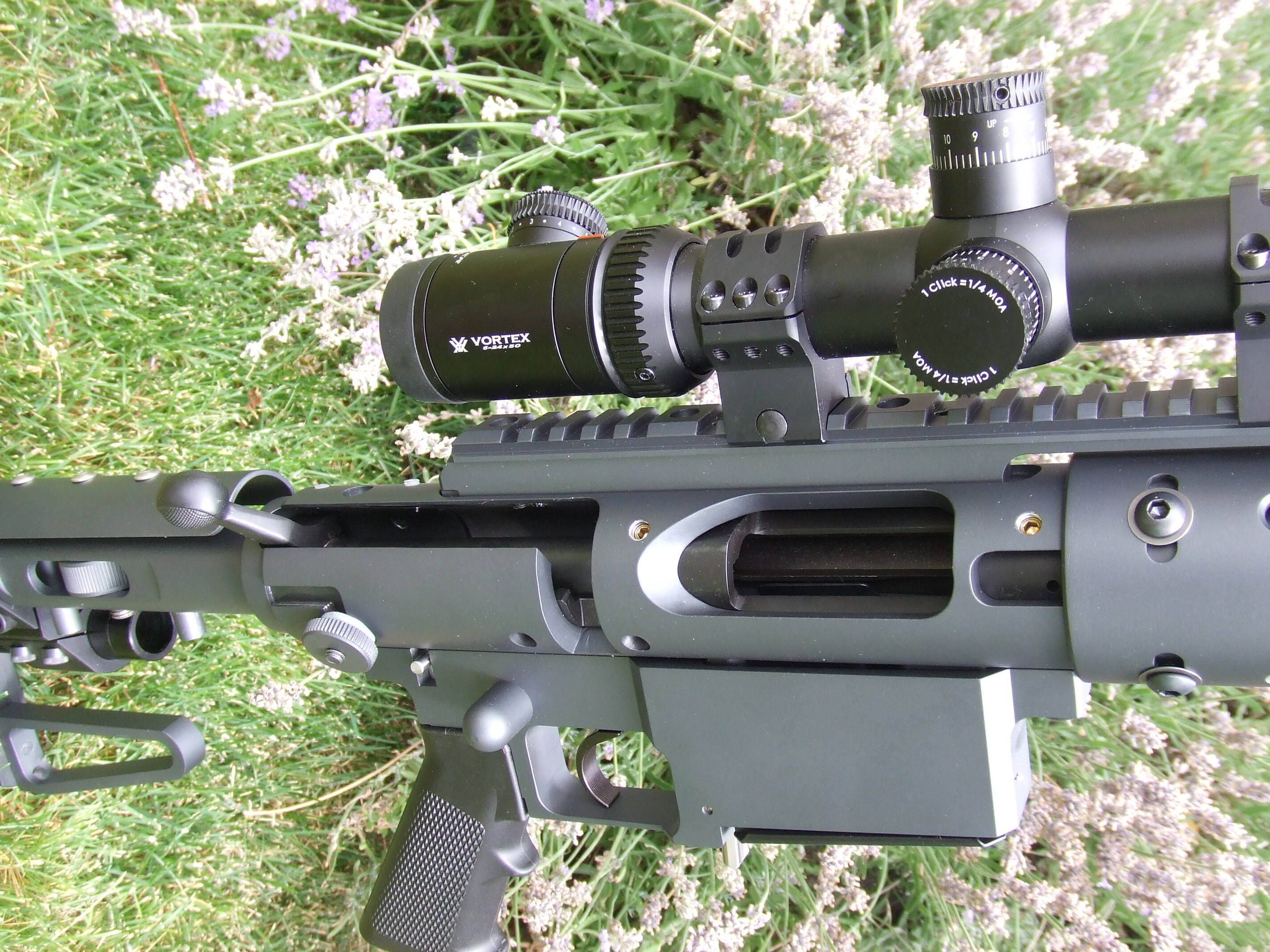

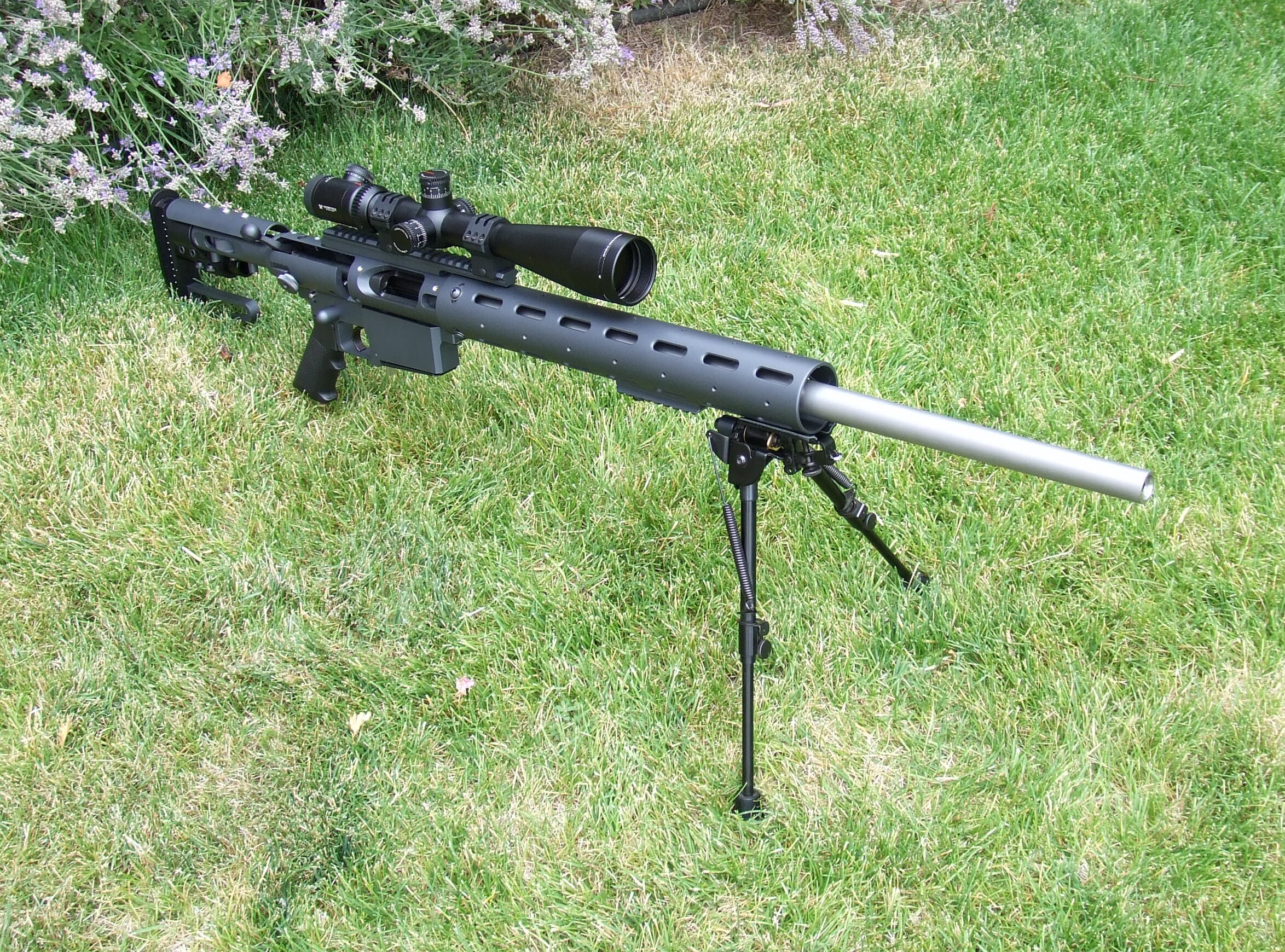

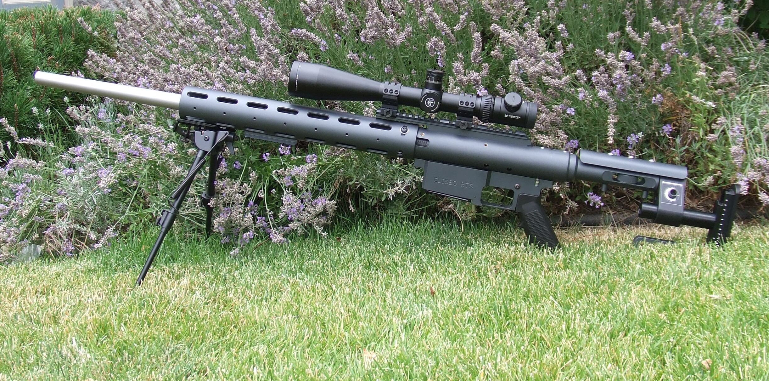

I had no problem putting it all together following Gary Eliseo's instruction page, once I found it (I'm a dinosaur, I guess) I clamped the whole barreled action in my mill and opened up both the front and the back of the magazine slot so I can mag-load longer rounds..... (NOTE: the mag wouldn't seat all the way until I did that.) There was no need to shorten the mag retainer as it went in perfectly after a little time spent with the mill opening up the action fore and aft. The Timney trigger with the safety and the bolt stop removed worked out just fine. The pins that hold both of those things in the trigger shell seem to have no other functions, so that worked just fine, though there is no safety....so far, all the matches I shoot require an Open Bolt Indicator, but not a safety. I hope to make it to the Hide Cup matches next year, but will have to check out their rules in regards a safety.
The finished rifle (which I have not fired yet) is a Competition Machine....Got X-Ring? (gunsmith grey Ceracoat finish) RTS chassis, Krieger Barrel chambered for 6.5 Creedmoor, Remington 700 action accurized/all squared up and a Sako extractor installed, Timney trigger, Weaver tactical rings and a Viper Vortex PST scope.
I sure hope it shoots as good as it looks!! (at least I like it!)
Have a look at the pictures...

Very nice. I'm not usually a fan of the "tube" guns but this one looks very good. Go shoot it! I'm very interested on how it does.
Yeah...I have always been a WOOD stock guy and recently switched to the synthetics. This is my first "Tube Gun" genre and I picked the color to give the whole rig a sort of "together" look rather than going with some kind of camo or desert/coyote color. At least it is NOT a "glue-in"!! Anyway, no matter what camo scheme you pick it is never the right one for the season/region/foliage you are going to need camo in anyway. This gun will most likely only be a comp gun anyway as it weighs just over 16 (!!) pounds with a magazine installed. Some of the guys I shoot with seem to think that I will NOT like the PST in a very short time and want to switch to a Nightforce or something similar.....I guess we shall see about that......

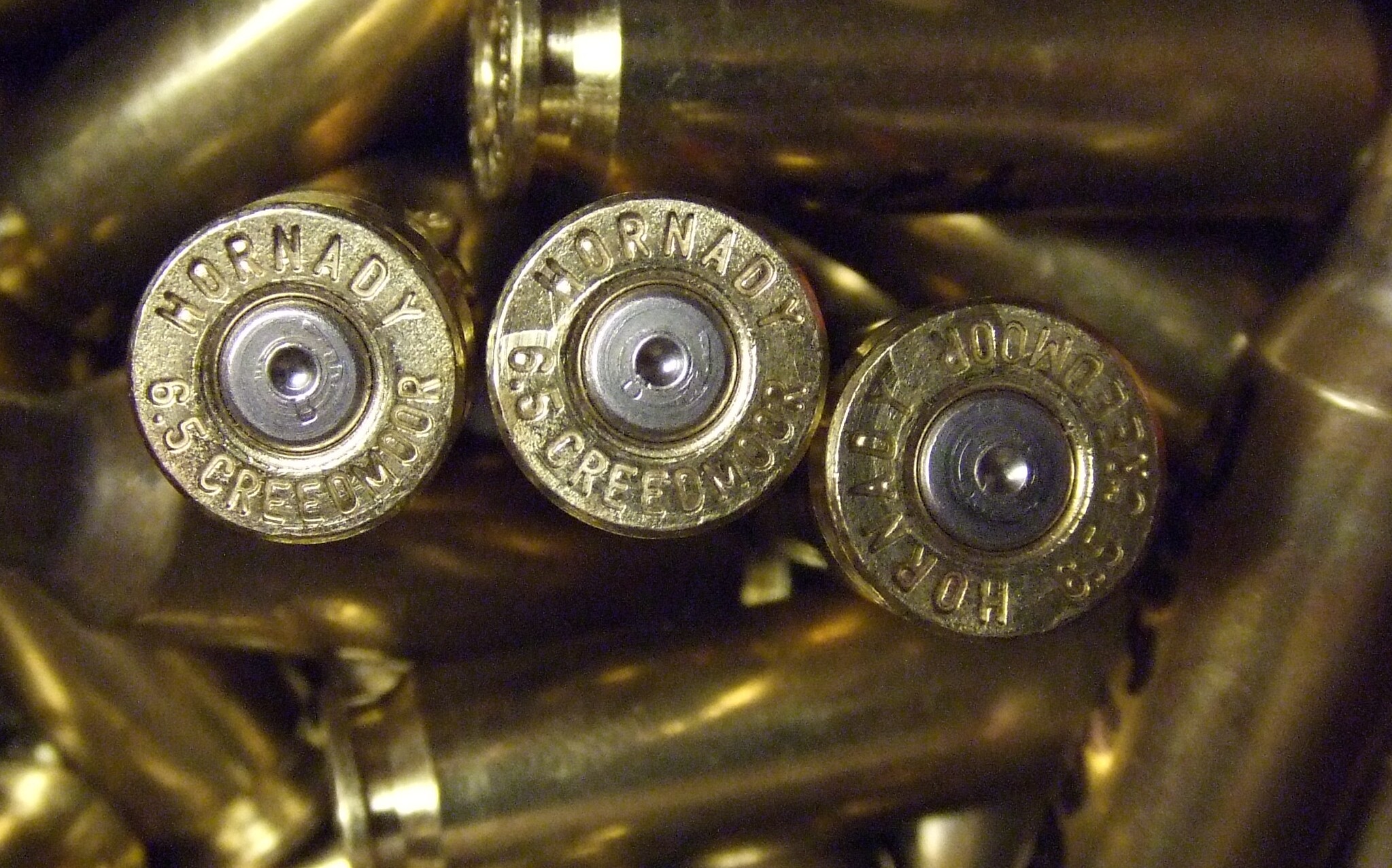

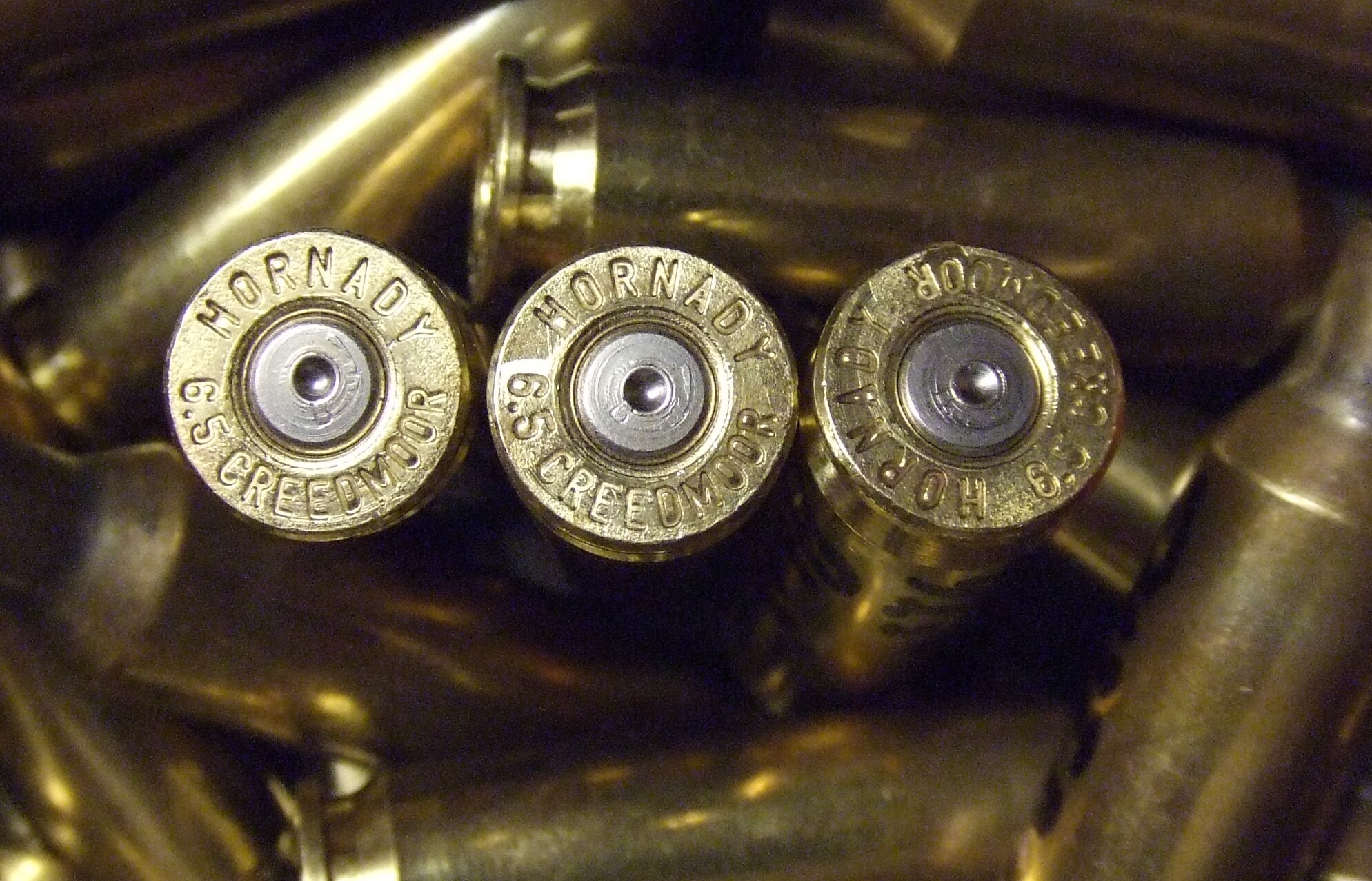

Finally went out and shot it...a little windy and with me, who is not the best guy to have shoot for groups shooting, it is making somewhat under .5 MOA at 220 yards with the 42.5 grains of Rl17 and about the same with the 43 grainers...haven't measured the groups yet...(5 shot)...so I am just eyeballing the groups and they appear to be about one inch at the 220 yard distance.. I can't give a report on the speeds as I grabbed the wrong case and when I got to the range and opened the case I did grab, I discovered it had a Contender pistol in it instead of my chronograph setup....DUH!!!!!...gotta look IN THE CASEE next time, I guess. But the loads were (and I am still breaking in the Krieger barrel and trying to get everything comfortable together) 42. 5 grains of Rl17, 42.5 grains of RL17, 43 grains of RL17, one load with 43 grains and 43.5 grains of 4350 and one load with MRP in it, but I don't remember exactly how many grains for the last one as they shot worth crap so not worth remembering. Bullets were Lapua 136L, Primers BR-2 and the cases Hornady's 6.5 Creedmoor cases. The Quickload software tells me that the Rl17 42.5 loads should be around 2881 fps and the 43 grainers should be about 2905, but my experience with Krieger barrels is that they tend to be a little faster than what the books/computers say they will. Now I gotta go and shoot them across the chrono to get some usable measurments for ballistics. Pressures looked good..the 42.5 showed no ejector swipes, the 43s showed some and the 43.5 grainers showed that they were a little more "swipey", so I'm thinking that the 42. 5 loads will likely be the hottest I will go. (see the pics). More to follow later sometime.
