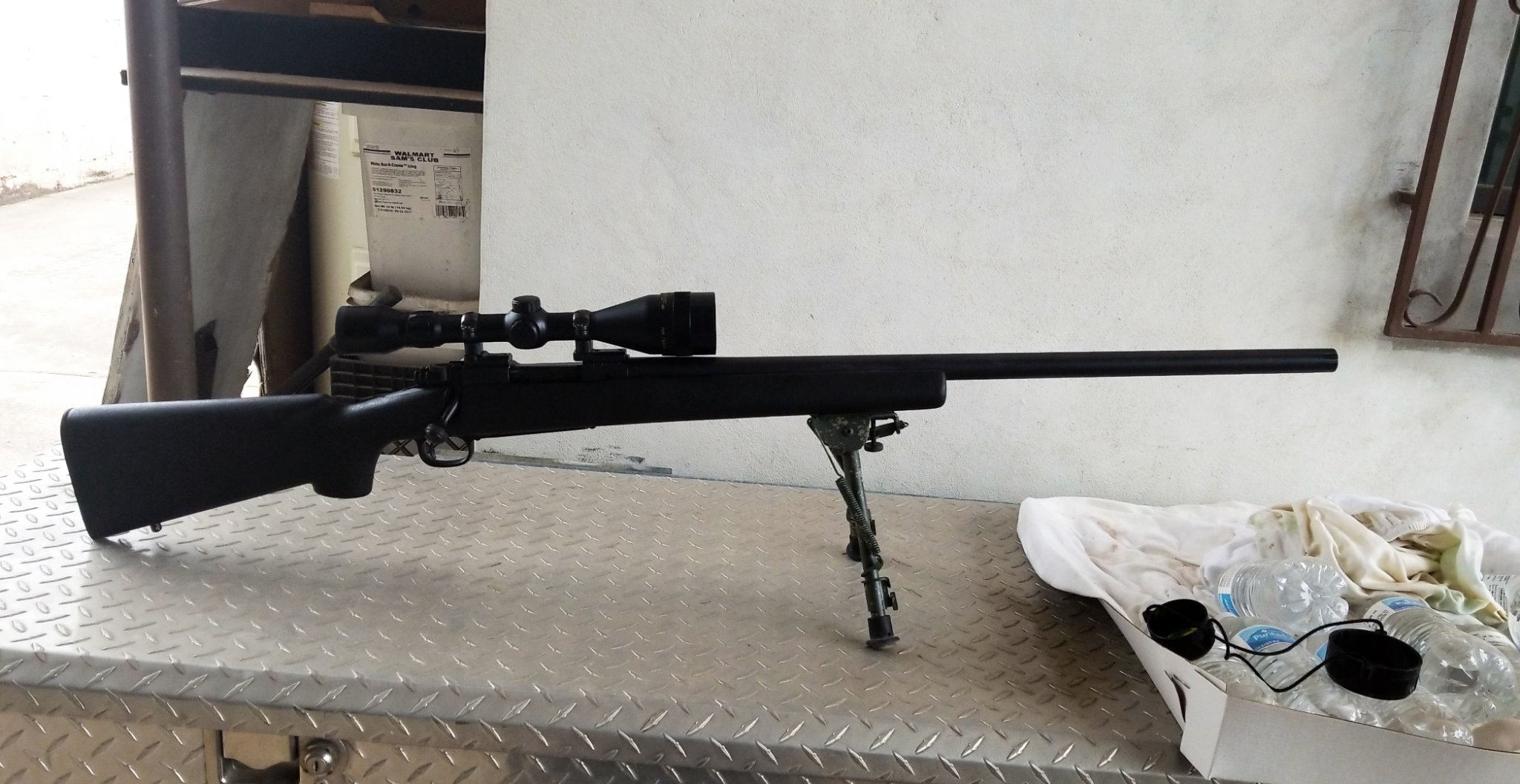

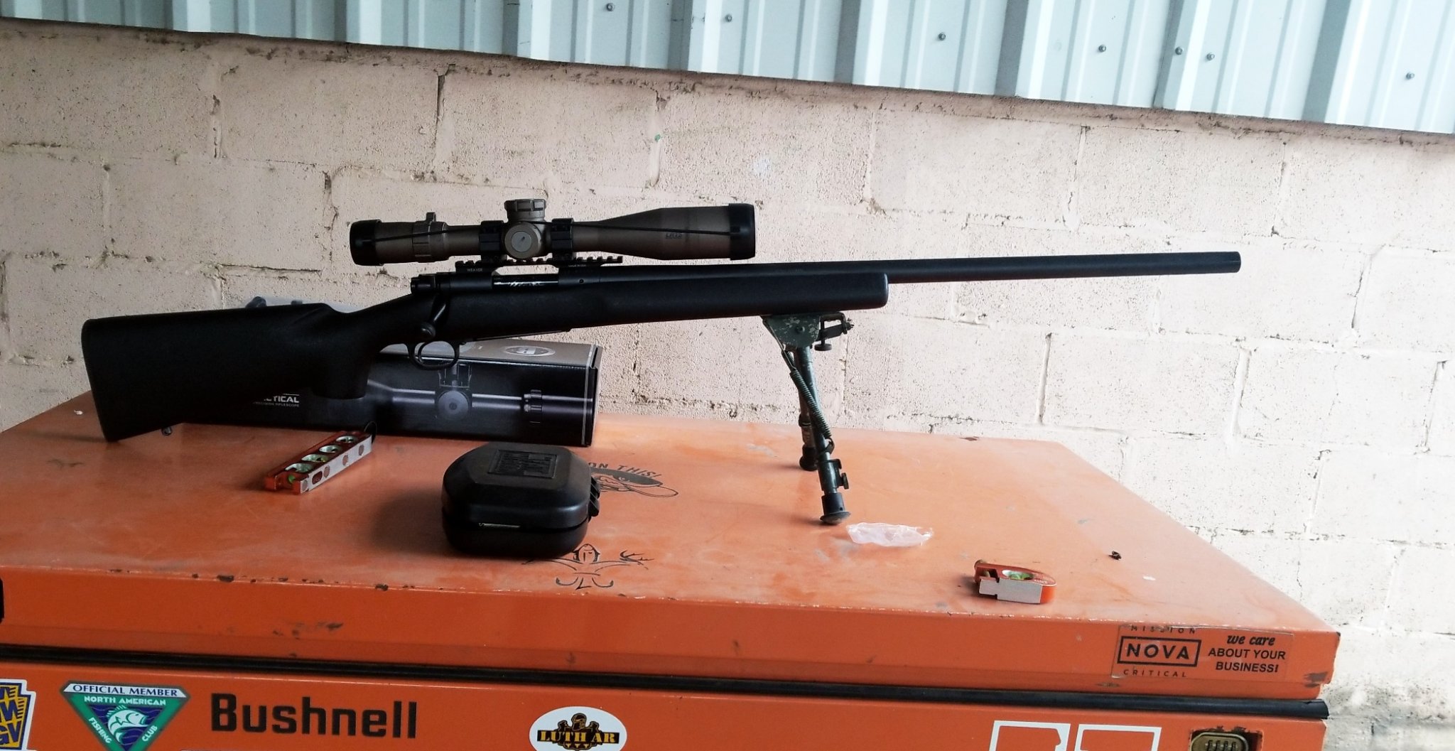

    Bought me a new toy and it finally arrived at my FFL. Was planning on taking it out today and just shoot some thing to see how she functions but it started to rain. I threw on her a 20 MOA weaver base, LRTS, and seekins rings. The rifle is in very good condition overall. However, the bolt does not run smooth at all like my other M70. Right when/where the bolt face & lugs go into and come out of the front part of the action is where it's very rough. Not sure what to do about this to fix it. Suggestions??? Trigger feels like it's been worked on and is relatively light.
    Anyhow, it's a heavy varmint barrel model. She is very front heavy. I have a box of 73 ELDM and the first two rounds don't feed well into the chamber, the remaining four do (only 6 fit). The 55 grain HP American gunner all feed smooth.
    I will try to see if I can go get her on paper @ 100 and maybe look around to see if I find anywhere else where I can stretch her out.

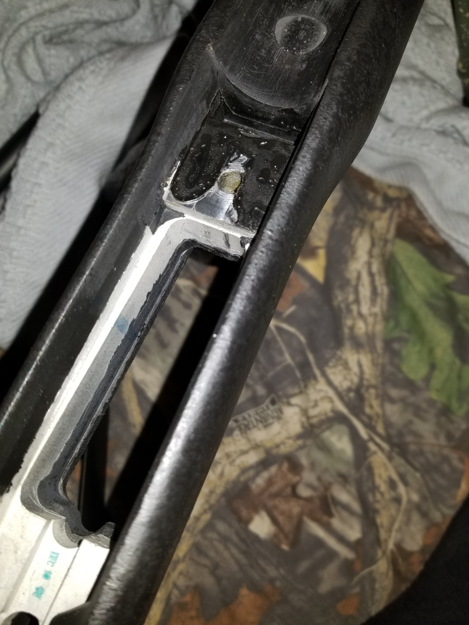

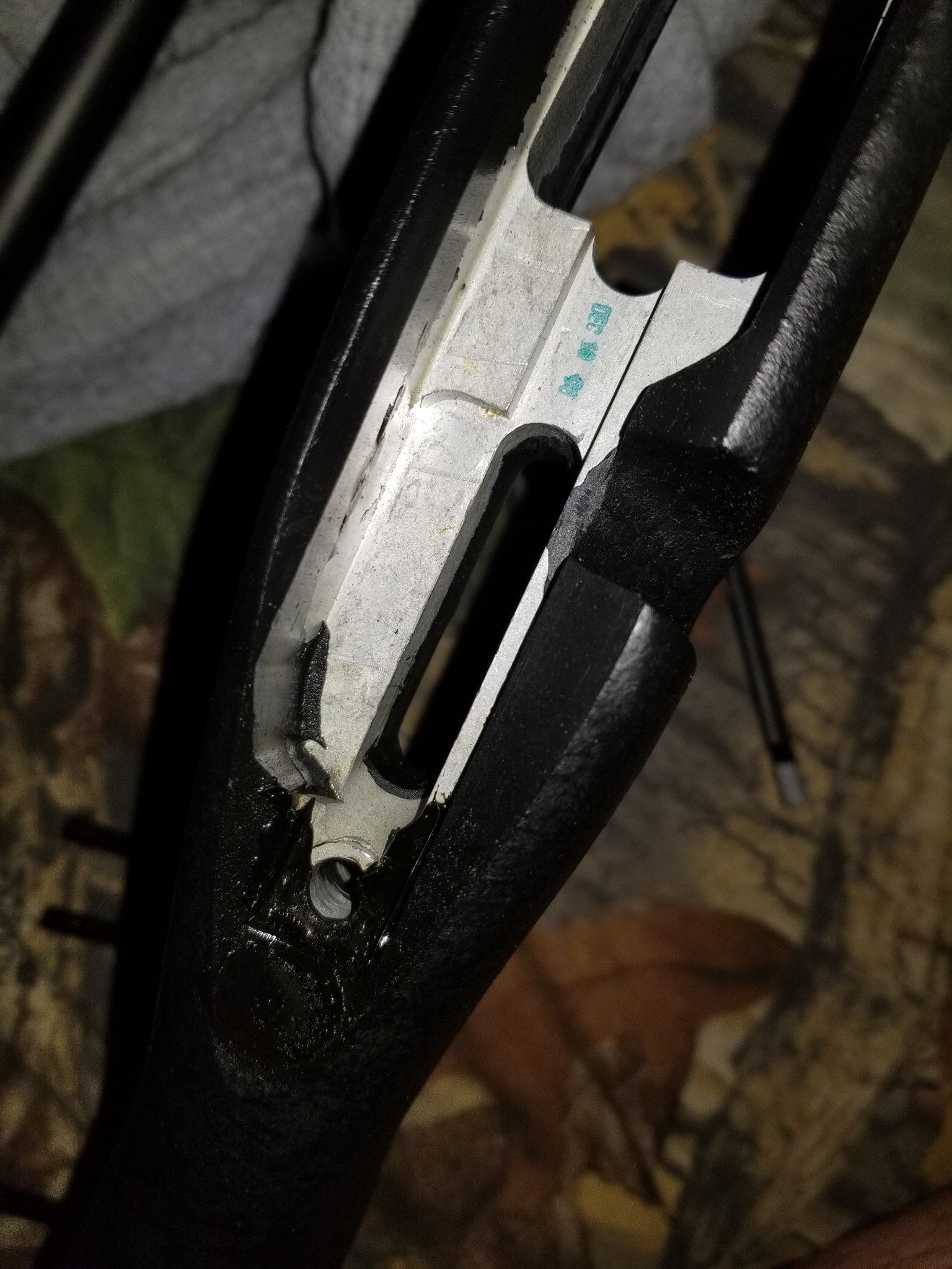

    Fix and fill a small ding/dent on bottom of stock

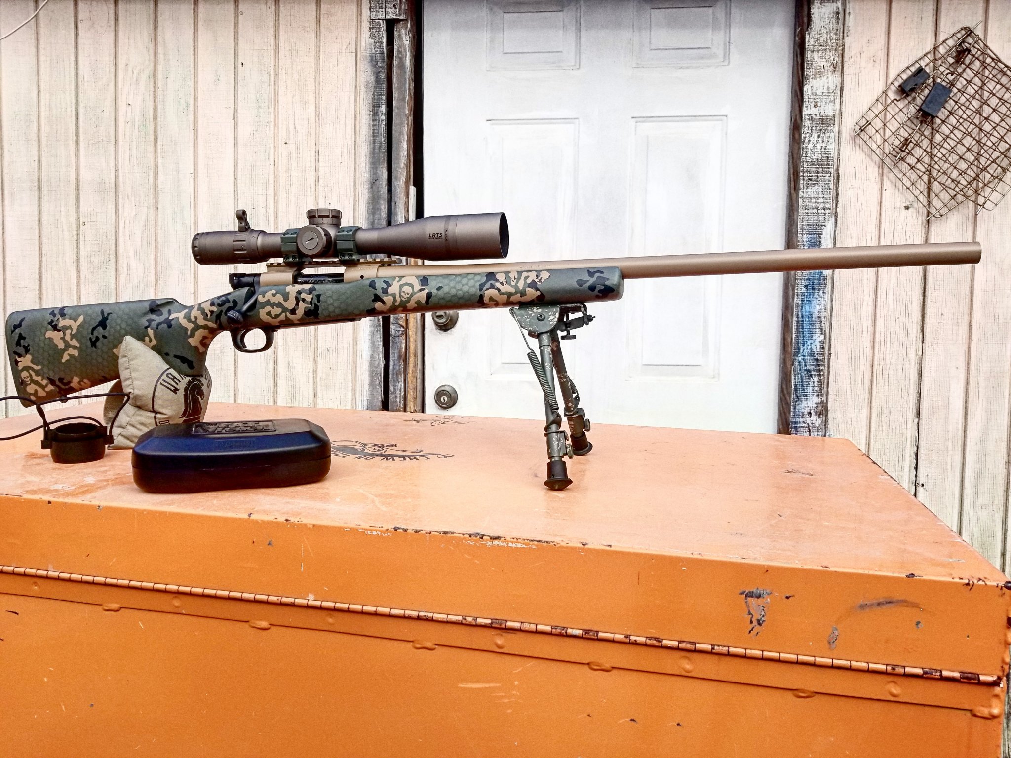

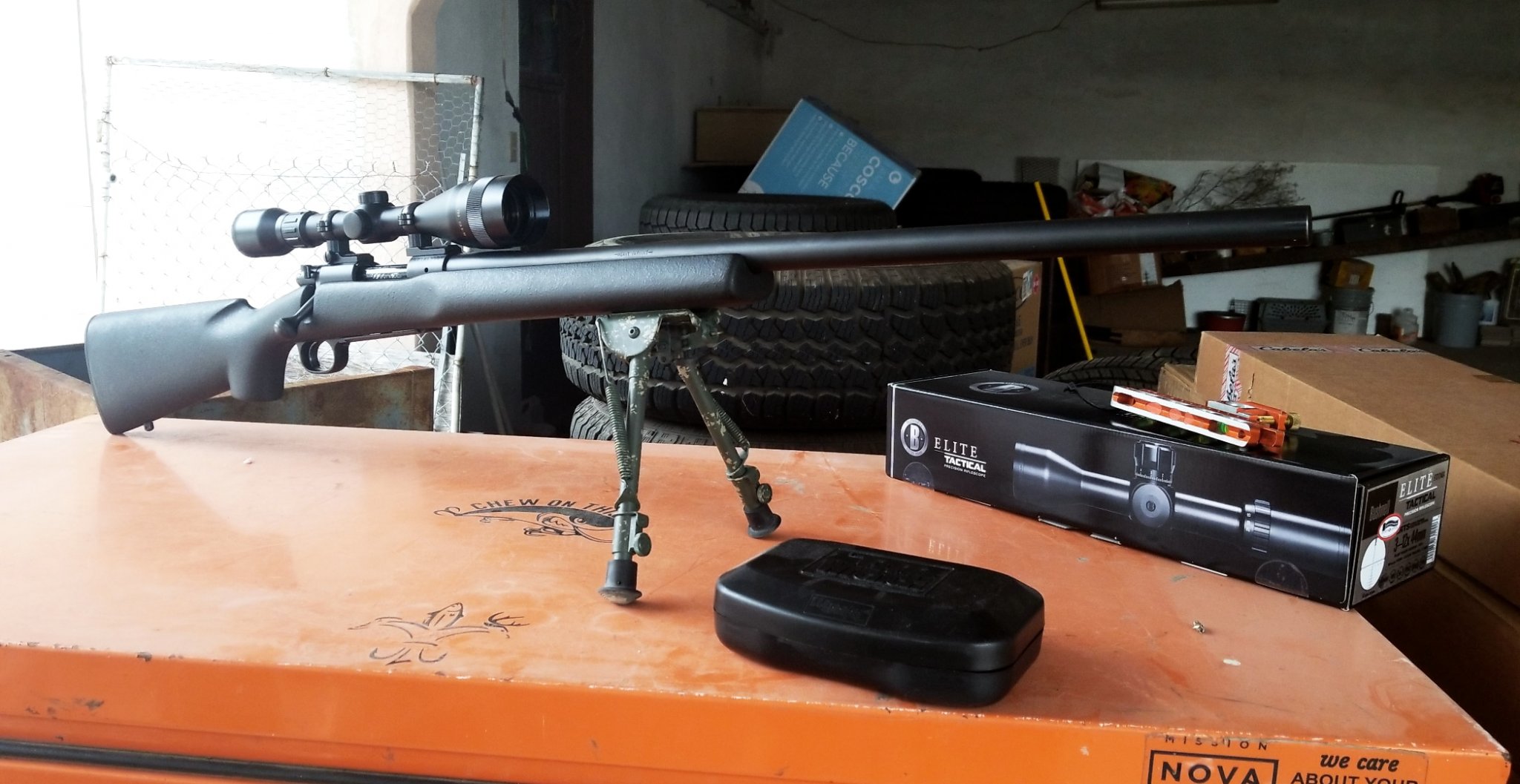

    This is how I got the rifle

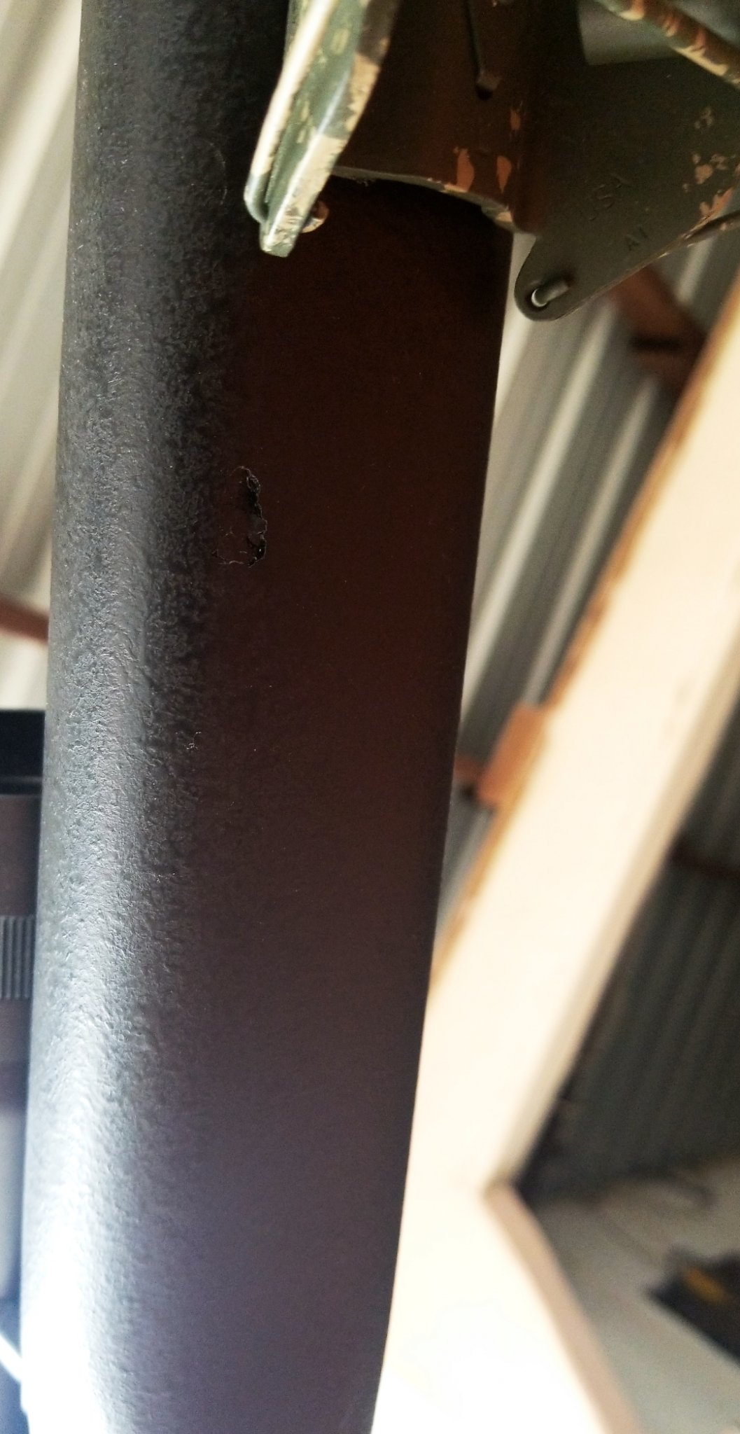

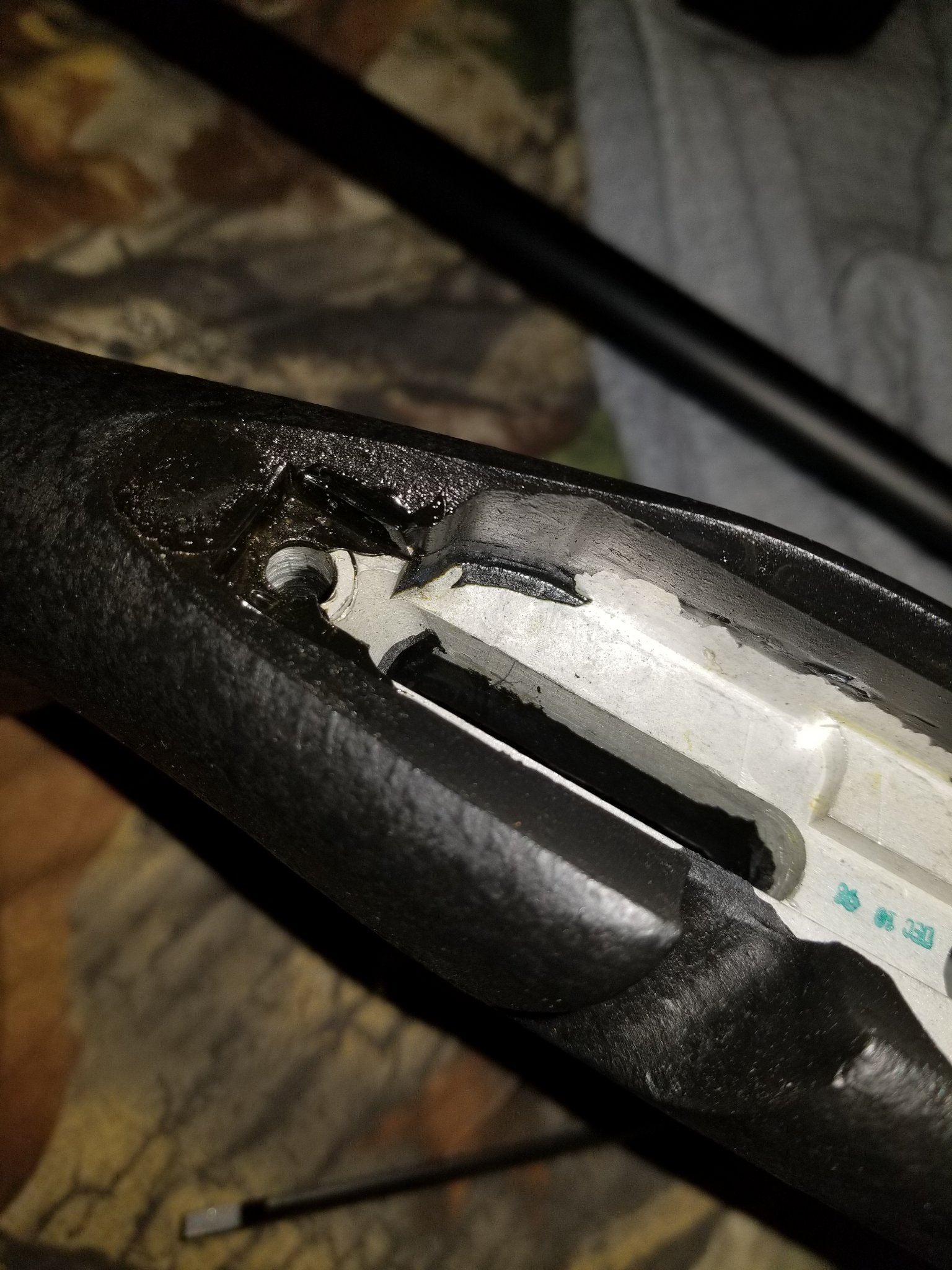

    Below is what I want to fill in order to fix and smooth out

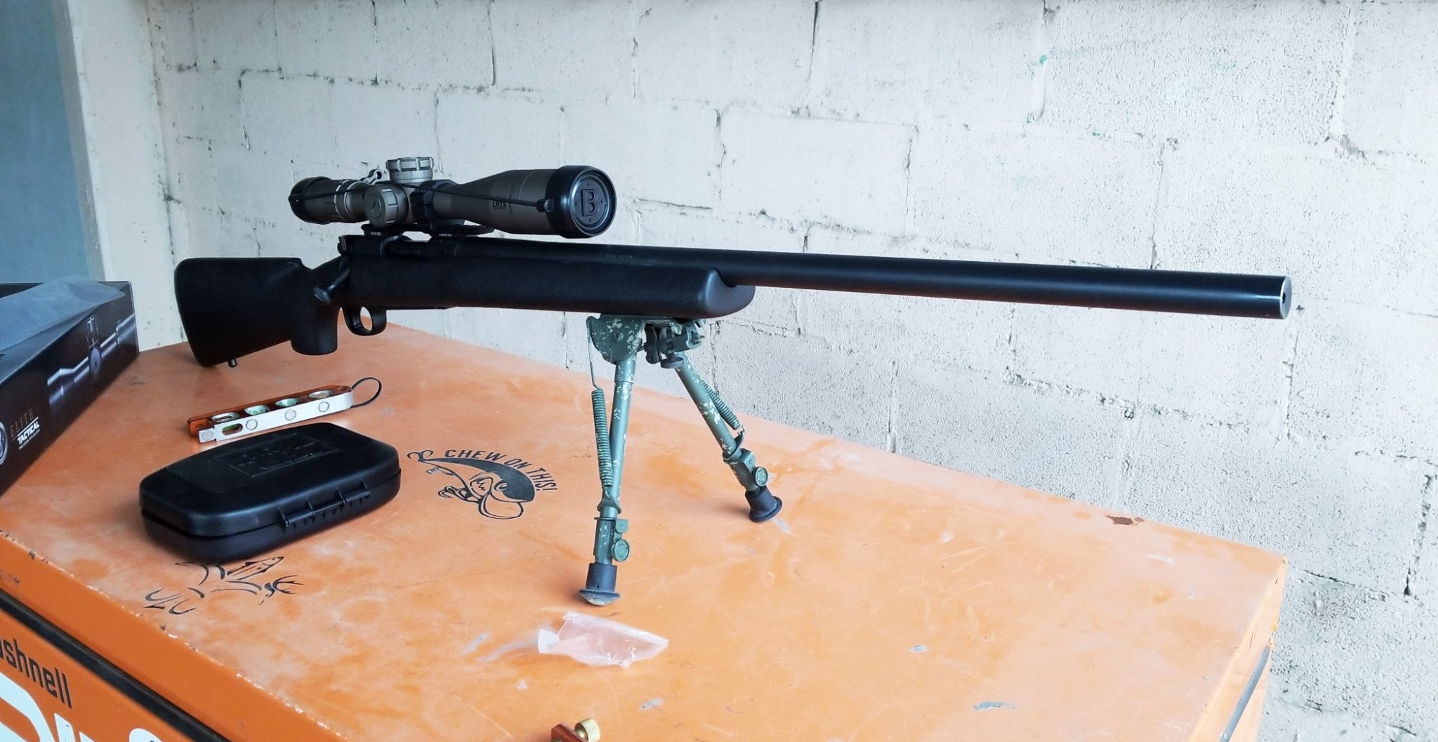

    Below is with new base, scope, and rings.

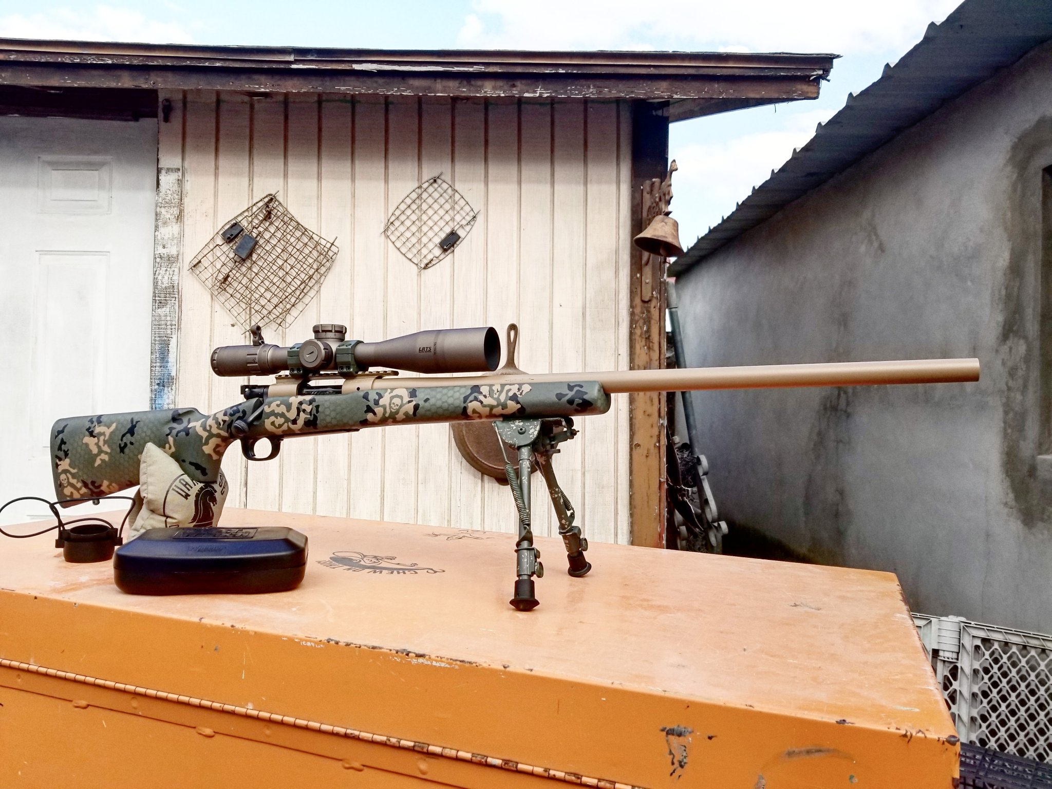

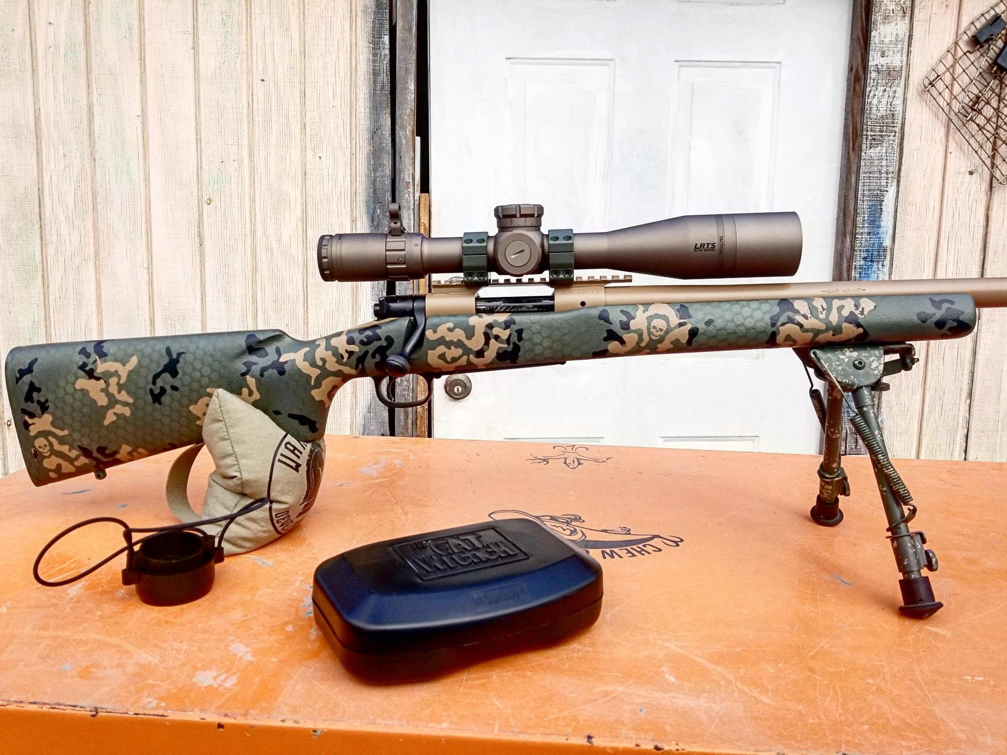

    Paint scheme I will do
    Stock will be exactly like that canteen and barellee action will be solid color in the nutmeg

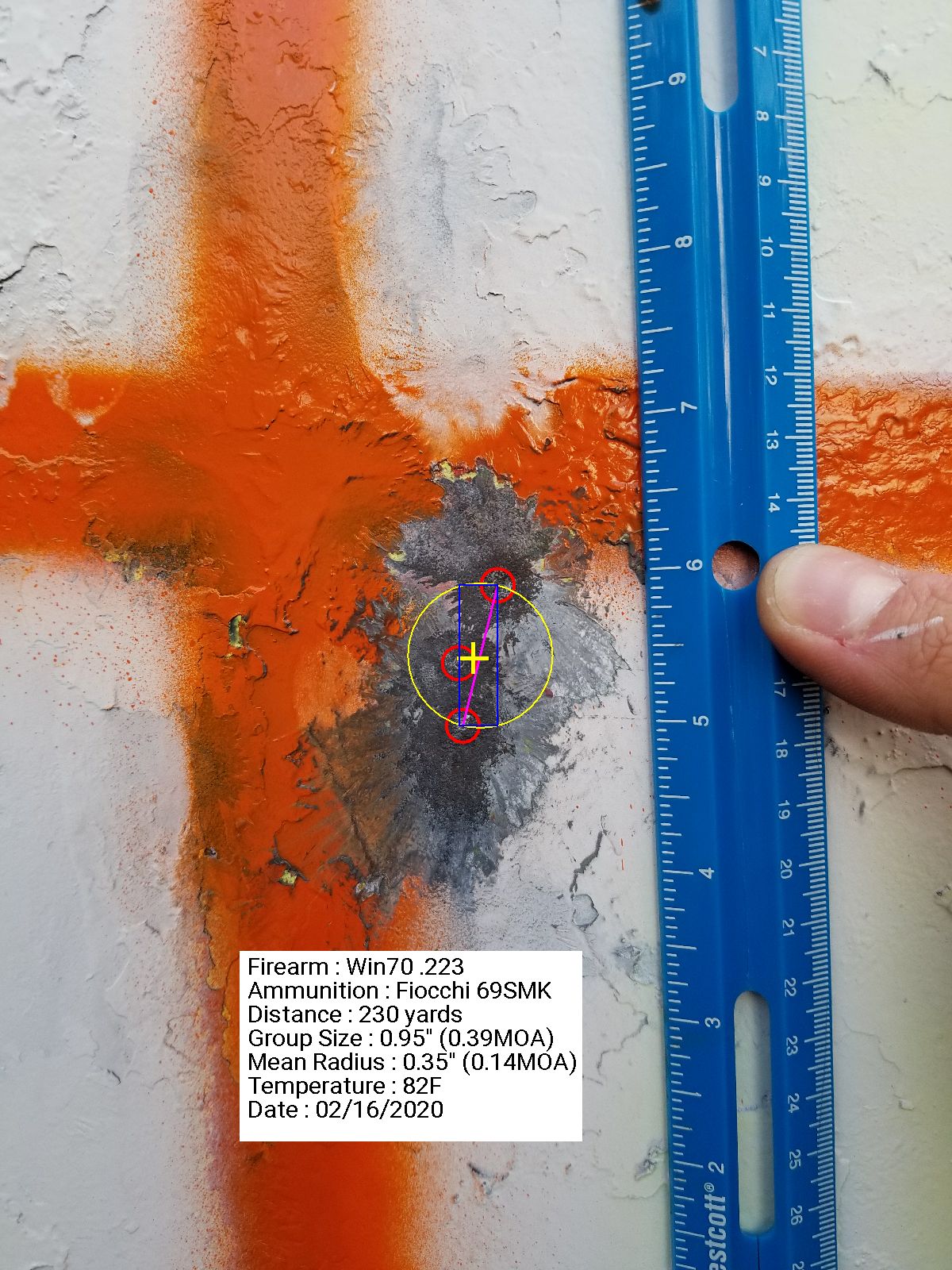

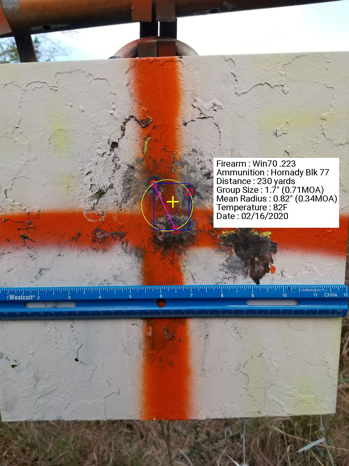

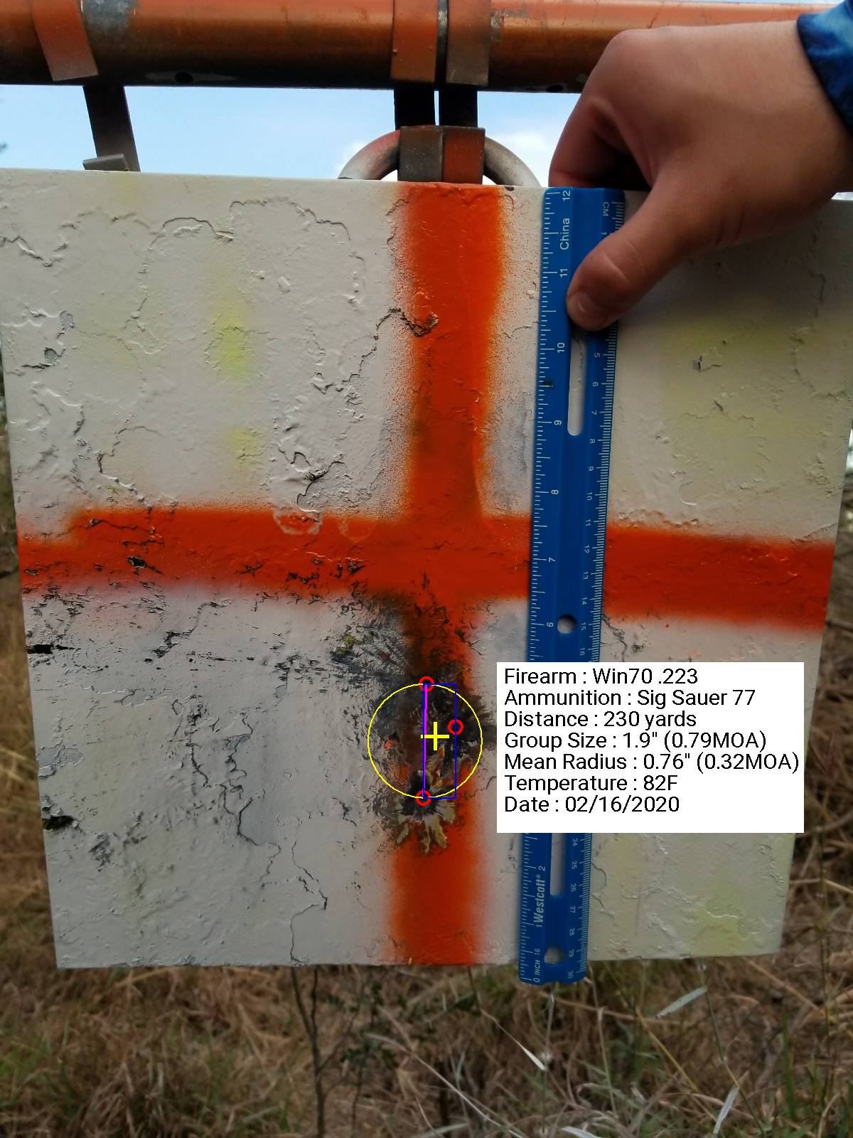

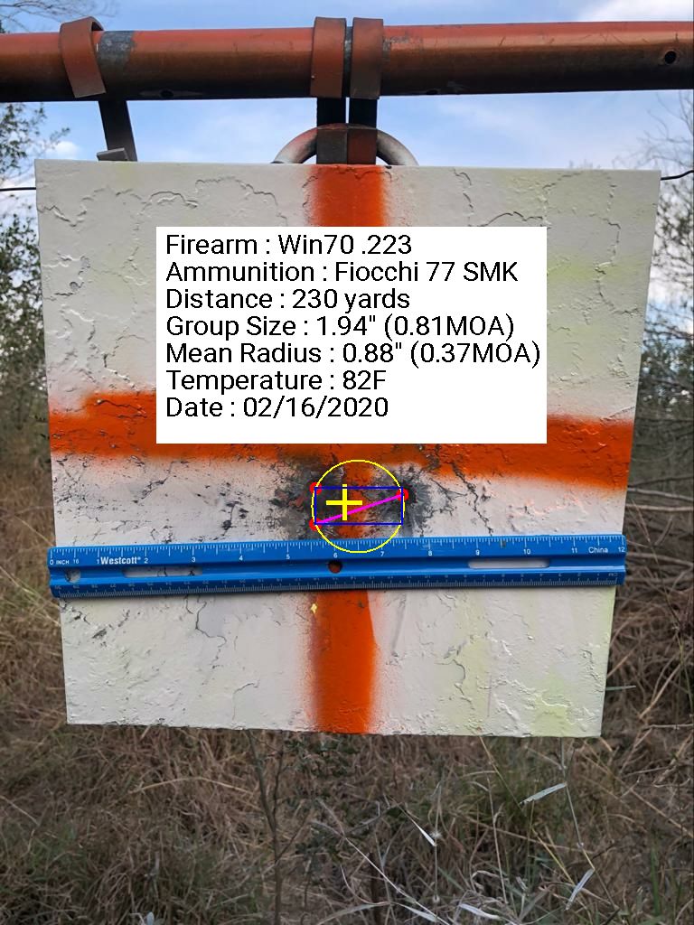

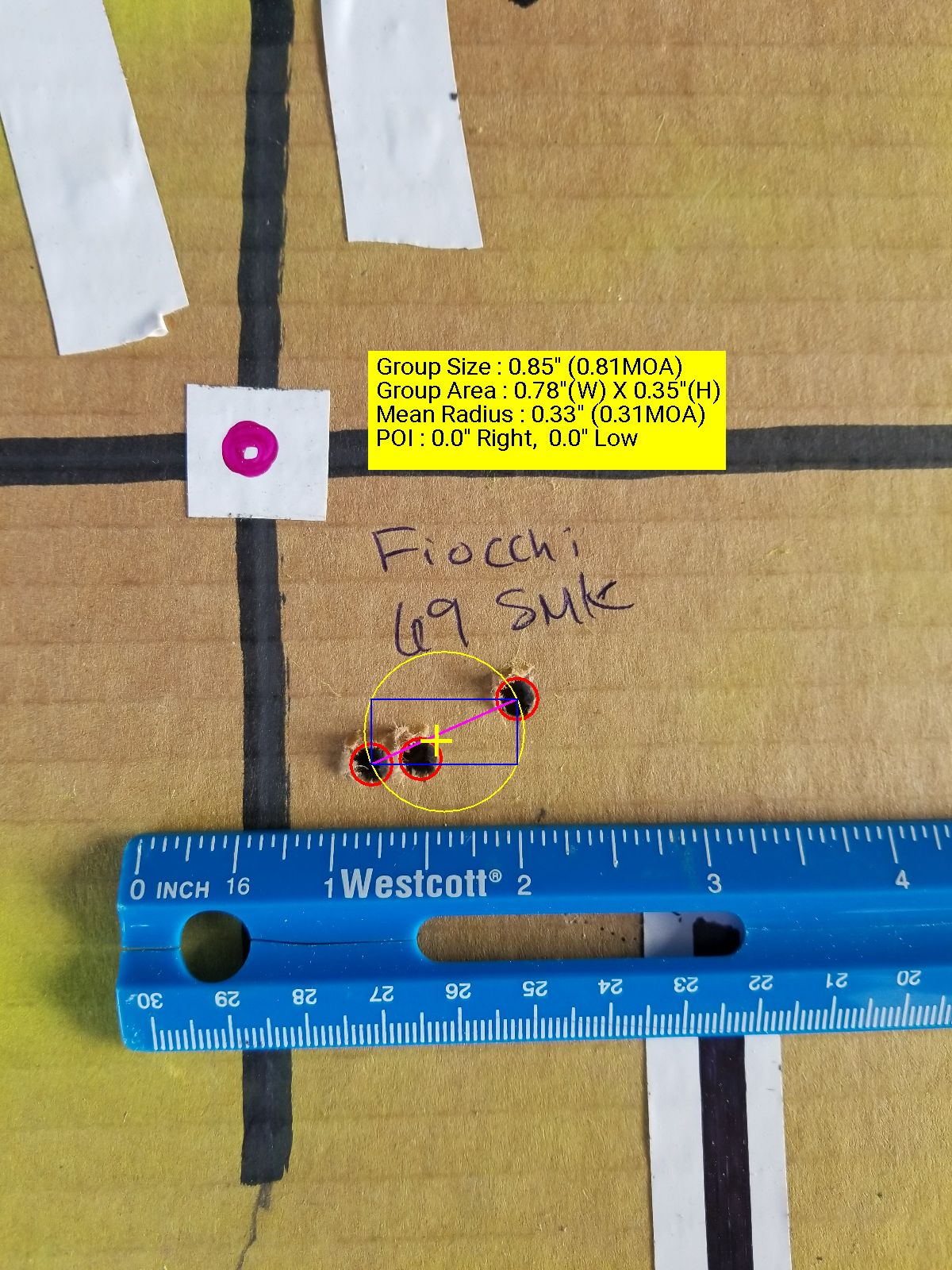

    I tried hornady American gunner in 55 grains, hornady ELDM in 73 grains, and Fiocci with a 69 SMK.
    At 100, the 69 and 73 seemed to group pretty good. The 55s, not so well. However, the 55s were the first I tried and later I came to a conclusion that maybe the rifle shoots better with more copper fouling on it. I say this because the 55s seemed very consistent @ 207 yards, after I had tested and fired many rounds @ 100.
    I then moved out to 370 from a higher elevation on a hill top. We could definitely feel the wind. While all three ammunition types gave me consistent hits on a 12x12, nothing seemed to be dead center like my 6.5 would have been. I got all hits but it was also a huge plate so that doesn't tell me much, precision wise. I think the wind was a big factor. From 370, I could not conclude what was more accurate.

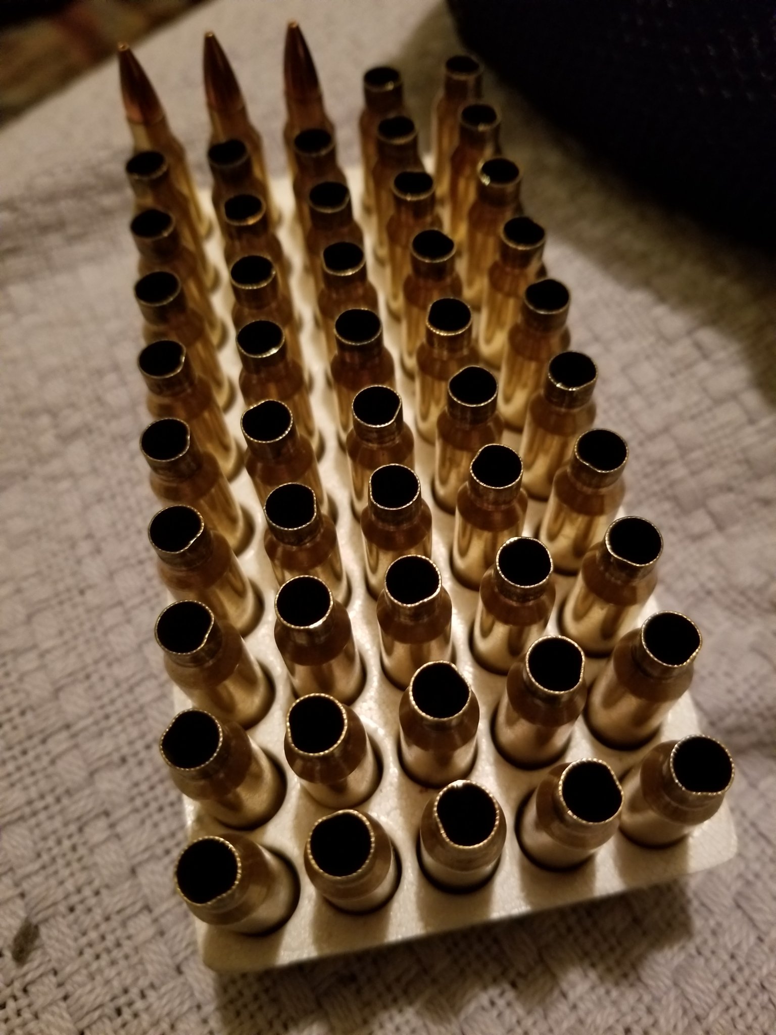

    On the dented neck issue.
    I'm assuming yours is the push feed action.
    If so, it's most likely an overly strong ejector spring.
    It's an easy fix, just like it's done on a Remington 700.
    Takes just a few minutes.

    Is it a push feed, with a spring loaded ejector? If so that is probably just from the brass hitting the inside of the action as it comes out of the chamber.

    BTW,
    When you remove the barreled action from the stock, you might see a glob of bedding compound in the recoil lug area.
    How do I know this?
    Had the same rifle in a 22-250 back in the day and the compound was loose.
    I drove over to H-S and asked Tom Jr about it and he said that Winchester insisted on it, but it was unnecessary, and I could remove it without ill effect.
    He gave me some replacement goop.
    Since mine was peeling out, I removed it and shot it to test it out.

    The case mouth denting is from ejection as several have stated above.
    All three of mine did this until
    a. The ejector spring got weaker.
    b. Tuned the ejector spring.
    It's not really a problem for now. Dont worry about it.

    @Mike Casselton
    Mine shot better fully bedded. There at the end some of the HS stocks were not the best.
    Thanks all,
    So it seems the final conclusion on the dent cases isn't so bad after all and not some thing to worry about.
    @Mike Casselton
    You are right about the bedding. I took the rifle out of the stock. Unfortunately, it looks really nasty in there. To my surprise though, the rifle shot decent for the way it seems to be bedded.
    I know it's tough to judge group sizes with no reference mark. However, the top group is just barely under an inch, edge to edge. Bottom group is closer to half.
    Top group is Fiocci ammo with 69 SMK.
    Bottom is Hornady match with 73 ELDM.
    As far as this nasty bedding job, I like to think that the reason for the bedding block is so that no further bedding is required. Seeing how it did not shoot all so bad, I want to think it should be alright for the rifle to stay as is. The other part in me knows that removing all that bedding compound will make for a much better mate and will not hurt accuracy.
    Thoughts???
    @j-huskey
    This is something I was not aware of, the different twist rates that is. I suppose it's safe to say mine is a 9 twist but I will confirm later today.
    Going back to the bedding, my other option would be to re-bed it but do it properly. I've just never done one and I feel I make things real messy. I'm kinda spent right now so taking it somewhere for a professional bedding is out of the question. I think I will wait a month or so and take it in, once I'm better off financially. Either way, I still had some fun shooting it yesterday out to 370Y.
    @stello1001
    That is not a factory Winchester bed job.
    They bedded the front lug with a clear bedding.
    I have never seen them bed the rear lug (doesnt mean they might not have.) Never seen them use black bedding compound.
    Very much appears somebody bedded the rifle later.
    @stello1001
    My thoughts agree with yours. Winchester bedded just the recoil lug area and nothing in the tang.
    Previous owner's work or some hack gun plumber.

    Everything I shot today was sub MOA. The only exception was Hornady black 77 grains, I had one flier. However, I had been shooting all afternoon long and never noticed fliers so I'm not sure what to think of it.
    Last time I tried a lot of lighter pill loads, today was the heavies.
