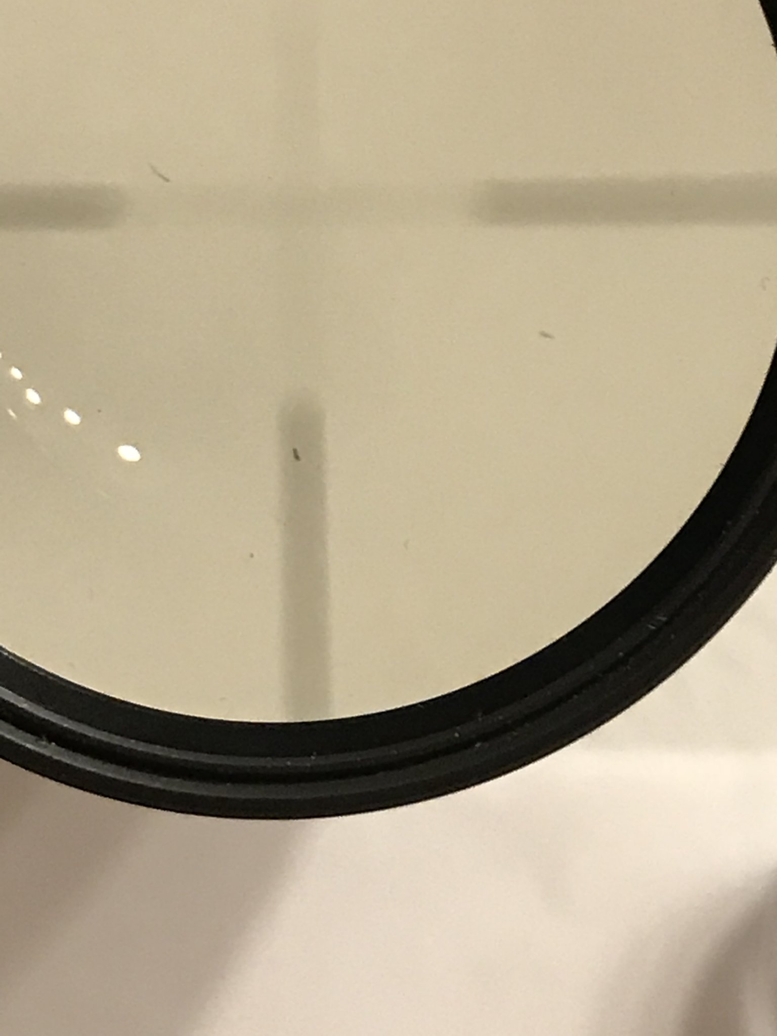

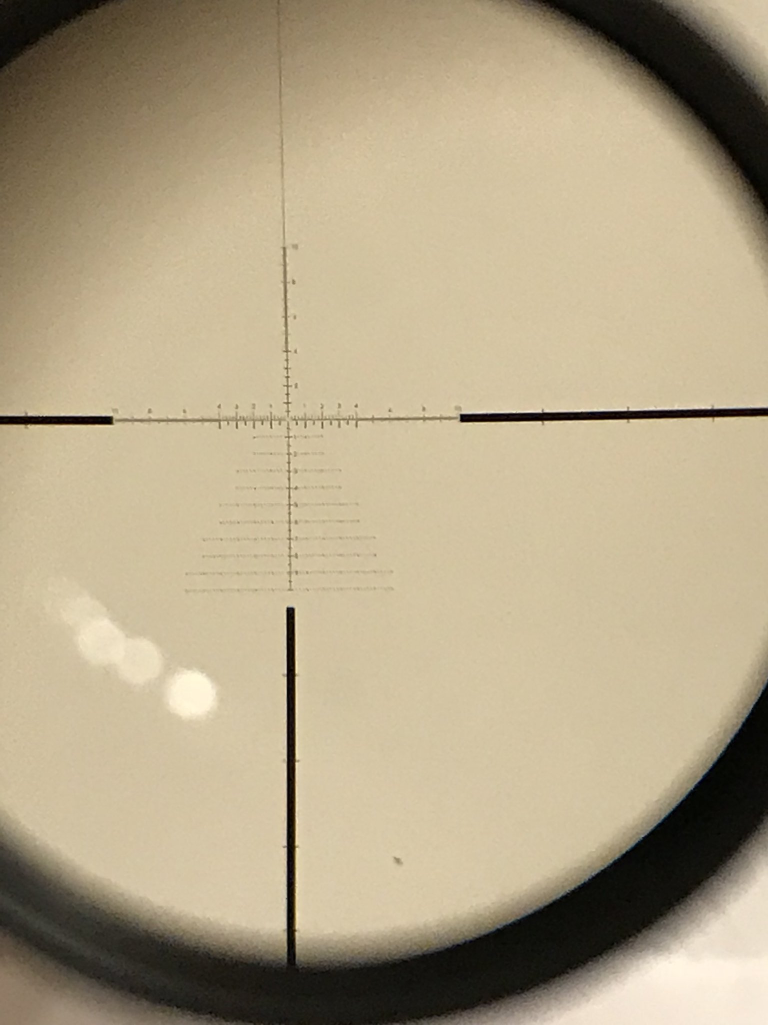

And it’s got debris on the inside... not cool vortex. Anybody know the super secret number to vortex? (Not the customer service # on their website)

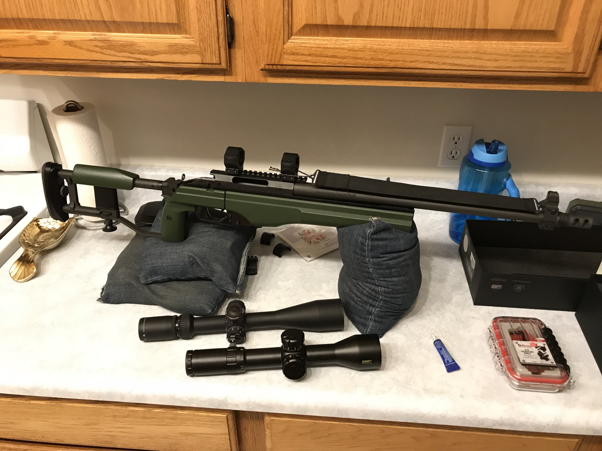

Other than that, I really like it. Turrets are fantastic, glass is excellent,(except for the debris) I’m impressed. I’ve slowly been hunting for that unicorn scope, I think I may have found it. Started with a Burris xtr2, moved on to a Bushnell dmr2i and now the vortex razor amg.

Wow I know things can happen but those are some large dust/debris...and more than one. How did that pass QC? Frustrating but very nice scope. Love the reticle.

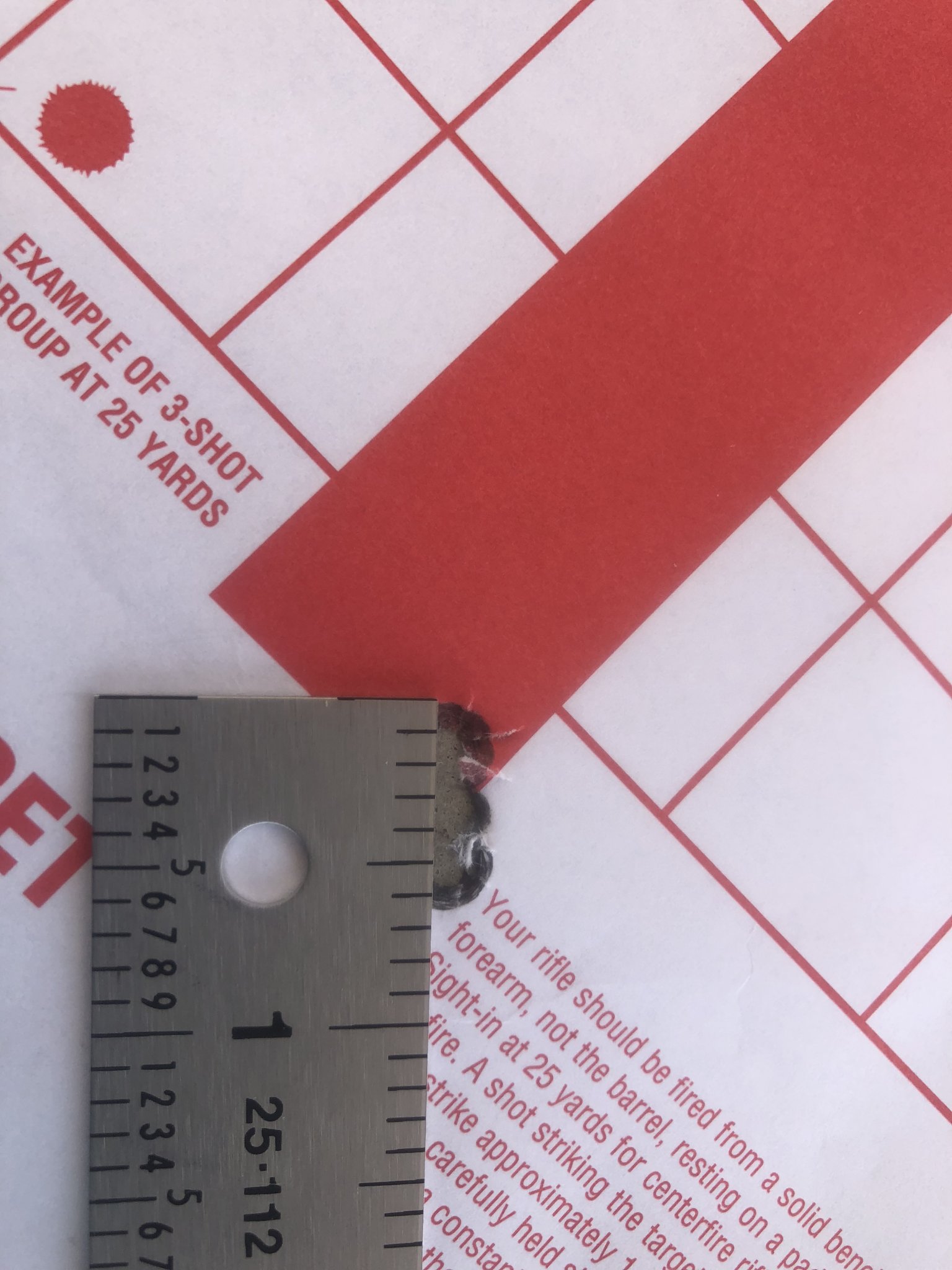

I keep my AMG on my GAP Thunder Ranch. But until I save up to buy more high end glass, I switch it to other rifles. It sits in a Spuhr 3601 Mount.
This is after taking it off the GAP, mounting it on my 223 Wylde gas gun to get 100 yd dope, and then remounting on m GAP, turning dials to zero and shooting 3 rnd group. This was the first 3 shots, so no warm up or “settled in” shots. 168 fgmm factory ammo. Aiming at the corner that was where the middle hole is.
So, you can have full faith in your AMG once you get it right.

Looks like grease spots on a lens. It happens, and more than likely it wasn't there during the process. Send it in, it'll be back in a week or so.
What makes you think it had to leave the factory like that? Rough handling in shipping could have dislodged something from the grease inside on to the lens.

Thanks guys! Dave at Vortex here. I made contact with Mikhailovich and we are going to get this taken care of. Not that this is a good excuse but we have been in the process of moving to our brand new state of the art facility over the last couple of months. We are now fully moved in, as of last week. It's just my speculation but possible with the move something got missed on this scope. In any case, again no excuse, but we will get this taken care of ASAP. I also think our new facility is going to allow us to do even more great things in our industry in the coming years! Thanks everyone!

yea, ive had similar happen with a couple different optics over the years...seems like it always happens on hotter days, like the grease inside gets a little thin after baking in the sun for a while...usually its small specks that i cant even see unless i zoom out to min power, but once i pulled the trigger on my 28 nosler and during recoil a big blob of grease hit right near the middle of the cross hairs lol
One benefit I have is I’m used to looking through dirty or scratched glasses because I’m terrible with them. I just sort of block out the issues. So I would probably do the same on the scope haha.
Practically every scope I've used or been issued had floaters like these. USO x2, Nightforce NXS, Leupold Mark 4 series, Vortex. Nothing so far in my 2 Athlon Cronus BTR's......but that means there will be today when I use it :)
They move around. John Williams, former owner of USO, used to tell people to smack the scope hard and firmly on a phone book to get them out of the way.
I am convinced that the EBR7B is the best reticle right now. So more AMGs for me in the future. I was hesitant when I sold my Kahles k624 to fund it but I have no regrets.
Man that reticle is so busy...I can't help but wish they made an AMG with an MR4/SKMR3, or even just an SKMR.
Got my AMG when my USO went down. Now that I got the USO back I still have my AMG on the rifle. I just can't seem to take it off. I like it a lot and much as any other scope I have used. Tracking and performance is spot on.
The Ebr7b is damn near identical to the mr4!
The EBR-7B is way busier on the horizontal.
The extra hashes at .5 mils are unnecessary. All of the hashes are too bold, too tall, and the numbering at every mil is also unnecessary and distracting. The Christmas tree on the EBR-7B is too wide too soon. Not often you're holding more windage than elevation. Another thing that bothers me on the EBR-7/7b is the numbers on the vertical being up against the main line rather than at the end of the tree.
The perfect reticle IMHO would be an MR4 with one down, two up, one down windage hash marks like the SKMR3 and Mil-C. But that's an incredibly small complaint. Everything else about it seems just perfect.
I actually like the cleaner center of the EBR-7 in comparison to the EBR-7B, but it does complicate small wind holds since your reticle goes out .3 mils.
The problem is that even though I have some reticle complaints, it's still a decent reticle and everything else about the AMG is just fantastic. Glass quality, turrets, eyebox, weight, illumination are all top notch. It's a ridiculously nice scope.
I would love to get an AMG, but I don’t care for the ebr7 reticle. The 7b is a little better with the small center dot, but I wish they would’ve just stuck with the ebr2c reticle. Love that reticle! Nice and clean, open center, and it just looks a lot less cluttered to my eyes. If they put that reticle in the AMG, I’d get one for each of my long range rifles.
I could live with the EBR-2C with a floating dot instead of an open center.
