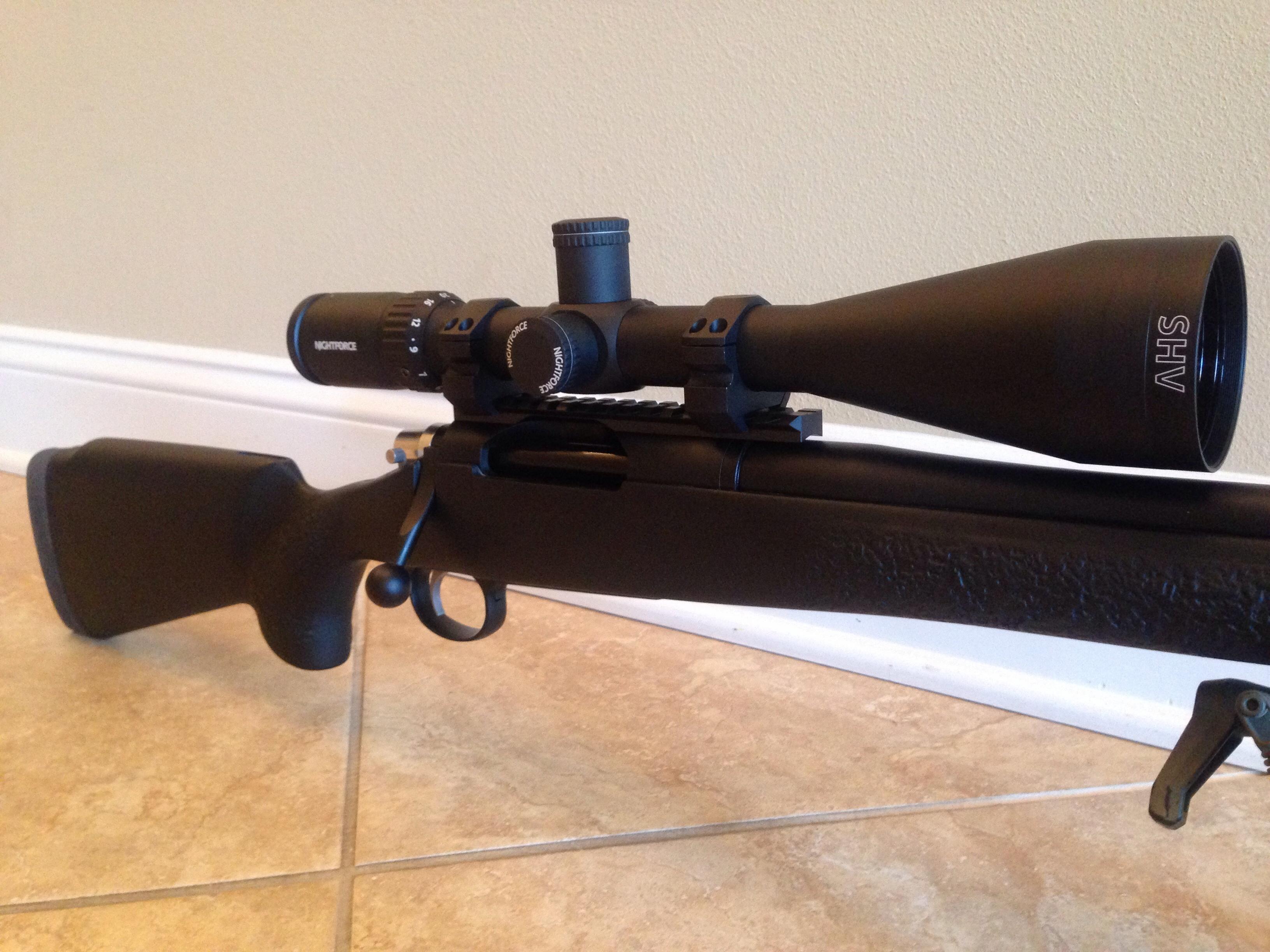

I spent another weekend with Robert to learn a little more on what it takes to build a one hole rifle.
Saturday morning came early....4:00 am we were in the shop getting ready. We went over lathe setup and how extremely important it is to have your lathe setup correctly.

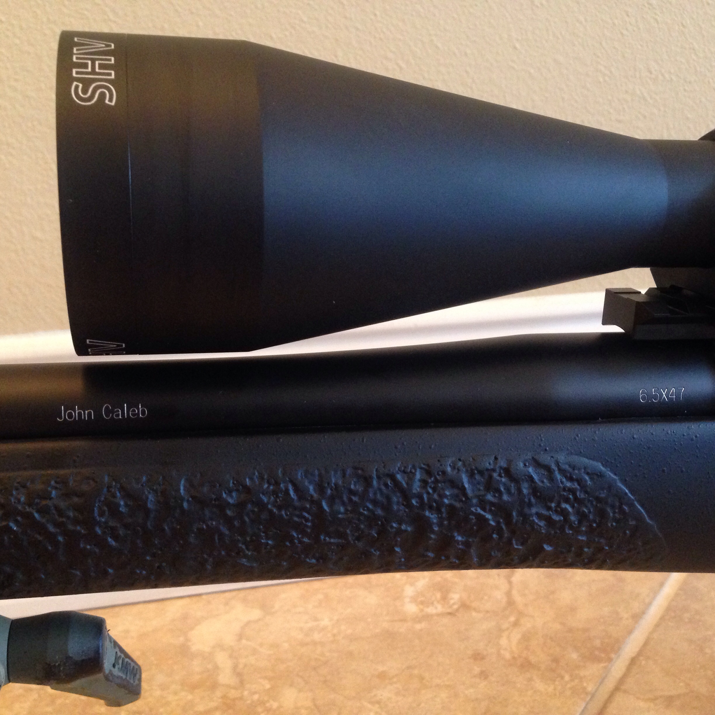

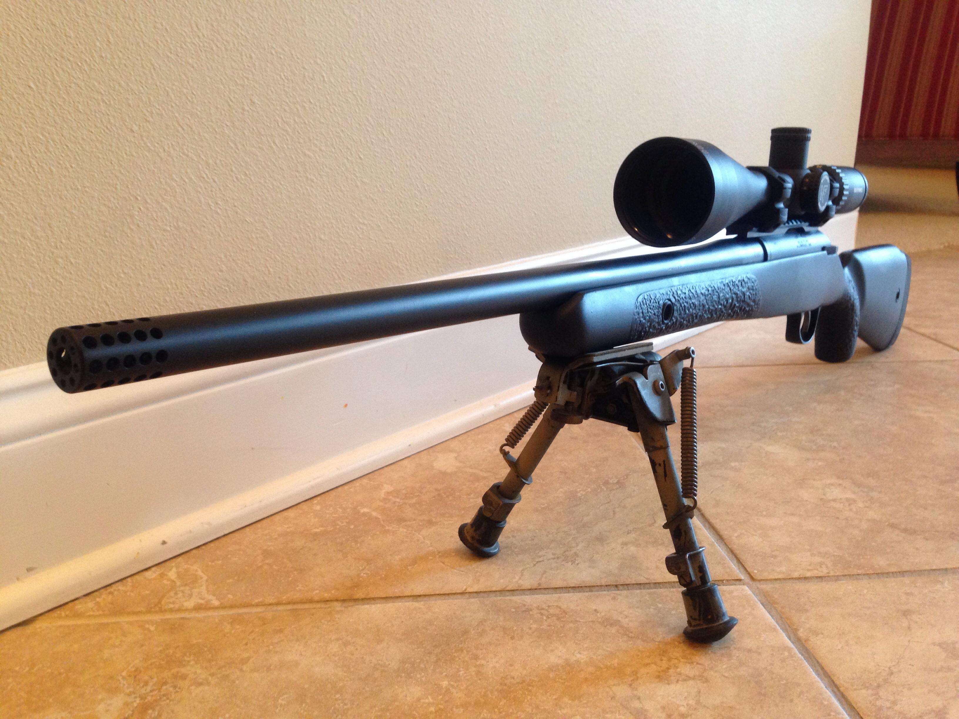

Before breakfast I had my barrel dialed in correctly (within .0001) and had the barrel chambered in my favorite cartridge..The 6.5x47. After breakfast I installed a Vias brake and turned the brake down to match the contour if the barrel.
We fit the stock to the barreled action and then coated the metal in ceracote. After drying and a cool down period we bedded the barreled action into the stock. Then it was time to eat and watch some football?
The next day we were greatest by Jered Joplin from American Precision Arms. Jered arrived just after we had popped the action out if the stock. We cleaned up the bedding with the mill and Jered helped us assemble the rifle so they could take a short break to put some fish on the table.
This rifle is for my 7 year old son. My mission is to put him on as many deer this year as possible. I owe a big thank you to Robert for taking me under his wing going on two years ago. He continually builds me the quality of rifle that I'm looking for. Which is a .1 or less rifle. That's my guarantee from him or I send mine back....I just haven't had to send one back yet! ( this makes #6)
Thank you Robert and Jered! You are both class acts
Specs
Kelbly Atlas action
Bartlein #3 contour 20 inches plus vias brake
Manners EH3 with ADJ Spacer system
BDL
Jewell trigger
Nightforce 5x20 SHV
APA rings

Most of these parts were picked up at matches. That's the good thing about shooting his rifles
