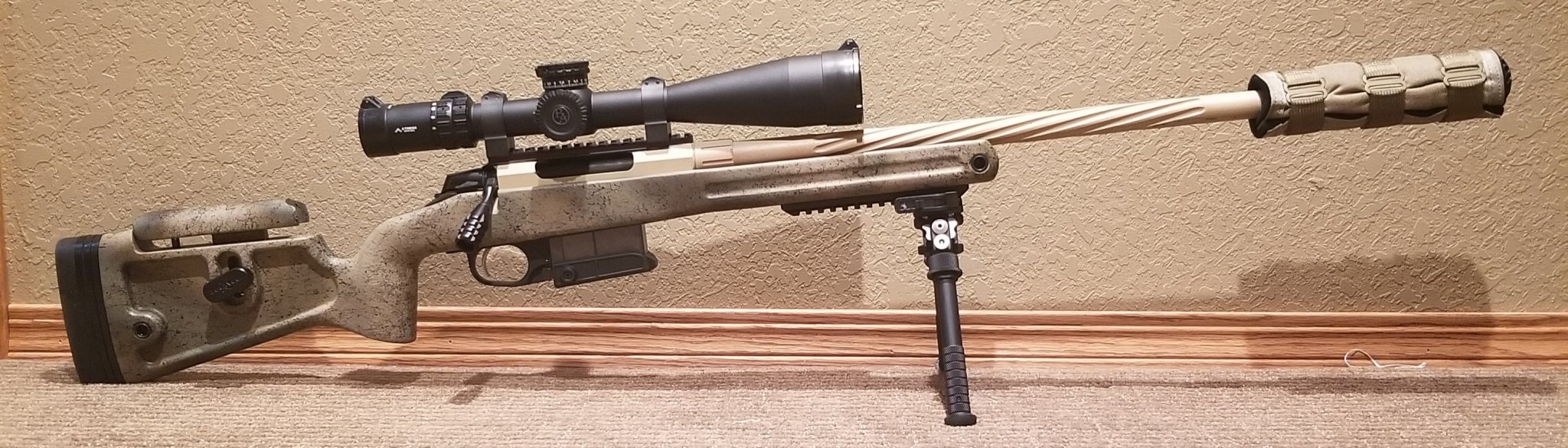

    Mine was delivered today
    Order Feb 22
    Ship date May 6, delivery on 11th
    Weight was 33oz AFTER I installed a seekins precision 13 slot rail on the MLOK. 10oz lighter than the B&C M40 I was using.
    There was paint/material on top of the pillars that made a notable mush when attempting to torque action screws, I had to chip that off. It doesn't seem like the pillars run all the way through either to the bottom metal. Dont know if they are supposed to or not? And they are fairly oversized to the action screws as compared to the B&C stock? Time will tell I suppose if thats an issue.
    A little flex in the fore end, but no more than the previous stock. Non issue for me as long as the whole system can still sling bullets well. Cant wait to use it, definitely a better fit to me and more comfortable.
