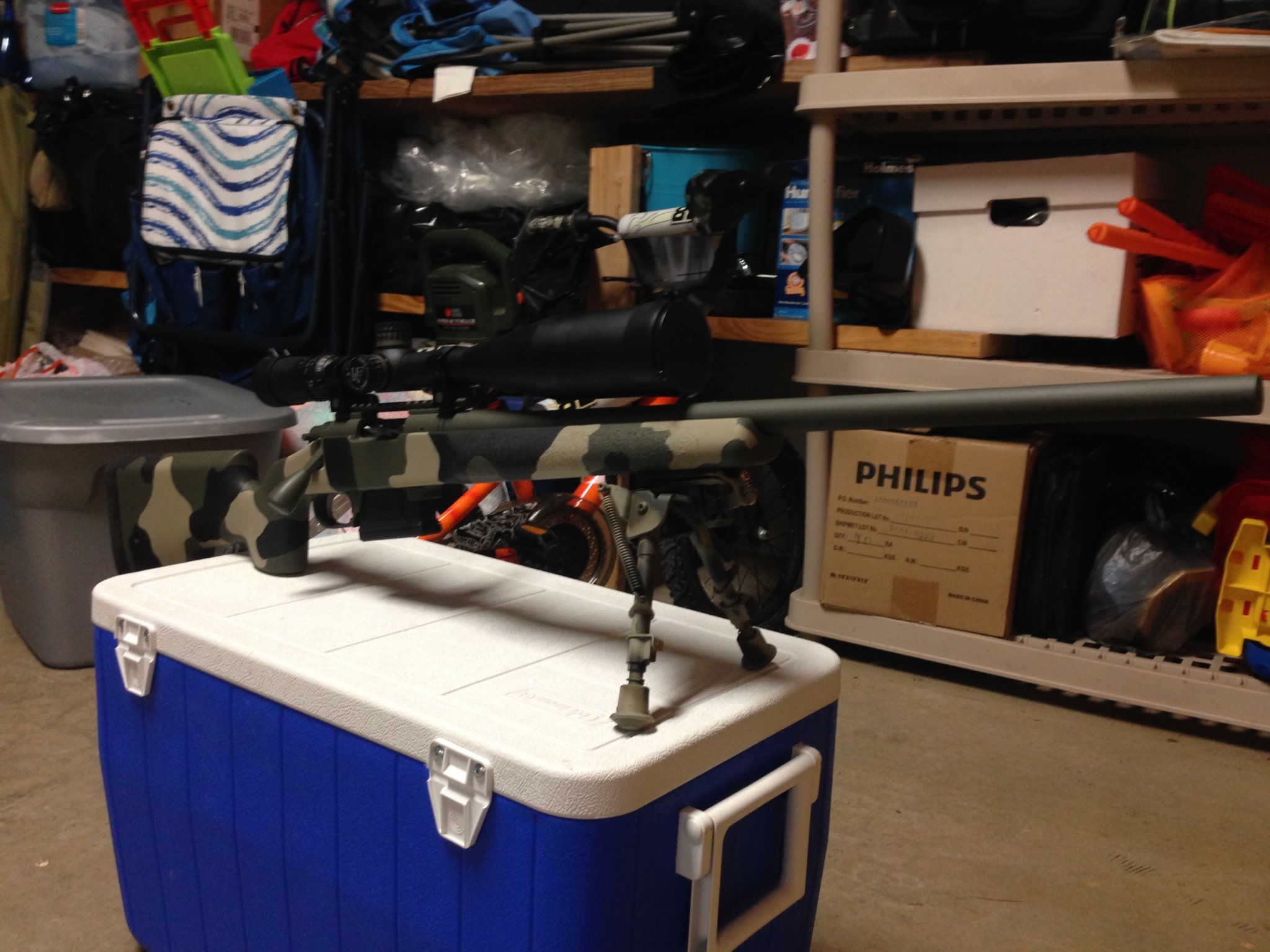

Hard to beat them for the price point for me. Wasn’t big on the Camo pattern it came with so gave it a krylon makeover. Bedded with Devcon to a factory Remington 5r mil-spec barreled action. 1/2 moa shooter. I’m pleased with it and have had McMillans as well. I’ll likely own another grayboe soon
