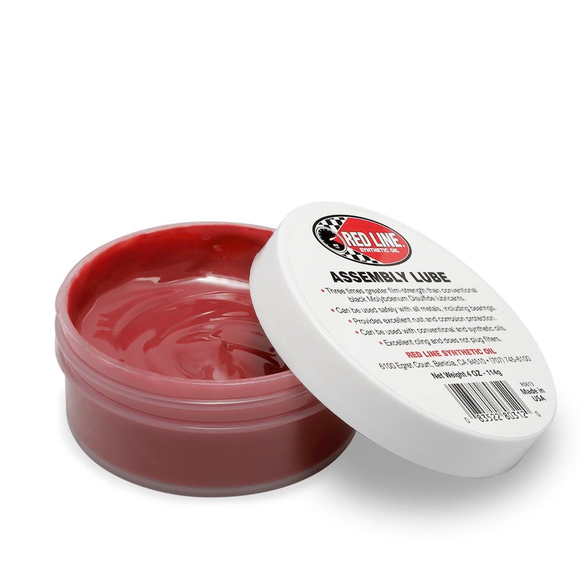

Best stuff I have yet to find, full synthetic and has tons of molly in it, stays put like it is suposed to in race engines it was designed to be used in. Thin enough not to give you problems when it's cold out.

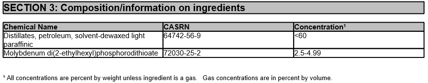

This is very good assembly lube & I use it sparingly on high pressure points for new bolt lugs & cocking cams.
It is not full synthetic. As can be seen below it's Petroleum based with light paraffin + Moly. This is actually better for high pressure or point contact situations where mating/break in needs to take place.

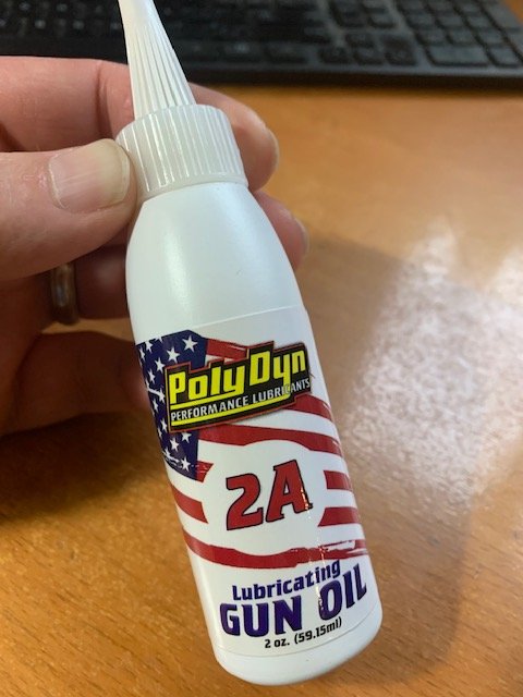

Another newer option is the PolyDyn 2A Lube. It's very good. Polymer based & formulated specifically for firearms applications. It stays put better then anything else of similar viscosity I've tried. I've been using it on bolt lugs & pistol slides about a year now. Also great for things like adjustable gas blocks etc.
I think the only place it's available is amazon.
