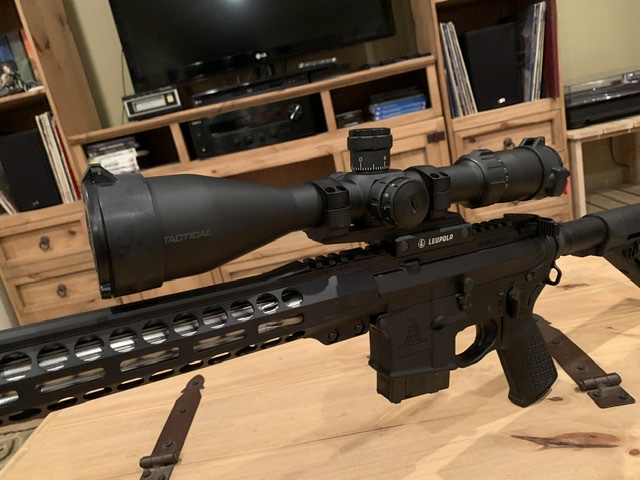

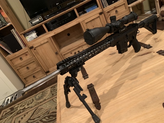

Didn’t know where to put it so I’ll just put it here.
Grendel Hunter upper with 20 in bbl. It is their brake. Spikes Tactical lower with Geissele two stage trigger. Aero Precision BCG. Weaver Tactical 3-15 FFP with illuminated EMDR reticle. Really a great optic for $500 from Natchez Shooters Supply. It is a Satern bbl. Pretty accurate with Hornady Black ELD.
Reactions: bobke
So far all I have done is zeroed it at 100 yard indoor range. Got to get to the outdoor range.
Nice build. Is that a Satern/Liberty or one of their cut rifled barrels? Will you be reloading or shooting factory ammo? If reloading, have found AR Comp to be very forgiving and even tempered in my Grendel’s. Give your barrel some range time to settle in, accuracy seems to stabilize once you have 50-75 rounds down range. Well done at the front end, and the Weavers are a value, as you’ve noted.
Reactions: army_eod
By the way, that brake is very effective at recoil reduction and is not really loud. Of course, the rifle as you see it approaches 10 lbs. So no recoil anyway.
Classy looking Grendel.
Mine are a bit more conventional looking, a 20" and a 24', both with AR Stoner (Satern/Liberty?) barrels. The 20" is an off the rack AR stoner Upper, the 24" is a homebuilt employing AR Stoner components exclusively. The bores of the barrels scope out as just plain beautiful.
