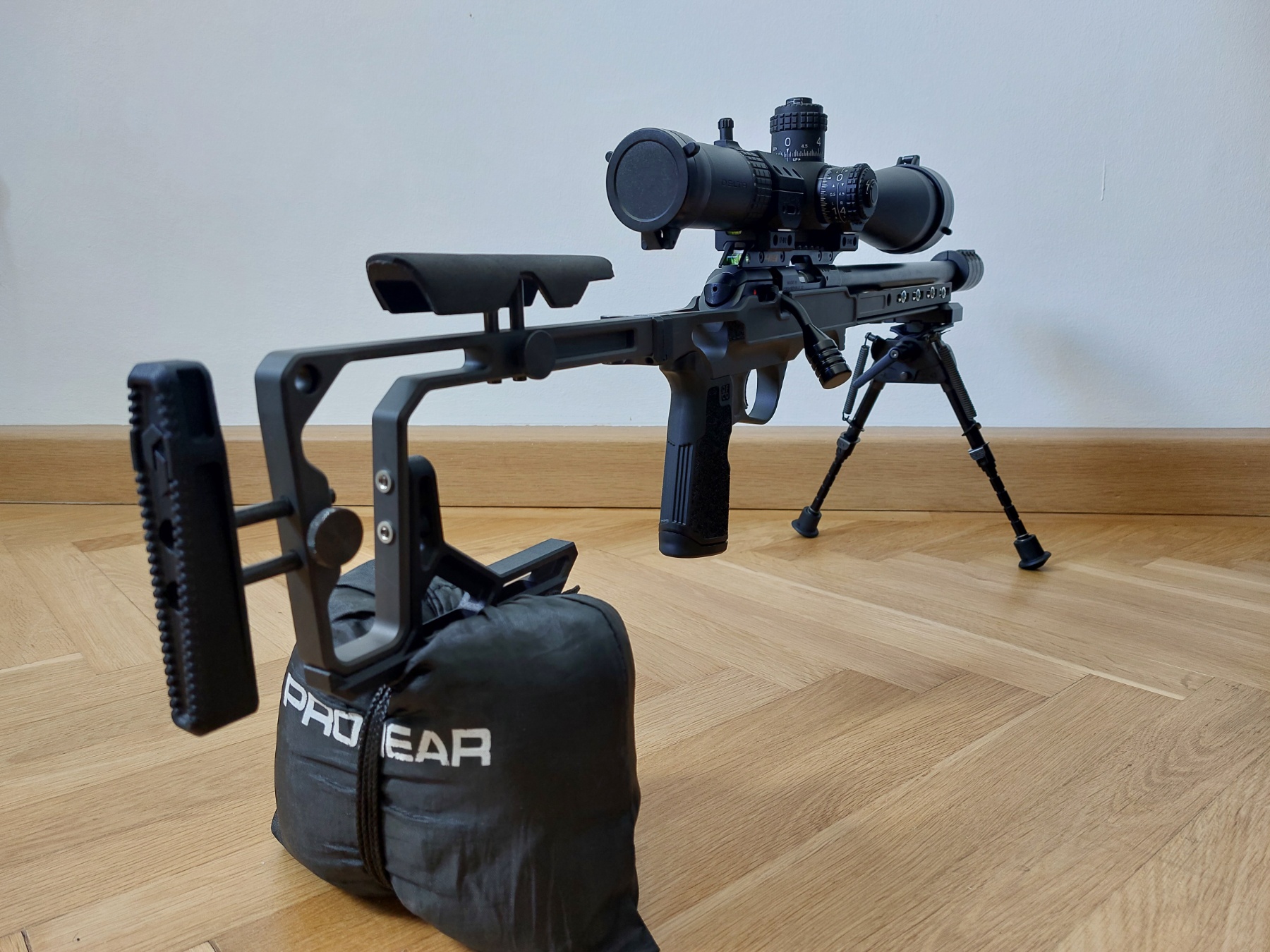

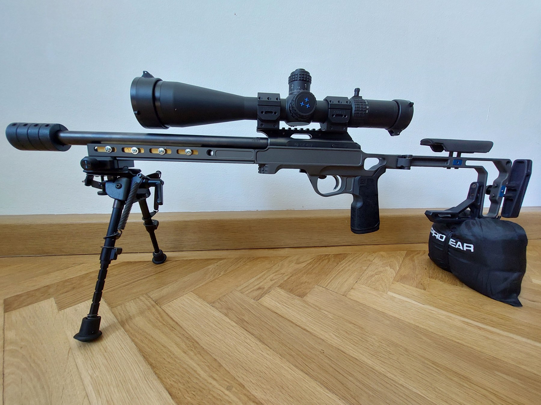

    I have the Grey Birch LaChassis for T1X chassis, and use it for both PRS ELR and STAG competitions in Ireland (Republic). I purchased it on Brownells Germany website and have been running it for almost a year.
    I wrote an initial impressions review a while back in FB.
    In short, it's pretty nice and light, which meets my requirements for STAG shooting competitions (no sling allowed for standing or sitting/kneeing positions). Plus it's stable and has many features that supports my PRS ELR shooting (although you may need to add some M-LOK weights). I like it (except for the price... about 20% more expensive than an MDT LSS-RF build but lighter weight).
    Let me know if you have any specific questions about the chassis. Cheers!

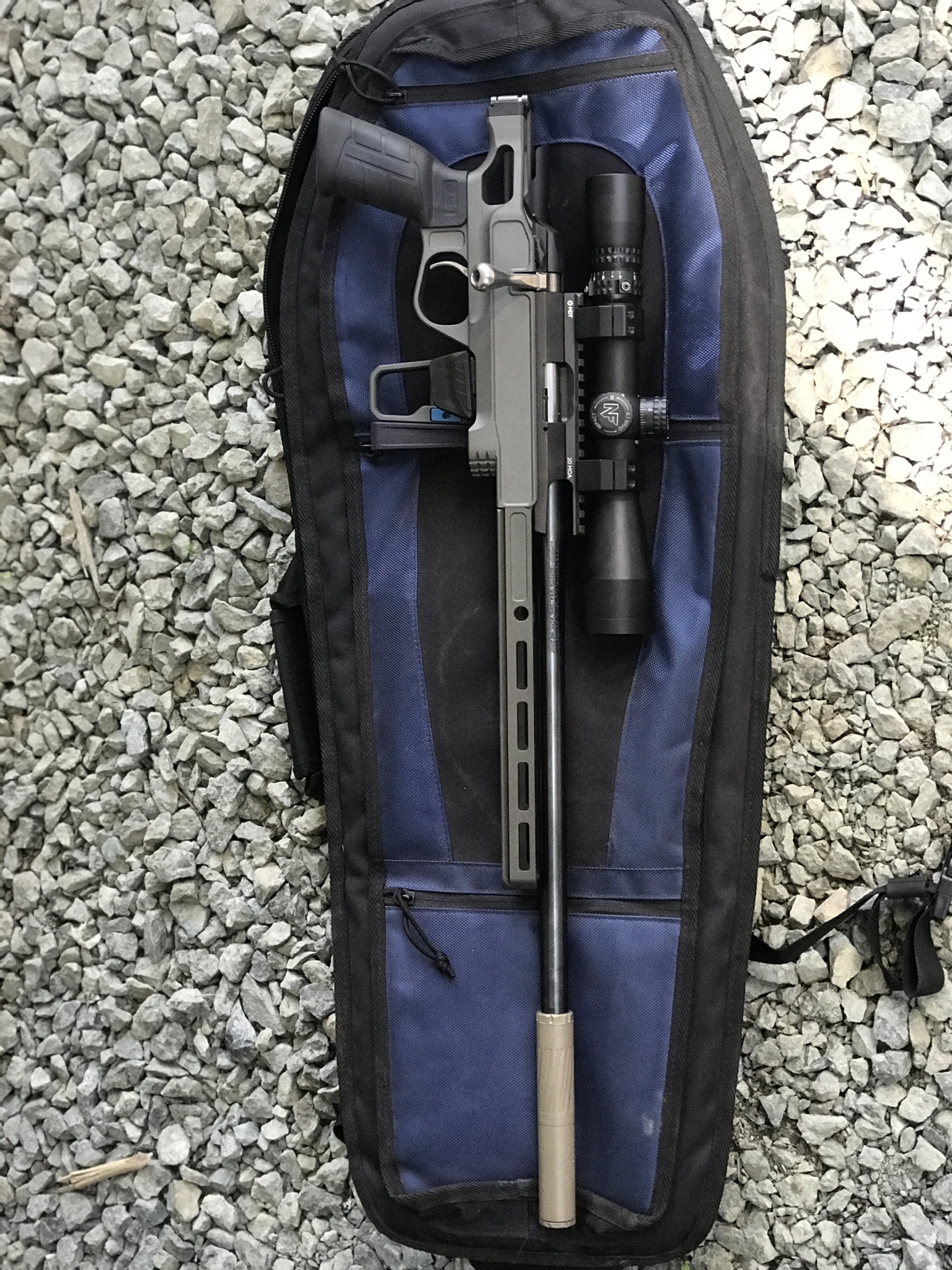

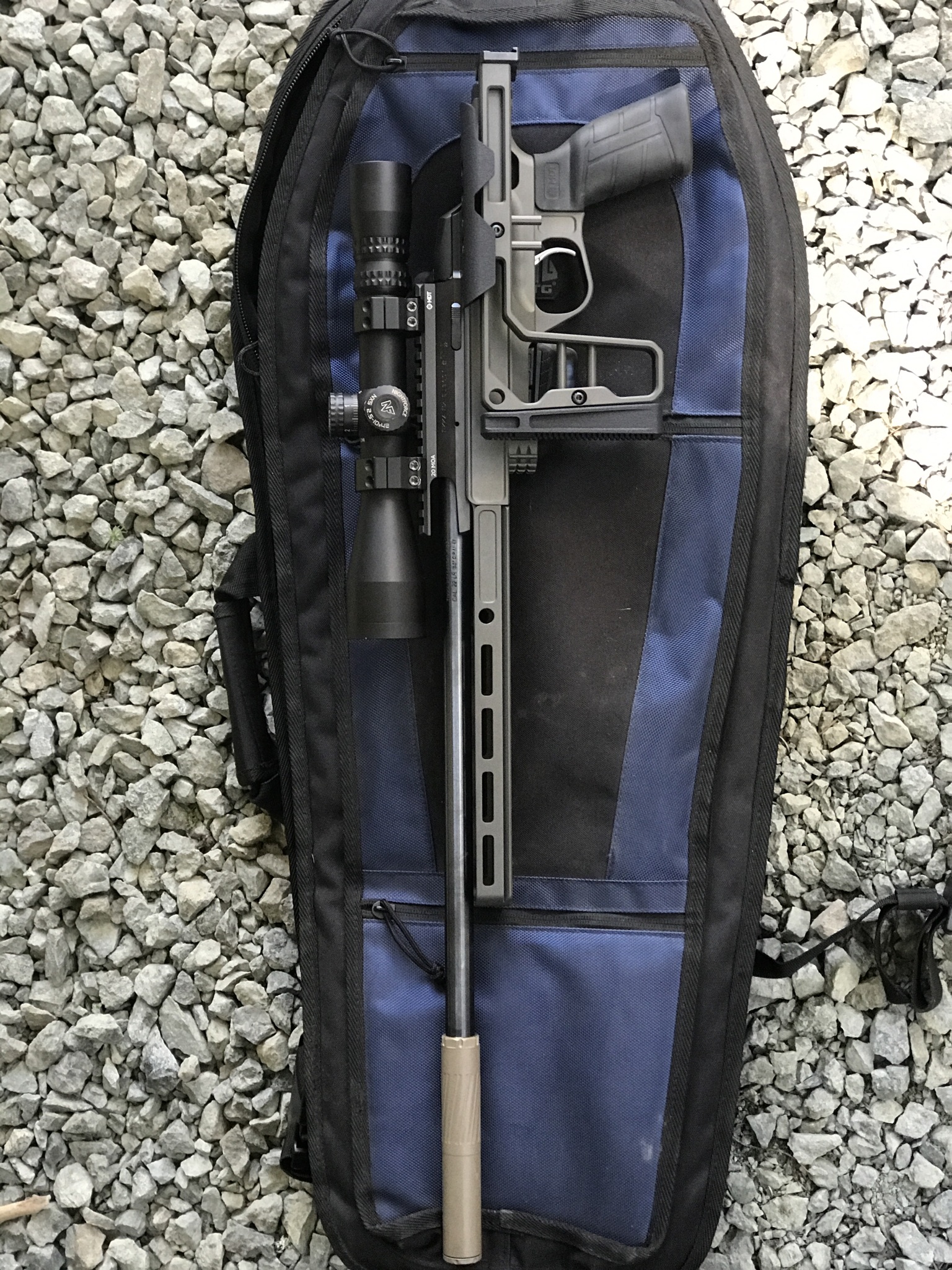

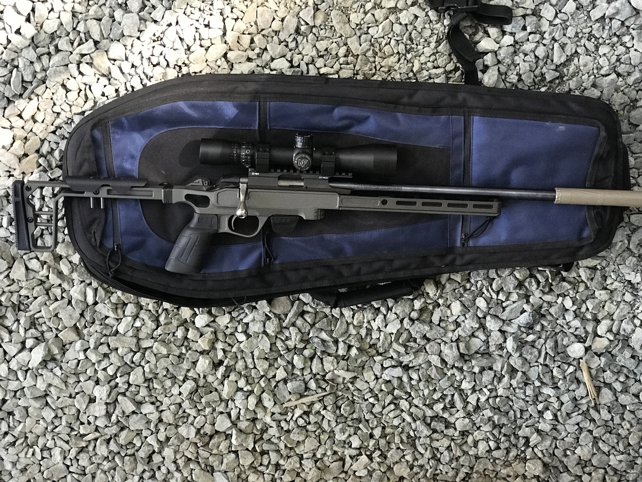

    Quick follow up for anyone else interested in this Chassis,
    After a quick trip to the hardware store to get the missing screws I put everything together and added my B/A.
    Everything went together very easily and functions well.
    A trip to the range showed almost no change in zero and accuracy at 50, 100, 200 yds was as good or better than before.
    The whole package as pictured with NXS 2.5-10 weighs 7lb 15oz and is very comfortable to carry and shoot.

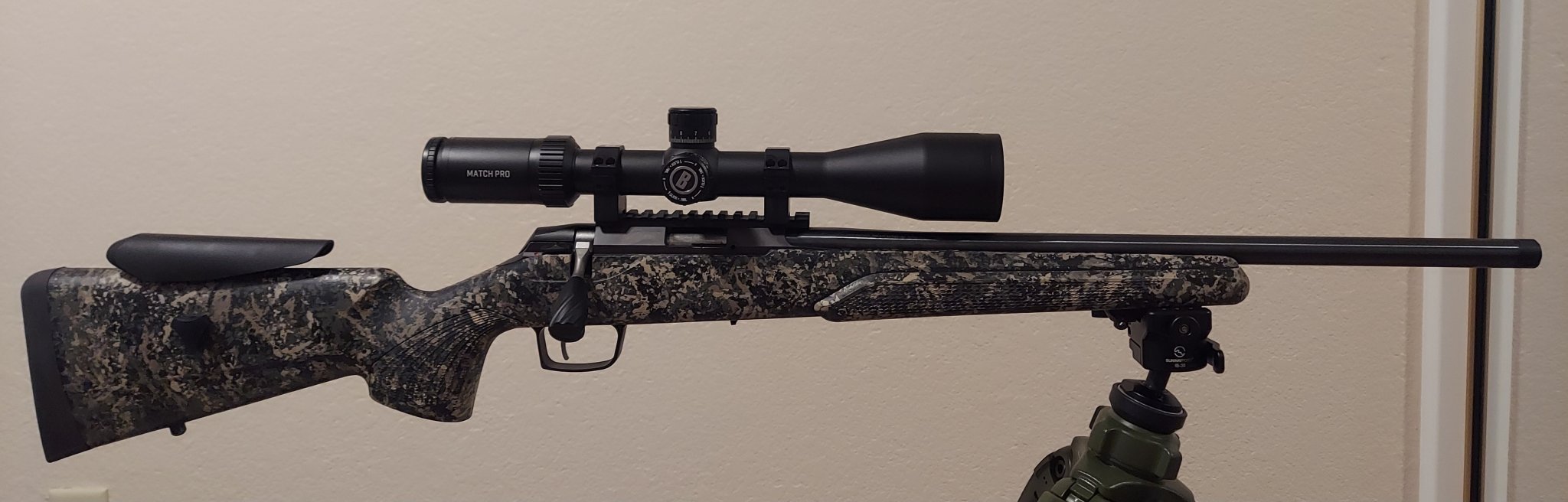

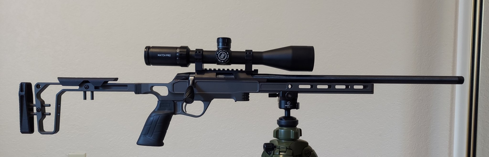

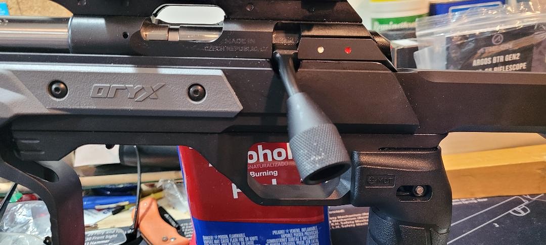

    From this:
    To this:

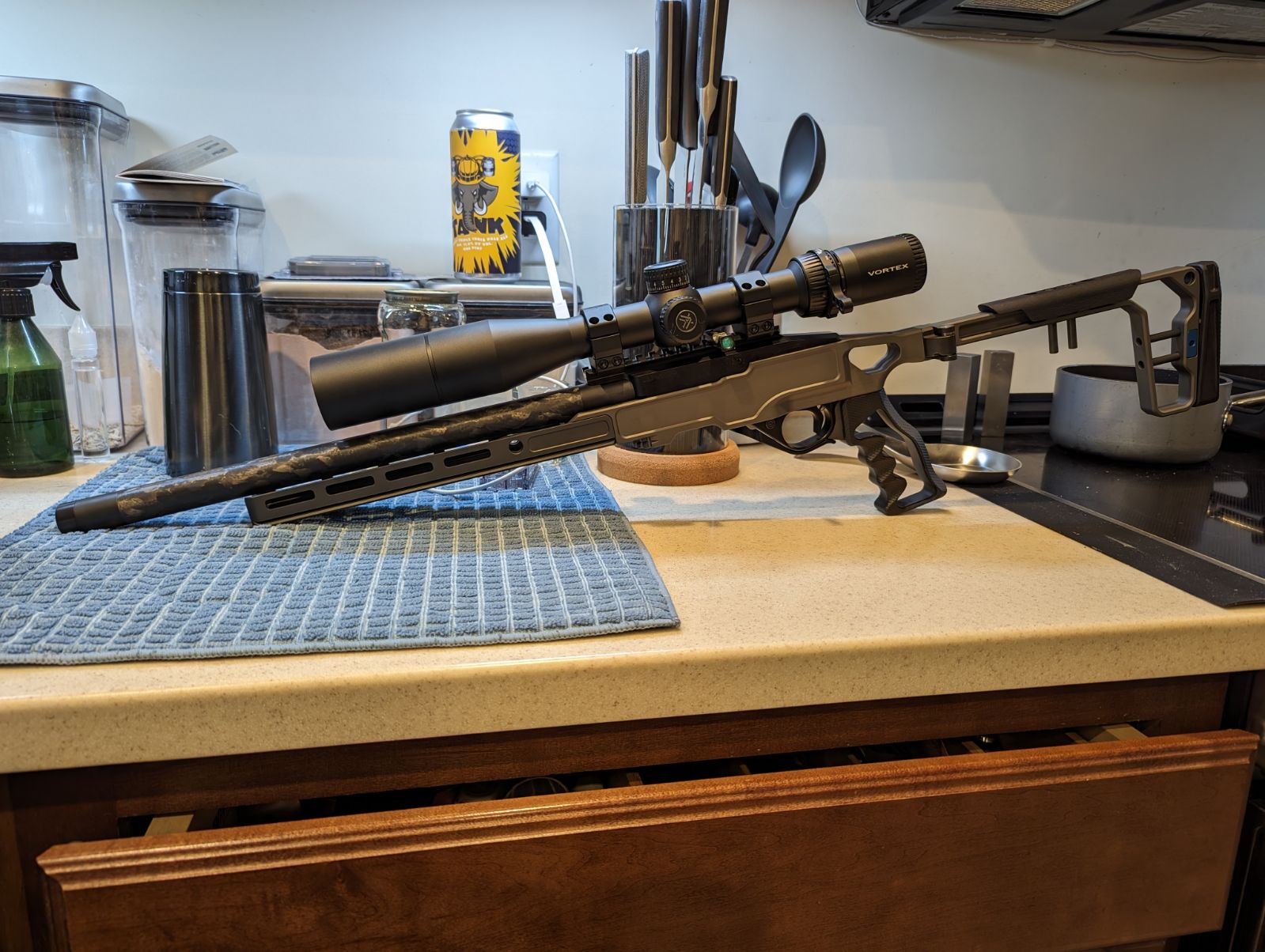

    I just installed into the chassis today but it's too damned hot to go shooting here in Phoenix. So far it feels nice though. One thing that wasn't too impressive was the missing hardware. I had to go to the local ACE Hardware and buy the screws to attach the forend and both action screws as well as one of the trigger guard screws.

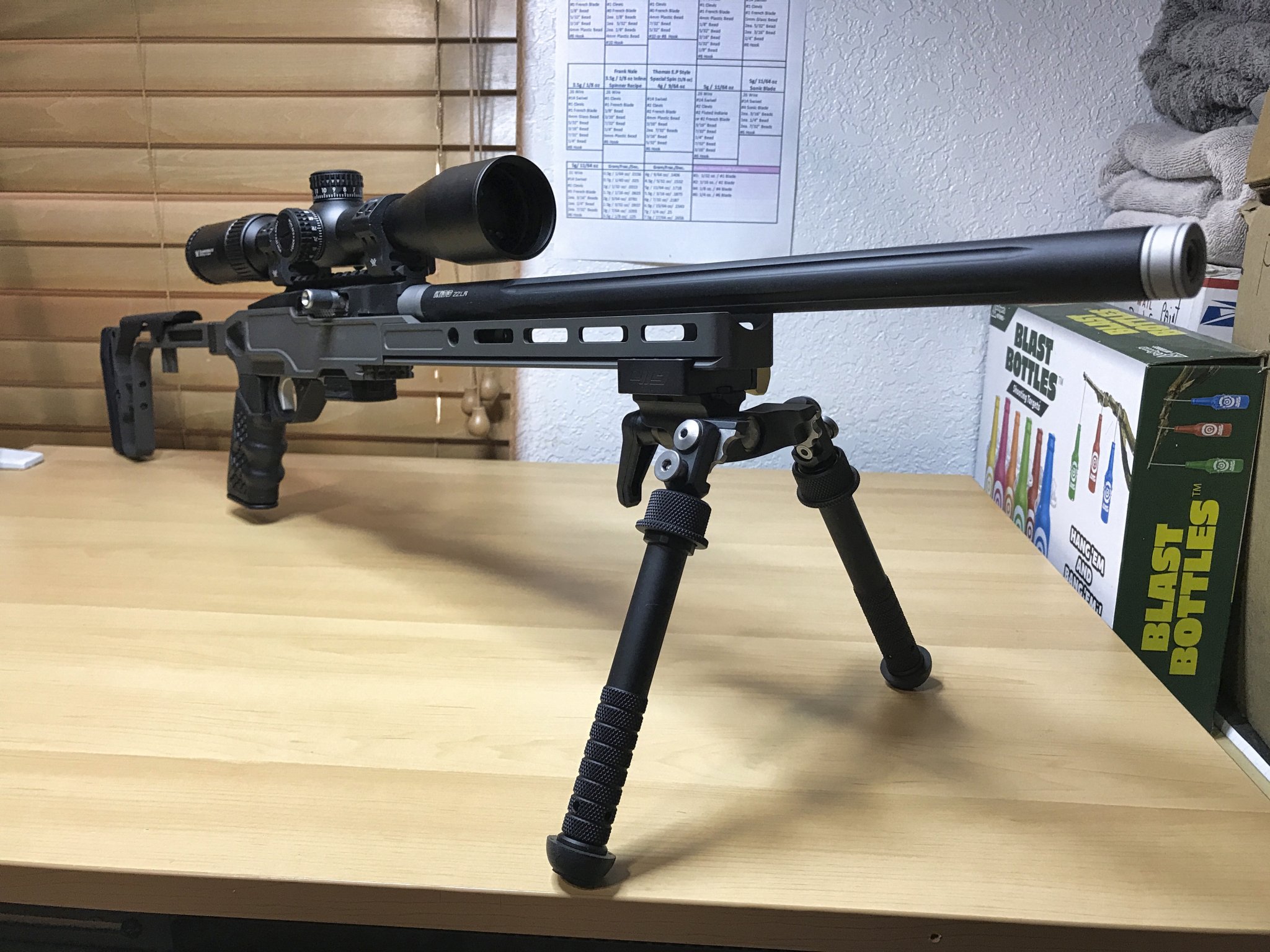

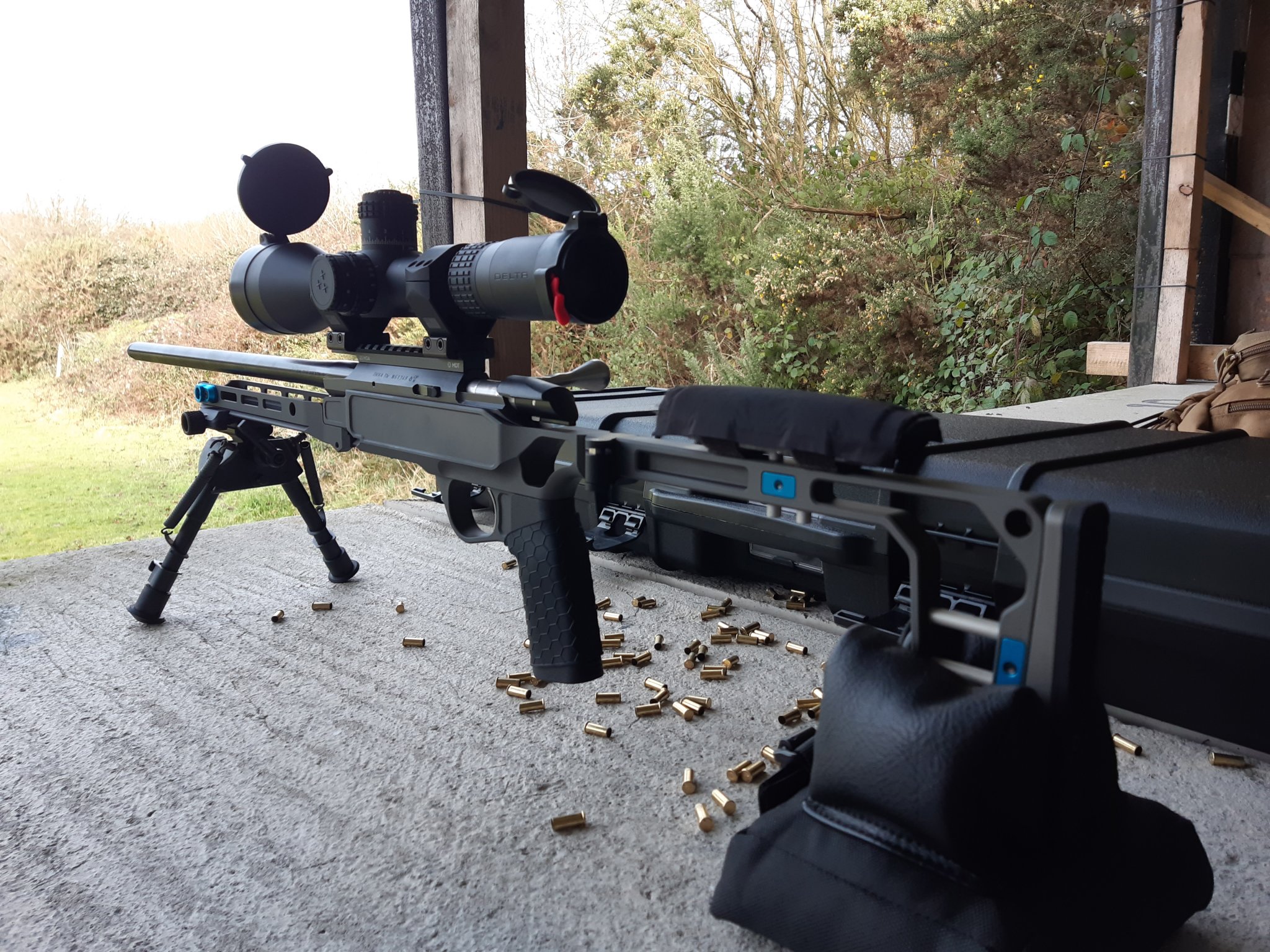

    My only complaint was the cost of the chassis,... especially compared to the price in the US. It's far more expensive in Europe in Euro.
    Mine came with all the parts from Brownells Germany,... except the Grey Birch sticker,... but I got the Grey Birch 5-degree angled pistol grip instead (it was stated that the pistol grip was not included). Sorry to hear that you had missing parts.
    Enjoy shooting with your new chassis (looks very nice)!

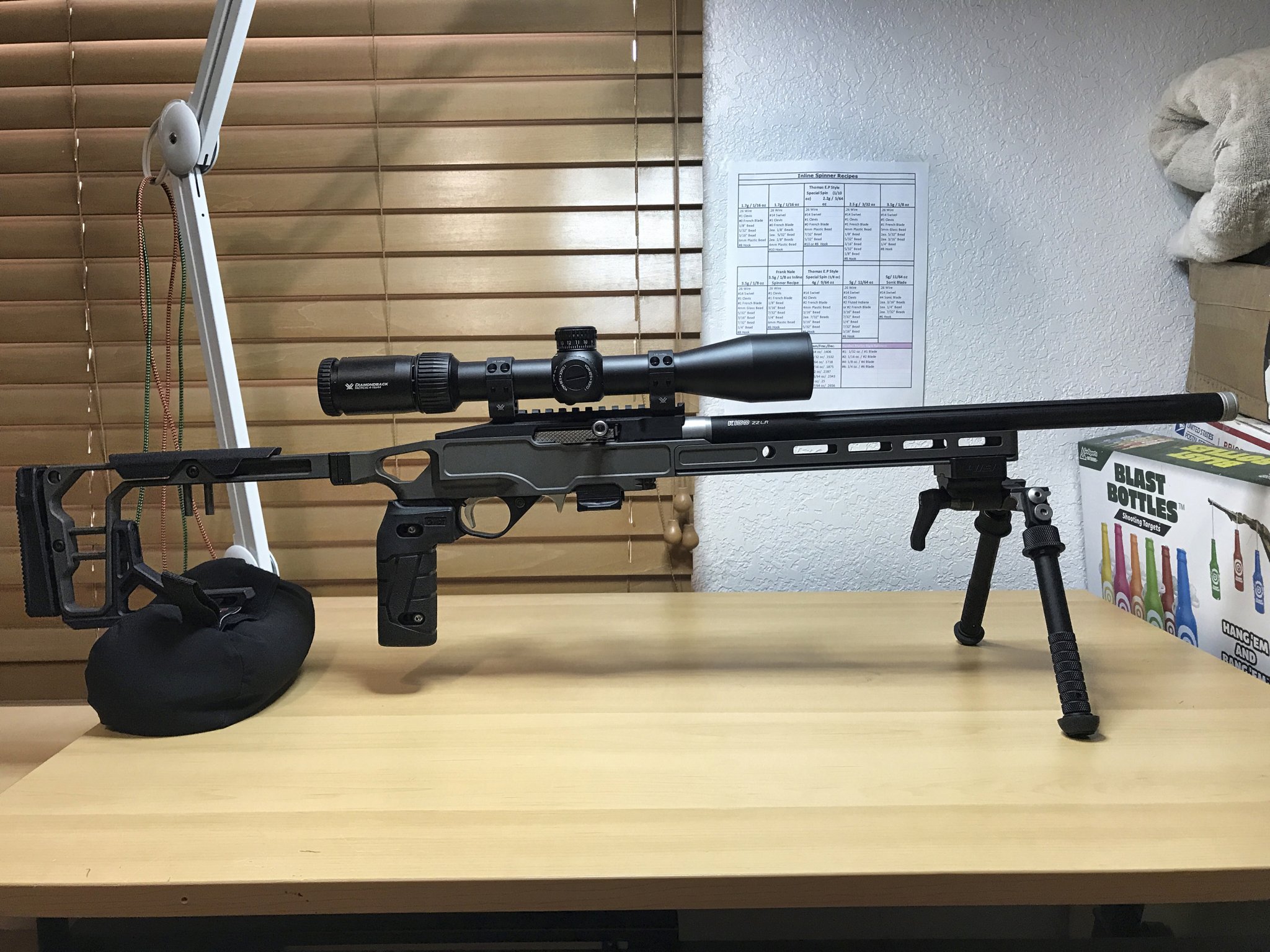

    KIDD Supergrade. I replaced the rear setscrew with a nylon tip setscrew to tighten up the rear of the action. I have since added Bag Rider and replaced the stock hand grip with an MDT Vertical Grip. Really like the chassis.

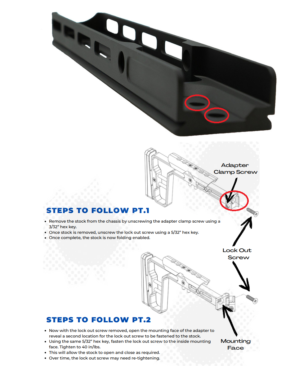

    Mine just got here. So it came with only one set screw?
    Instructions said 2 but they were all outdated?
    Did you torque the rail to 15inch/lbs and the 2 on the folder to 40inch/lbs?
    Nylon tip set screw from a standard hardware store?

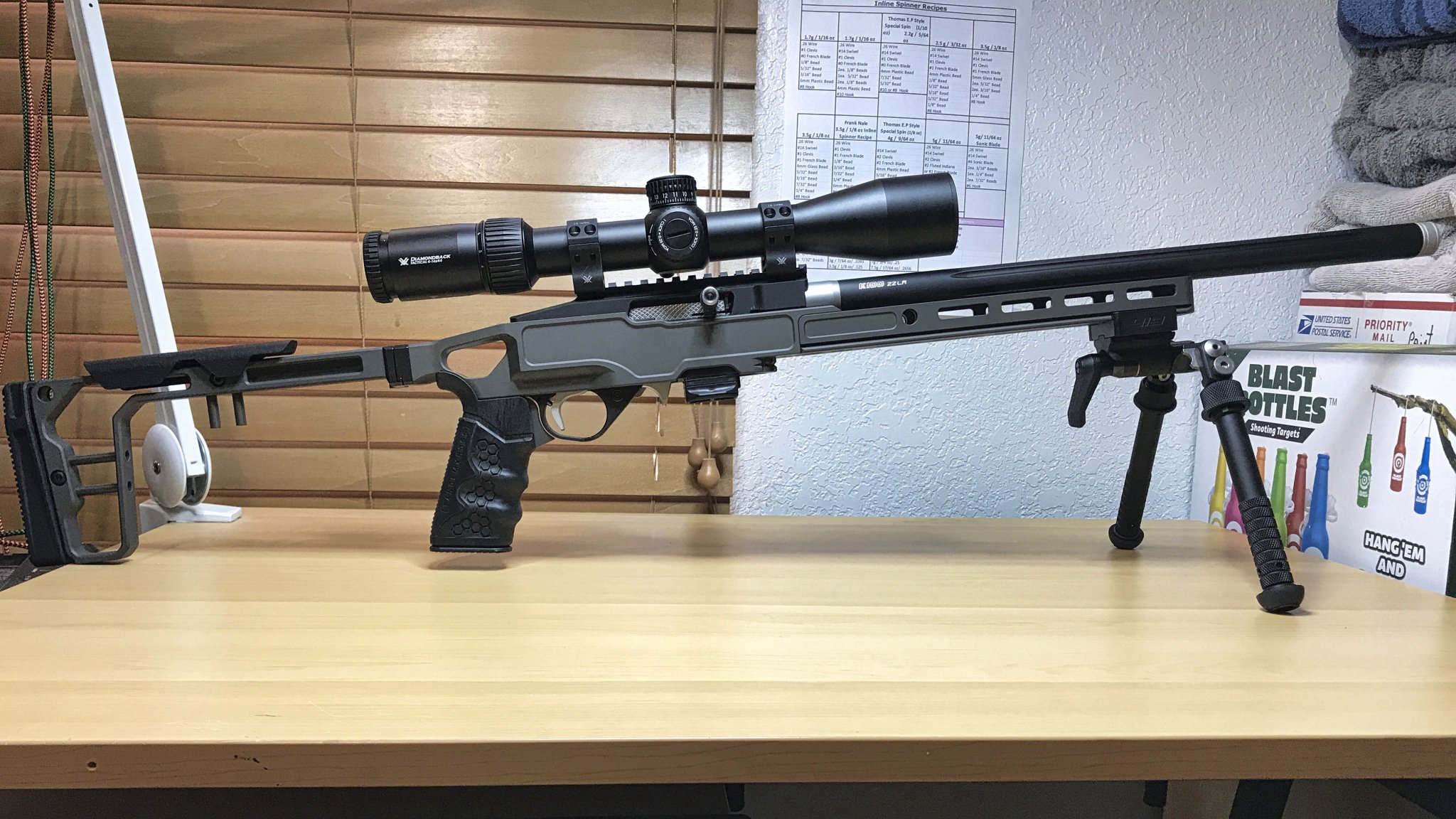

    My chassis came with one set screw. It bugged me that I would mar my receiver/trigger housing with metal to metal contact so I ordered some nylon tipped set screws from Amazon. It makes me feel better and they hold it secure at the rear. I just hand tightened the rail and screw to make the folding stock non-folding. I added the Grey Birch Bag Rider and MDT Vertical Grip as I like ergos better.
    What did you torque these to?
    Would it be safe to go by...
    3/32 = 15inch/lbs
    5/32 = 40inch/lbs
    That should be fine. No need to overthink that part. Focus on the torque for your action screw and optics.

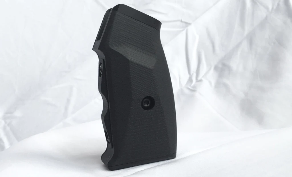

    Now just have to hunt down a EO grip. Oh man. Wonder how the CZ grips would do on this.

    Look at the (MPA EVG Enhanced Vertical Grip if you like shooting with a thumb rest and more importantly it places your trigger finger at a right angle to the trigger. Have one on my Volquartsen 10/22 in the Gray Birch chassis, great addition.
    Reactions: usafa77
    I did see those.
    I think I'm just too in love with the EO. Want it to match my other rifles. Just spent too much hunting them down. It's like I have to complete out the set.
    The MPA has a big gap between the stock and the web of your thumb, for me it wasn’t comfortable at all
    Depends on how you place your hand. I prefer to have my thumb on the right side and the gap is a none issue. If you use a full grip then it can be and issue with the gap. As I said in my original post, "If you like shooting with a thumb rest" .

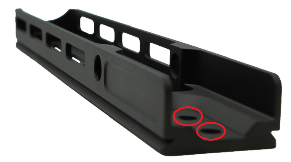

    Apologies for this question,
    Is this where the rear action screw is to be installed?
    Some of you are using plastic?

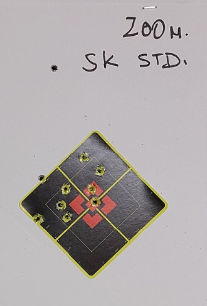

    Took my 457 out of a MPA chassis and dropped it into the GB chassis. This thing is tiny. Like a toy. Would make a good childs first rifle. Machining and finish look good. The 457 has a gucci trigger spring, bolt knob, and Proof 16" CF barrel. This barrel has always shot surprisingly well but it really impressed tonight. I shot CCI SV and my bottom shelf SK Standard Plus. It was a little harder to shoot than the MPA chassis and definitely my RIM X in a weight-kitted MPA but it really impressed at 99yds
