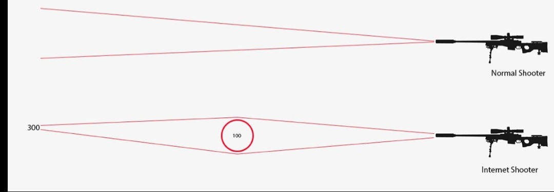

My theory is based on gyrations. Depending on the size of at spinning top and the speed you spin it, the top will
A. Start out wobbly and come to center, then back to wobbling until it stops.
B. Start centered then start wobbling till it stops.
C. Start with slight wobble, come to center, the back to wobbling until it stops.
I tried this on my bar and those were the results. I know a bullet isn't the same as a spinning top, but the gyrations of the 2 may be the same.
It's a theory that i am willing to give up for a better explanation. I KNOW my results on target are consistent. My reload average SDs are below 5 (some groups are at 2)
Reactions: wade2big

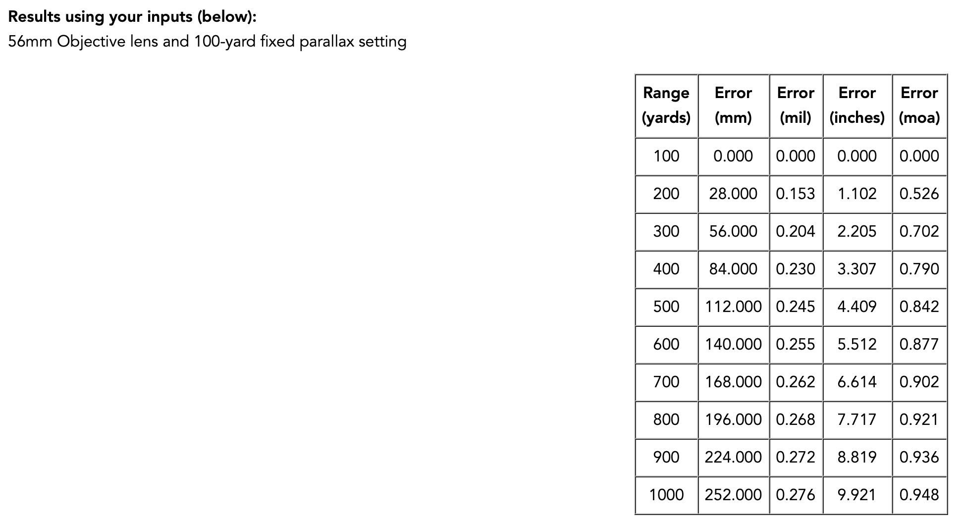

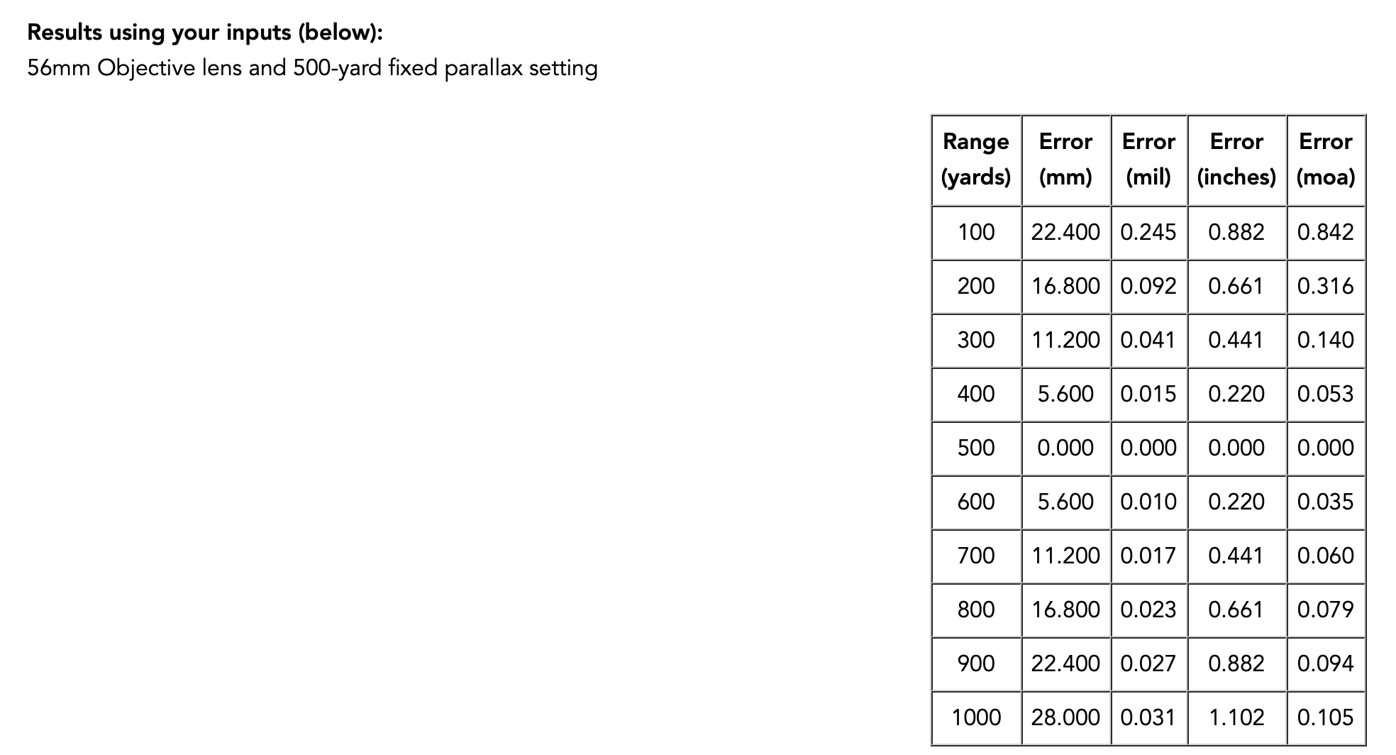

Here is the difference in parallax error if you have it parallax free @ 100yds and then shoot out to 1k. Also the difference when you have it parallax free at 500yds and shoot at 100 and 1k yards. This is with a 56mm optic.
This was worth the price of admission. What program did you use to generate the charts? I've always know to set correct parallax and check with the head bobble, but I never saw the deviation.
Here's the link to a parallax error calculator.
The cliff notes: parallax can absolutely be the reason for bad groups at 100yds or a bad 100yd zero. However, the further you move out, the less parallax matters as it's not just an angular value. The error is limited by the linear value of the objective lens. So, for most people shooting steel/prs type stuff, once you get out past a few hundred yards, you can basically use the parallax adjustment as a "focus". Because if the target is in focus and your 100yd zero is correct, it's not possible to have enough parallax error to miss the size targets we shoot.
Things to keep in mind with parallax (apologies if you already know this):
1: if you're looking through the center of the optic (basically clear edge to edge sight picture) then your parallax knob doesn't matter much (in theory).
2: Since we are looking through the center......parallax can only be half of the objective lens. So, even if you move your head as far as you can to barely see the center of reticle up against the edge of your sight picture, you are still only at 50% of the objective lens (center to edge).
3: most people are going to have mostly clear sight picture. Maybe a touch of scope shadow. So you're now only at a very small % of the total maximum error (which again, is only half of the objective).
So, that basically just means.........pay very, very close attention to your parallax when you zero the rifle. If you have an optic with parallax adjustment, make sure it's adjusted out via the head movement thing as well has making sure you have clear edge to edge sight picture. If you don't have a parallax adjustment, then pay very, very close attention to your edge to edge sight picture.
After that, you can basically just treat the parallax knob as a focus wheel as long as you have good edge to edge sight picture. And the further distance, the less it matters.

Honestly, it doesn't matter what people claim...OP can claim he shoots one-hole 10 shot groups at a grand all day long with him using his big toe to squeeze the trigger...That stuff is largely irrelevant but he's saying that his groups are 1 MOA at 400m or so then 1/2 MOA at a grand....
Since he doesn't seem to want to answer my questions above, my guess is that he shot a few groups where this occurred and is prematurely drawing conclusions about this being an actual hard-n-fast pattern attributable to his weapon system (him, platform, his ammo) and not just happenstance...My guess (and it's just a guess until he chimes in) is that he's shot only a very small handful of groups at those distances on a realatively new barrel and is jumping to conclusions...If he were to fire another 30 groups at 400m and 1000m the overall spreads would normalize to expectations (consistently smaller groups at 400m vs 1000).
Sorry, your post got buried in all the BS posts. The barrel has about 1000 rounds. About 100 rounds at 100yrds, 700 rounds at 600yrds, 200 rounds at 400 yards and 100 at 1000yrds. I shoot prone from the same place on the ground
