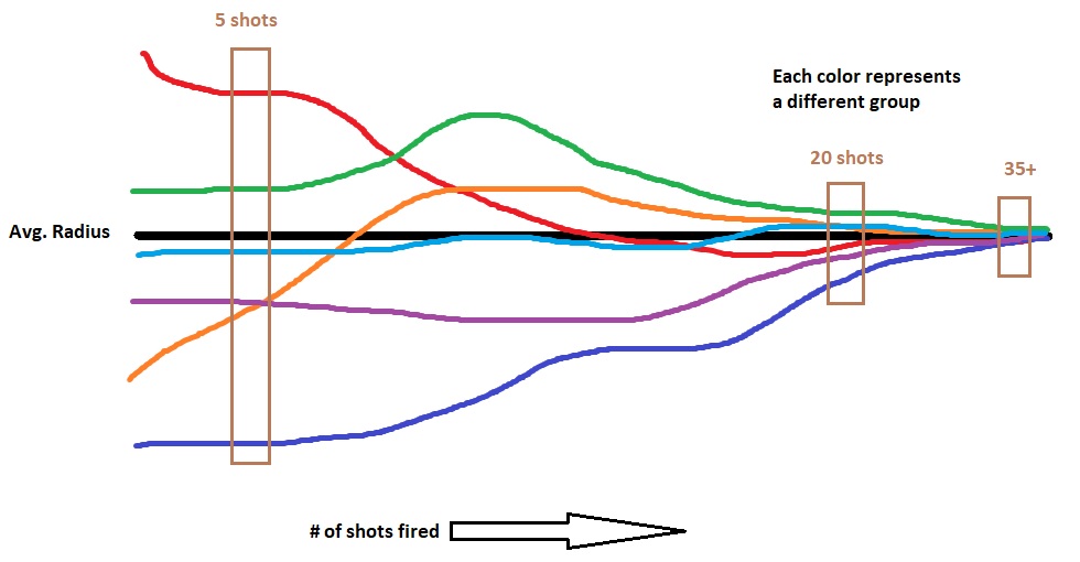

    There's a thought I've been developing over the last several months. It goes something like this;
    Spoiler alert: I've done nearly 1000 rounds worth of 30-50 shot sample size tests in .223, 6.5cm, and .300prc in the last few months and the number is somwhere between 20 and 40 depending on how much variance is in the sample.
    Amazing to record POI vs. POA over 50 rounds and watch the mean point of impact move around .2-.3" at 100yd from where a 3 or 5 shot group started out.
    Plotting those impacts shot by shot has me thinking that the average radius and SD of the radius from the MPOI is more telling than the extreme spread of a group of shots... and SD is really only viable if you have enough data points to show normal distribution.

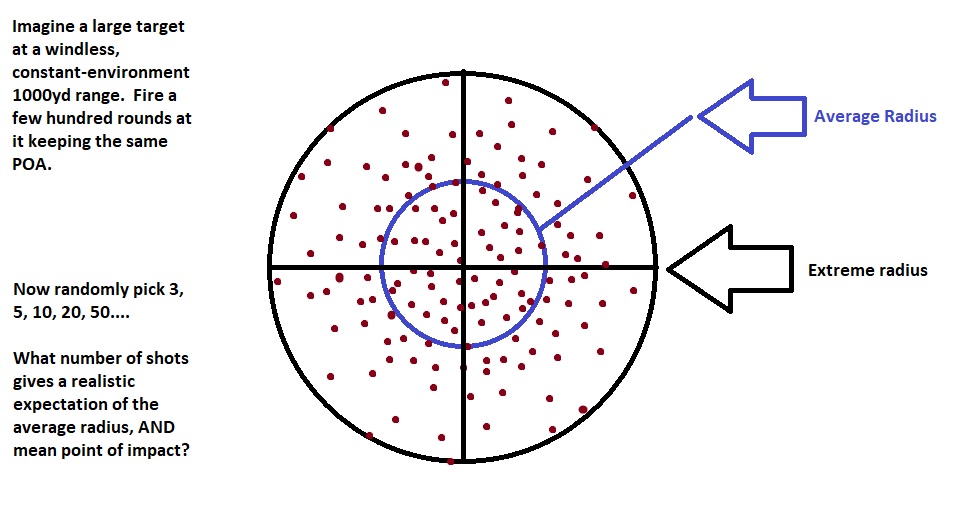

    Here's another way to look at it; Of all of those dots in the picture above, only 2 of them represent the extreme spread, or group size.
    So we're basing the precision capacity of all of those hundreds of shots off of the two worst ones. The method gives no way to measure the "weight" of the other shots inside the outer bounds.
    What are the odds that 3 or 5 random samples from all of those red dots in the picture above will contain the 2 on the outer edge? Because that's basically what we're doing when we do load development.
    5x at 41.0
    5x at 41.3
    5x at 41.6
    etc....
    Then we take the best of that and load 5x at 2.850, 5x at 2.855, etc.... And then we take the best of that and call it good right?
    But each time you shot 5x of a load and pass it by, you essentially took 5 of those dots above at random, and assumed it represented the population. You could have got 5 of the ones in the tightest cluster and thought it was immensely better than it really is, you could've got 5 on the outer ring and thought it was heinous, especially compared to others where you get 5 closer together.
    5x at 41.0
    5x at 41.3
    5x at 41.6
    etc....

    Eventually you'll shoot enough flyers they all group the same in the end?
    Seems like what is being implied is that after 50 rds a load that puts 5 shots through the same hole at 100yds will be the same as a load that prints a 3" group at 100yds. Because group samples dont mean anything.
    I find that hard to belive.
    And .2 moa shift at 100 is only 2" at 1000yds. I could live with that.

    I guess my biggest point is that you shoot 5 shots of something and either keep it or pass it up based on what it tells you. My experience of continuing to shoot the same load for 50 shots has shown that doing so is in many cases entirely baseless. i.e. what the 5 shot group told you was a lie.
    A 5 shot group has the ability to show you how bad a load can shoot, but is no indication (by itself) of how good a load will shoot. And even if it shows you how bad the load is, you don't know if it's representative. There's no two ways about it, even in accuracy fixtures and BR rifles the MPOI, SD, and group size (or if you take the time to measure it, average radius from MPOI) doesn't settle in until 15-30 rounds into the group.
    If you seriously want to know your mean point of impact, ES, SD, dispersion potential, etc.. You need to shoot 20 rounds MINIMUM. Bare minimum. Ever wonder why a bunch of 5-shot groups are all tight, but the average location of them is different from the next group, and the next group, etc..? It's because you're randomly selecting 5 at a time of the dots in the OP picture.
    ETA: Also, ever wonder why occasionally the same "happy" load occasionally throws a big group? Like normally .3-.6" but this one is .9 for some reason. And you tell yourself "Must've yanked that one" but everything seemed fine? Must've been a bad case. Must've goofed the charge. Must've seated that one different...

    What Ledzep is saying is no different than what has been discussed numbers of times elsewhere. That is that five shot groups are not statistically significant if your intent is to find the best load possible.
    So how much better or worse is the worst good group vs the best worse group based on small sample when expanded to large?

    Nope. Take a sample of 5 off of any production line and apply 6 sigma or any statistical analysis to it and you'll be swimming in scrap parts by the end of the week.
    Look back at the picture in the OP. Pretend the max radius is 18", so the whole group of several hundred dots there is a 36" group at 1000yd. Barring BC variability, muzzle velocity spreads, yada yada...
    That's a heinous group. 1 Mil wide.
    What you're doing by firing 5 shots is RANDOMLY selecting 5 of those dots. You're not in charge. You're not picking the 5 you like, you're not picking the best 5, the worst 5... you are receiving 5 random shots as samples of the population of total shots of that load (your theoretical accurate barrel life, essentially).
    So again, what are the odds that you get 5 that represent the average radius of that group? What are the odds that 2 of those 5 are the extreme limits of the total group (shots on the outer perimeter)?
    What are the odds that the 5 you're randomly given are MUCH closer together than the extreme ends of the total group?
    What you're doing by firing another 5 shot group is randomly selecting another 5 of that big group. So each group you fire is giving you a better and better picture of what the combo is capable of. If you don't overlay them by correlating POI vs. POA, then you lose the global reference point and subject yourself into being tricked into thinking the precision is better than it really is.
    ETA: It is entirely possible that you fire a 5-shot group that is representative of the average radius of the larger group. However, of the possible groups you can shoot, THAT particular one is a lottery ticket amongst a shit load of other groups that are much better and much worse than the average.

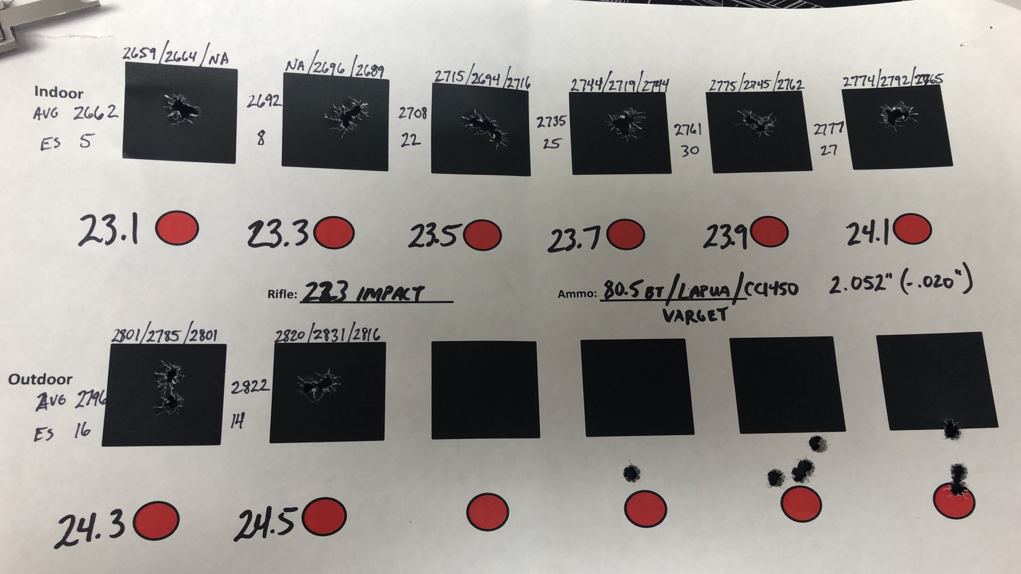

    If you really don't believe it, give it a couple boxes of ammo.
    Put 20 shots into 1 group at 100yd. Any pace, best conditions you can get, just do your best to be as consistent as possible and put 20 shots of your best load(s) into a single group. Then take one of the worst performing loads you had with the same powder/bullet combo during load dev, load 20 and do it again.
    My 50 person-fired (non accuracy fixture) shot groups ended up in the .95-1.5" range depending on the barrel used (factory button vs. Kreiger/Bartlein). At 20 shots they were a little better, probably had some in the .7-.8 range I can review that when I get a chance. The first 5-10 shots of all that testing varied wildly from nearly an inch down to .4". Keeping the same components/barrel they were within about a tenth of an inch after 50 shots.

    i shot the first 3-4 groups here from the rest and the others from bipod/rear bag
    same 223 barrel with a random charge of 2000mr and random jump on a 80.5..10 rounds from a barricade @ 100

    Here's some representative MS Paint art to try to convey what I'm talking about as far as statistical viability of 5-shot groups. This assumes they all converge to the same point, which in my testing has pointed towards being the case SO FAR, but I'm not going to say that's always the case.
    So essentially what you're doing with 5-shot load development is praying you have the light blue line. ;)
    Not sure what I'm looking at.
    Several groups' mean radius as they develop. Each colored line represents a group (say each color is it's own powder charge, for example every .3gr) and as it moves to the right more shots are added to the group. The more shots you shoot, the mean radius levels out and stops moving around. The brown boxes show what the mean radius (dispersion) of the shots of each group look like at different shot counts.
