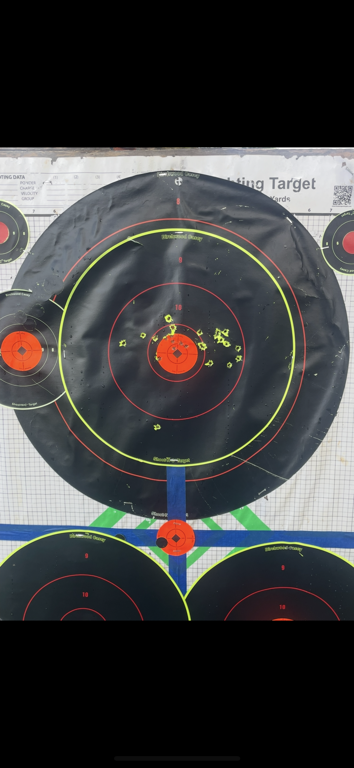

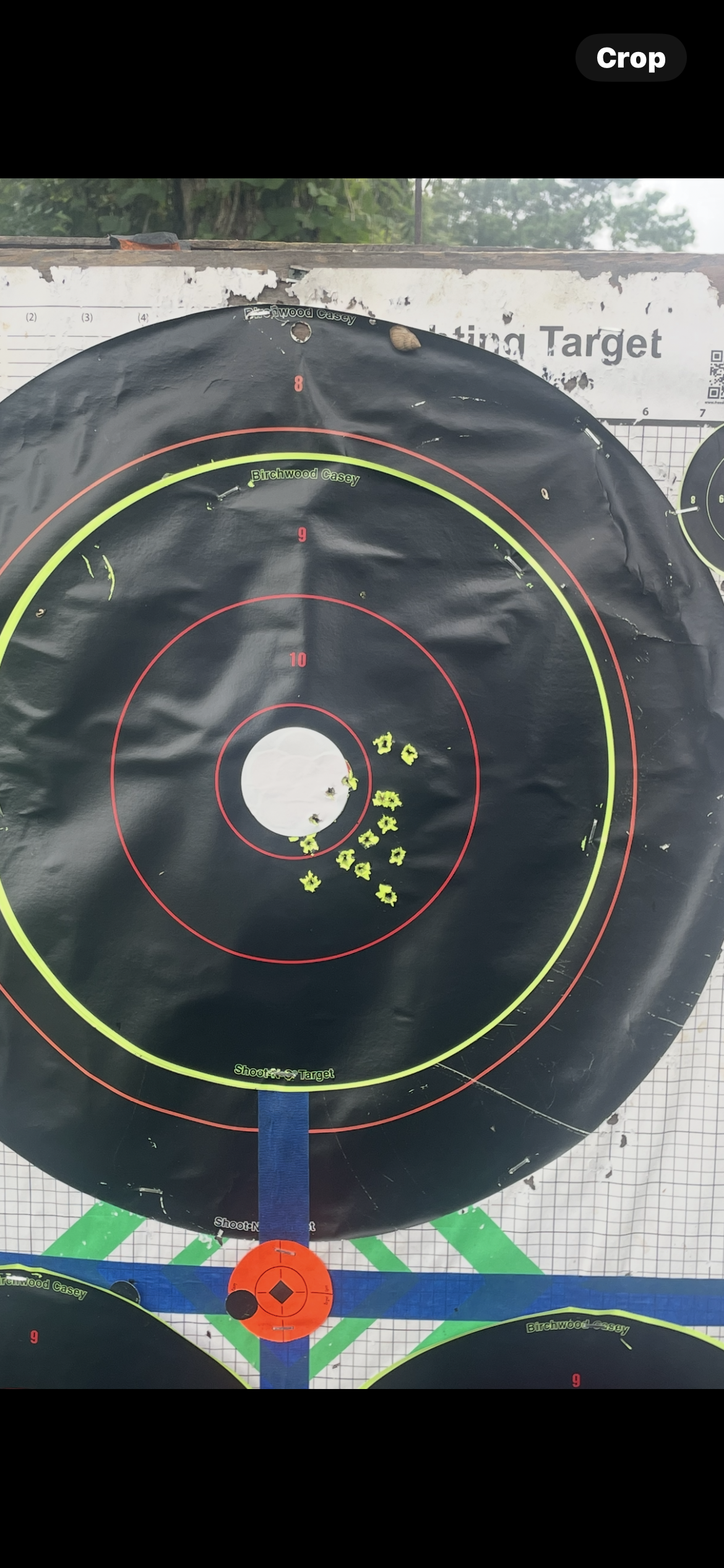

So, what did you group measure that you got at 300 yds.?
At 300 yds. I'd consider a "good group" to be ~1.5" or less.
An ES of 138 and an SD of 36.7 is pretty bad, in my book. I once had an 50 shot ES of 97 with an SD of 33 when testing a new primer. That was the worst I've ever gotten. When fire forming some new Alpha brass, 80 shots gave me an ES of 29 with an SD of 6.2 that produced .418 MOA group ( this being out of a .308 Ruger Precision Rifle, but with a Krieger barrel). Typically my high round counts yield SD's in the single digits. The factory ammo (mostly match grade) I've fired has yielded SD in the mid teens and ES's no worse than 50.

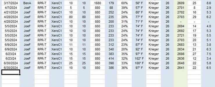

Something experienced shooters have learned intuitively is that the more rounds you fire as you're chrono'ing helps your SD's settle down over time. A lot of your variations in sampling will happen in the beginning. The first 5, 10, or even 20 rounds. But after 20 or 30, more rounds will actually help your SDs look better. This is due to the law of large sample sizes. And how Normal distributions solidify over larger samples. A larger sample creates a more accurate and narrower CI on the normal distribution. Now maybe not with your range, ES. But in terms of SD, you can get the bulk of your variation pretty soon.

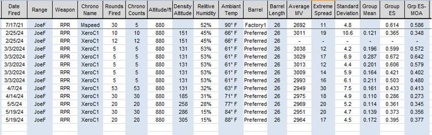

I had to take a few stats classes for my degree and you're learning the basics which def helps understand MV central tendency and dispersion data better. In my experience for any given centerfire rifle, SD starts out small (0-10 rounds where most people erroneously make their population attributions) then grows until it peaks around 20-25 rounds, give or take then begins to drop back towards a number that's more representative of the parent population, usually getting there by 30-40 rounds, as you say.
When I think Im ready to put a load into production, I'll do drop validation, firing 40-80 rounds of a given load receipe and record the entire string...My SDs in those cases are usually in the teens or low 20s for 5.56 and low-mid teens for .308, which is fine for my own requirements (hitting steel at 1000m and in)...I used to record my sessions only a two-three times a year as I hated carting out that LabRadar but now w/the little Garmin Xero, I record every single session (40-100 rnds).

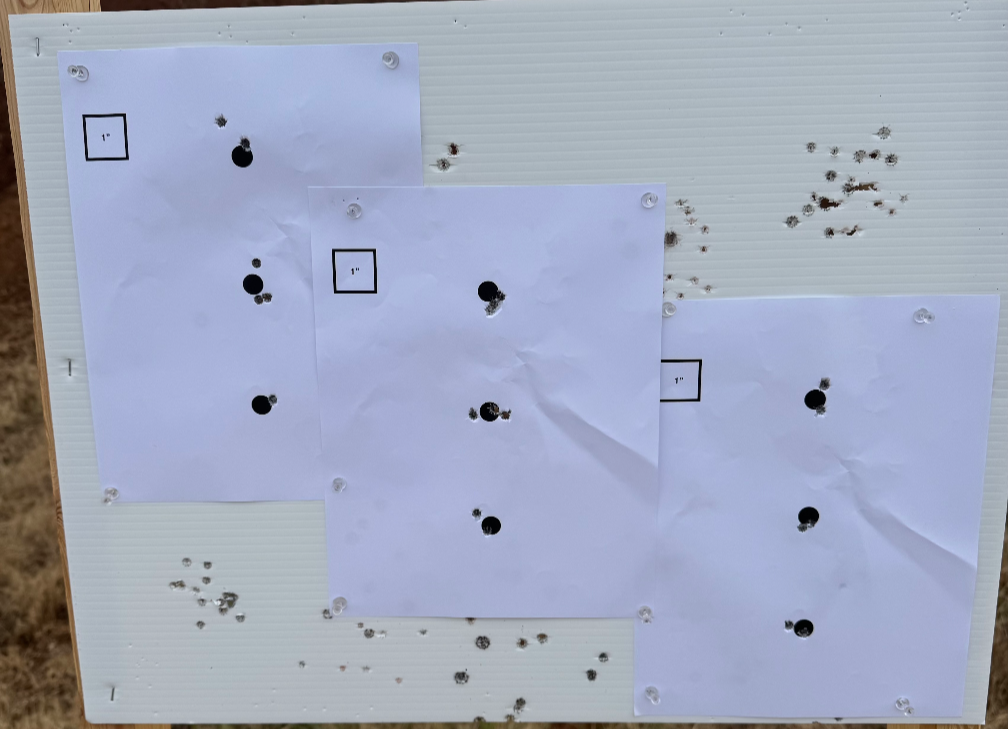

Group the rifle for the job. Jayden even mentions this. For example, my activity is hunting, then 7 of the 3 round groups with cooling in between is going to be most germaine to what I do. Especially on the first shot. I may have to take a second shot. Hunters I know have never had to take a third shot. And I feel, as do others, if you are taking more than 3 shots at an animal, something is dreadfully wrong and you need to stop and fix whatever it is.
Also, I heard of a guy, Wade at Texas Predator Hunting (TPH Podcast) do a 5 shot group of one single cold bore shot each day for five days. The dispersion was the same as if he took 5 shots at once.

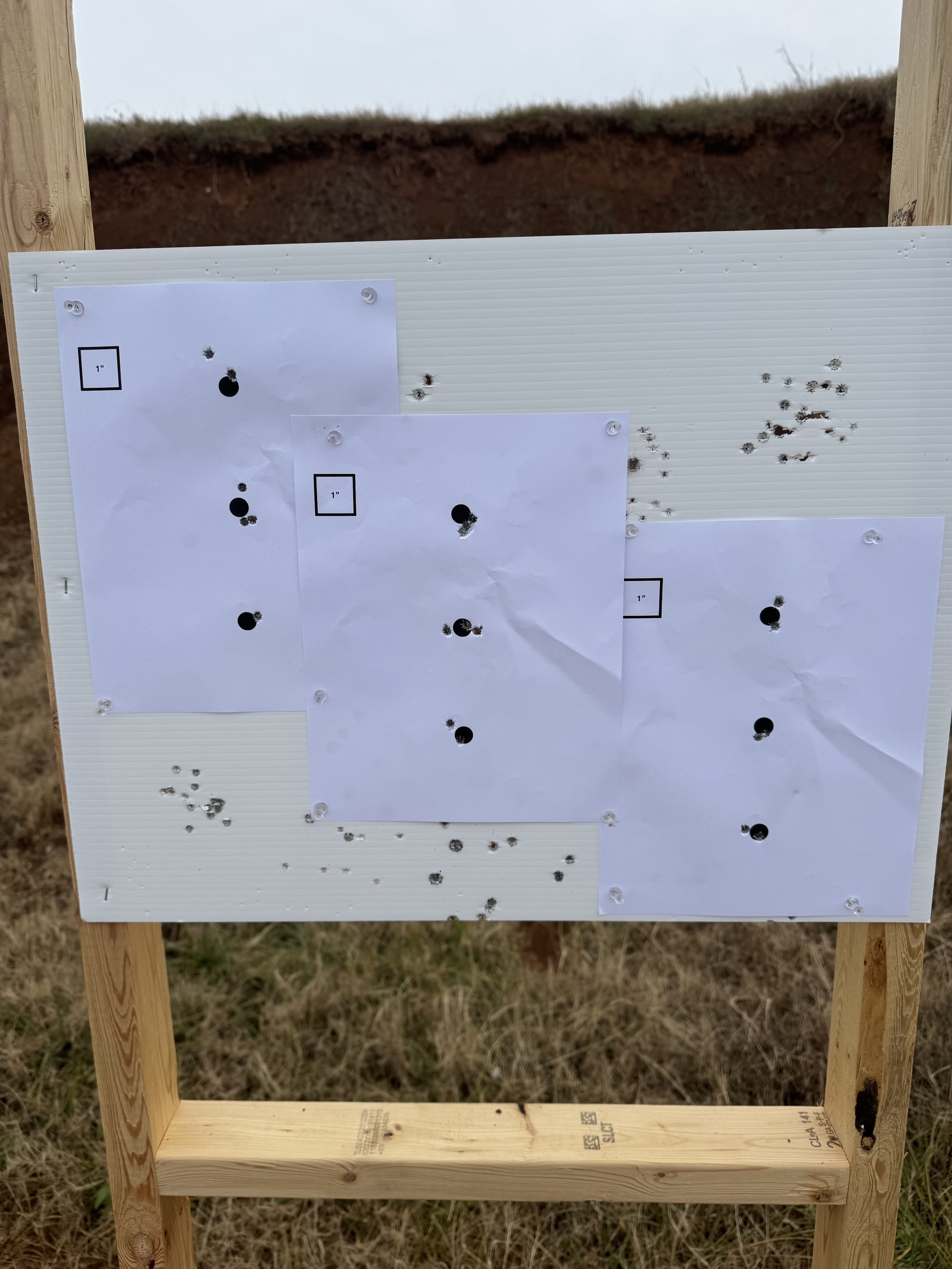

But I have also known Cortina to say that if the rifle is not shooting 3/8" at 100 yards in the first 3 shots or so, he is not going to waste more time and ammo. If it is not doing it in the first few shots, 73 more is not going to make it better.
So, either by factory ammo that works or work up a handload that works and just stick with that.
