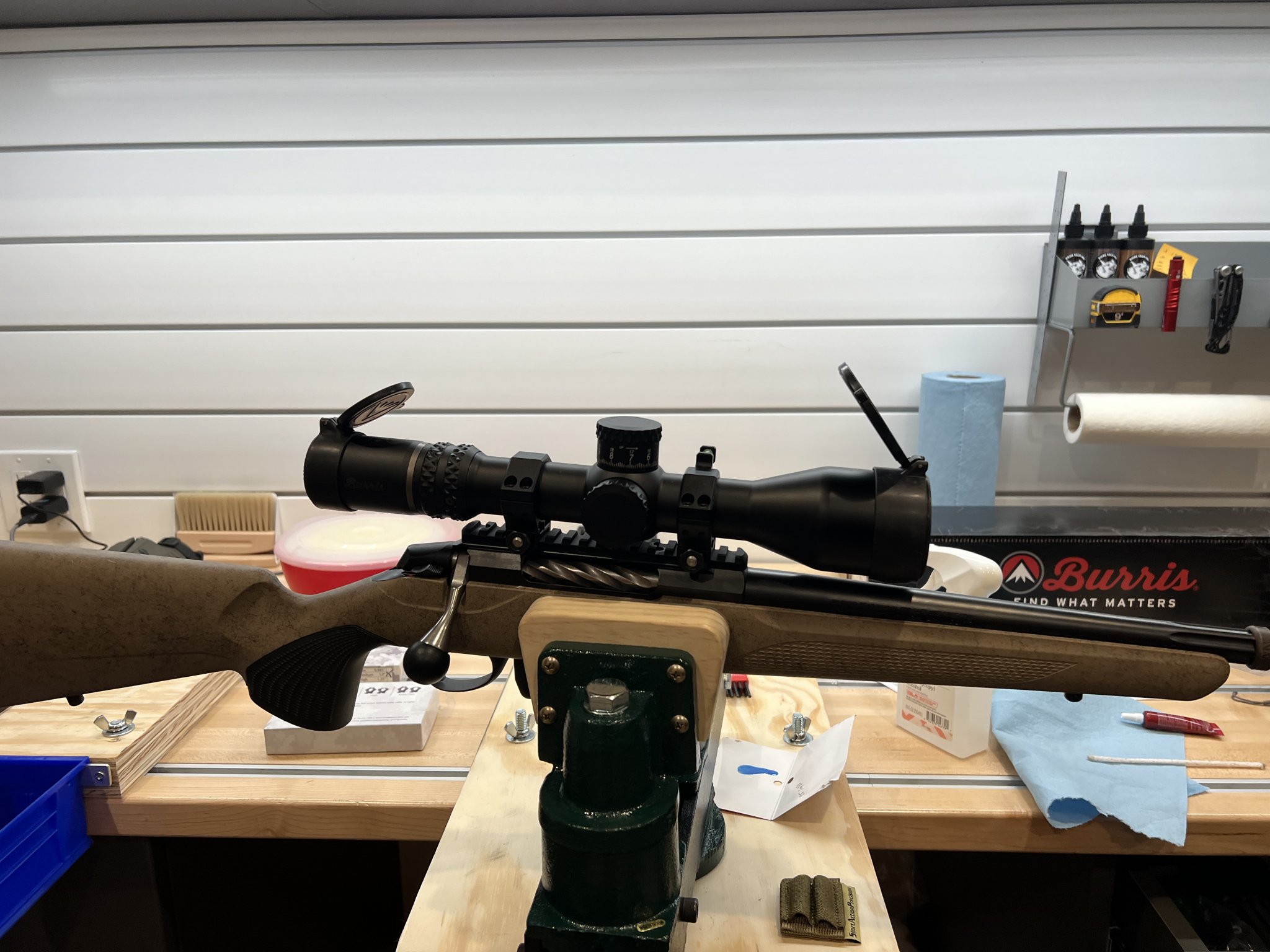

I had a Tipton Ultimate Gun Vise but saw someone else using a Pattern Makers Vise you can buy at Grizzly. It seemed much better so I picked one up about a year ago. It is amazing for cleaning and mounting scopes and I find it much easier to use. Also, the inside of the vise is wood and has a rubber protection on the one I have. It has never left a mark on any firearms. It cost a little bit more but was well worth it.
Edit: to add a photo
This is the way
Do you have any issues locking a rifle down? I watched a review and the rear locking pads were plastic and backing each other out.
Never had an issue locking a rifle down. I use mine for scope mounting and cleaning. Set up on the table when in use and tucked away under the bench when not. Being fully adjustable I haven’t found anything it won’t fit or anything negative to say about it yet.

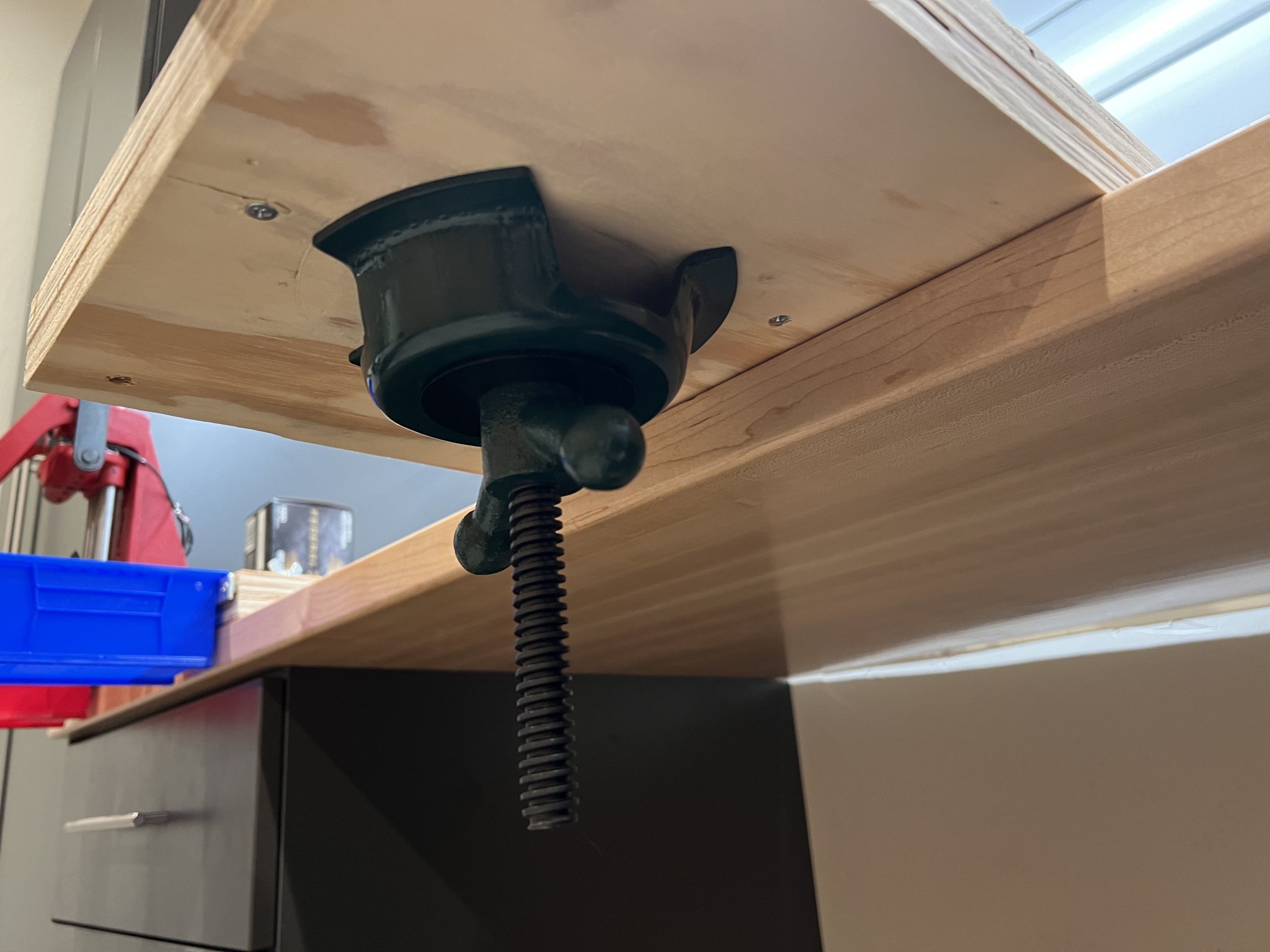

I love that bench rail. Mine isn’t that fancy, curious if clamps would hold the the vise steady enough if the vise was mounted on a board
Edit: If I’m looking at it correctly it mounts through the one center bolt? So I could have it in the center of the bench when I need it then take it off when I don’t?

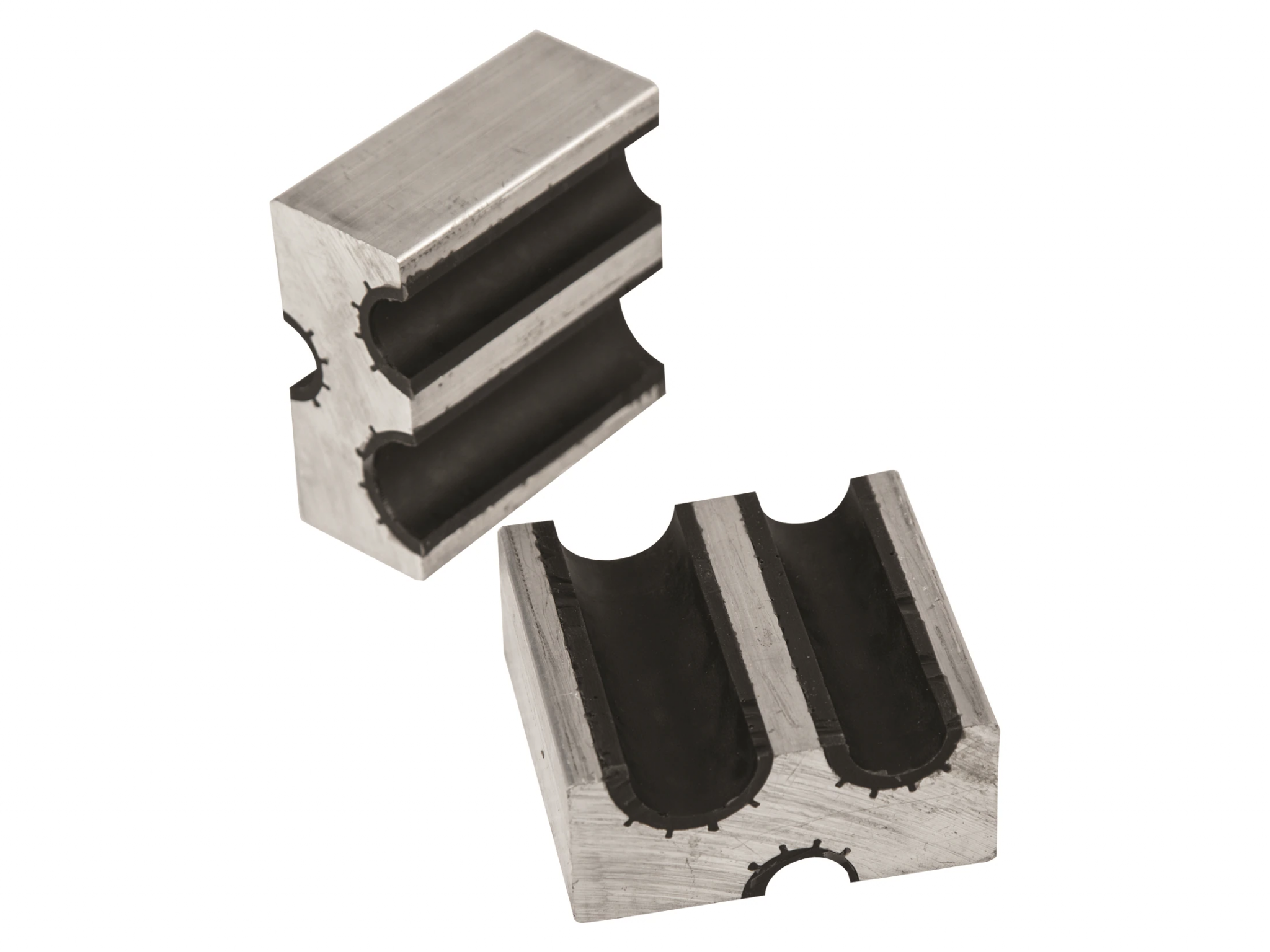

Now the arca/pic clamp from Sawtooth that the fella above linked is on my buy list as I have two chassis rifles with arca and it seems that it would be handy to have and use with my bench vise. I also, for the bench vise, have some various barrel profile jaw inserts that are sold. In particular, I have these Wheeler jaws but had to modify them a bit. Drilled a recess in them and epoxied two round rare earth magnets on each jaw face with the insert for the smallest barrel that I really don't give a dang about. Trying to hold a 20+ lb rifle, the jaws held together in the right spot, and tightening the vise just required one too many hands. haha Adding the magnets really made these useful.

It has a large wing nut and can be easily installed or removed. You do need to drill a hole through the bench. I have it attached to a piece of plywood that is attached to my bench with a t-track system so a little more involved.
What is also nice is the vice can be rotated. If I am installing a scope I will have the rifle parallel to the bench. When cleaning the rifle I will rotate it slightly so the end of the barrel is over the bench to catch any fluid in a rag or bowl and not on the floor.

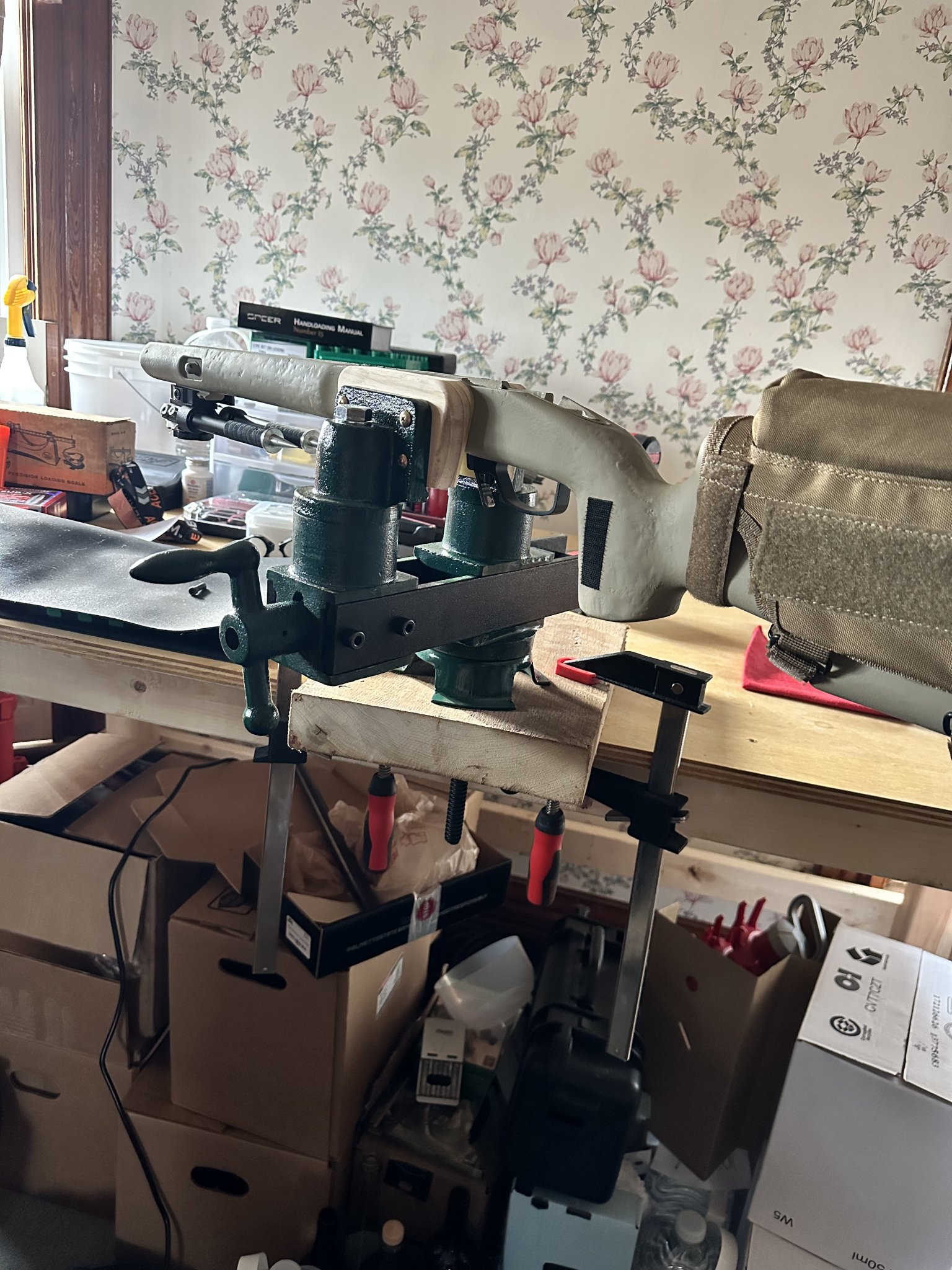

Are you able to lock down rifles in metal chassis without damaging the blocks?
Yes…my PRS rifle weighs close to 20 lbs in a XLR chassis and it is no problem. I haven’t noticed any damage to the blocks or chassis/stocks.

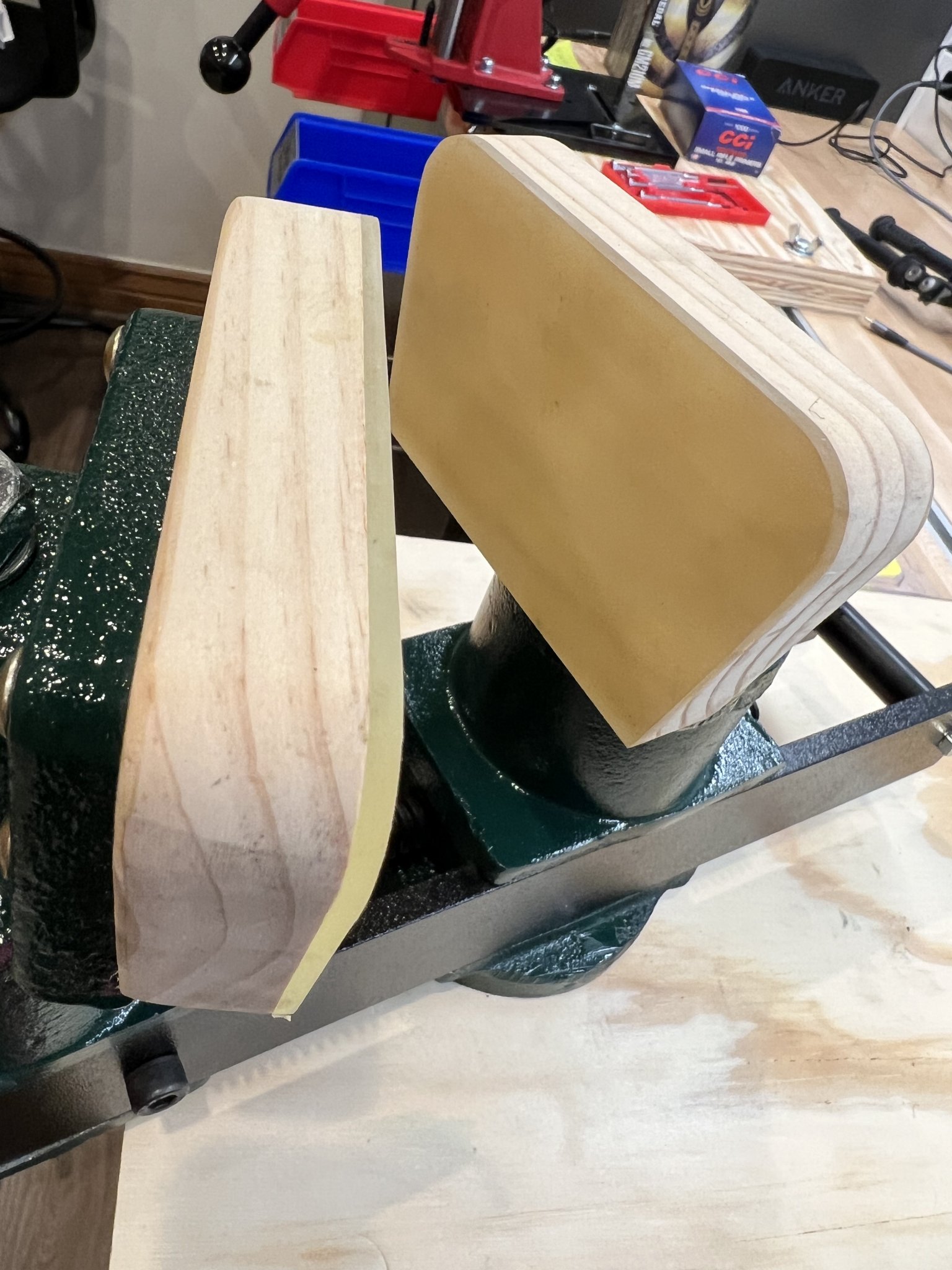

Here is a close up shot of the blocks.
Reactions: Ajwillly
Is that like a hard epoxy finish or soft rubber?
I am not sure what it is but seems to be a hard rubber type….could be hard epoxy. Keep in mind the vise is designed for carving wood and not damaging the piece being carved. I use it frequently and for a number of different guns and have never noticed any damage.

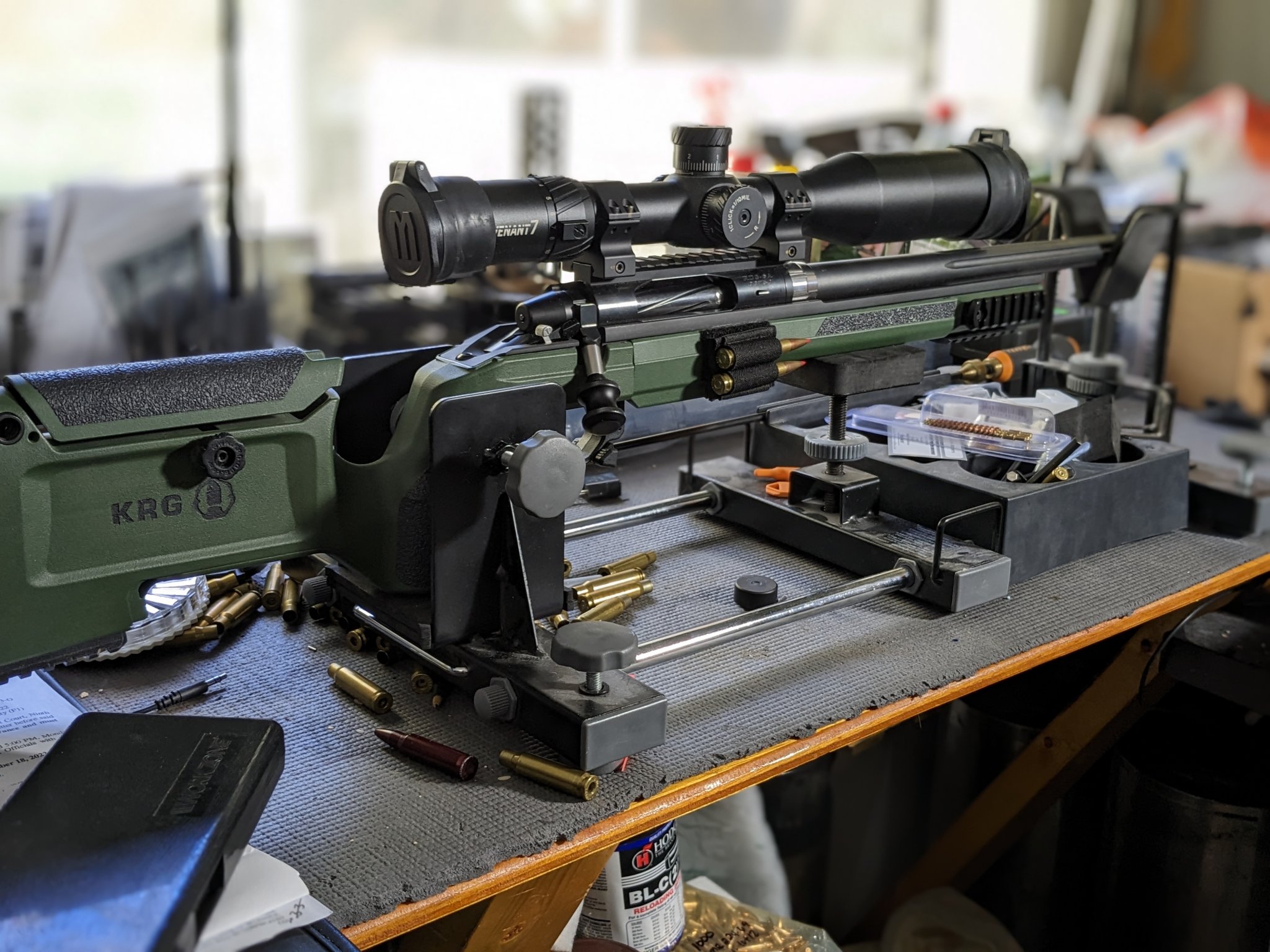

I have the Tipton discussed above as well as the atomic bomb option, 419 clamp + Orange. For light rifles with regular stocks, the Tipton works great. For chassis rifles, especially heavy ones, it doesn’t work well at all. My ACCs don’t clamp in with a shit. I still use the Tipton for the lever action 22s and the couple of stocked rifles I have left. All the chassis and ARs are done with the Orange now. The pattern makers vise or the sawtooth jaws are what I would jump to straight away if I could do it all over again.
I was given one of these Hyskore cleaning and sighting rests when I started getting into shooting. It's not the prettiest thing, but it's very flexible and has held up to the light duty use I've put it through over the last 4 ish years. I think if I upgraded I would go to a proper mounted vice solution.
