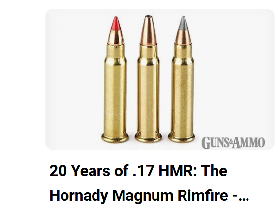

and i'll admit i'm being a bit of a pedant here, and maybe making a poor assumption based on outdated info, but. He lost me somewhat early when he started talking like the Hornady and Winchester ammo weren't likely a case of "same ammo different box". it's been kind of an obvious to anyone with a brain stem open secret that most of the 17 rimfire ammo was coming from either a singular or maybe two production plant(s) with only the tip of the V-max bullets being different, if that, between Hornady, Winchester, Remington, or Federal.
