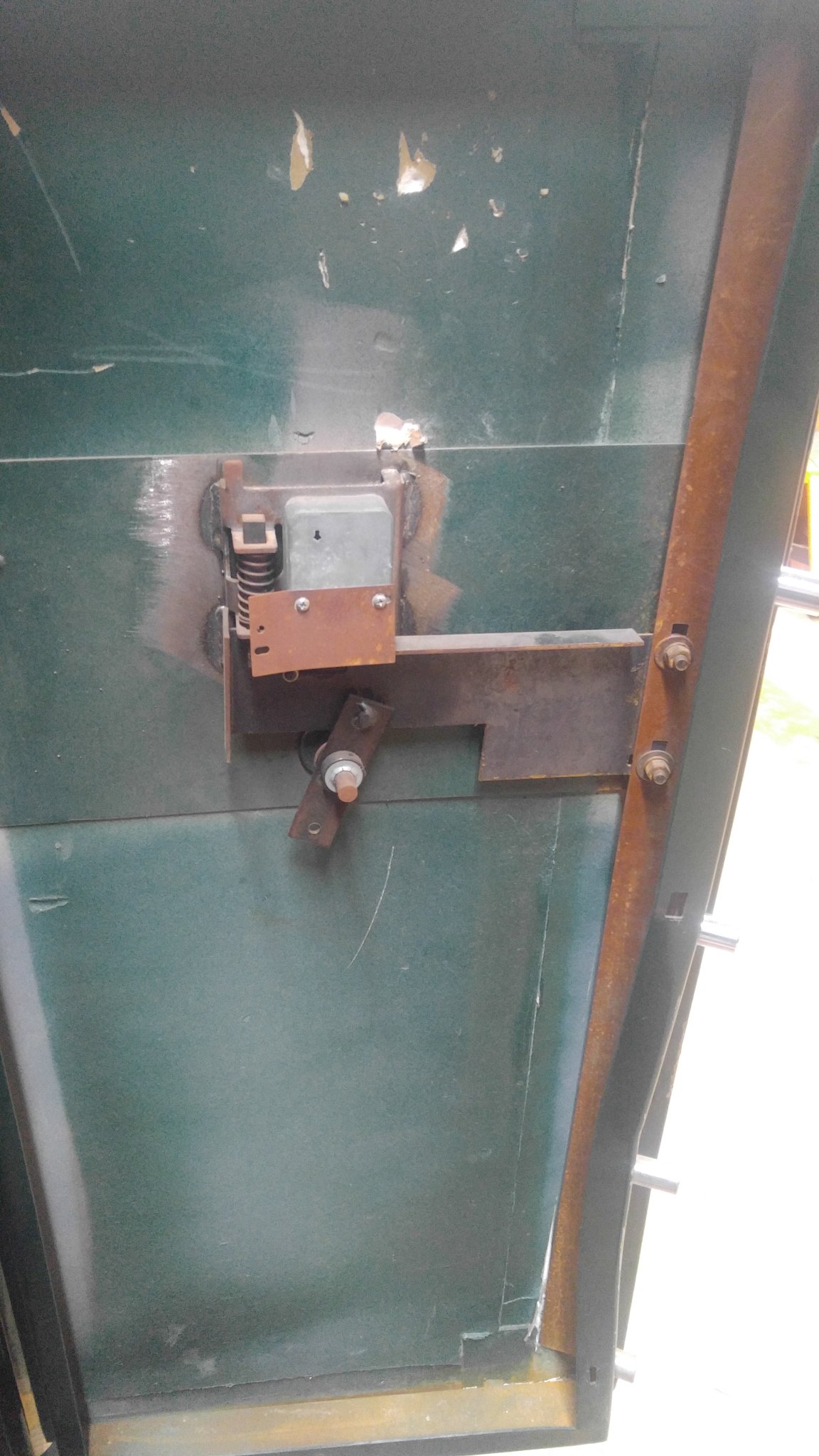

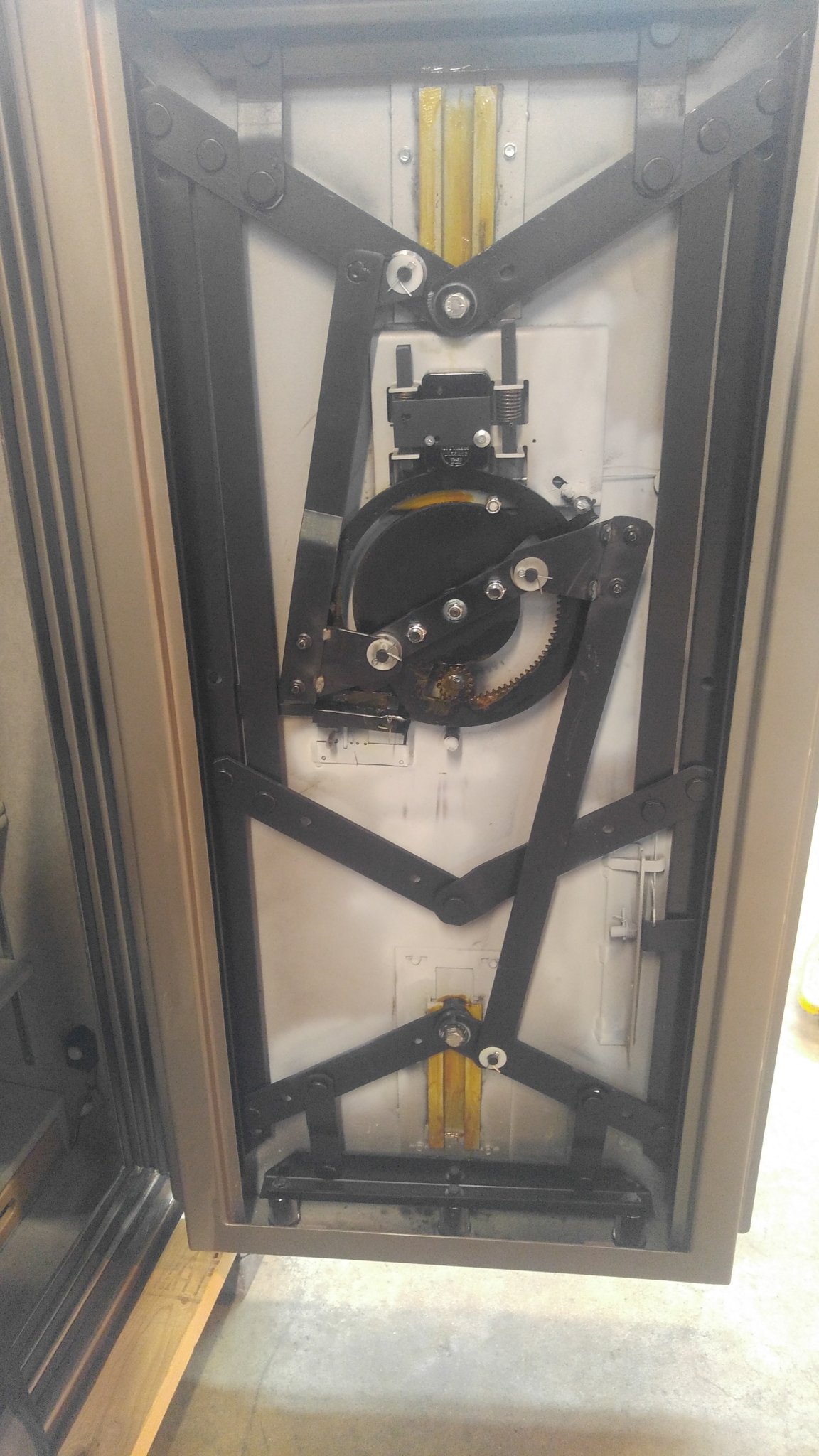

I got a Supreme Safes "untouchable" and I'm happy with it. Not on the level of something like a graffunder but definitely better than your typical liberty or box store "safe". Its 1/4" plate body, 1/2" plate door and serious mechanisms to support the bolts. I was told by the people that work on and sell them to only by a manual dial. With the electronic locks it's not if but when they will fail. No thanks. Mine weighs almost 1800 lbs empty and was a real treat getting in the house.
Attached 2 pics. My locking mechanism / bolt supports, vs what some cheap box store units look like.
