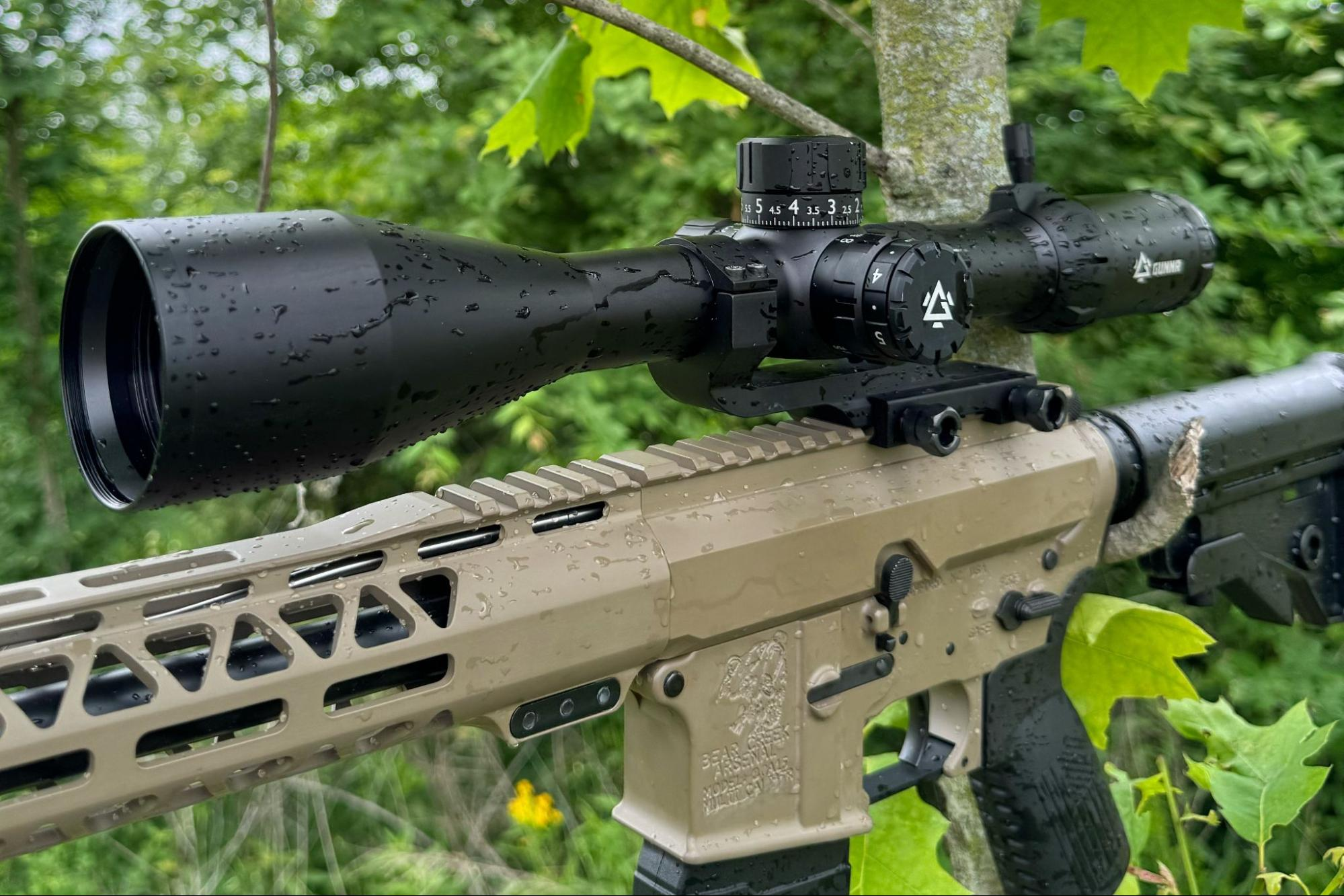

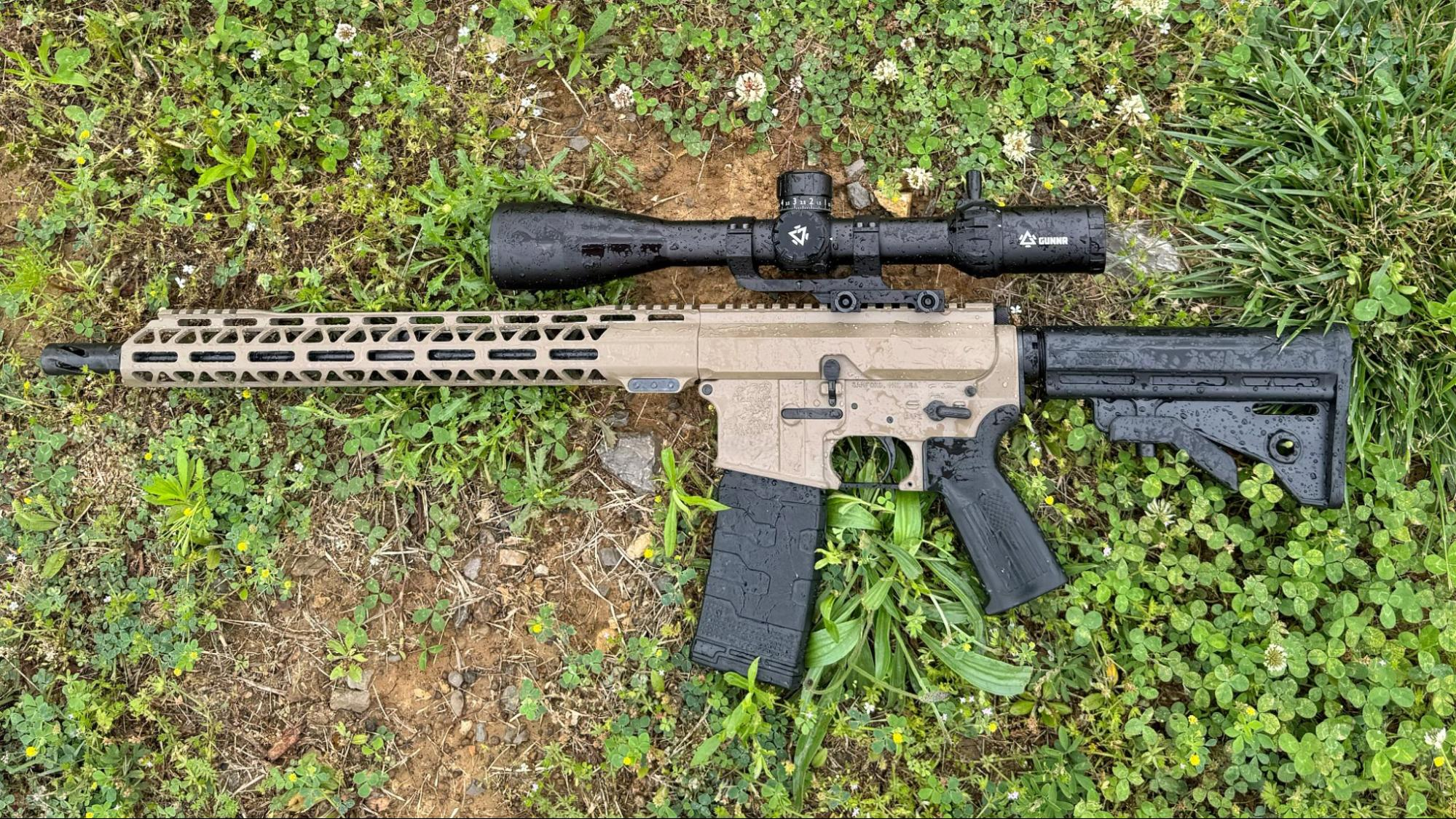

Using a Primary Arms scope mount, I mounted the HEIMDALL on a BCA-15 chambered in .223/5.56. Getting it zeroed in at the range didn’t take long. The adjustment knobs provided solid tactile and audible feedback when turned, which made making small adjustments easy.
During the two times I was able to take the scope for a spin, I only had access to 150 yards and closer, which proved to be light work for the HEIMDALL. No surprise there.
The reticle doesn’t clutter the view.
Durability-wise, I didn’t have time to give a torture test or anything, but I did drop it accidentally and shot it in the rain, and experienced no fogging or any other issues. While I have yet to put hundreds of rounds through any rifle with this scope, I don’t foresee there being any cause for concern once I do.

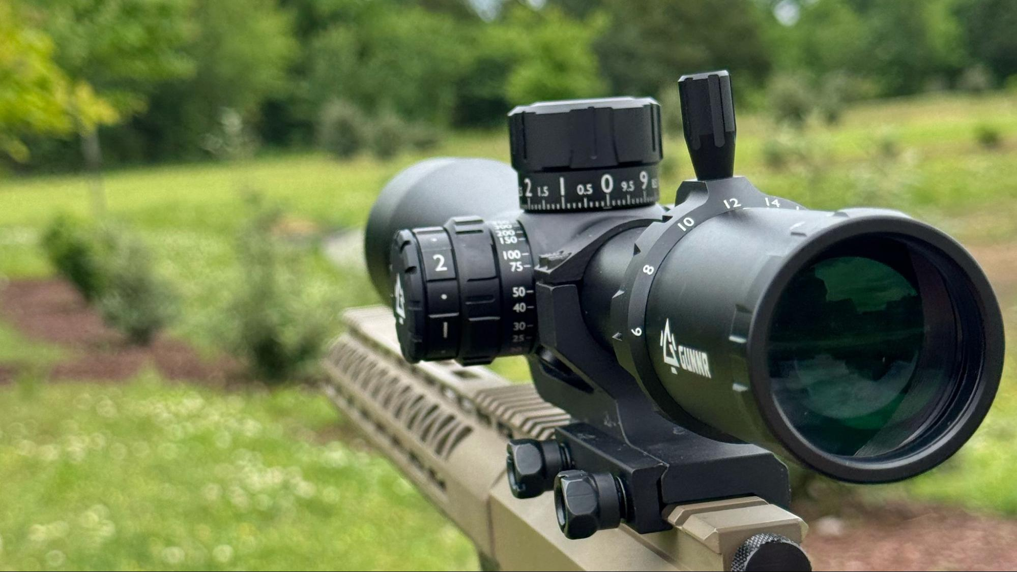

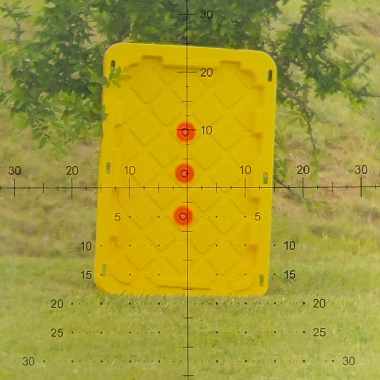

Of course, the reticle is one of the main highlights. It’s a first focal plane (FFP) reticle with plenty of hash marks and illumination. It’s sharp and provides a ton of detail for precision work. And, it doesn’t get too thick and clog your view even at full magnification.
No drainage systems were hurt during this review.
As mentioned, the reticle does provide red illumination settings, which were fine in lower light and overcast conditions, but it was far from “daylight bright” in full sun. That would probably be one of my main suggestions for improvement.

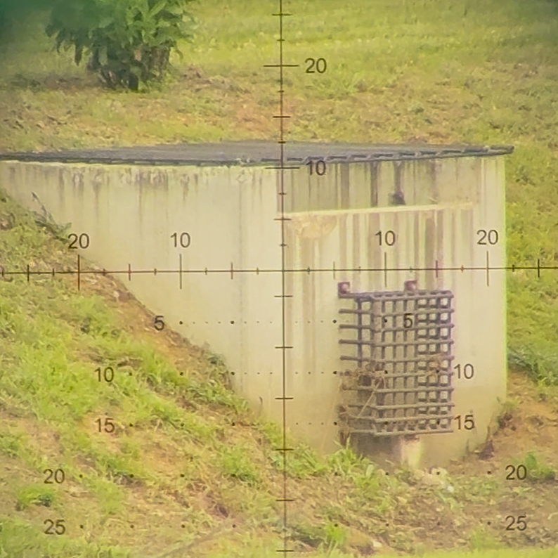

The glass quality stood out once I started stretching the distance. Edge-to-edge clarity was excellent from 6x up to around 12x; beyond that, especially in the 20-24x range, there was some softening at the edges, but nothing that affected my shooting too much.
Light transmission was pretty good into the late afternoon, but it seemed to lack slightly towards the evening.

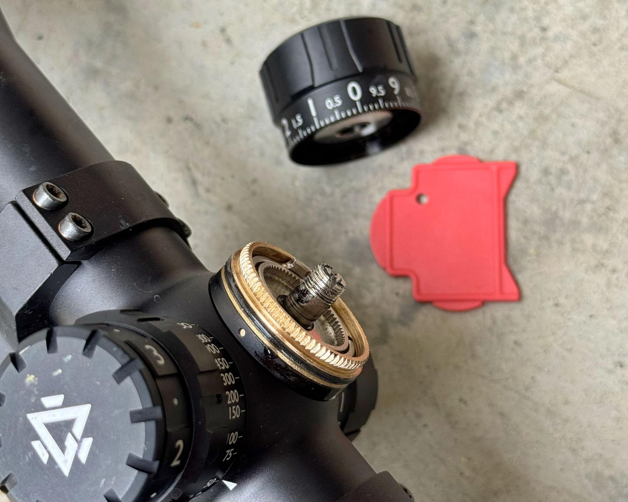

Simply remove the turret to access the zero stop.
As you’re shooting, especially if quickly transitioning between distances, the zero stop comes in handy.
To supplement the zero stop and allow worry-free adjustments, the HEIMDALL has locking turrets as well. I prefer locking turrets to capped ones, so these are good to go in my book.
