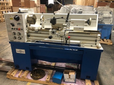

I dont either and honetsly im not driving to PA to get them. But that would be a really good project to piece together a working one. they even come with DRO's which is awesome.
And you have the parts to sell of the bad one.

This will actually do for barrels and truing actions, but not for production:
"%20x%2029"%20Benchtop%20Brushless%20Lathe%20Variable%20Speed%2050%20-%201800%20RPM%202HP%20(1500W)%20With%206"%203-jaw%20Chuck&gclid=Cj0KCQiAyracBhDoARIsACGFcS4Th5V3YKSbpBYb04zF5rLZ6uXx8fmG2rQxVwco6TuutEGH9OfRZHUaAj7XEALw_wcB
This is a very good, Taiwanese made lathe:
https://www.precisionmatthews.com/shop/pm-1236t/
