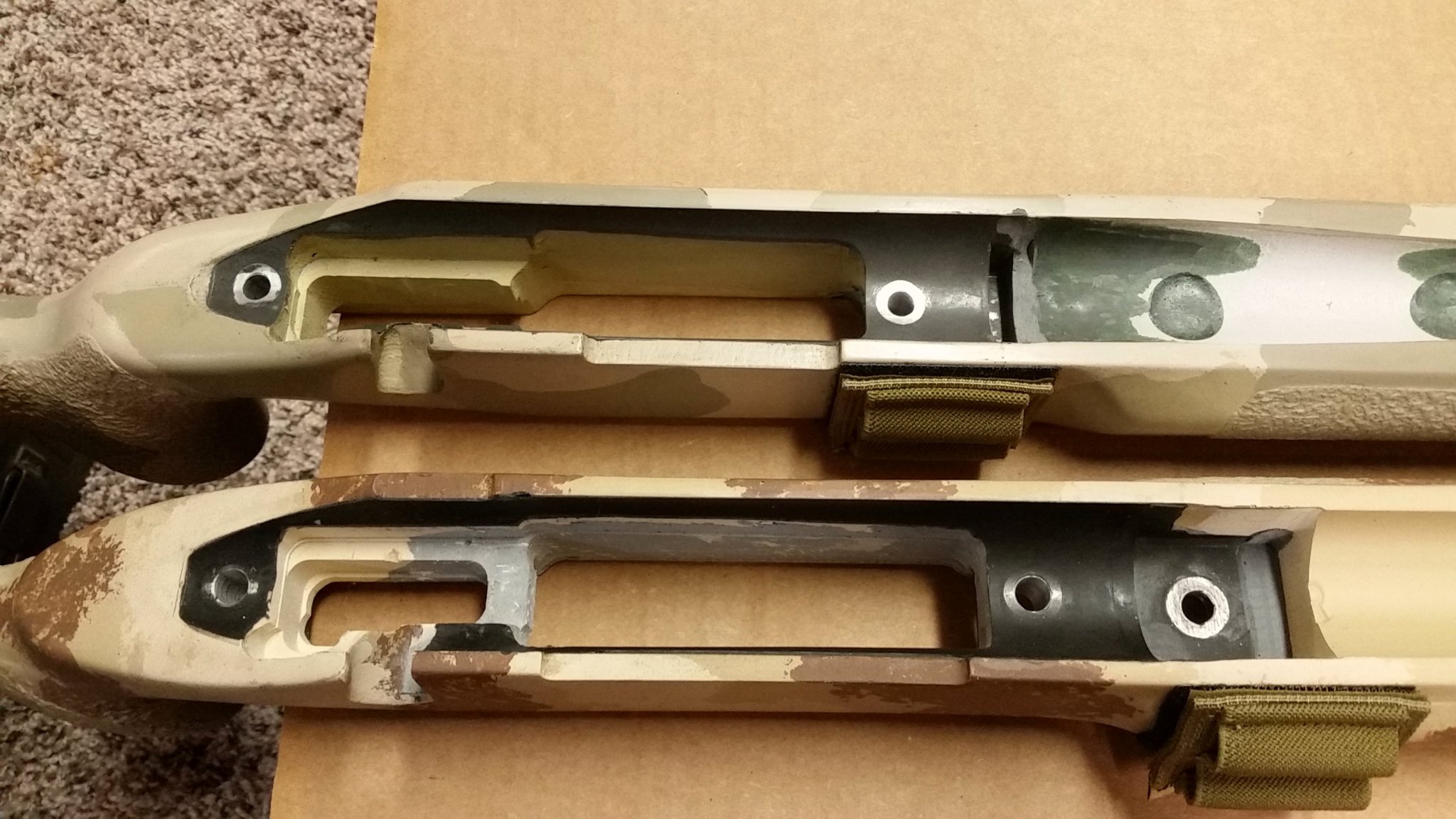

When folks refer to a "flattop" stock, it is one that has no inlet for action or barrel channel machines in it. If this is your stock then bite the bullet and send it to Long Rifles Inc. If it is factory inletted, then many top-quality Smith's can bed it for you. Those mentioned above plus RW Snyder Gunsmithing (he did my 300wm with Crane MK13 lug), Alex Sitman at Master Class Stocks has done many NRA champions' stocks.
The McMillan A5 at top of pic below was bedded by Alex, the 300wm at bottom is a Manners T4 done by RW Snyder.
