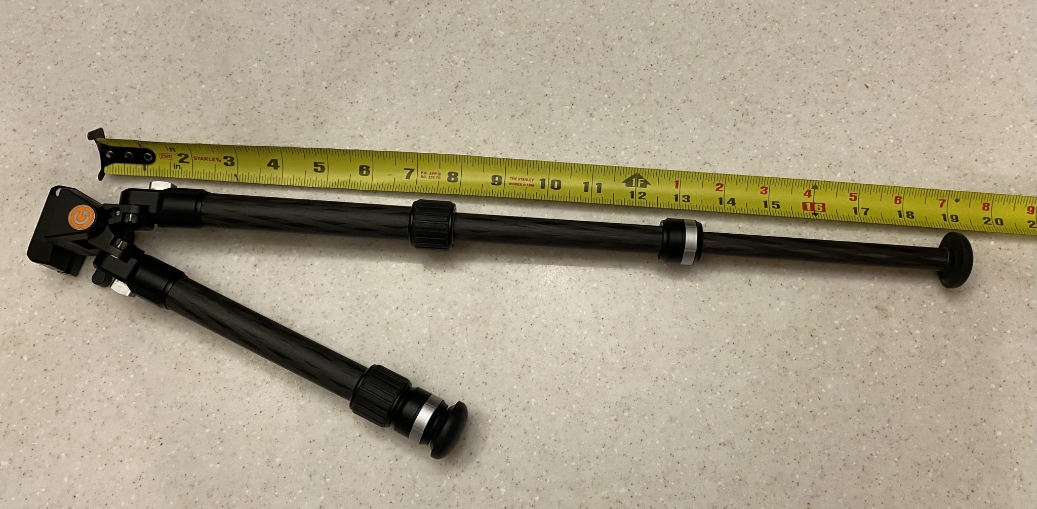

    Very excited about this. Price is right. 5"-19", Pull to deploy, spring loaded notched legs for height adjustment. I mean it's pretty much everything I'd want in a hunting bipod

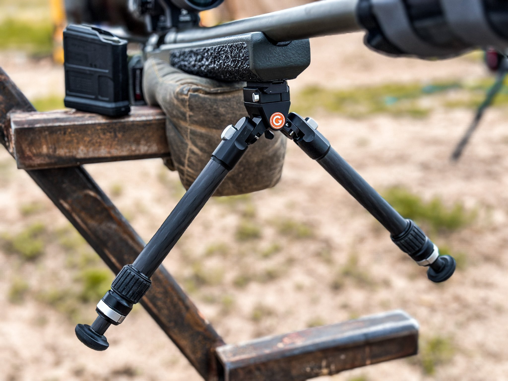

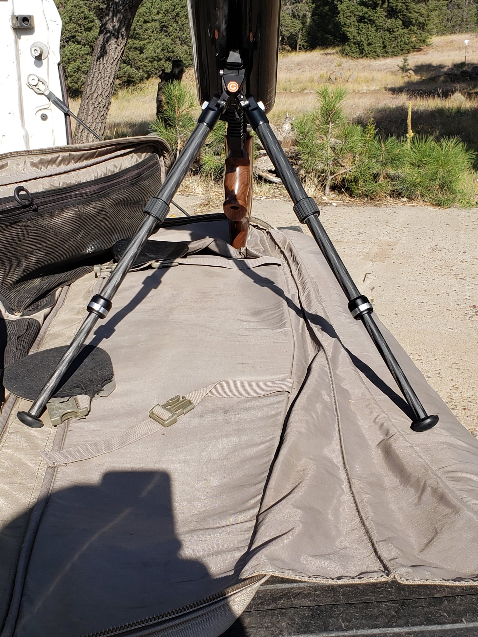

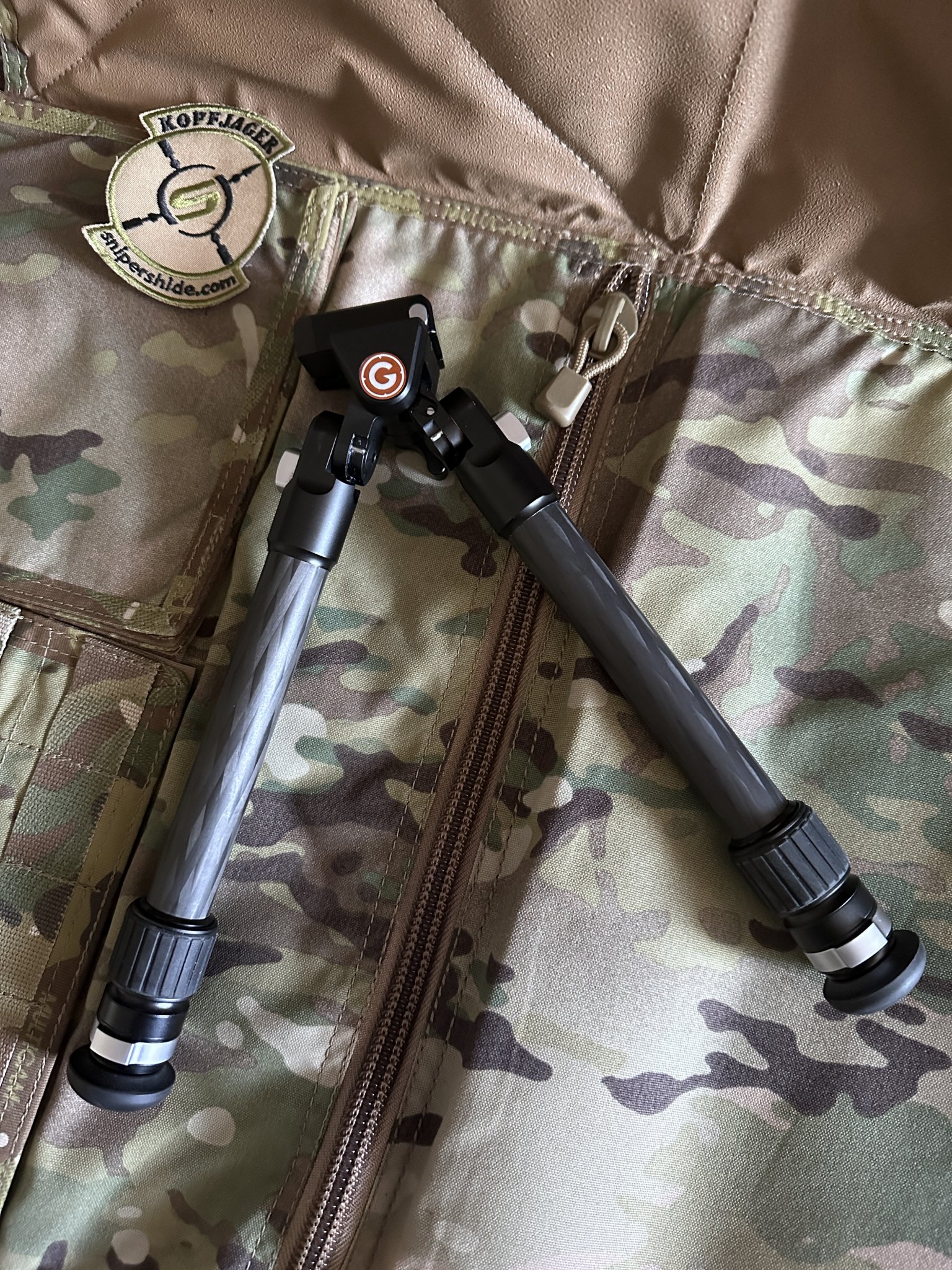

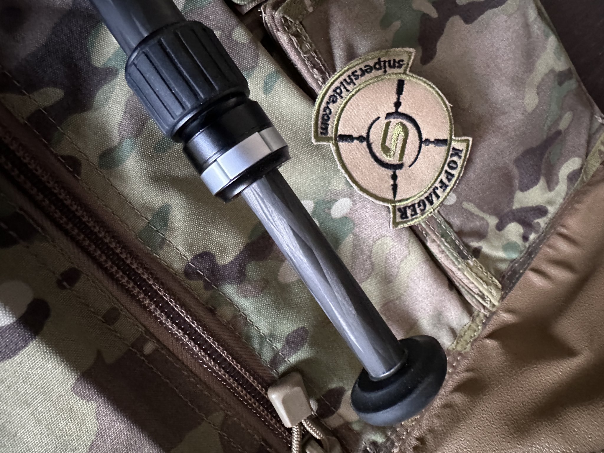

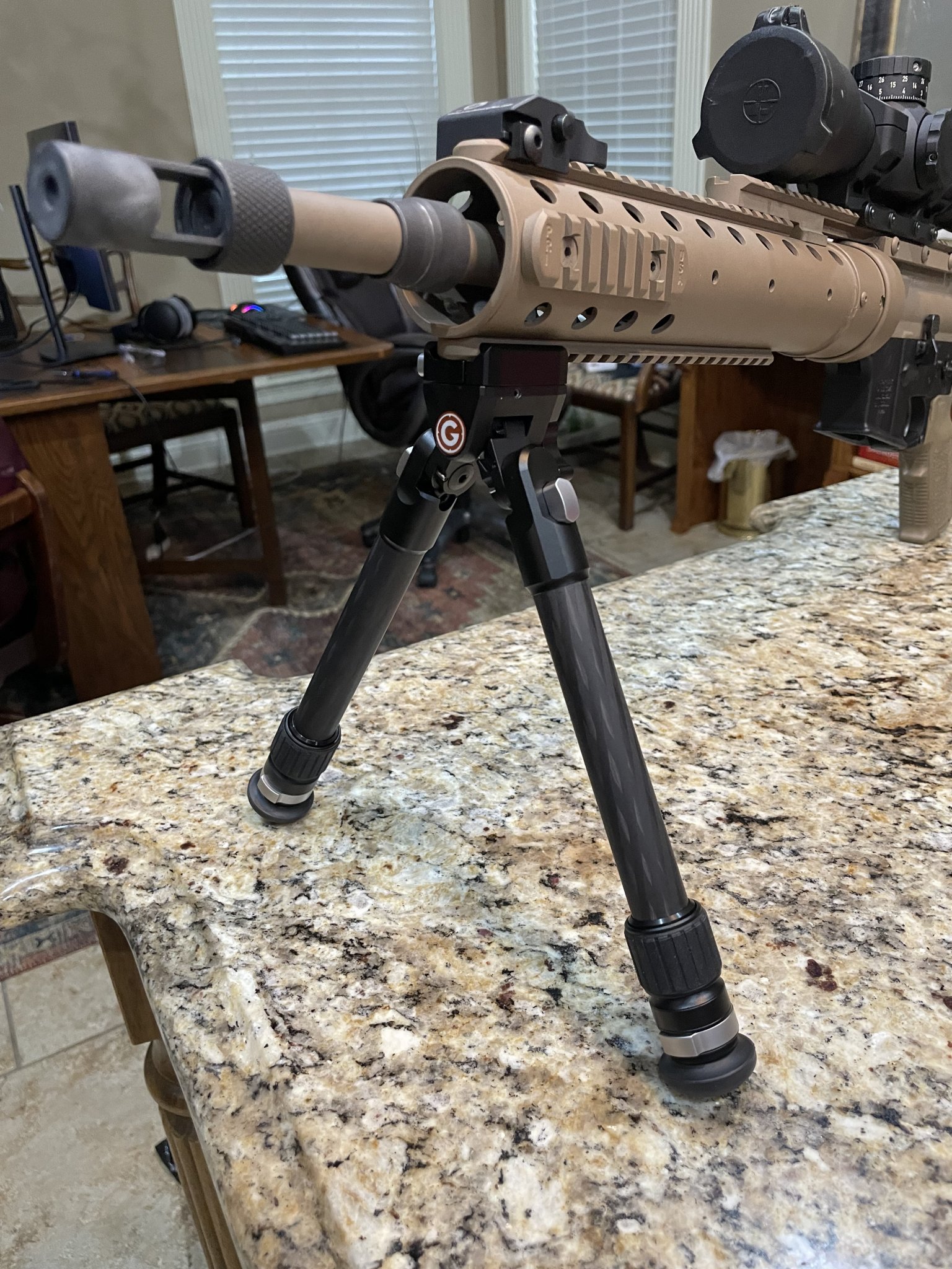

    So to note it seems very steady without the sleeves extended. With the full extension of 19” it’s not as steady but it’s still very stable. Enough that with a rear bag i would use it crouching all day. Also frees up a tripod if you and a friend are hunting together and are both sitting.
    One caveat is that the 6” position is with the legs splayed. So they can’t be directly stowed and deployed in the 6” position.
    Thus far i really like it though. Easily the most versatile bipod I’ve had to date. Is it as stable as my TBAC? No, but it’s very stable, lighter, and gives me a huge range of height

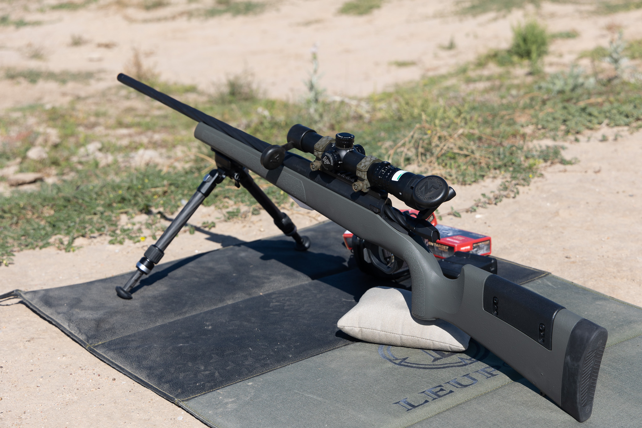

    I shot it a bunch this past weekend and really liked it, I had someone else shoot it too and they also agreed it was a good bipod
    Don't mind the Vortex I already changed that, we had to swap out a NF at the last moment, so originally it was meant to look like this :

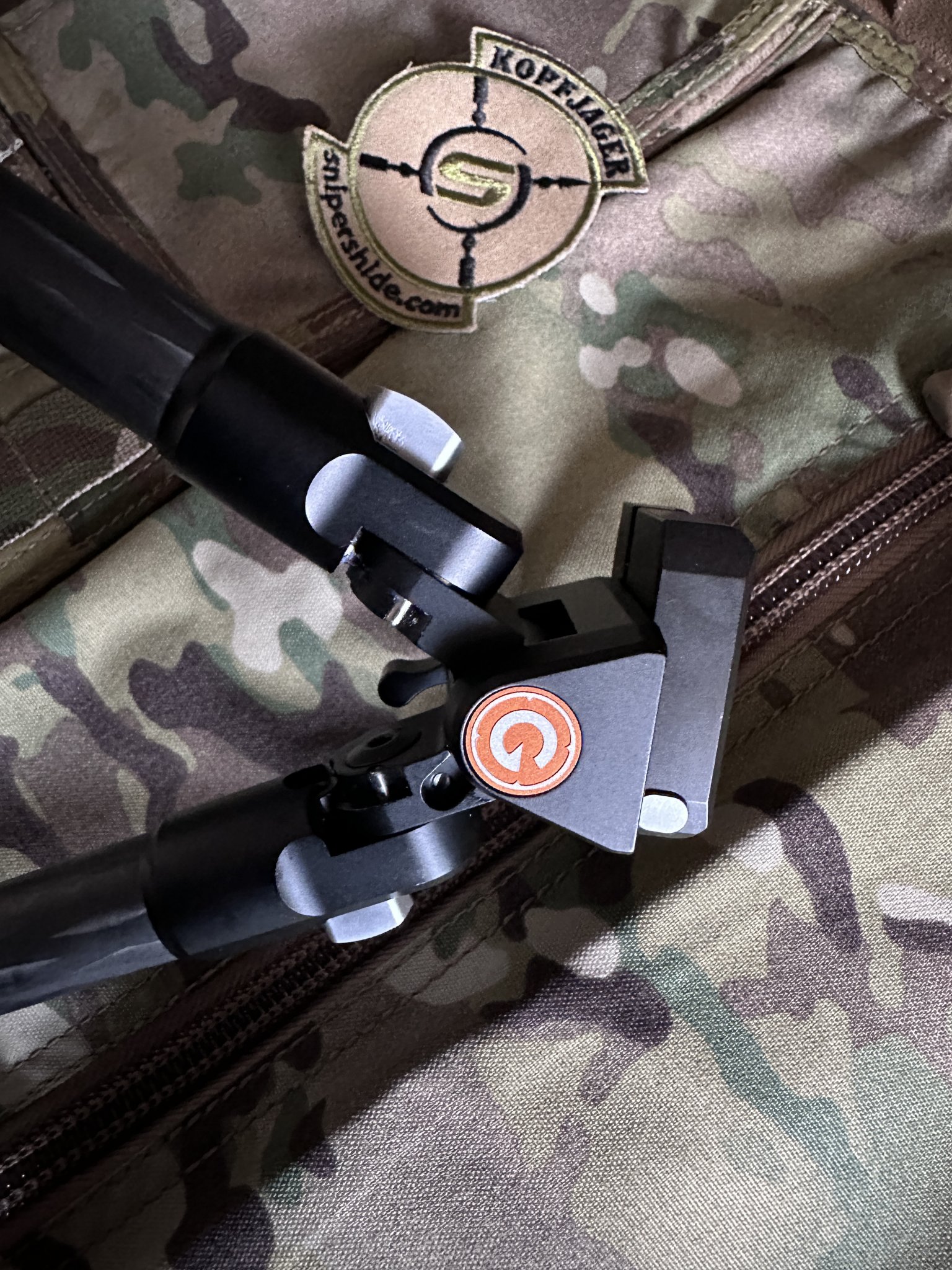

    We redesigned the leg locks on the quick deploy legs. Square cutouts and a square key make this about 3 times stronger. They won't collapse like earlier versions.
    Splay Detents
    We moved from 4 to 3 splay positions on the 2.0, but this allowed us to redesign and beef up the splay detents. These are MUCH stronger and showing far better wear over time and abuse.

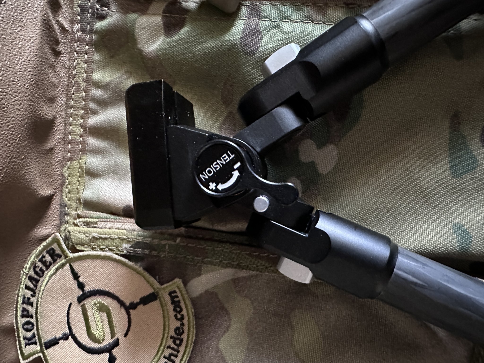

    Cant Tension
    This one wasn't really a complaint, but we knew it could be better. Finer thread on the cant tension along with high tech carbon friction elements and a slightly longer ratcheting lever make give it a much better feel with tightening and adjusting cant.

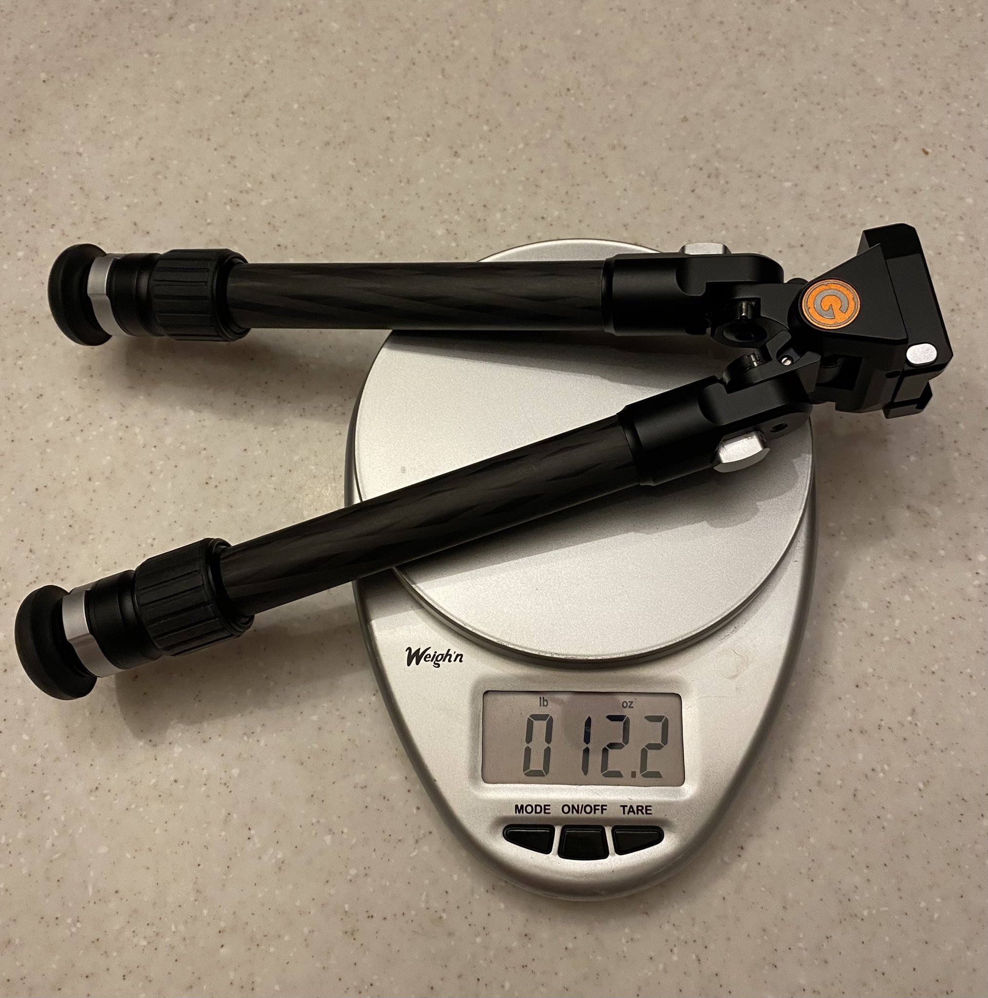

    Weight stays essentially the same at 12 oz.

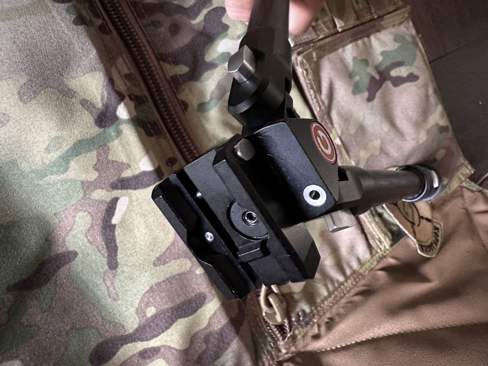

    Just received my Elevate 2.0 and it's pretty slick. Based on initial fondlings, as long as it holds up (no reason to think it won't), this is going to be about as good a hunting bipod as you're going to get. Looking forward to testing it out in the woods.
    I'll admit though I was upset with the tension lever at first until I read how to index it. Locks up like a champ now and I set mine so it doesn't interfere with the splay adjustment button when fully tensioned. Pretty cool tension system.
