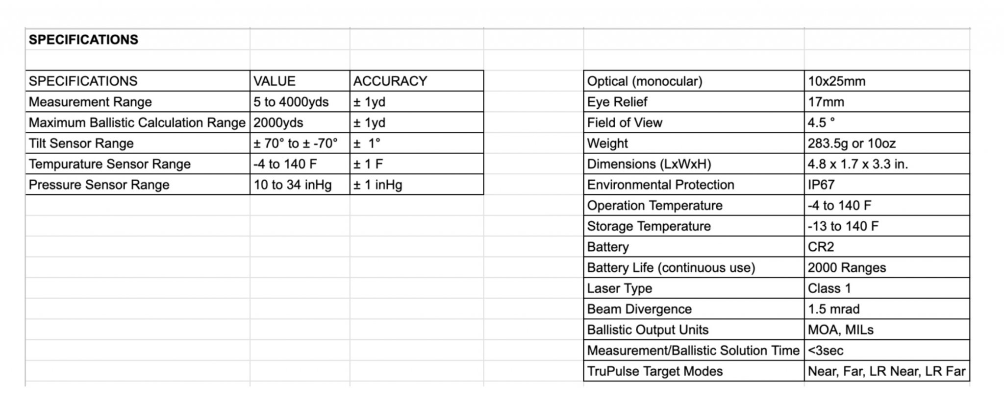

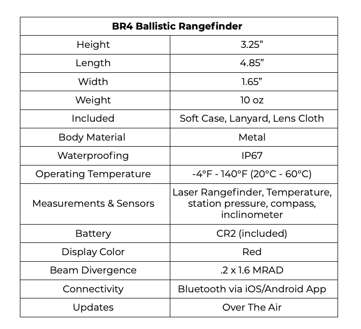

    The website shows this; interesting that the specifications in the manual don't match the web regarding divergence (called and let them know so they can correct):
