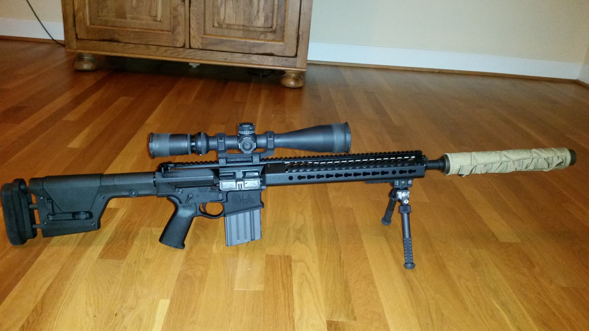

    My Gap10 Gen2 (Seekins setup) came with a Badger 306-97 unimount, 1.4" high 30mm. Per picture below, it was perfect with the AMG's 50mm objective and Defender caps. Now the G2R has a 56mm objective that has an OD of 2.55" vs the AMG of 2.32". That puts the bell about .120" closer to the rail, so a 1.55" height to center would be about perfect. Remember that with a 20moa cant on the bell ends up a bit closer to the rail than the ocular. The 1.45" measurement is at mount midpoint.
    For a unimount with a 56mm bell, I would probably go with a Badger 306-98 or better yet, the 154-342B. Otherwise, rings or Spuhr SP-4602 or 4603.

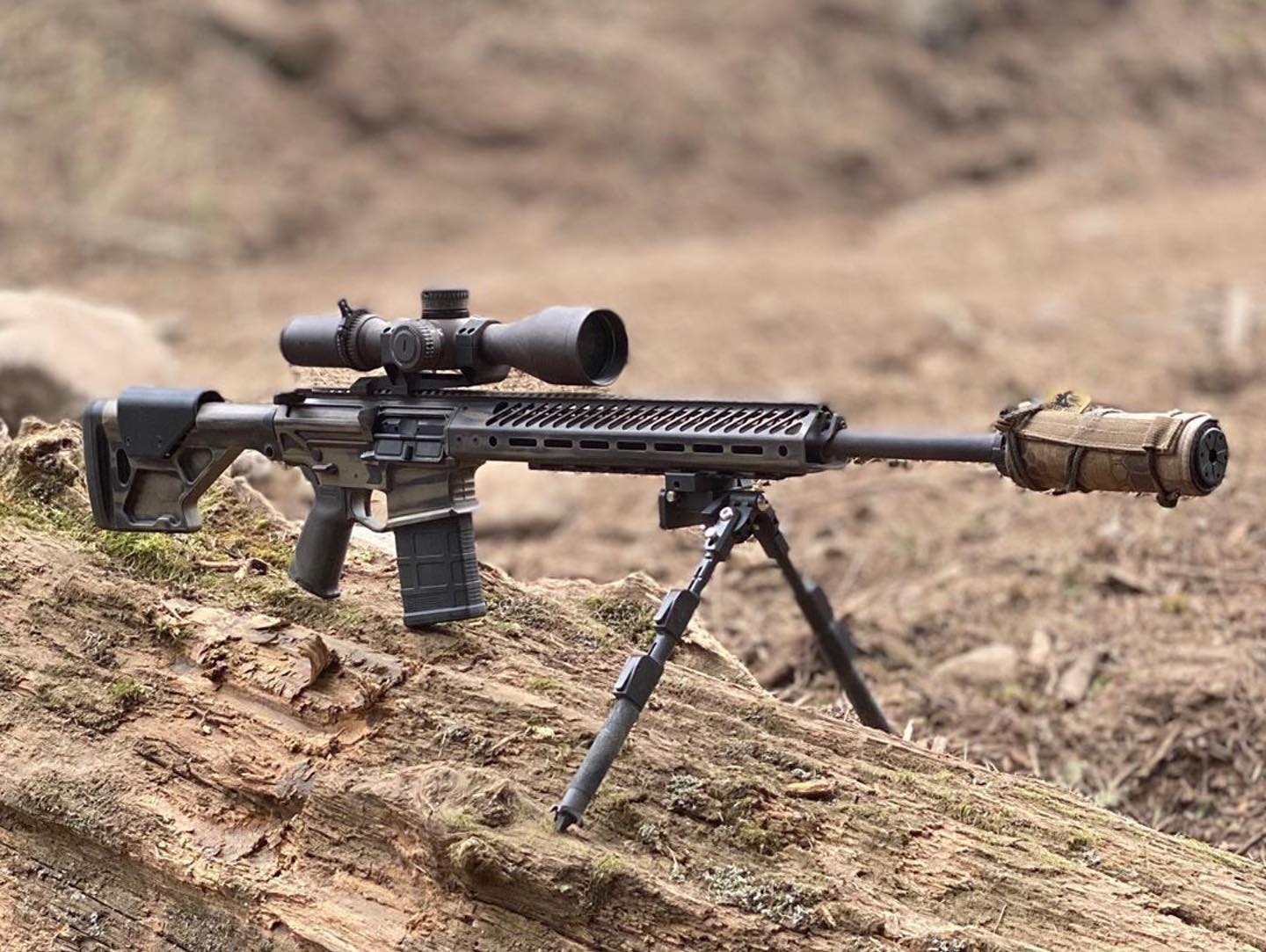

    Check this post on Seekins' Facebook page.
    Rifle: Seekins Precision M Series with their billet iRMT-3 upper and SP10 lower & full Ambi controls
    Handguard: Seekins 15” SP3RV3 M-Lok
    Arca Swiss Rail: Seekins MRAS M Lok
    Caliber: 6.5 Creedmoor
    Barrel : 22” Seekins 5R machined 416 stainless steel barrel with 1:8 twist
    Gas Block: Seekins Select Adjustable Gas Block
    Stock: Seekins ProComp 10X fully adjustable stock
    Grip: Magpul MOE+ grip
    Trigger: @timneytriggersusa Single Stage, 3lb pull
    Scope: @vortexoptics Razor HD Gen II 4.5-27
    Scope Mount: Vortex Optics Precision cantilever Mount
    Muzzle Device: SilencerCo ASR Muzzle Brake
    Suppressor: @silencerco Omega 300 with the ASR QD Mount
    The Vortex mount he lists, if 20moa, is 1.574" to ring center. Looks like it has just enough clearance for Defender caps.
