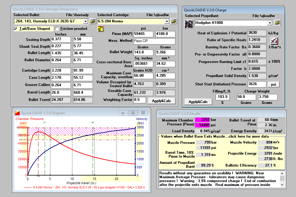

It's really tough to tell someone they need more powder, but here is a load like yours in Quickload, yellow means danger on the low end of spectrum.
Load 3 rds at 58gr and fire them with this powder.

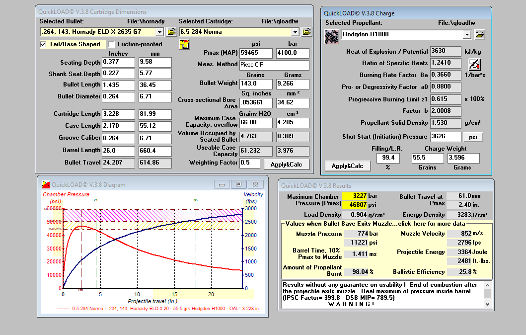

Good catch.
Here's 58gr of H1000. feel free to work up to it, heck, 57gr may have you back on track. I'm assuming you used Hodgdon's data? Some of there max stuff is borderline on the low end.
One more, I take it you are new to reloading, powder variances from lot to lot are real, best to buy a few lbs, you may go through this again on your next can, even though H1000 is not known to be as finicky as varget or 4350.
