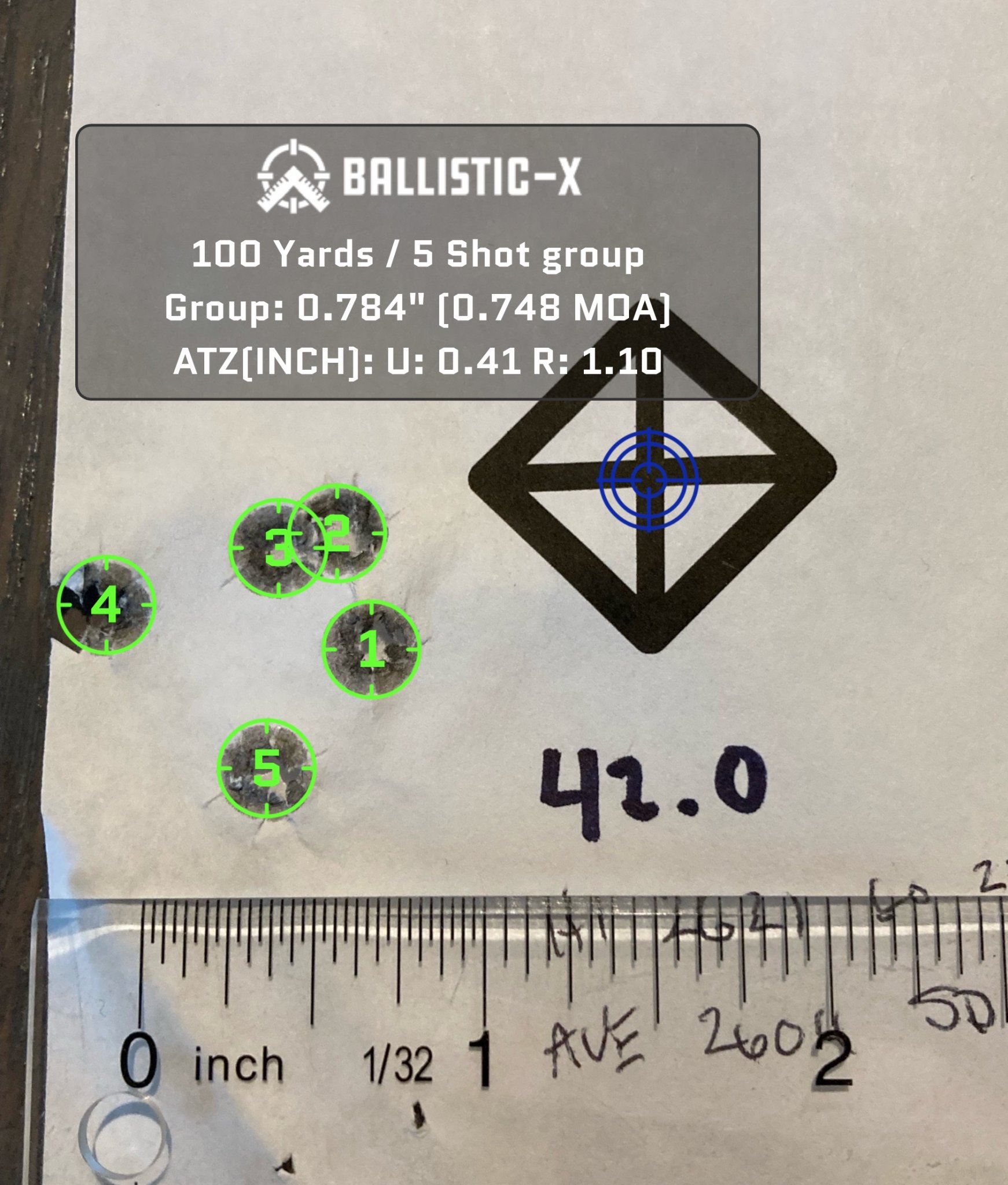

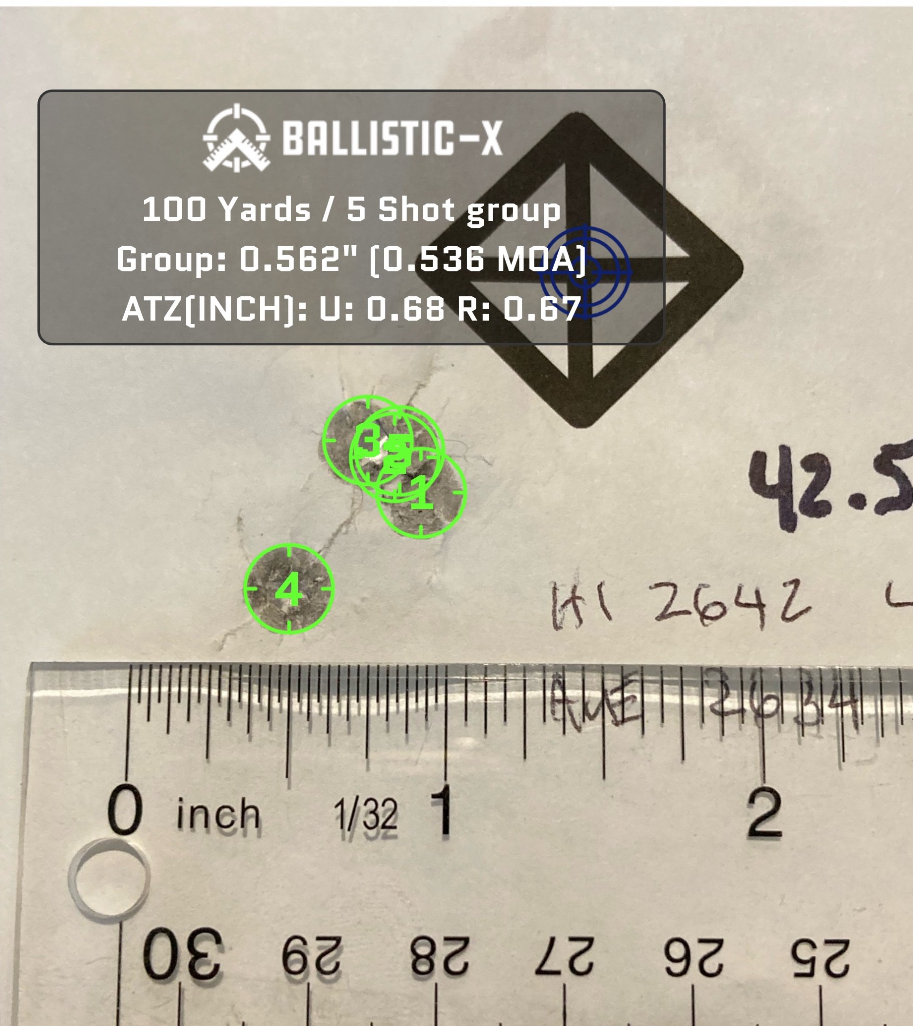

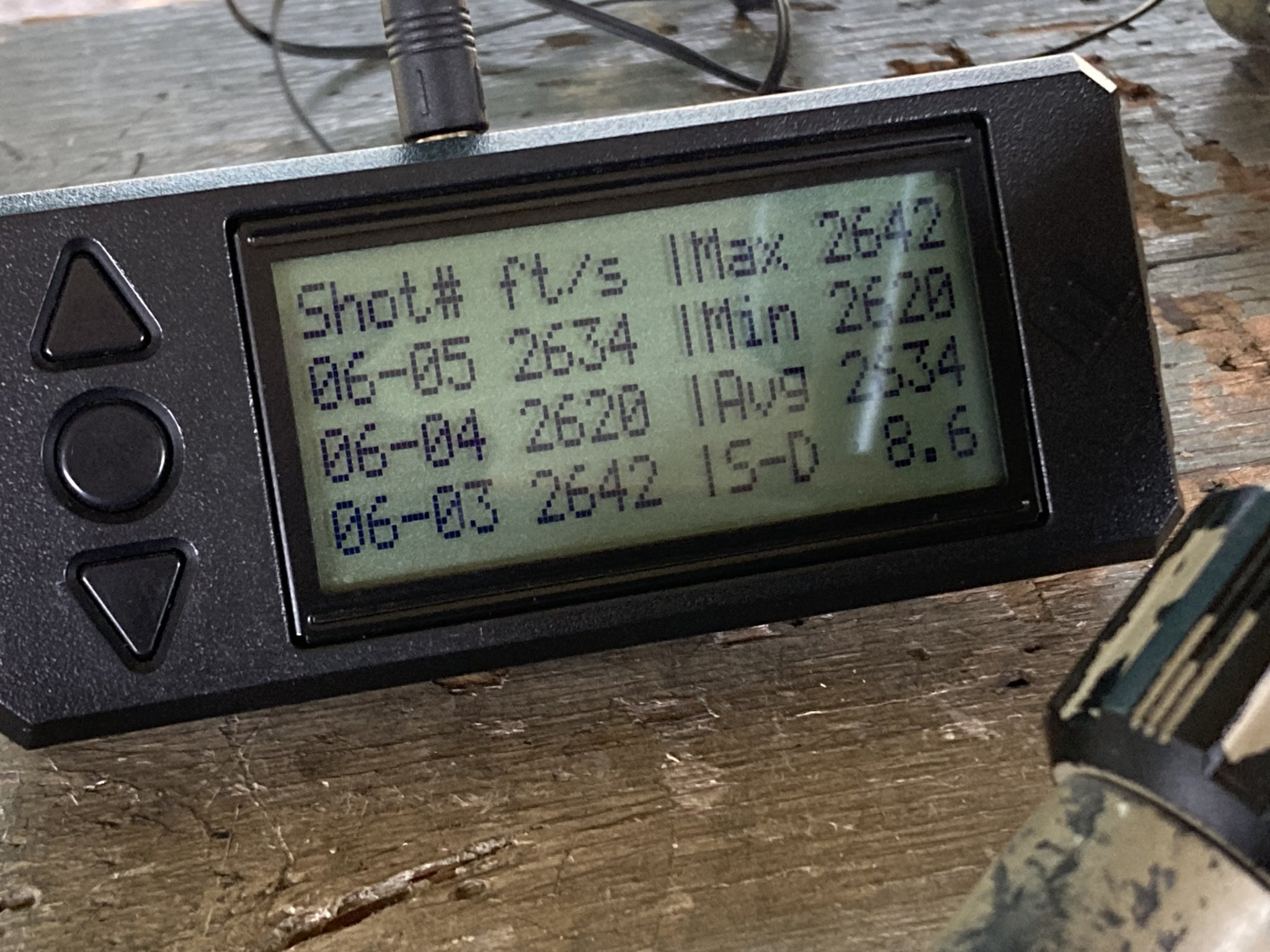

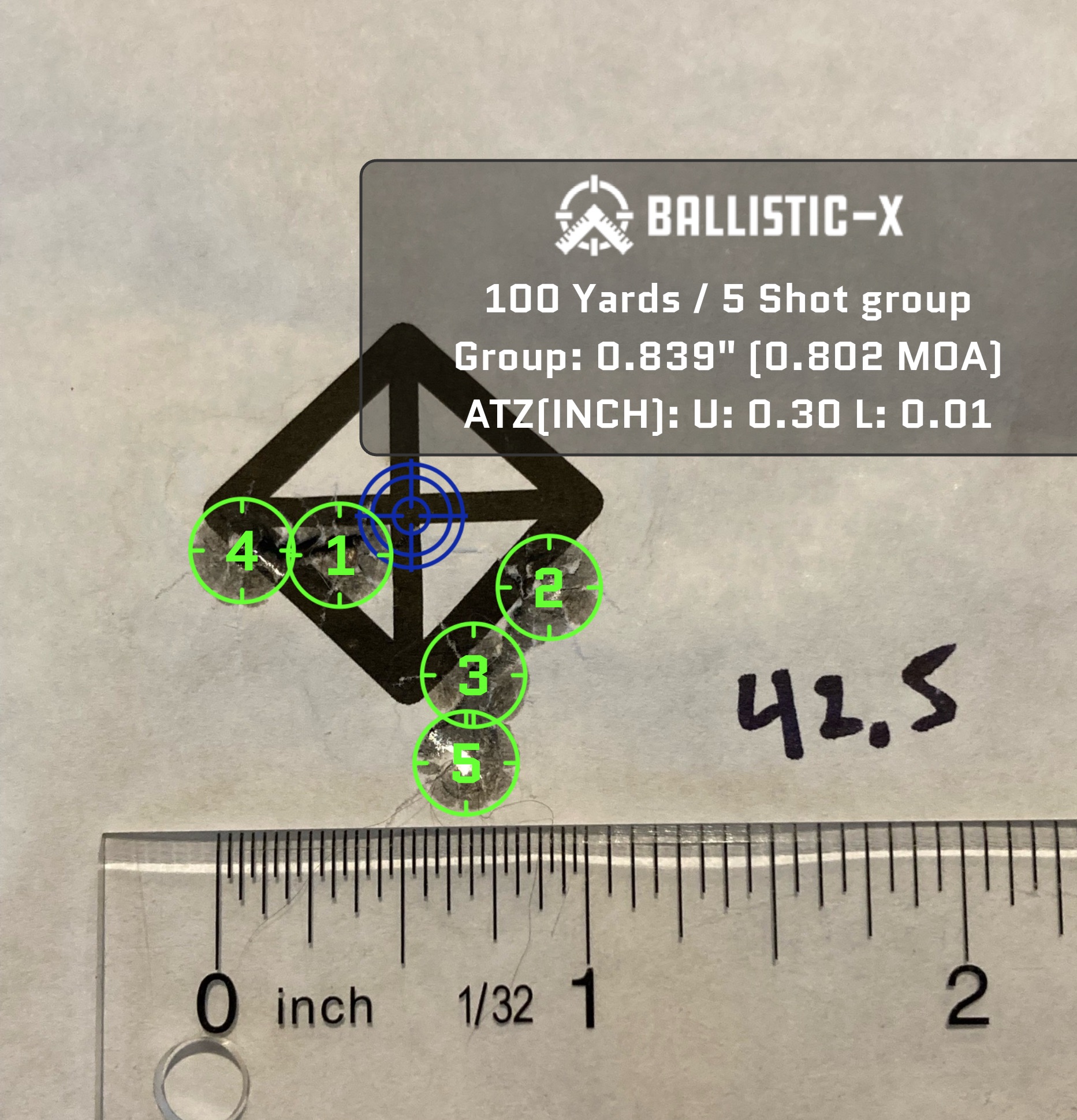

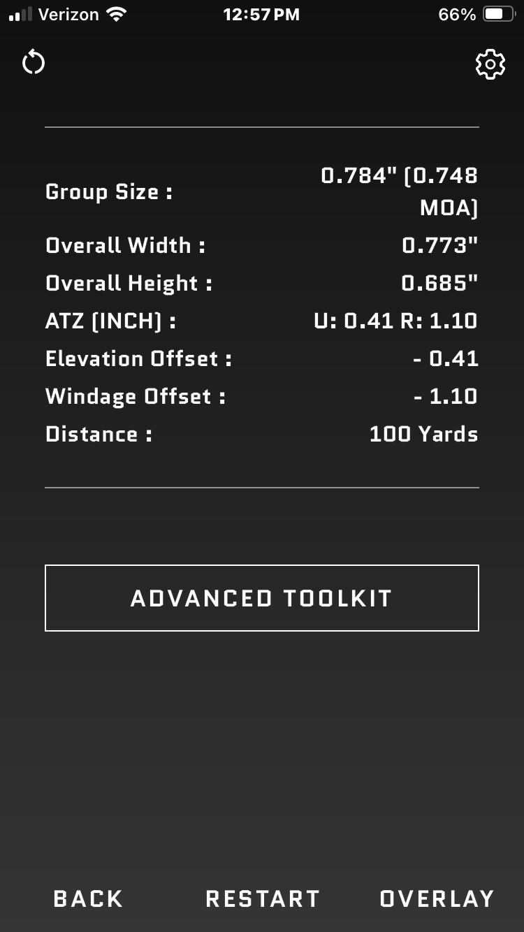

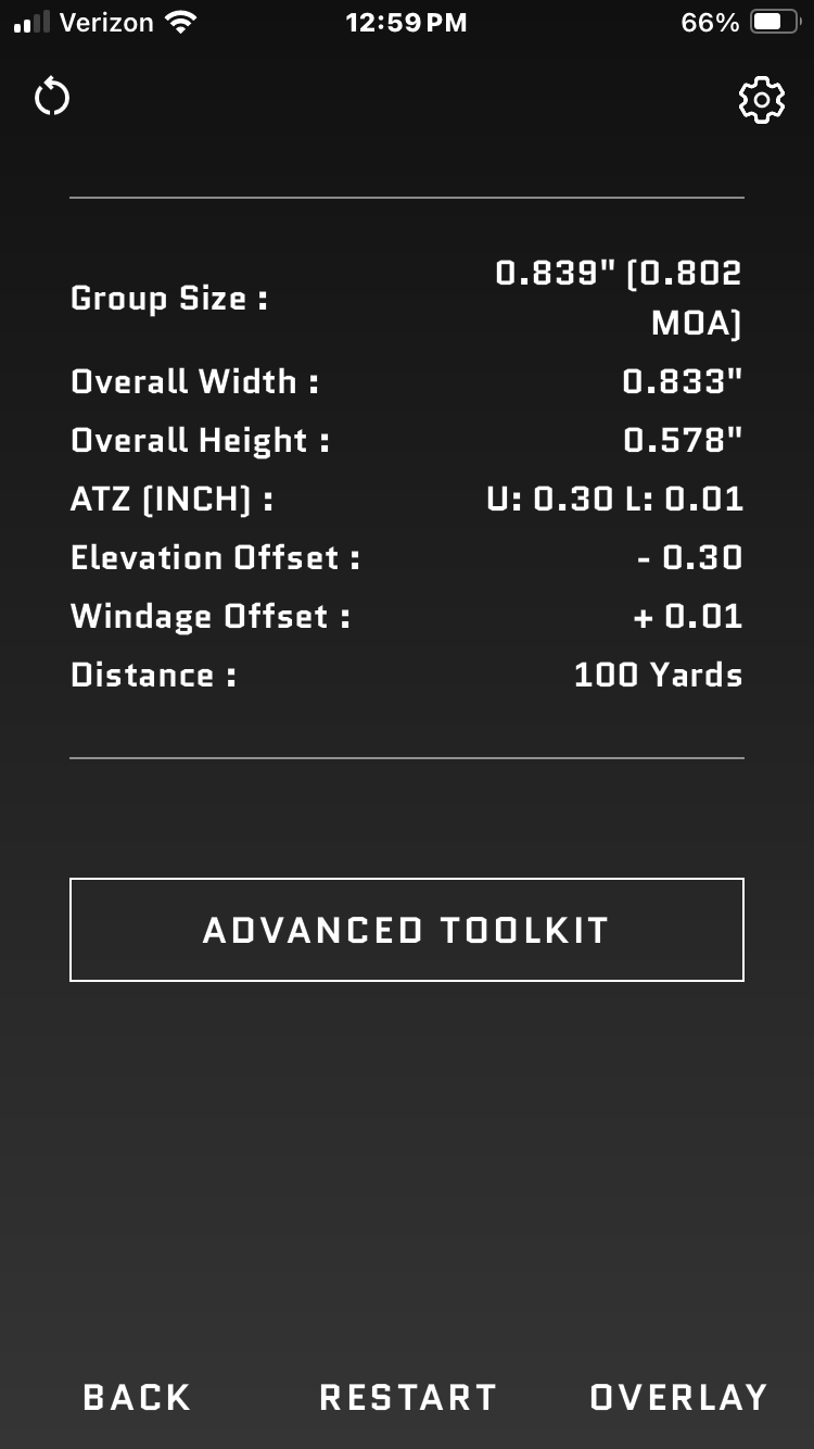

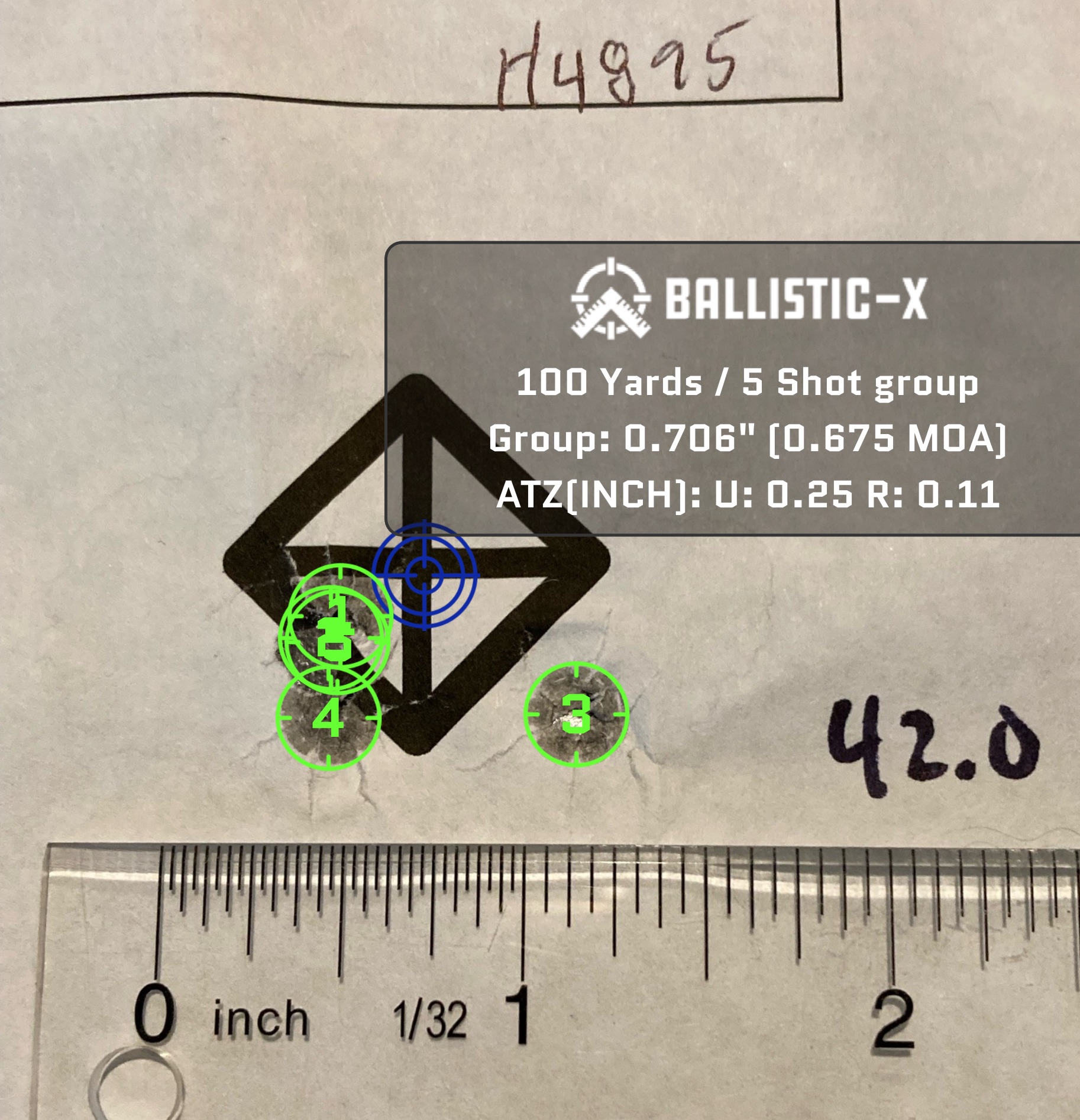

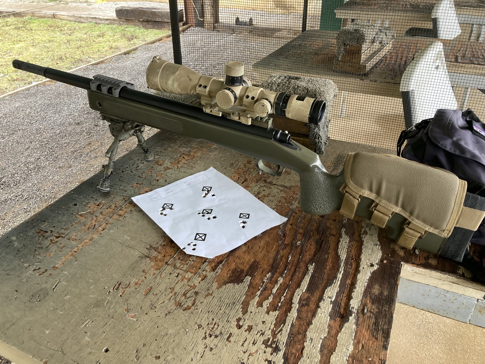

Rifle GAP barreled 20” M40A5
LC LR brass sized in RCBS GM full length die
.003 HS .336 neck
H4895 41.5 gr to 42.5 gr. In .5 increments
Nosler 175 @ 2.810” BTO
Initial load dev at 100 yards temp 50/ 30.09/ 100%
