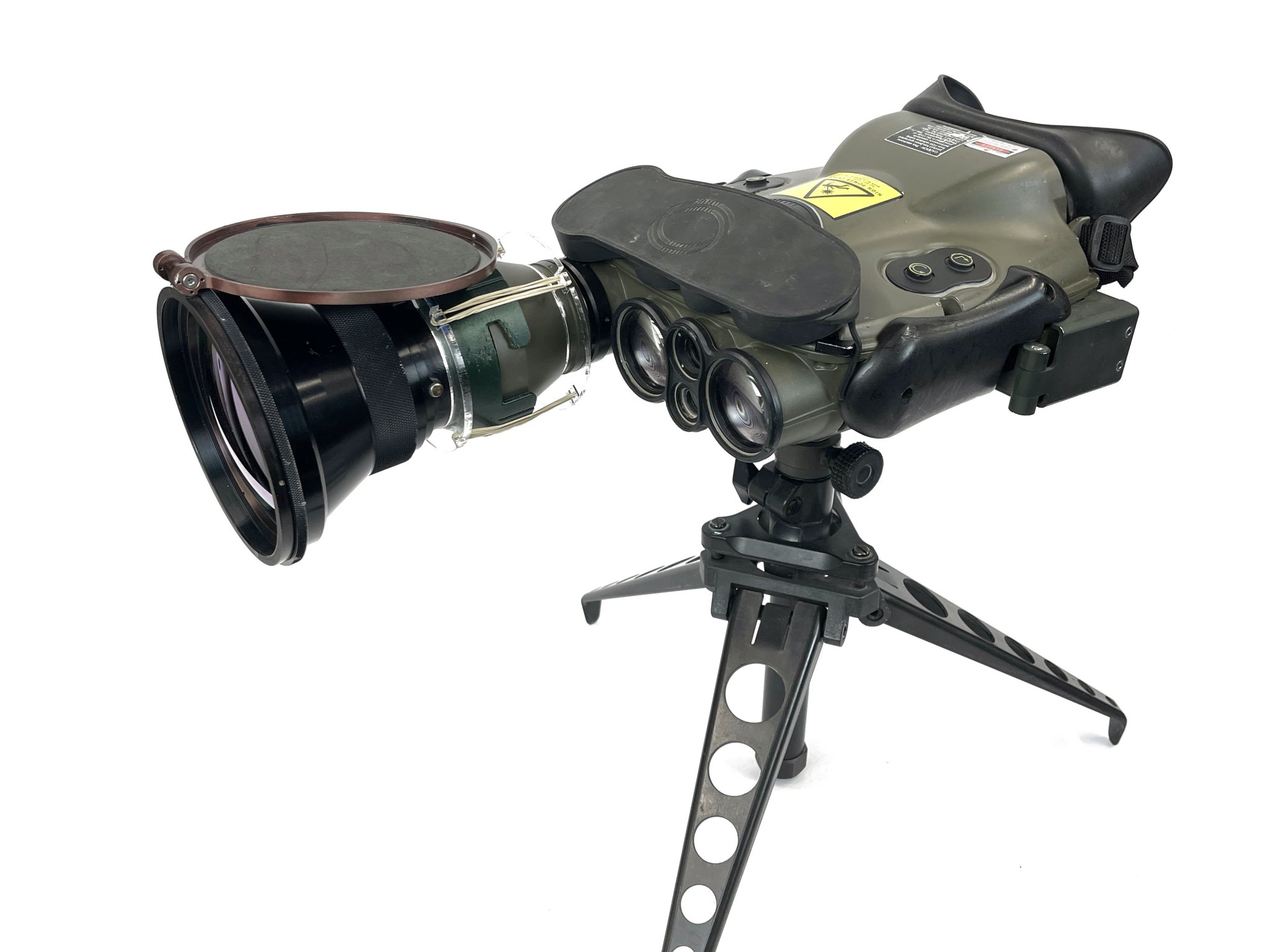

The JIM LR with factory 2x MWIR afocal magnifier is a pretty capable thermal spotter. But I was curious how it would perform with my Flir Recon MWIR afocal 2.5x magnifier mounted in front of the JIM LR 2x magnifier. It is nothing short of stupendous.
You can sort of see the OD green 2x magnifier between the big FLIR magnifier and the JIM LR spotter.

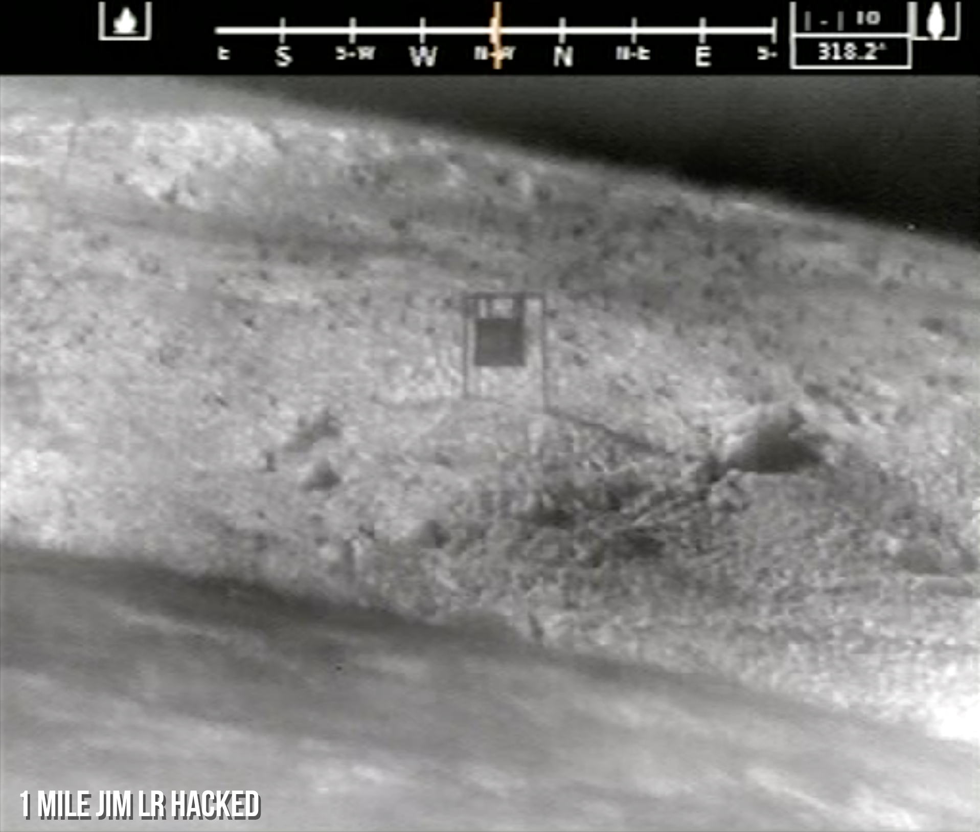

Here is our 1 mile target. The steel is 3 ft wide.

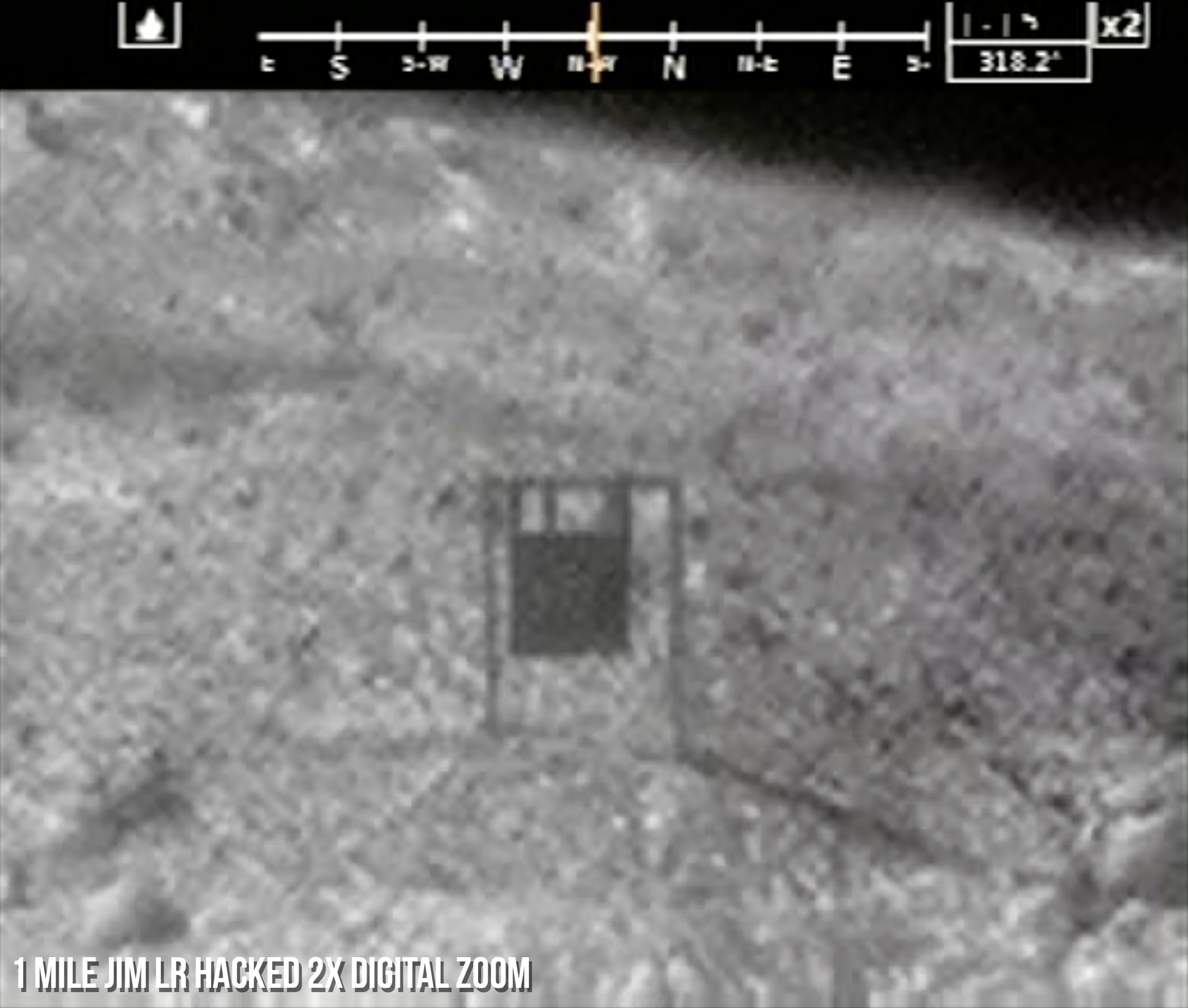

The image above is simialr to what I can get out of my hacked FLIR SeeSpot III using the same FLIR recon magnifier. But the JIM LR is 320 res vs the SeeSpot III which is only 256 resolution. The JIM LR also has digital zoom. Here is the 1 mile target with digital zoom.

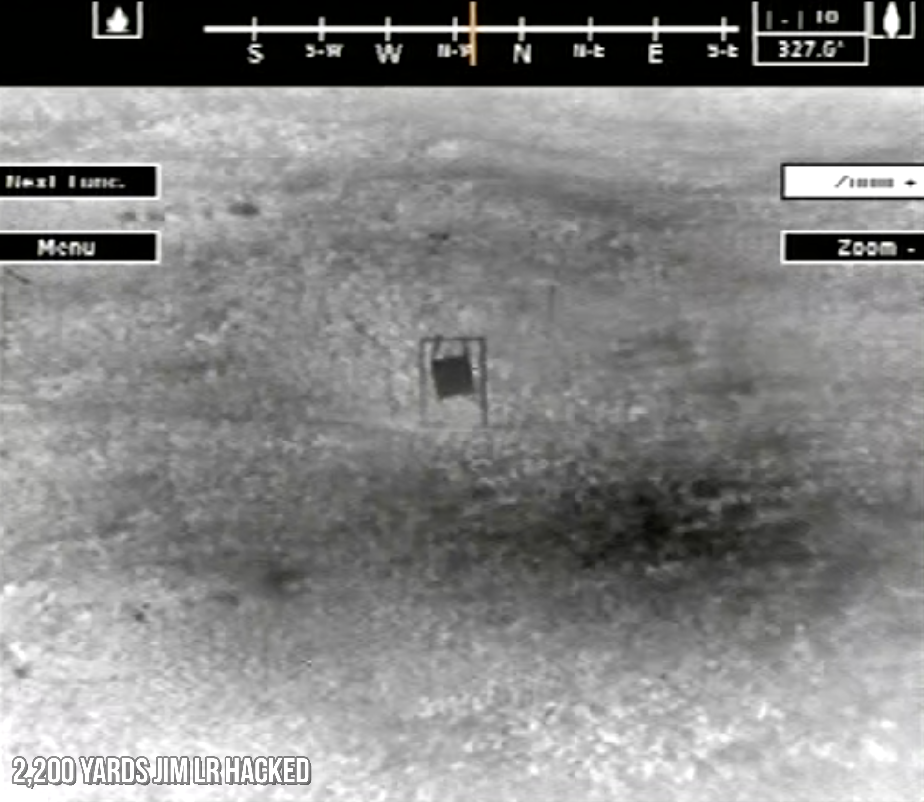

Now here is our ELR 2,200 yard target.

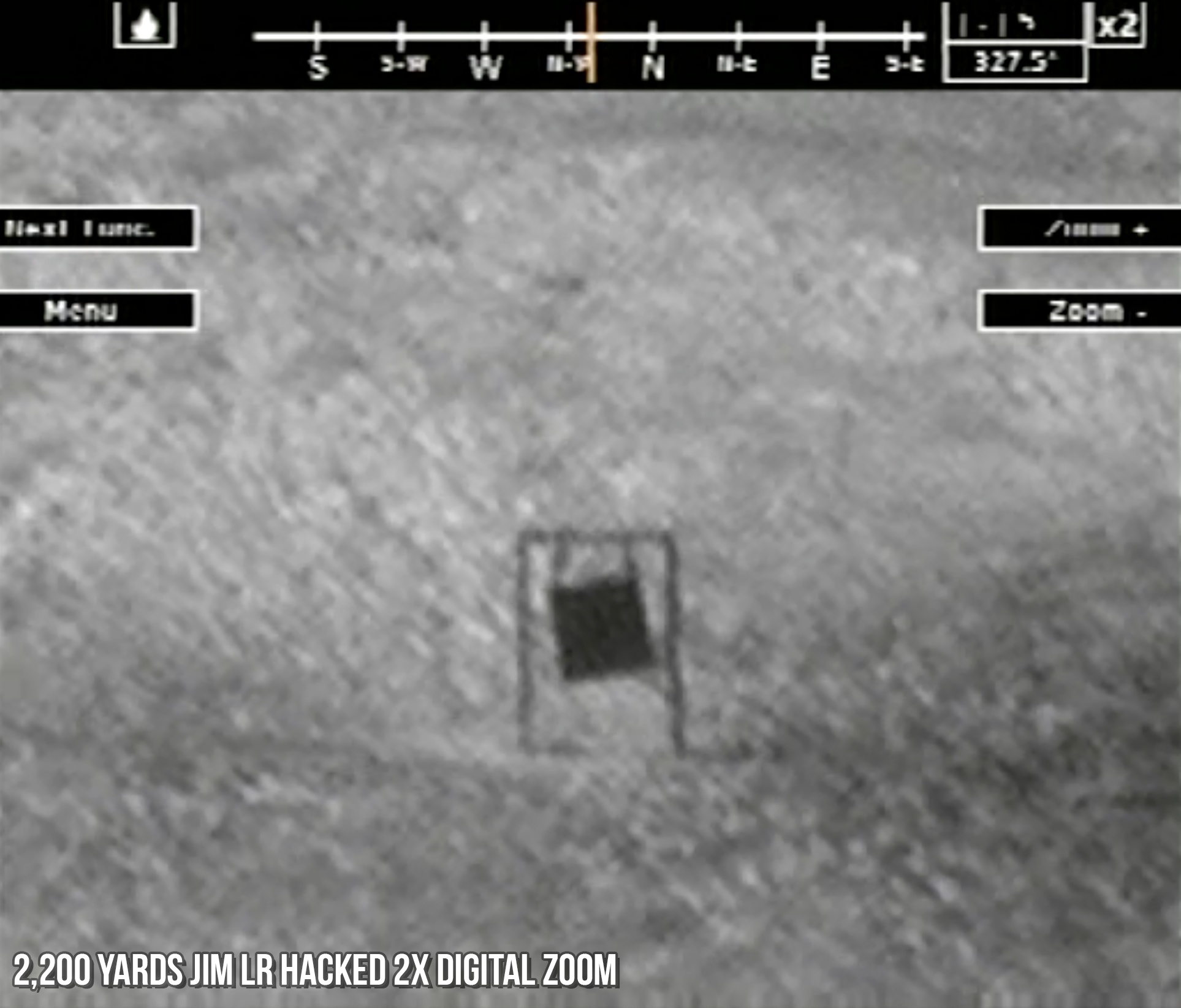

Now with 2x digital zoom.
