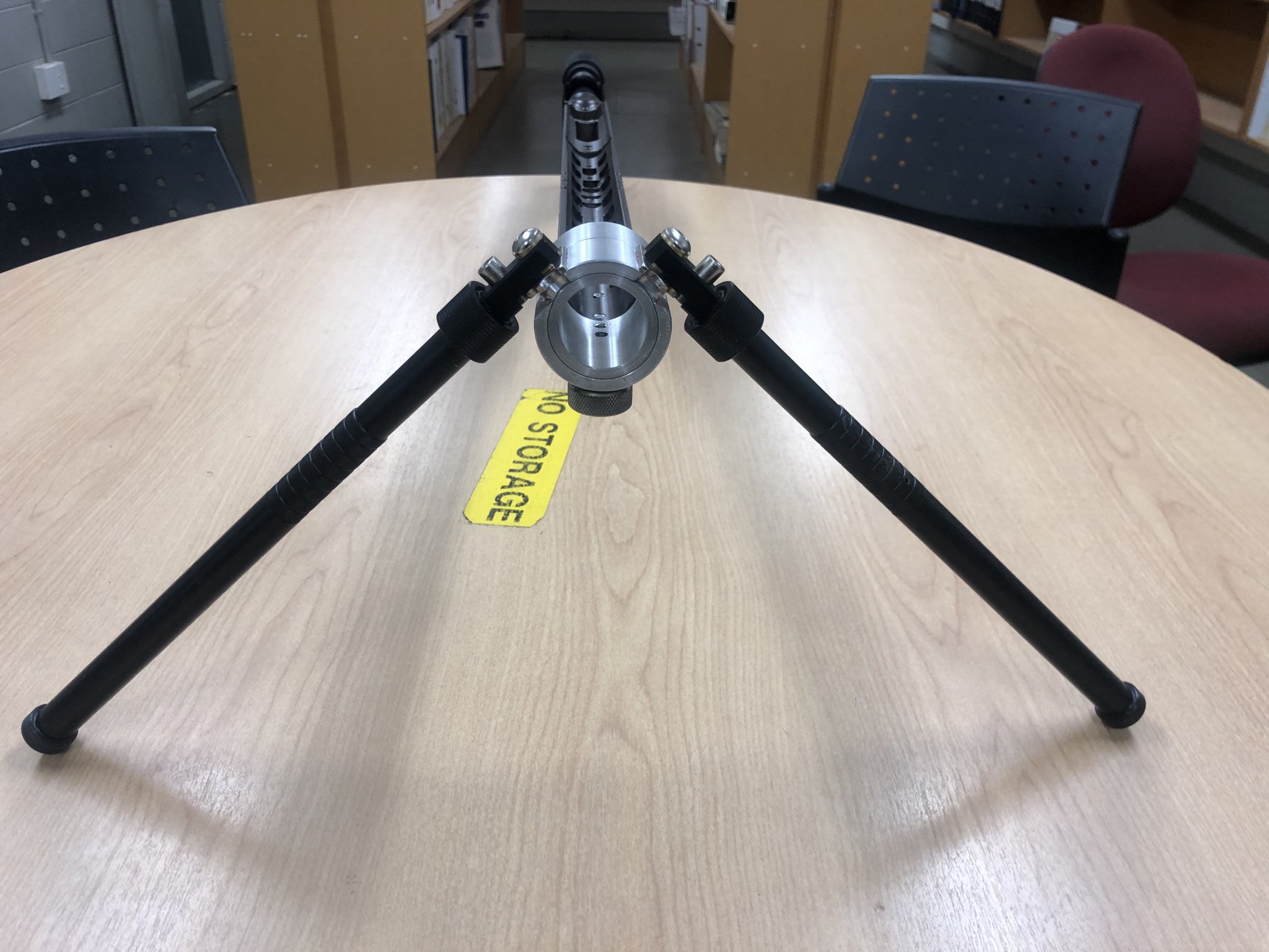

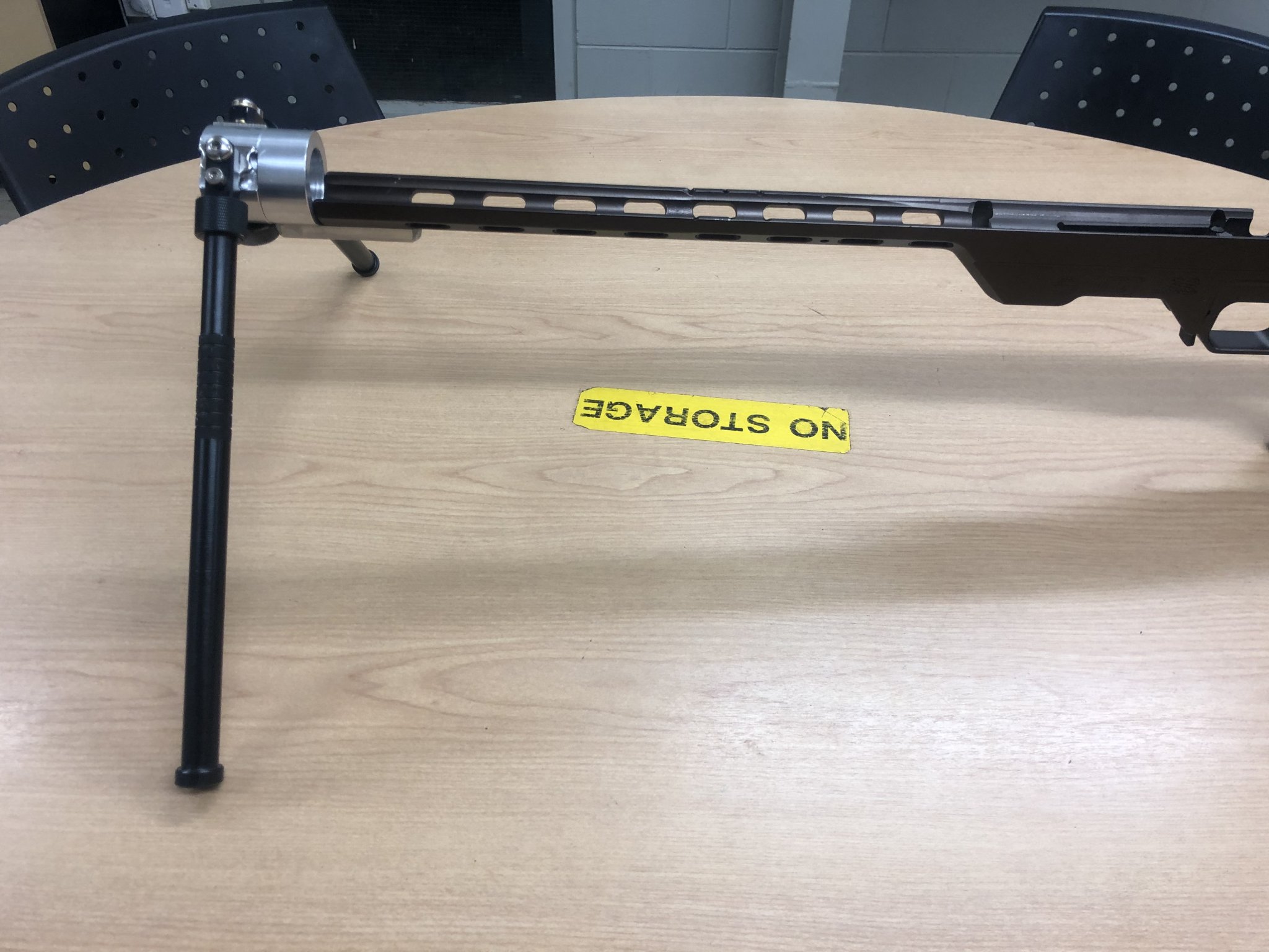

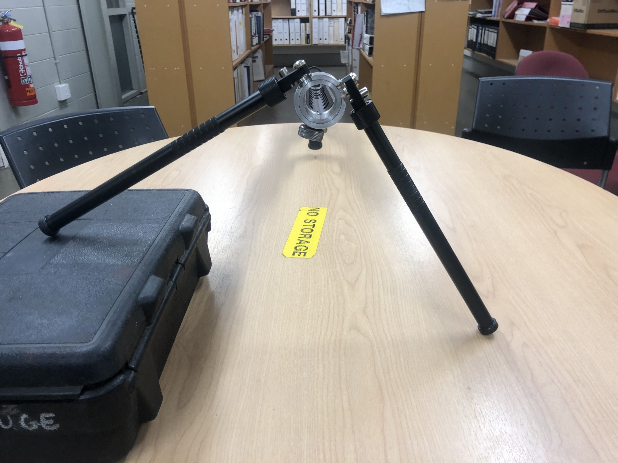

Had some free time at work so thought I’d have a wee go at building my own bi pod. What I was aiming for with this design is speed off set up on any surface even uneven ground. The front section with the legs on it can rotate 360 deg so on uneven ground you just sit the rifle down and release the one locking screw rotate the rifle level and lock it back up again

Looks like it is modeled after Mark&Sam's. Nice work.

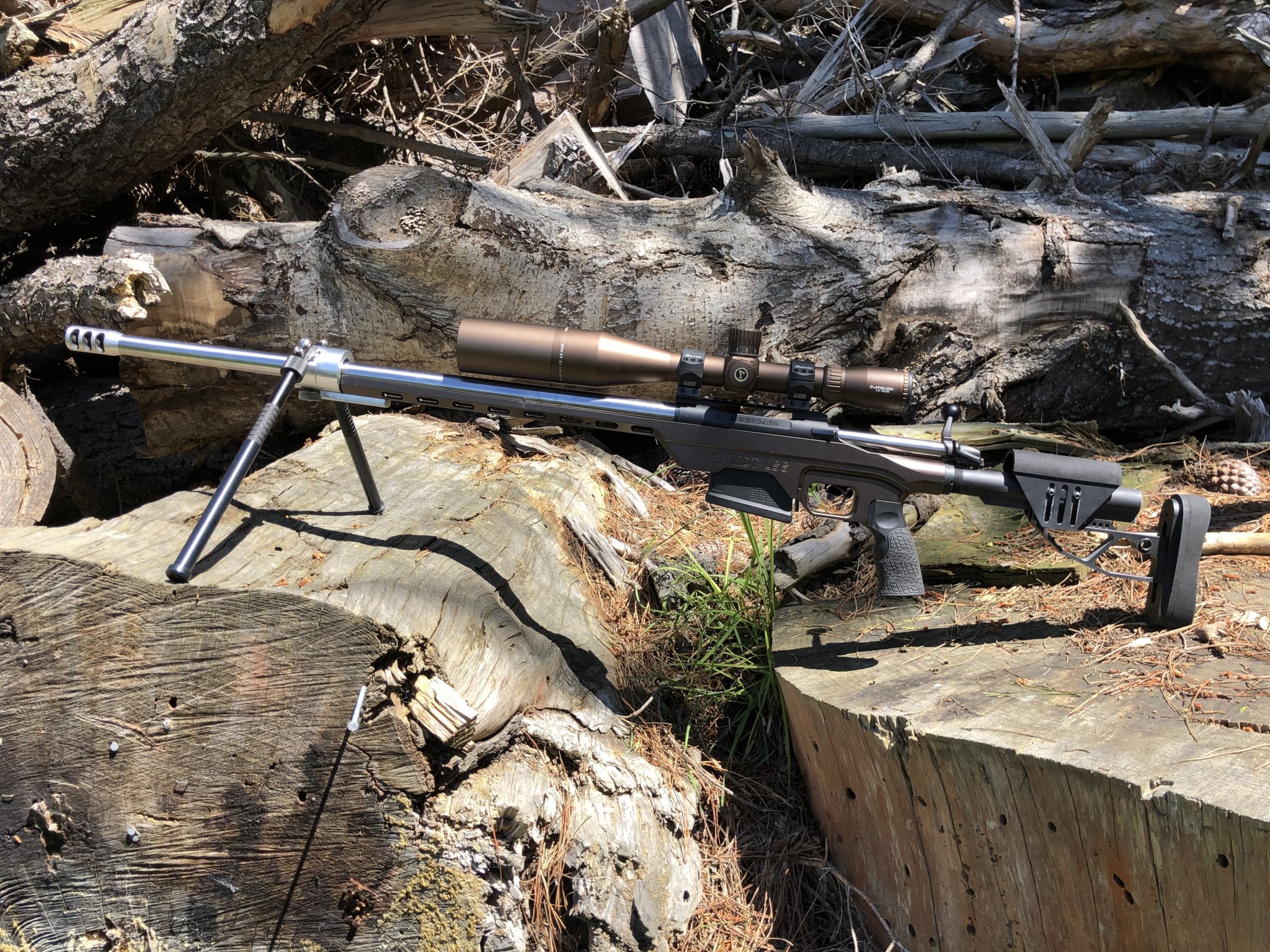

Went out and tryed it for the first time today and worked bloody well. Wet happy with it so far. And here is a shot off the finished rifle
