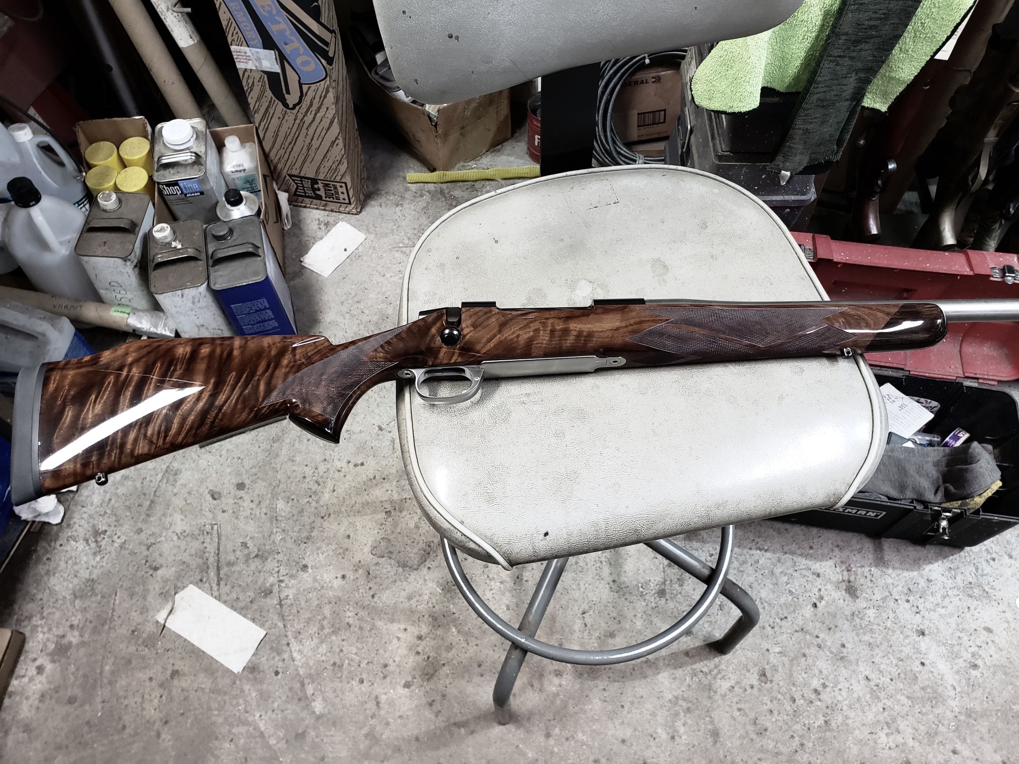

    I have a pretty cool project going on. Approximately 2-3yrs in length. That’s finally getting close to completion. I think you guys may find interesting.
    It started with a Claro Walnut blank that was gifted to me by a good friend of mine. I previously built a wood gun on another walnut blank that turned out excellent. I built that first rifle for my oldest son. So I decided to build another classic hunting rifle from this blank as well.
    I started with all the metal work with the following components:
    BAT Machine long action
    Bartlein 24in 1:10 twist barrel # 4 contour
    Sunny Hill BDL bottom metal
    Jewell trigger
    Custom Vias style muzzle brake
    300 win mag
    Next came carving the blank. I’m fortunate enough to be close friends with two very talented local gunsmiths…Dave Bruno from Bruno Precision Rifles…and Brian Swintowsky. Dave did all the metal work. Brian is one of the few guys left in the US that will hand carve a blank. So he got to work on it about 2 weeks ago.
    Started with some rough shaping the blank into a Monte Carlo style stock.
    I decided to have Brian put in 1/4in of cast off into the stock. I had this done on my first wood gun and it makes the rifle incredibly easy and comfortable to get behind quickly. You can see the cast off here.
    Next Brian rubbed the stock a bit with some oil to see what kind of color and grain was popping out.
    Here’s a little better picture of the rough shaping and the color potential.
    Here Brian put in the comb and a dark walnut 45* end cap. As well as a dark walnut cap on the bottom of the grip.
    Rifle was glass and pillar bedded. Then had the first coat sprayed on.
    Can really see the grain and color coming out now.
    Another coat of spray.

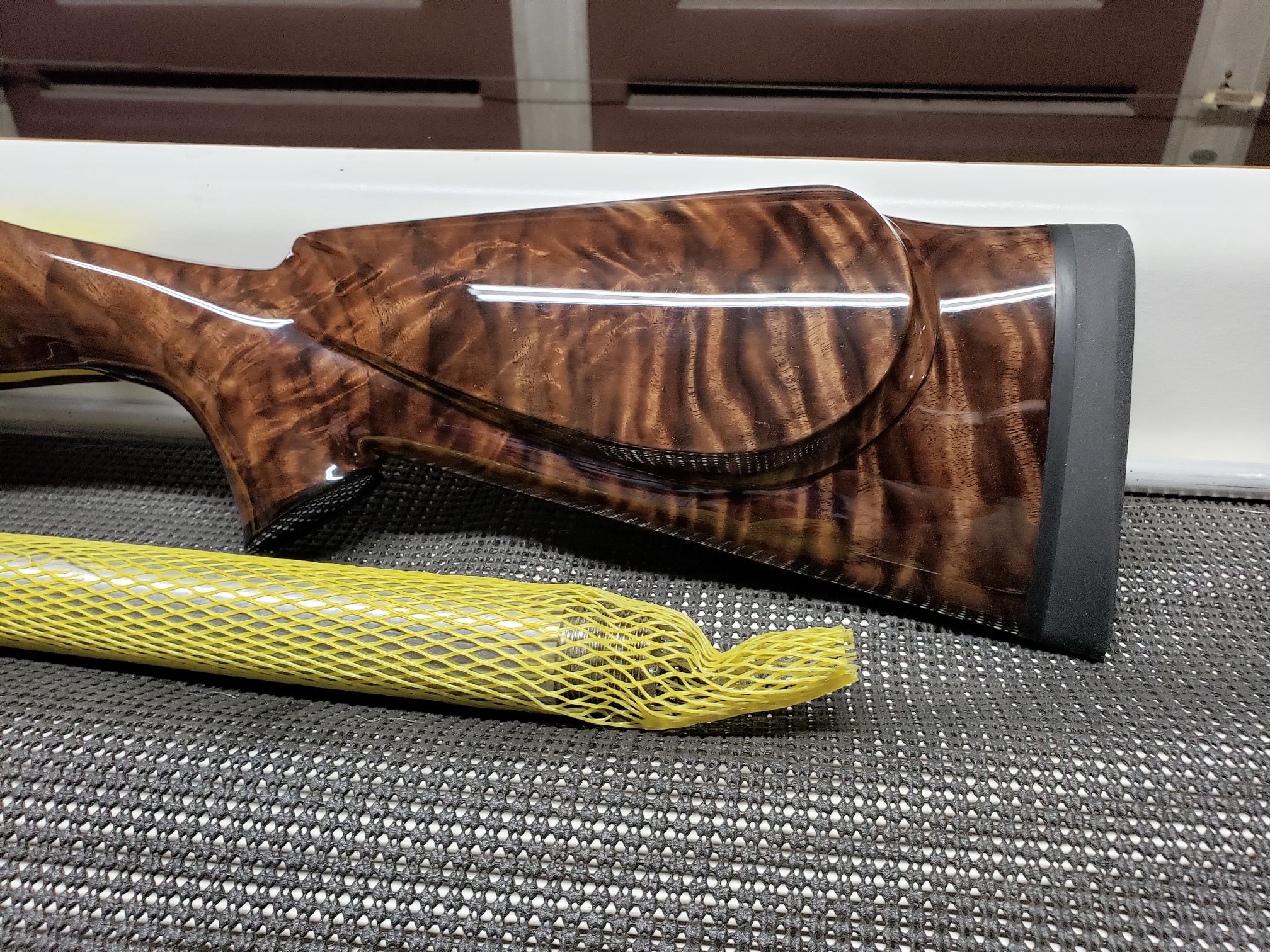

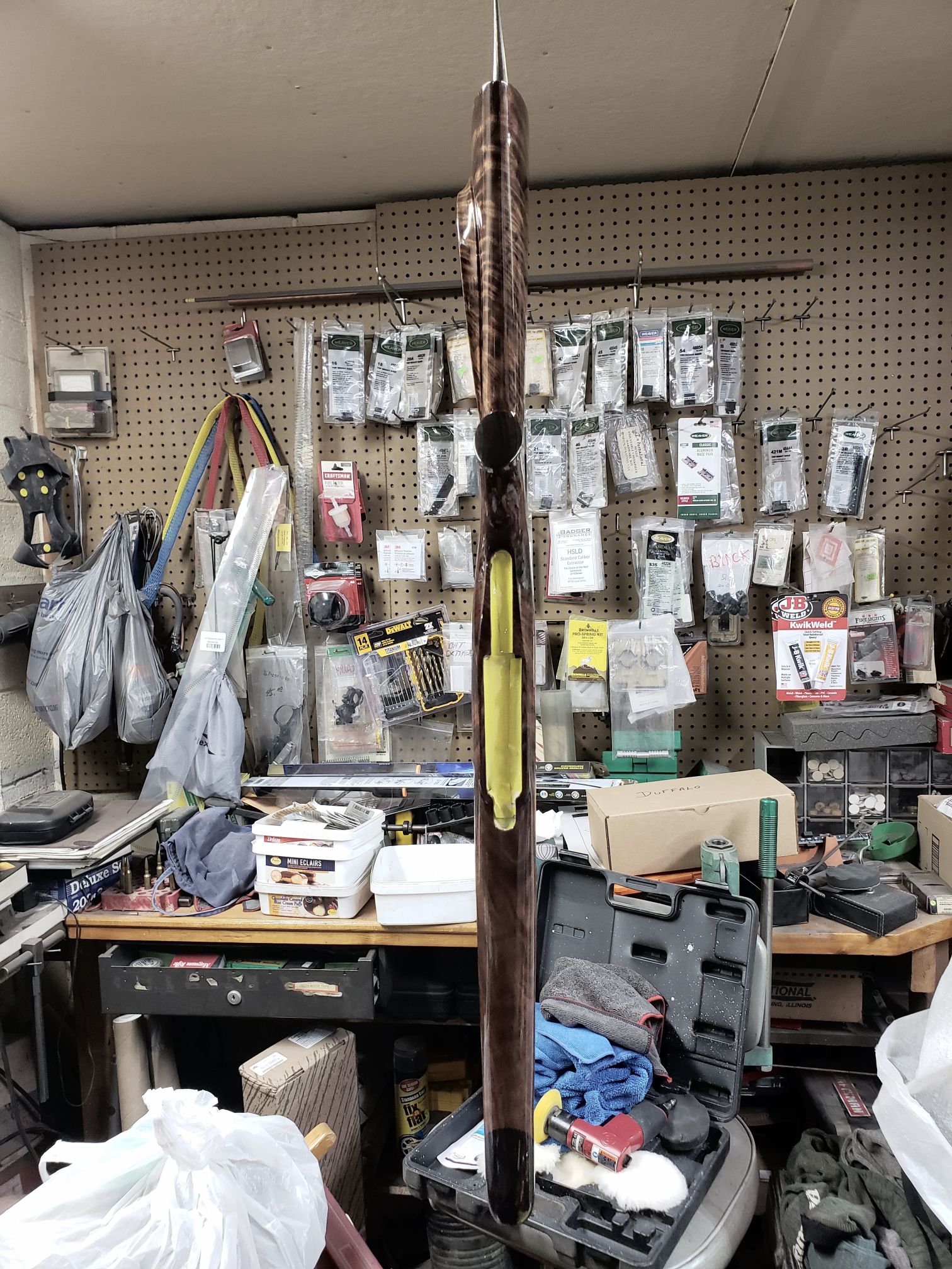

    Final coat of spray is on. And the stock is polished now.
    Next Brian will do all of the hand checkering, install the sling studs, and decelerator pad.
    Once the rifle is completed the plan is to put a few shots down the pipe. Then send all the metal out for Melonite treatment.
    More updates to follow as the checkering is being done. Hope you guys can appreciate a carved stock. Not many guys left doing it all by hand like this. It’s a dying art.

    Why the spray finish? Why not oil in the wood, which is much easier to repair if the stock gets a ding or scratch?
    Reactions: Baron23
    Stunning work.
    Good question. I don’t know. I let Brian make those decisions. I’ll look into it
    Interesting. Typically the customer gets a say.
    He would do whatever I told him. My first wood gun was done in a similiar fashion and I haven’t had an issue thus far. I will admit if I’m doing any type or hardcore pack in hunting or slugging through brush I tend to take my composite rifles. The wood one gets babied. And used typically from elevated tower blinds over large food plots.

    Do you mean like a tongue oil or similiar product? I’ve used tongue oil on my Garand stocks. But they end up feeling slightly tacky
    I began with a Claro blank on my custom 280 rem 30 years ago and used
    I believe Brian sprays 3M products I’ll ask him exactly what they are

    Very nice. Looks like the pores are nicely filled for a glass smooth finish.

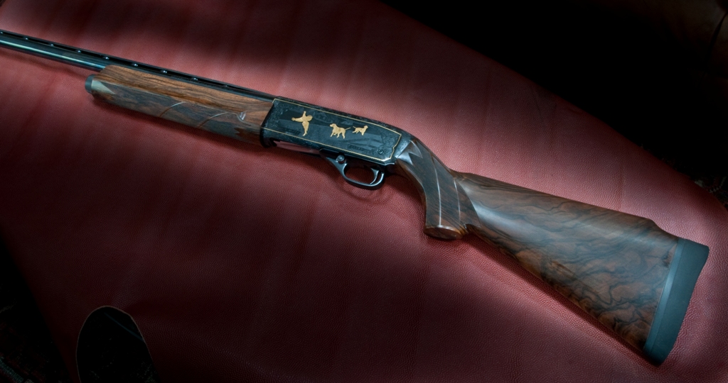

    Beautiful stock and I'm very happy for you. As a long time shotgunner, I've been pretty crazy about wood from time to time! haha
    This stock was all done by hand.....well, it had a rough machine semi-inlet but looking at your pics, it looks like inletting was done on a mill also, right? And yes, it has a hand rubbed, in the wood, oil finish which is time consuming PIA to do. This gun was a modest project that got utterly out of hand! haha
    My competition shotguns...well, really really pretty much every other shotgun except this and a one other, def have polyurethane as it is fairly unassailable and yes, they can be fixed up...... but perhaps not as easily as an oil finish.

    He said he sprays a sealer on the wood. No oil or stains. Then it gets a protective harder top coat that he polishes and buffs. 🤷‍♂️

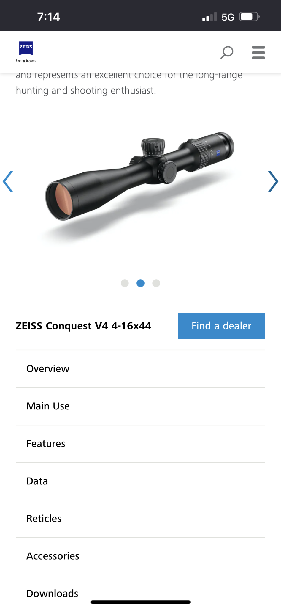

    I need some recommendations for a classy optic for this rifle. Nothing too big or obnoxious. Like a 3-12x44 or 3-15x50. I was considering the following one

    Beautiful! I’d love to know what his first coat was that filled/sealed the pores that well.
    He said a 3M sealer. I’ll ask for the specific product name. The closest thing I can describe it as would be the finish in a violin , cello, guitar, etc
    It’d be great to know, but if it’s something he doesn’t want divulged then. I definitely understand. For me to get a glass finish like that I use a clear grain filler.

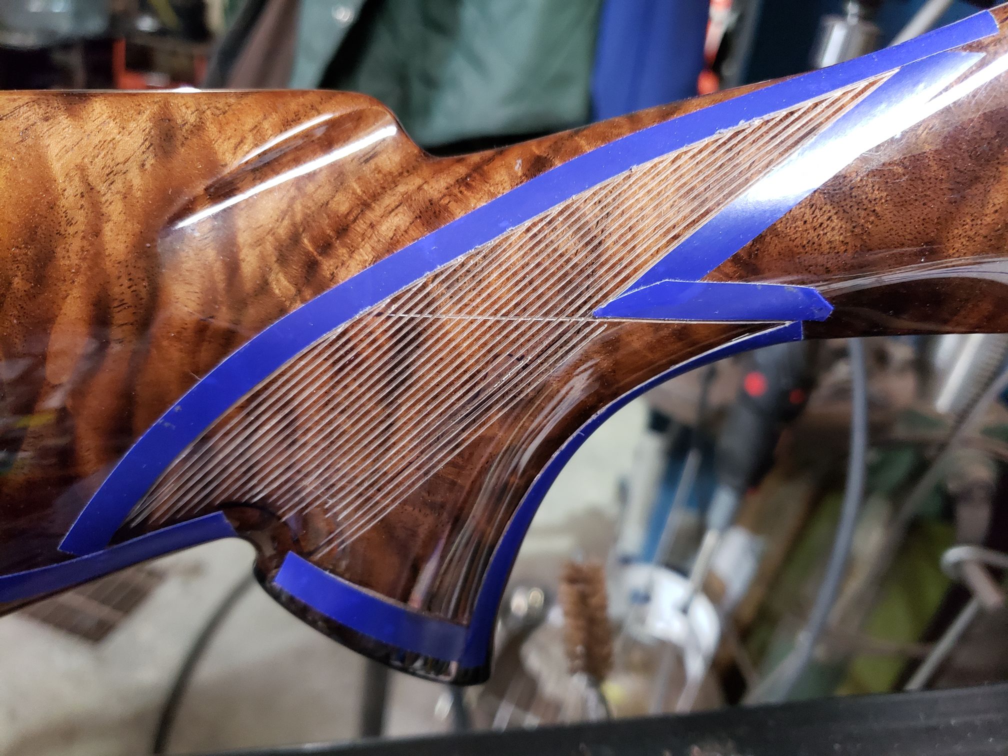

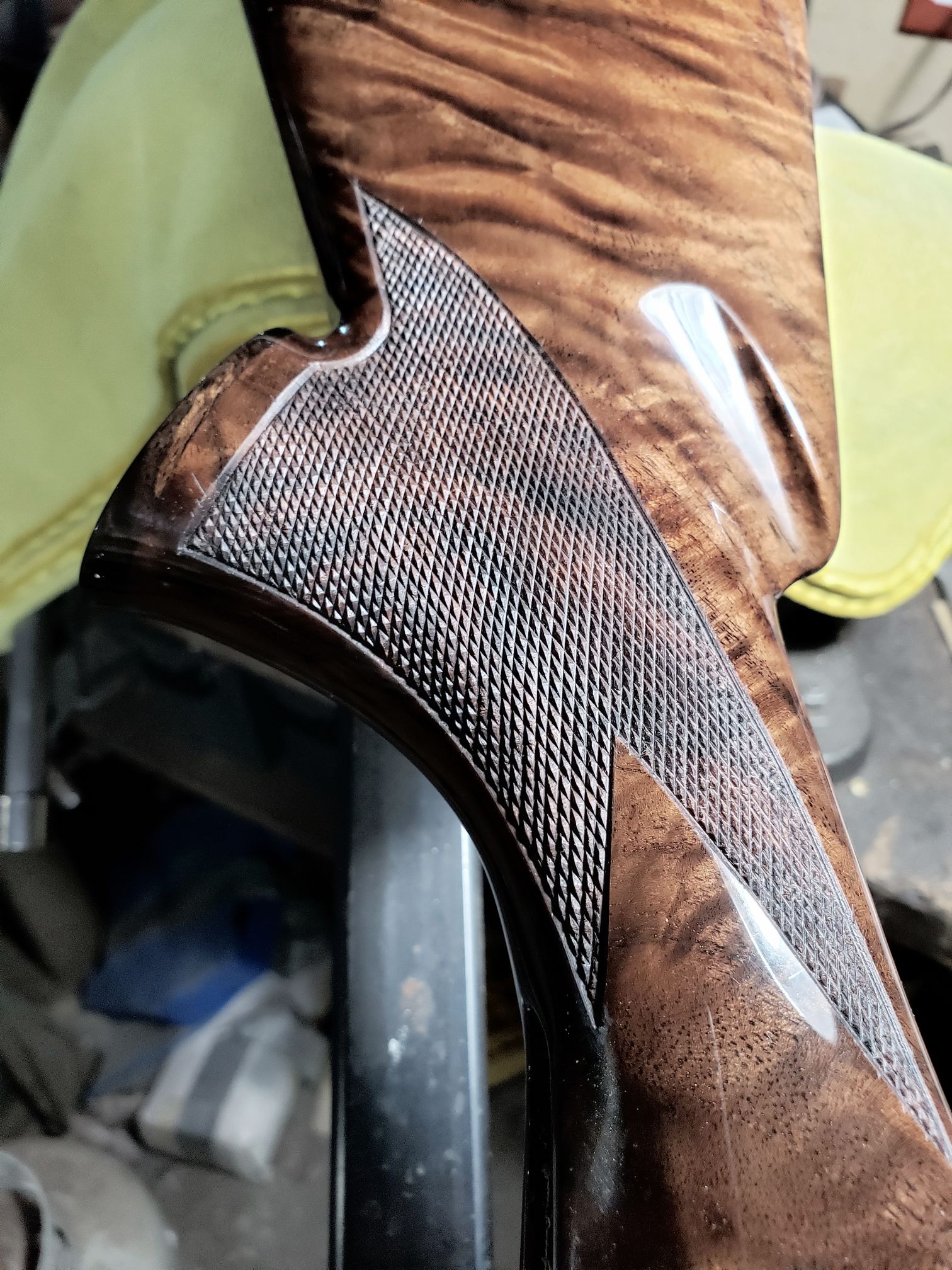

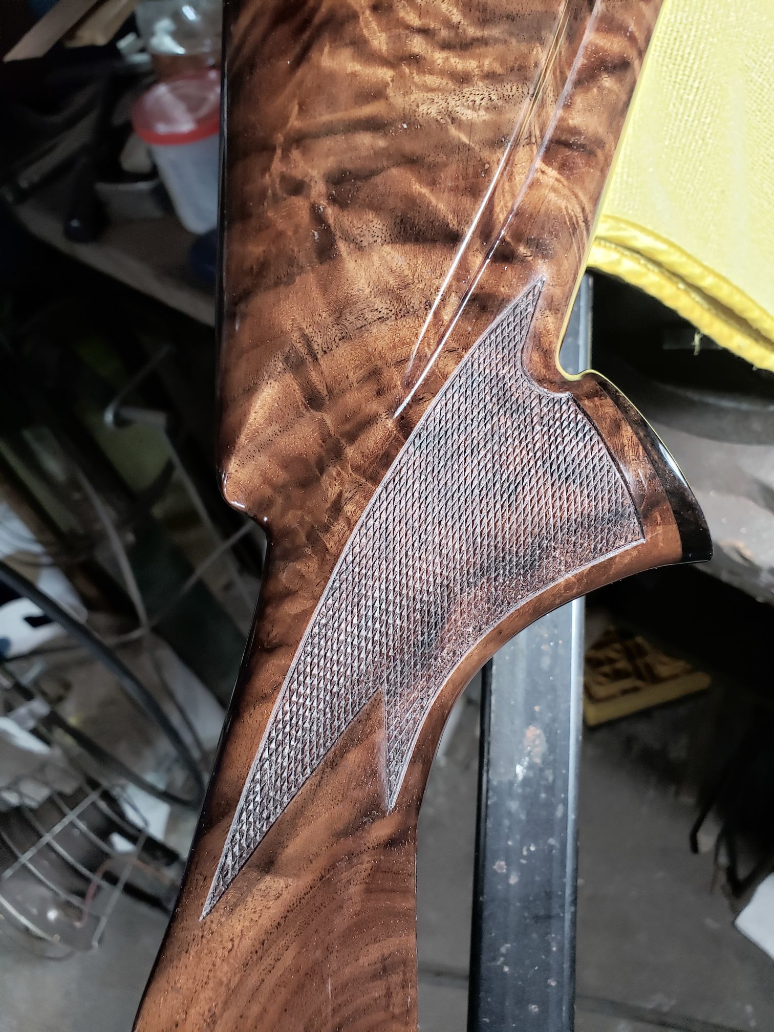

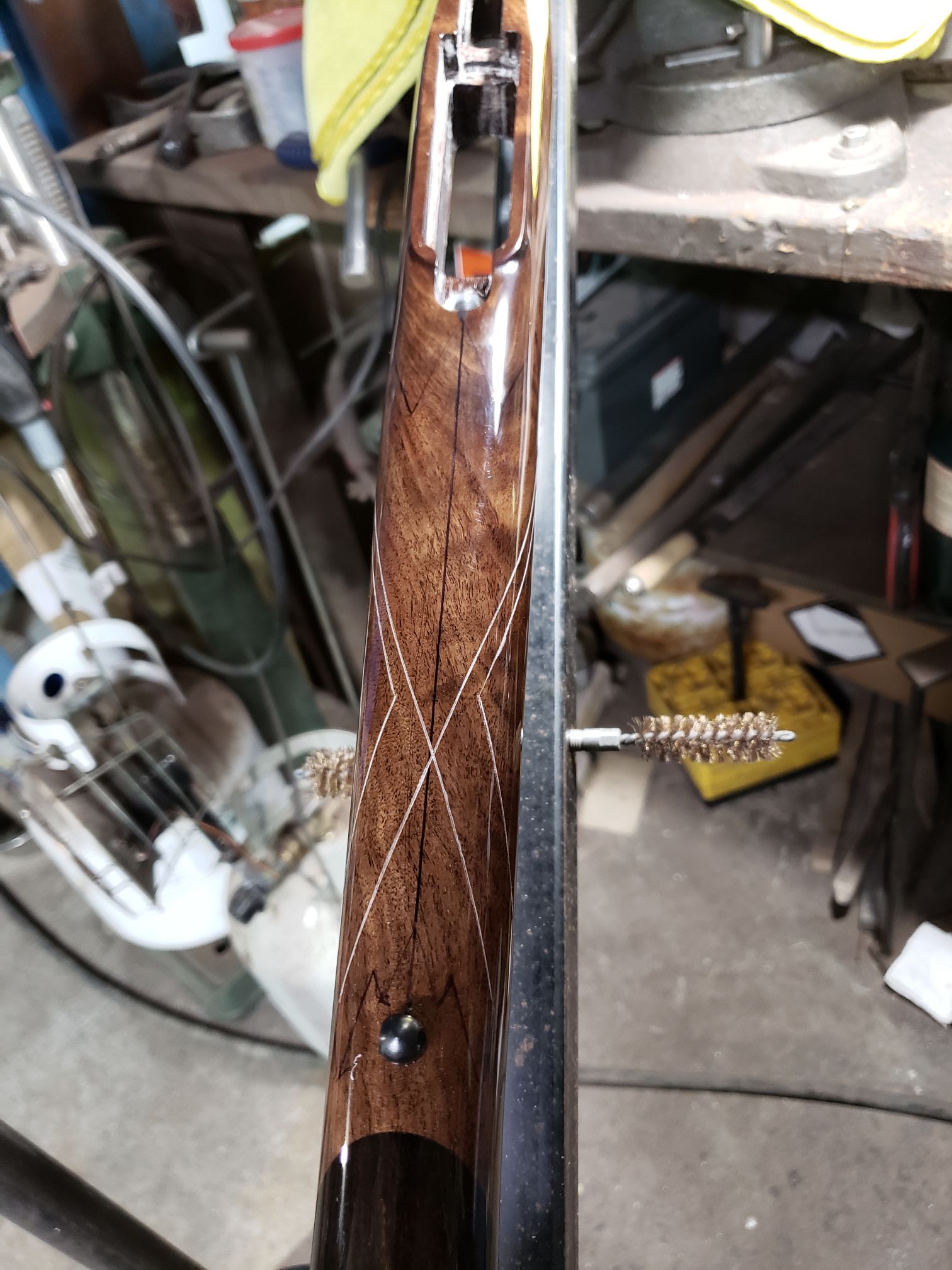

    Stock is done. All the checkering turned out phenomenal. I’m really happy with the grain pattern and color. Now I need to shoot some bullets through the pipe to break it in before I can send it out for melonite.
    Did you use aqua fortis on the stock to bring out the grain?
    Your checkering work is stunning. Having tried it, I can say that it is a horribly difficult thing to learn and get right…. People spend years trying to get… decent. That is amazing, complicated and perfect checkering! Incredible.
    Folks who can do compound curves… true artists. That rifle is stunning.
