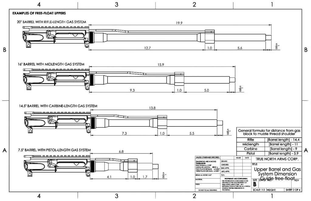

For a 15" Atlas S-One with a rifle length gas system. the shoulder of the gas journal is 2-5/16" from the front of the handguard. For a +2 gas system, the back of the AGB should tuck 5/16" inside the handguard. That AGB is also set screw, not clamp on. I would also verify that the 0.875 AGB will fit, even though it's just the back of the AGB under the rail.
...here ya go, the 15" HG will cover just about any gas block you choose on a standard "rifle length gas system"

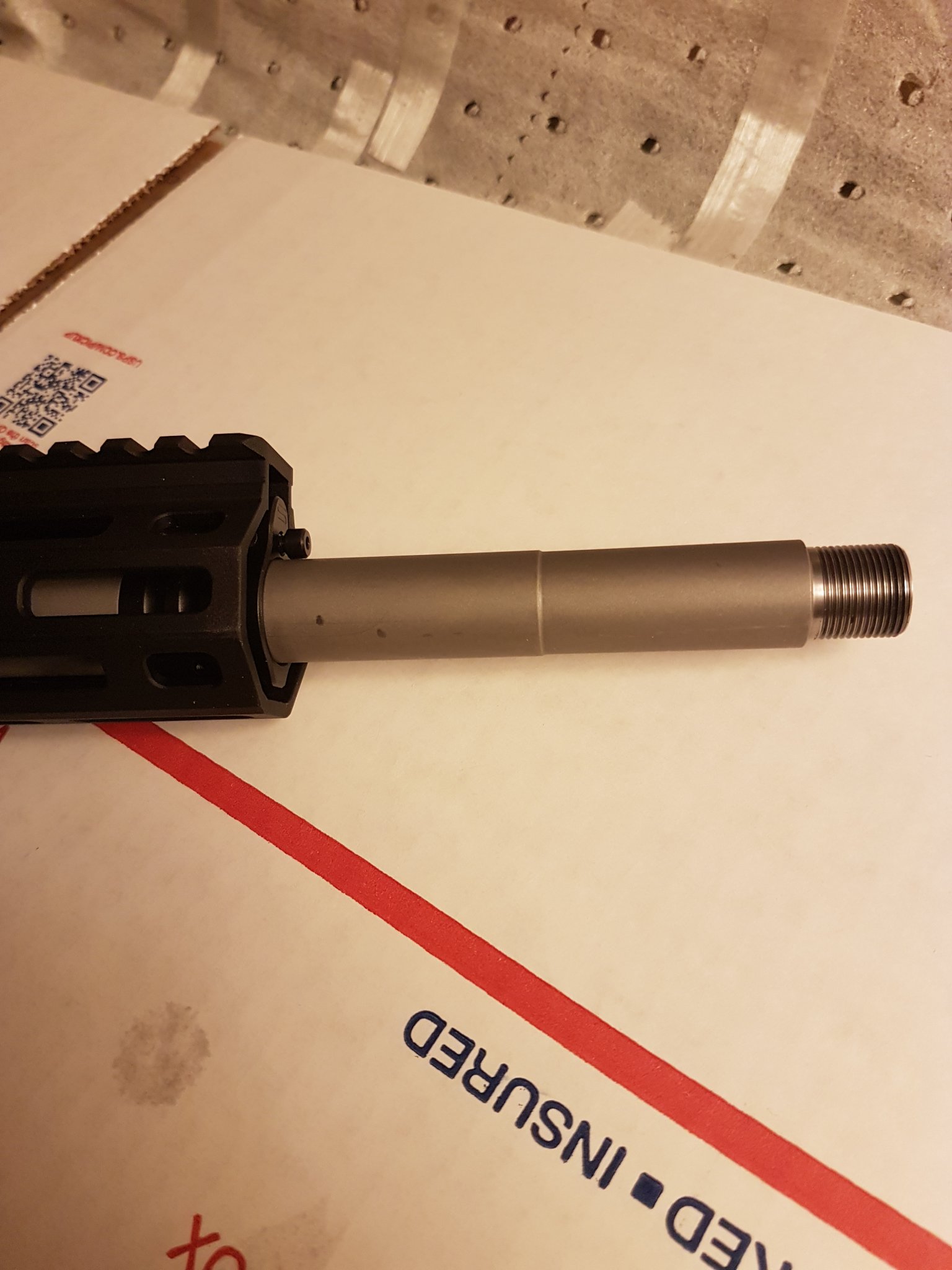

...FWIW, this is a 13.7" HG on a 18" barrel with a standard "rifle length gas system (RLGS)" with an SLR set screw type gas block...although it's a AR15, what is important for you is the length of the handguard in relation to the gas block on a RLGS...there is no difference in an AR15 -vs- AR10 when it comes to the gas system lengths.. good luck!
