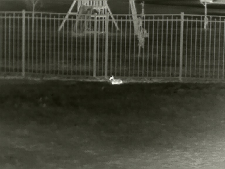

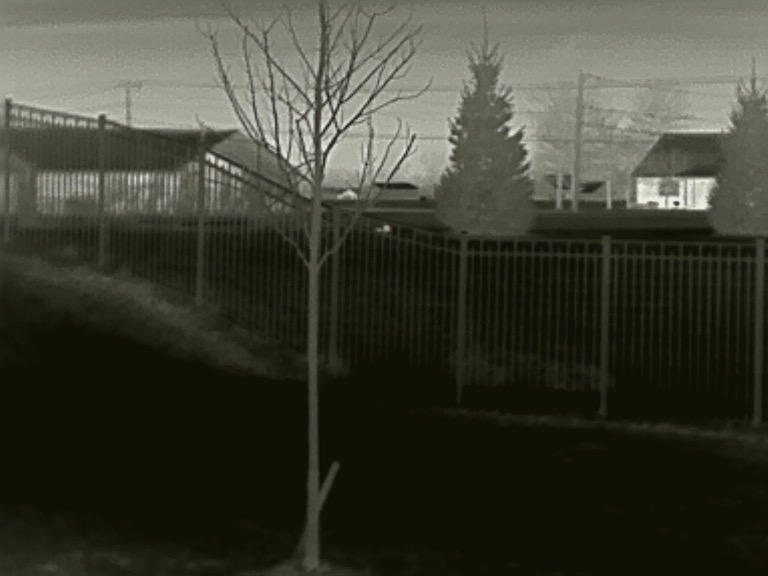

    I really like this iRay USA CBL19.
    384x288, 12um, 50Hz, 2X optical.
    Proprietary battery but is removable and rechargeable, and you can buy spares. Also runs off USB battery pack.
    Good option at $1800 I think.
