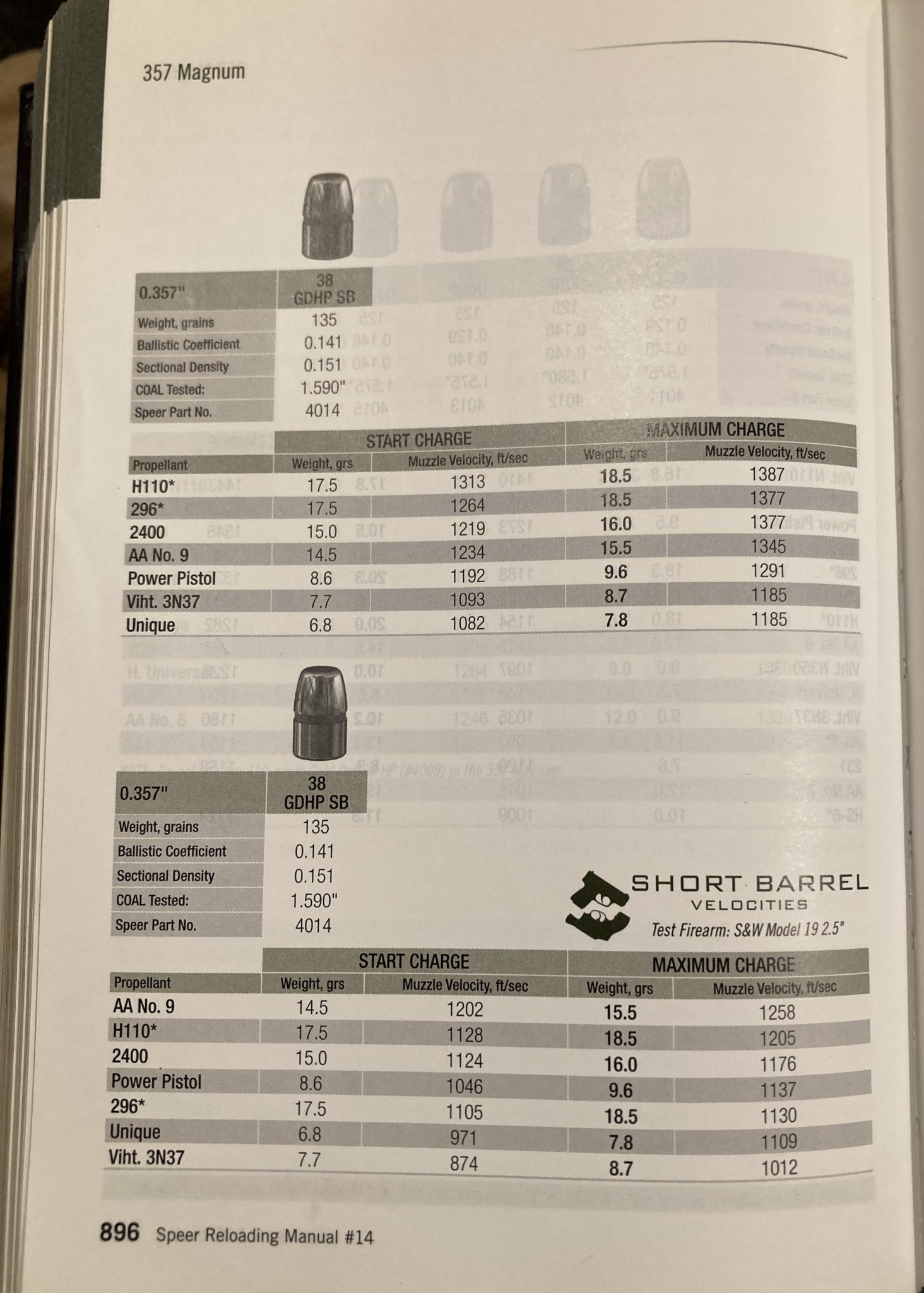

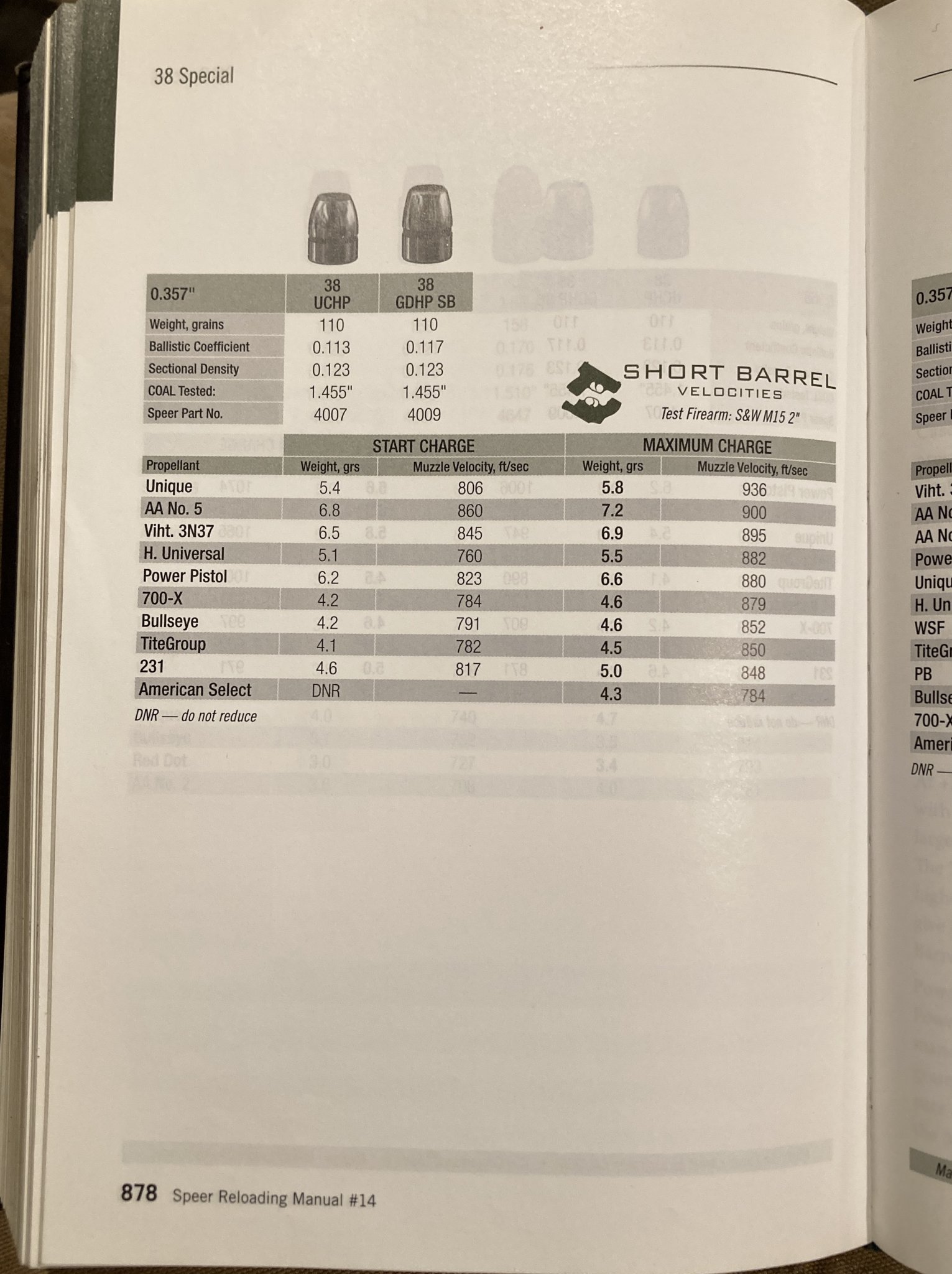

Here is Speer Reloading Manual #14 data for short barrel 38 load.
And data for short barrel 357.
