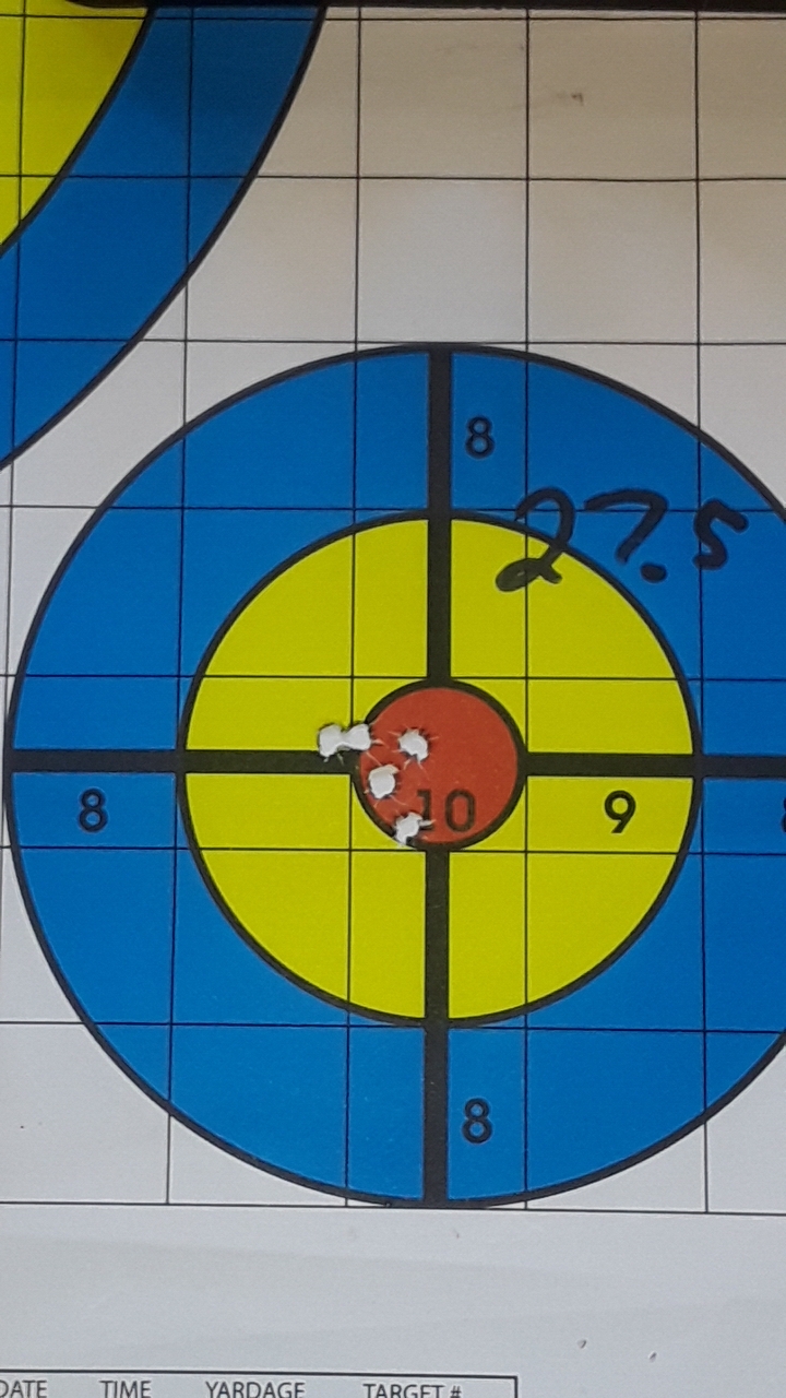

This is my best load from this week and going to pull out all the fc 223 brass I can find.
52g speer and cfe223 at 2.20 coal.
I may play with seating depth.
Full disclosure 50 yard test.
16inch ar.
