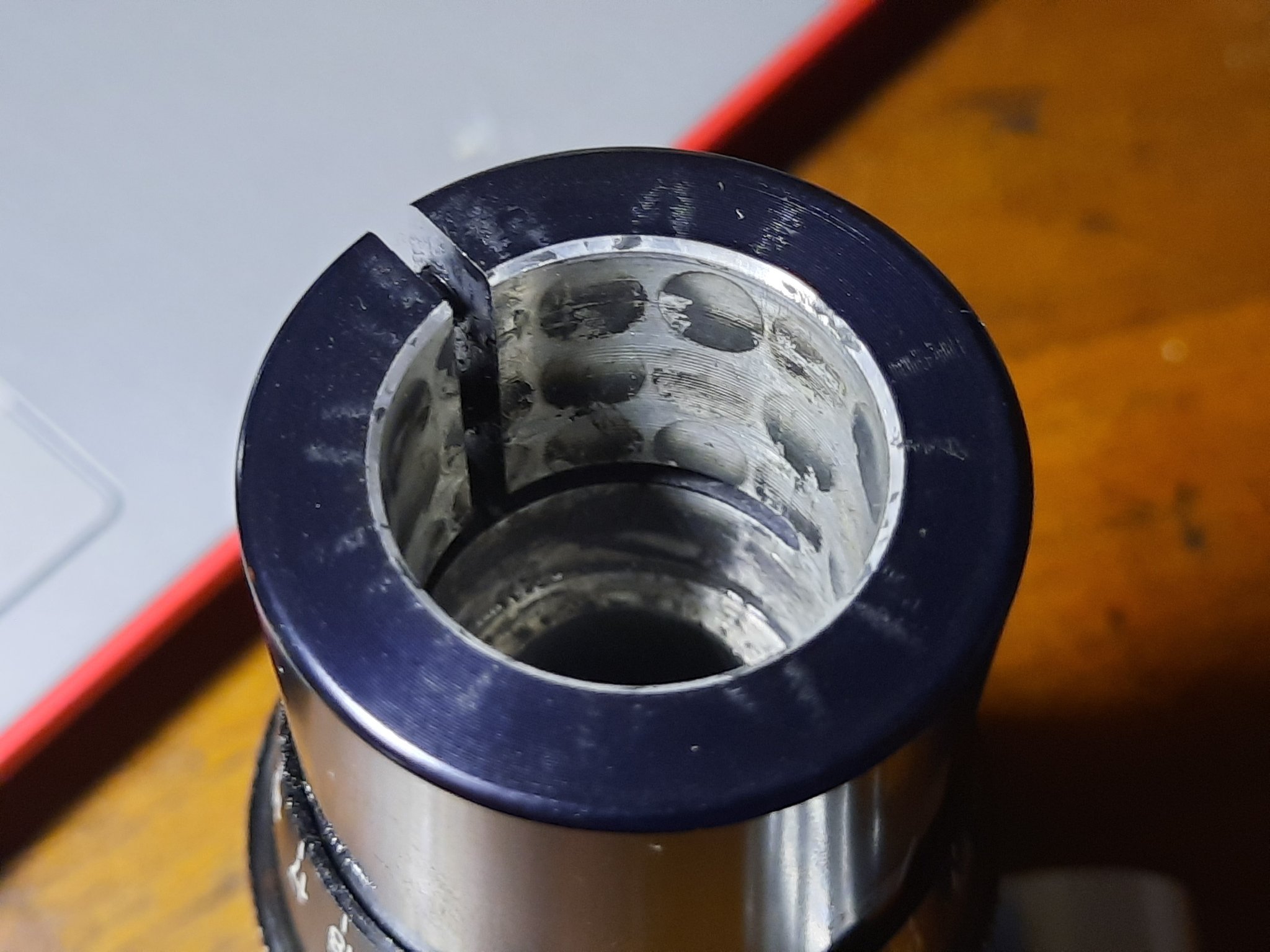

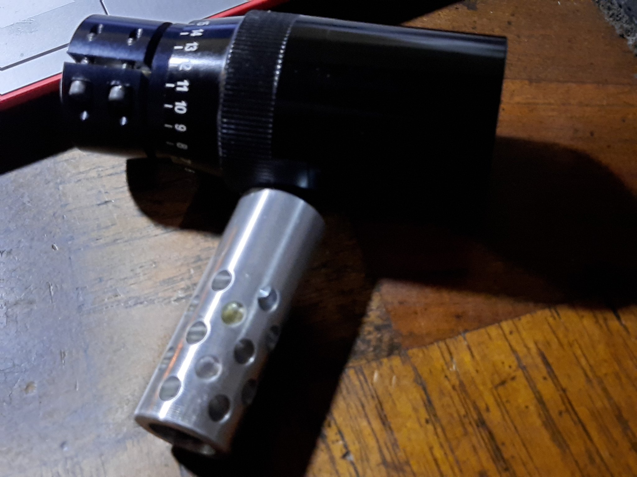

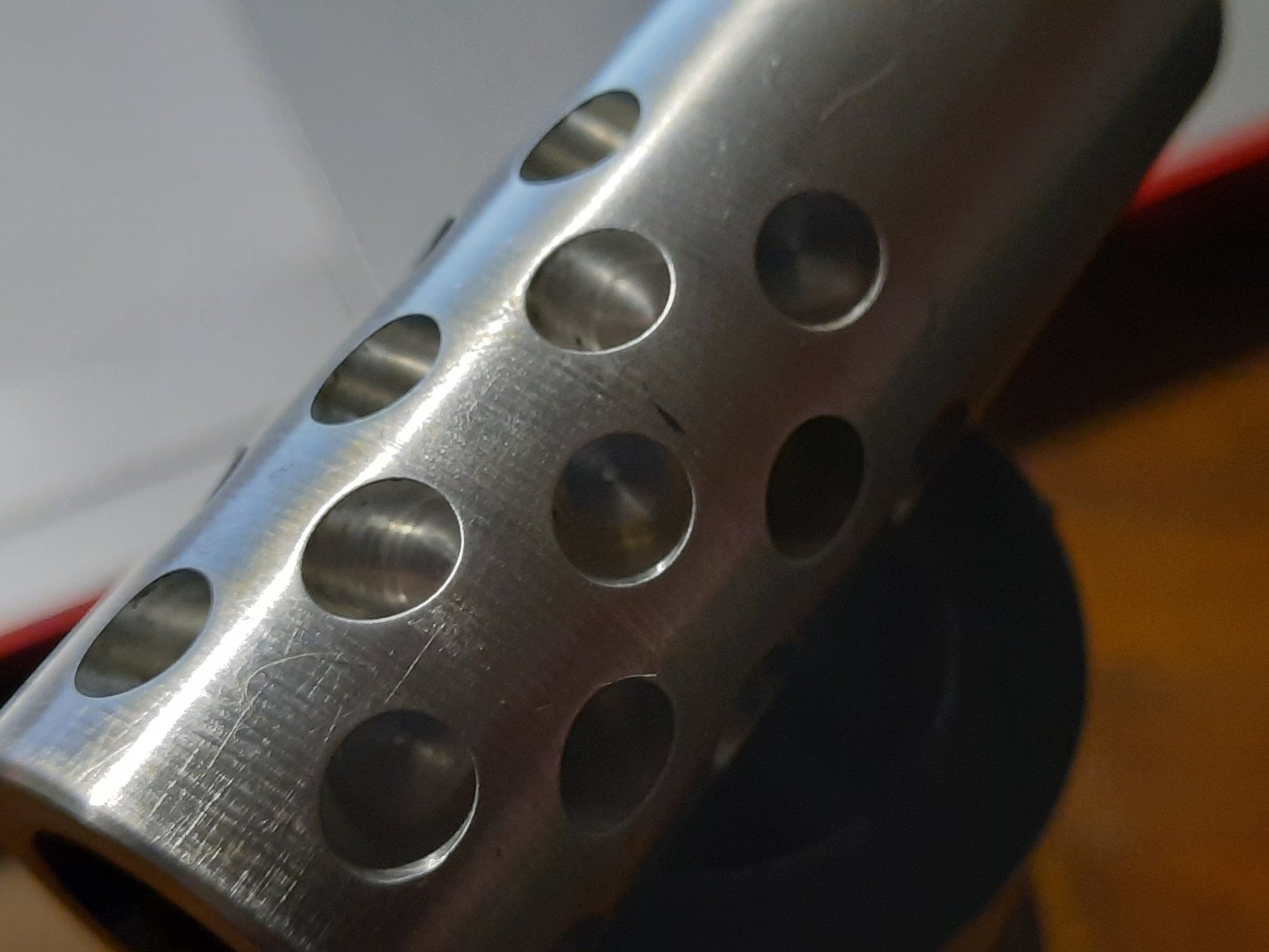

I had a Harrel tuner and had it bored out to .860" for a CZ 457 MTR. Since I had a bunch of guns that I wanted to try a tuner on,
I had a false muzzle brake made with a 1/2-28 thread and an .860" OD. That allowed me to screw the false brake onto any
threaded barrel and clamp the tuner to it. The reason that I had the holes stopped short of going through the brake was to prevent
the muzzle blast from destroying the tuner finish. A shorter adapter with no holes may even be better, I just liked the look.

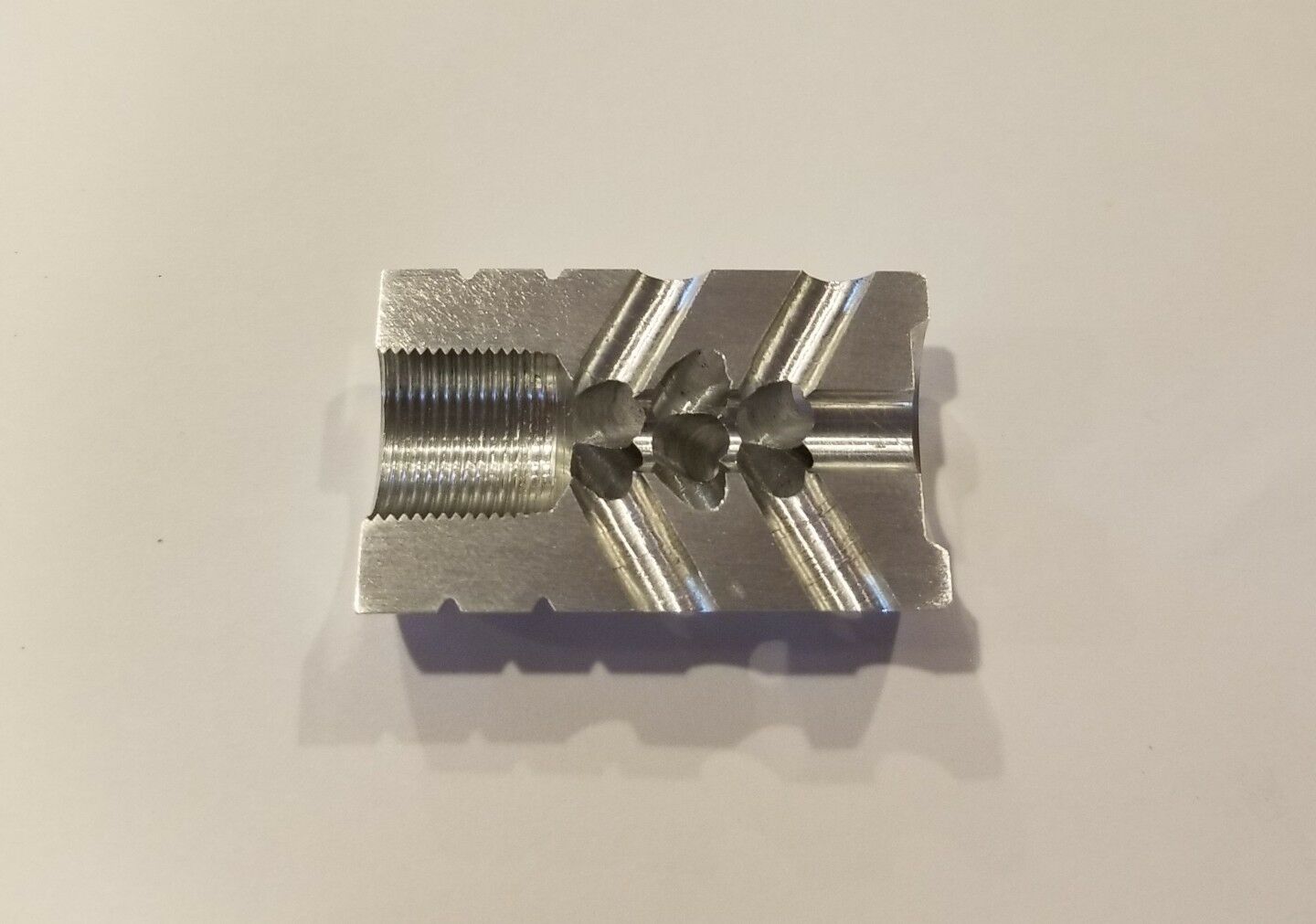

A guy on eBay ( 163036765515 ) ( Ruger 10/22 Muzzle Brake/Compensator .920" O.D ) did it for me from a simple sketch. The
last photo is from his page so all you would need do is tell him a diameter and a length which could be the same as the depth
that Harrel bores their tuner.
