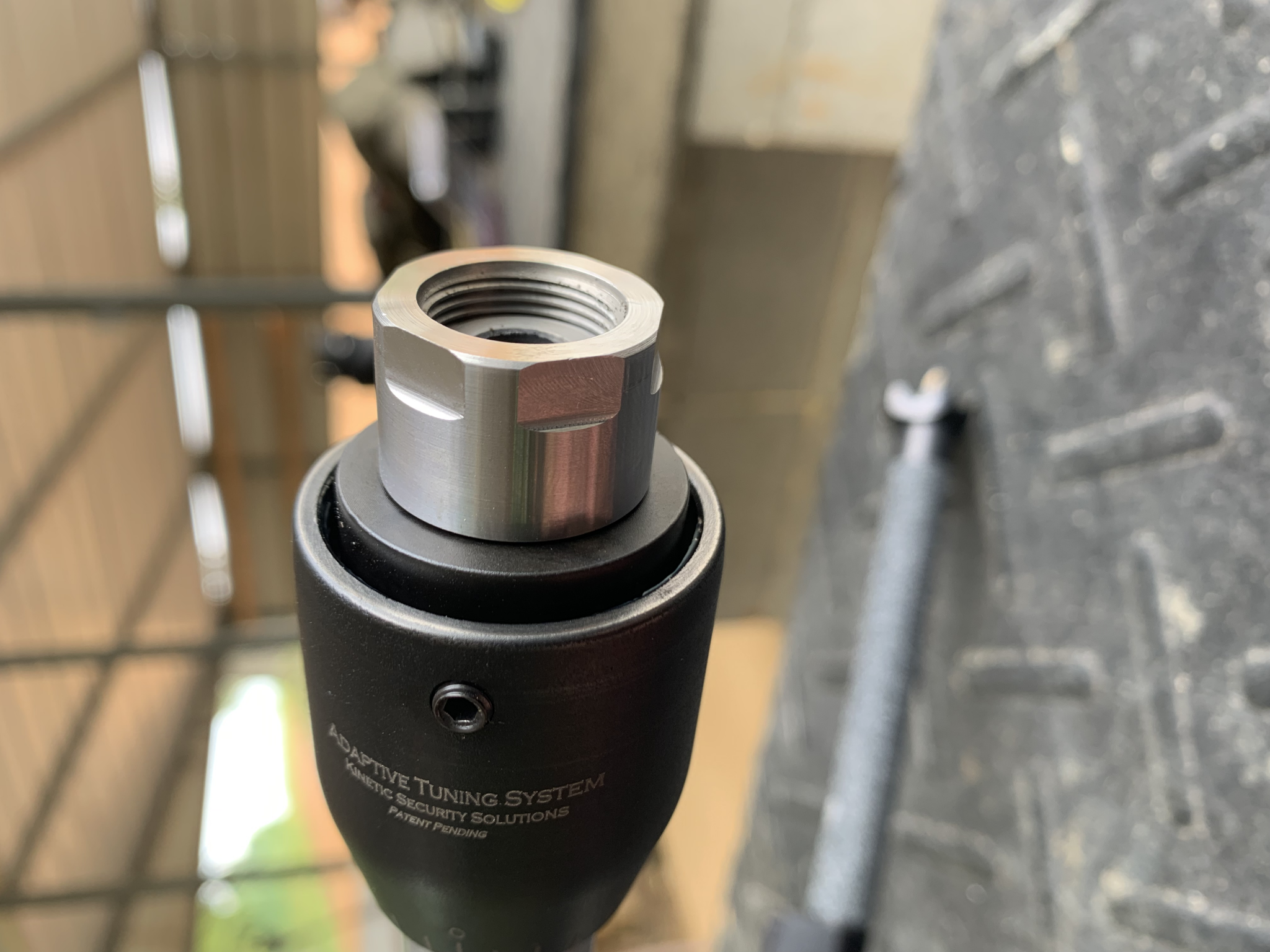

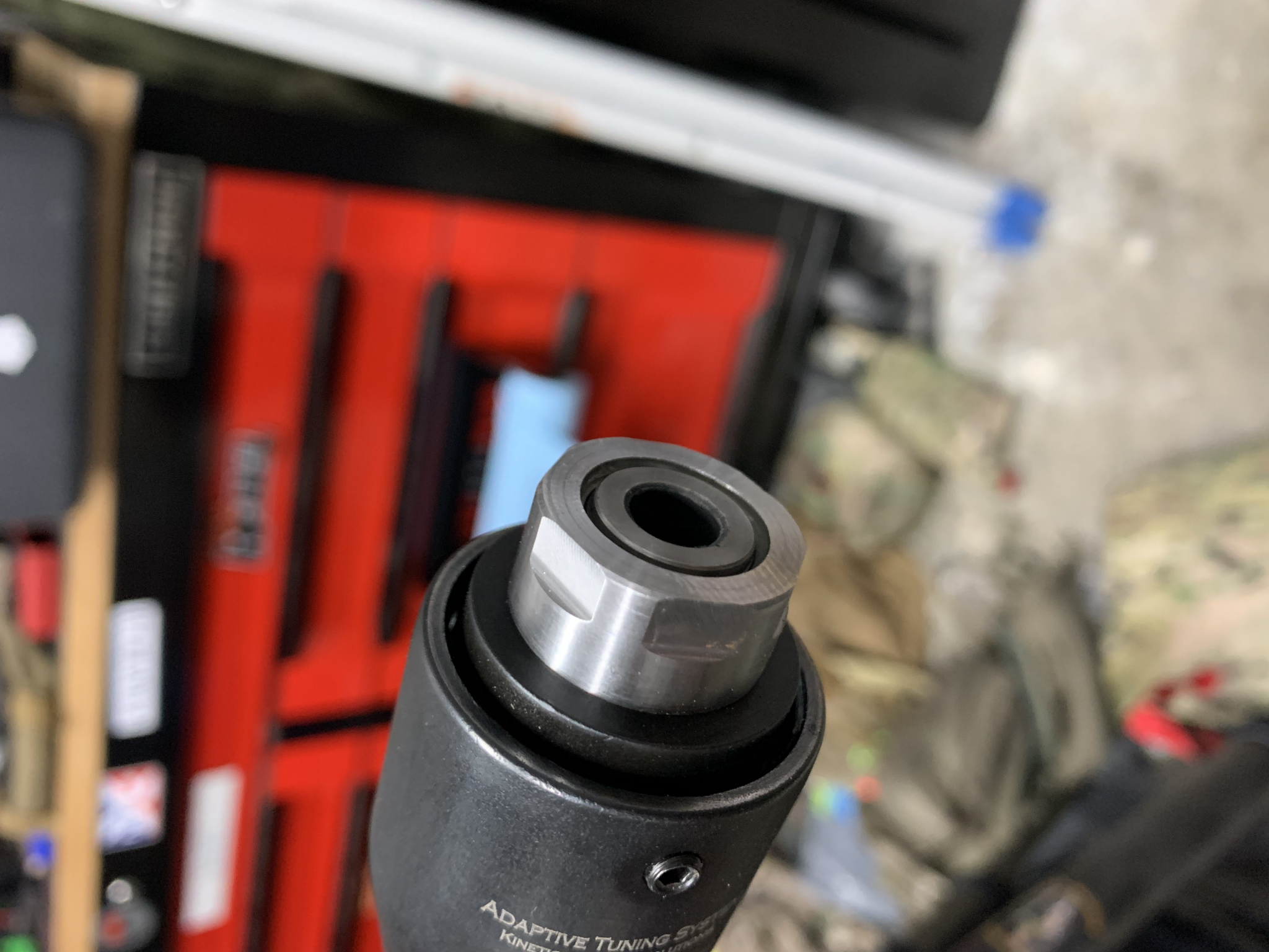

I would make reference marks and take pictures. My ATS was spot on when I took it off and back on with reference marks. Try to torque it the same if at all possible. I changed thread protectors to one that was .20in shorter to smooth the end out and my tune moved some from that. Im sure the harmonics changed with weight or how tight I had it torqued in place.
I would make reference marks and take pictures. My ATS was spot on when I took it off and back on with reference marks. Try to torque it the same if at all possible. I changed thread protectors to one that was .20in shorter to smooth the end out and my tune moved some from that. Im sure the harmonics changed with weight or how tight I had it torqued in place. View attachment 7692385View attachment 7692386

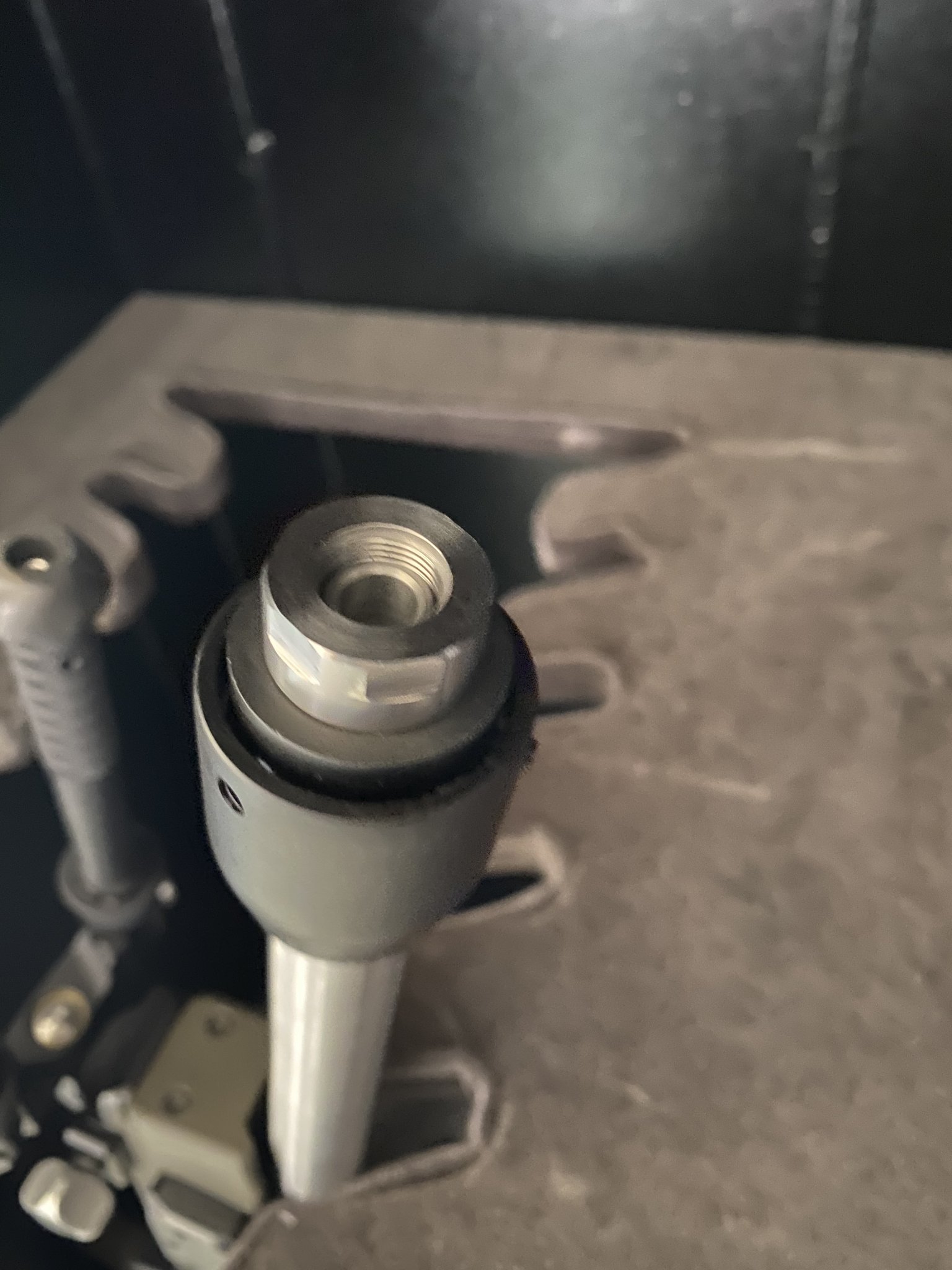

What’s the total length of the protector after you cut it down to be flush with the muzzle?
I did not cut it down. I contacted PVA and had Josh make another one that was .20 shorter. Paid his for it and I had it the following week.
Crazy. I had him do that same exact thing too but mine is still long. He said he went through and broke 3 of them before he finished cutting mine.

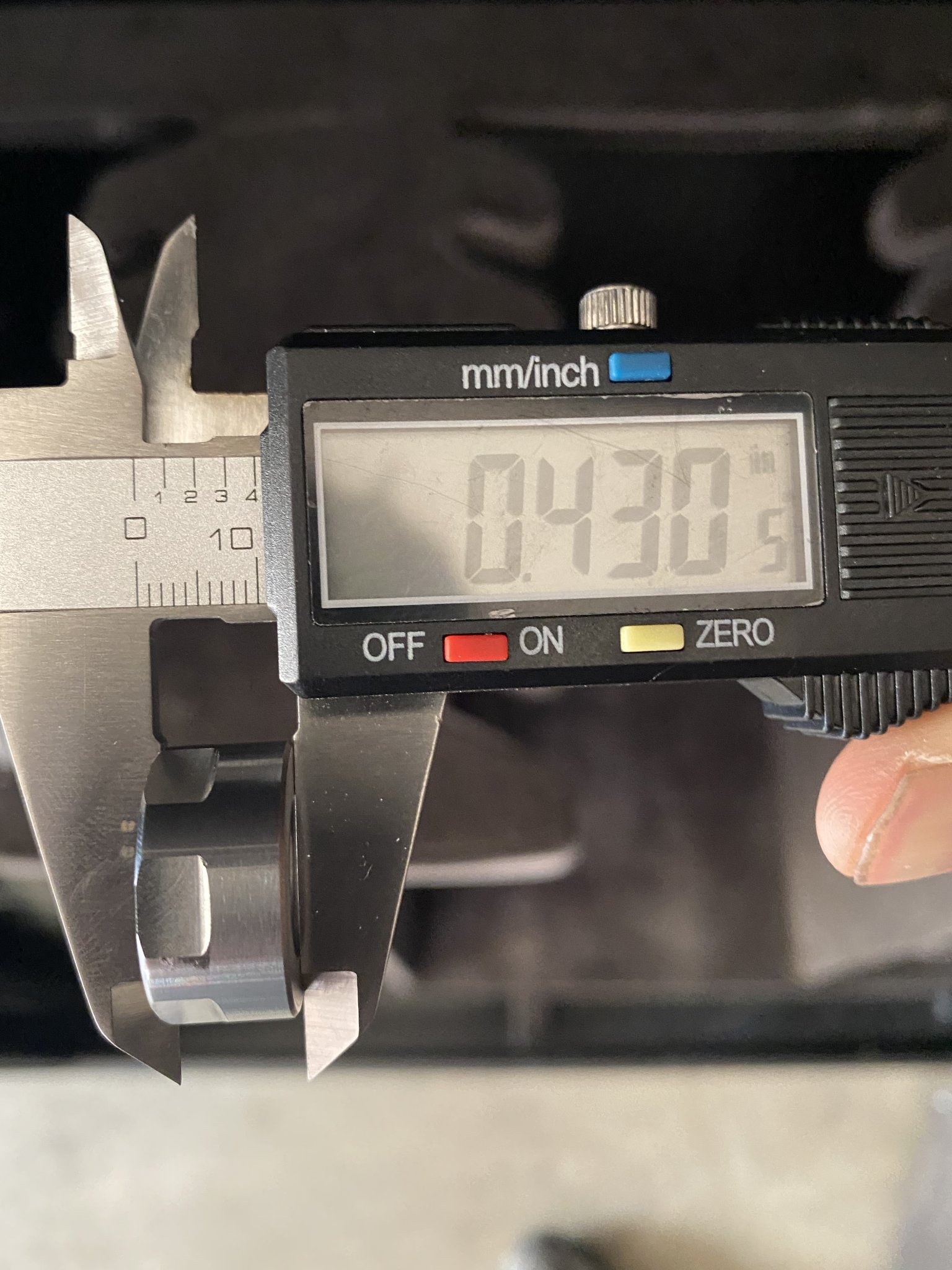

.430 was as short as he could cut it down and it’s .13 too long still with the tuner. Without the tuner on it’s flush. 🤷‍♂️

I assume the muzzle threads on the barrel were cut less than .5 inches which is why this cut down protector is flush with the muzzle without the tuner on..
