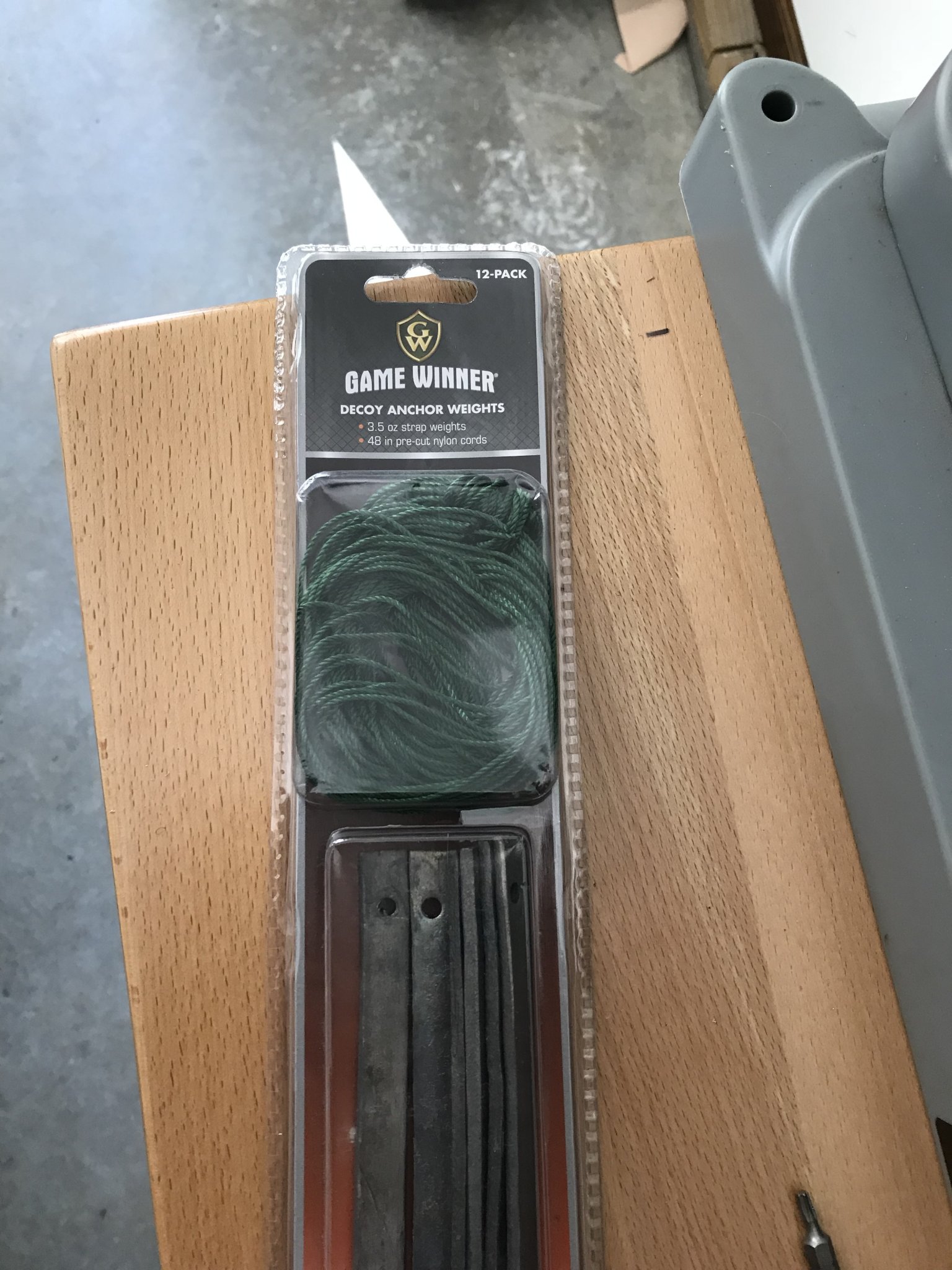

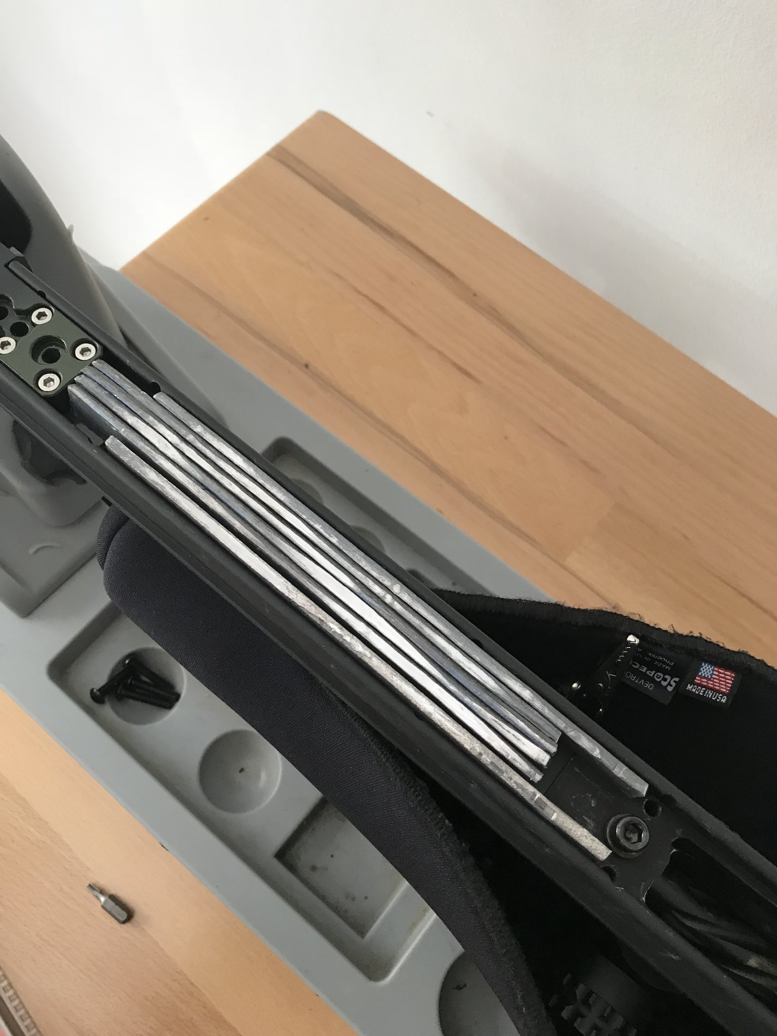

    It's funny you should ask. I took off the buttplate and filled the lower cavity with 357 lead bullets. I did it for balance and it worked really well. I intend to shoot mostly from the prone position so I didn't care about the extra weight.

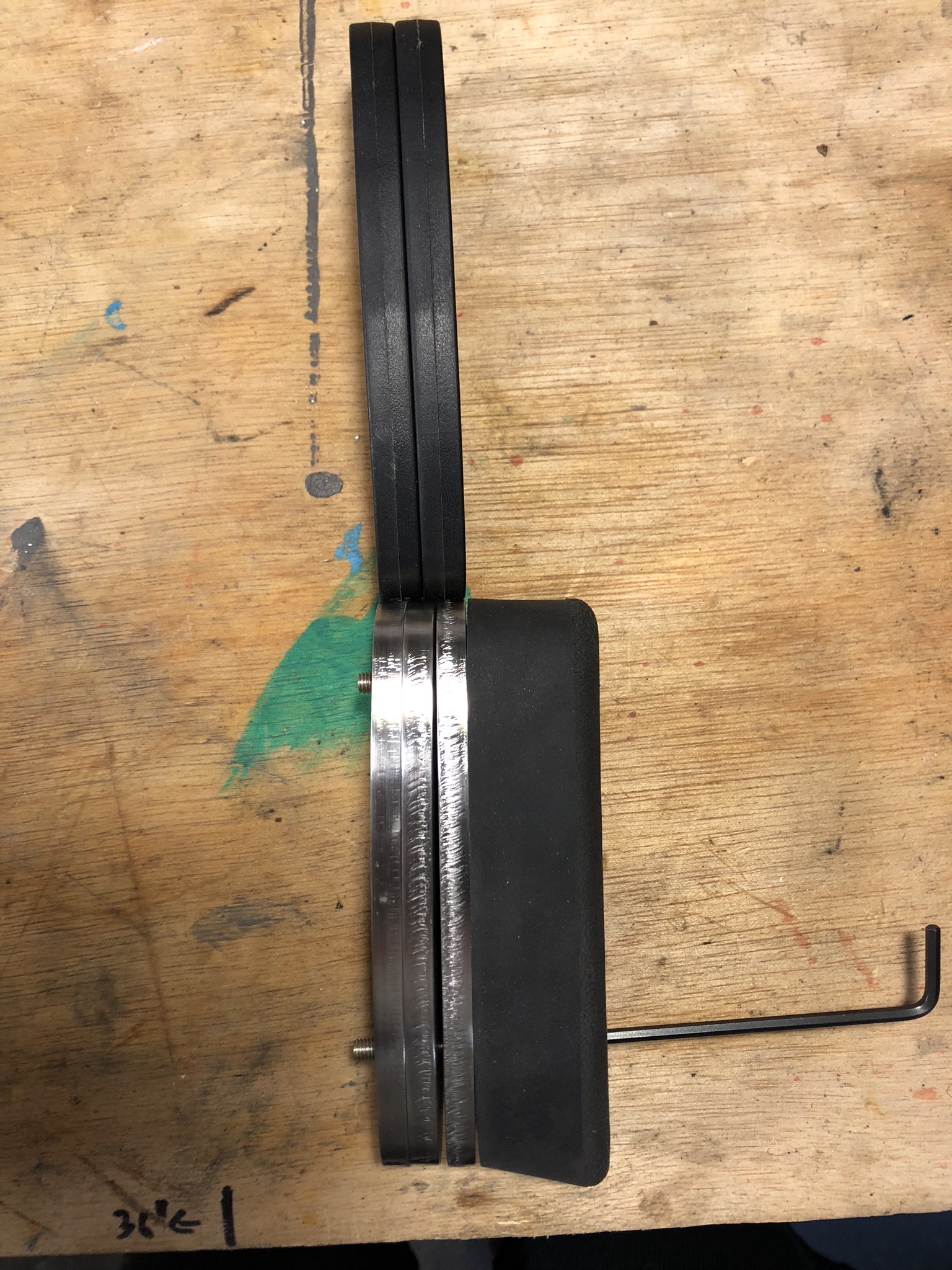

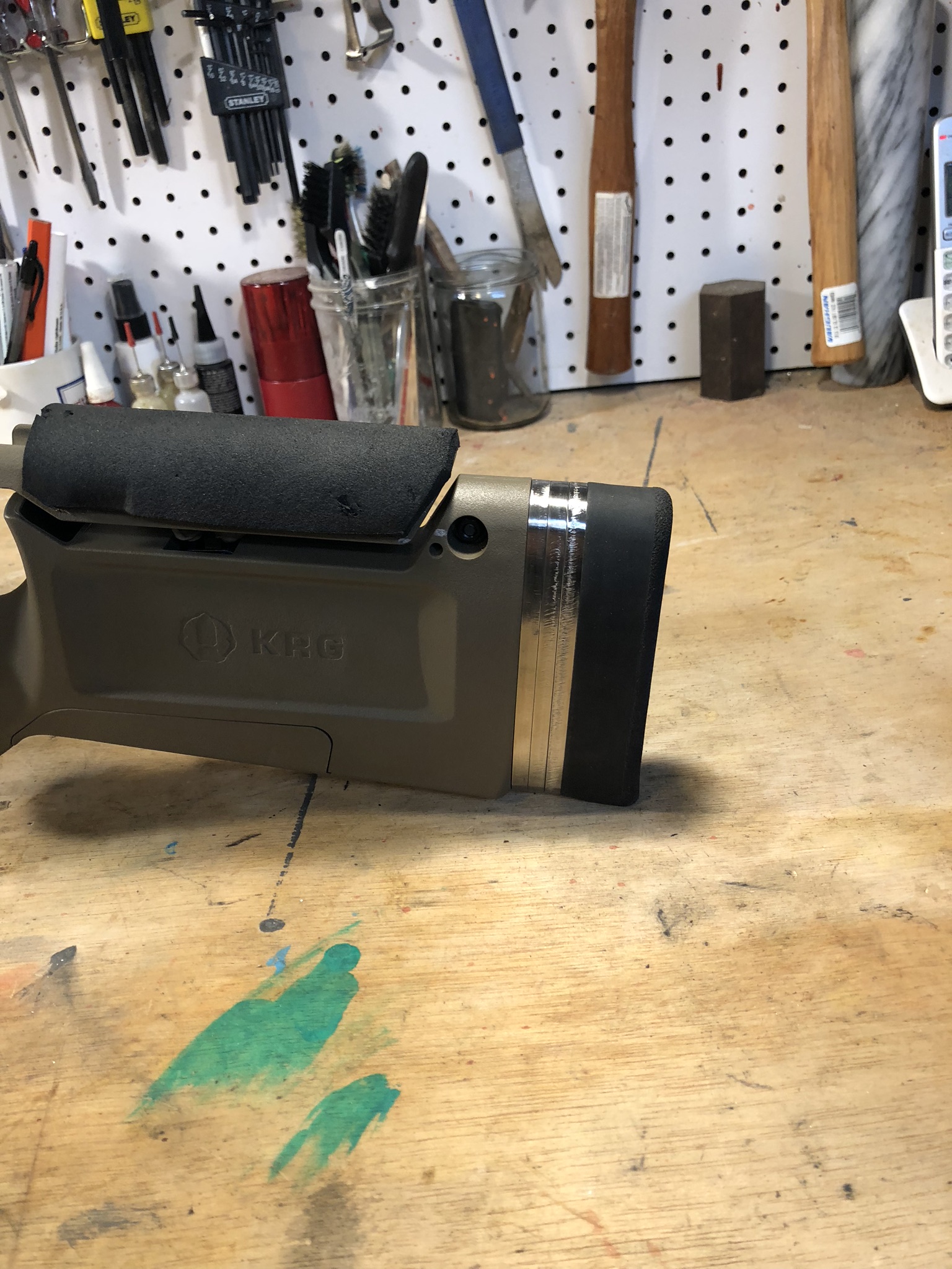

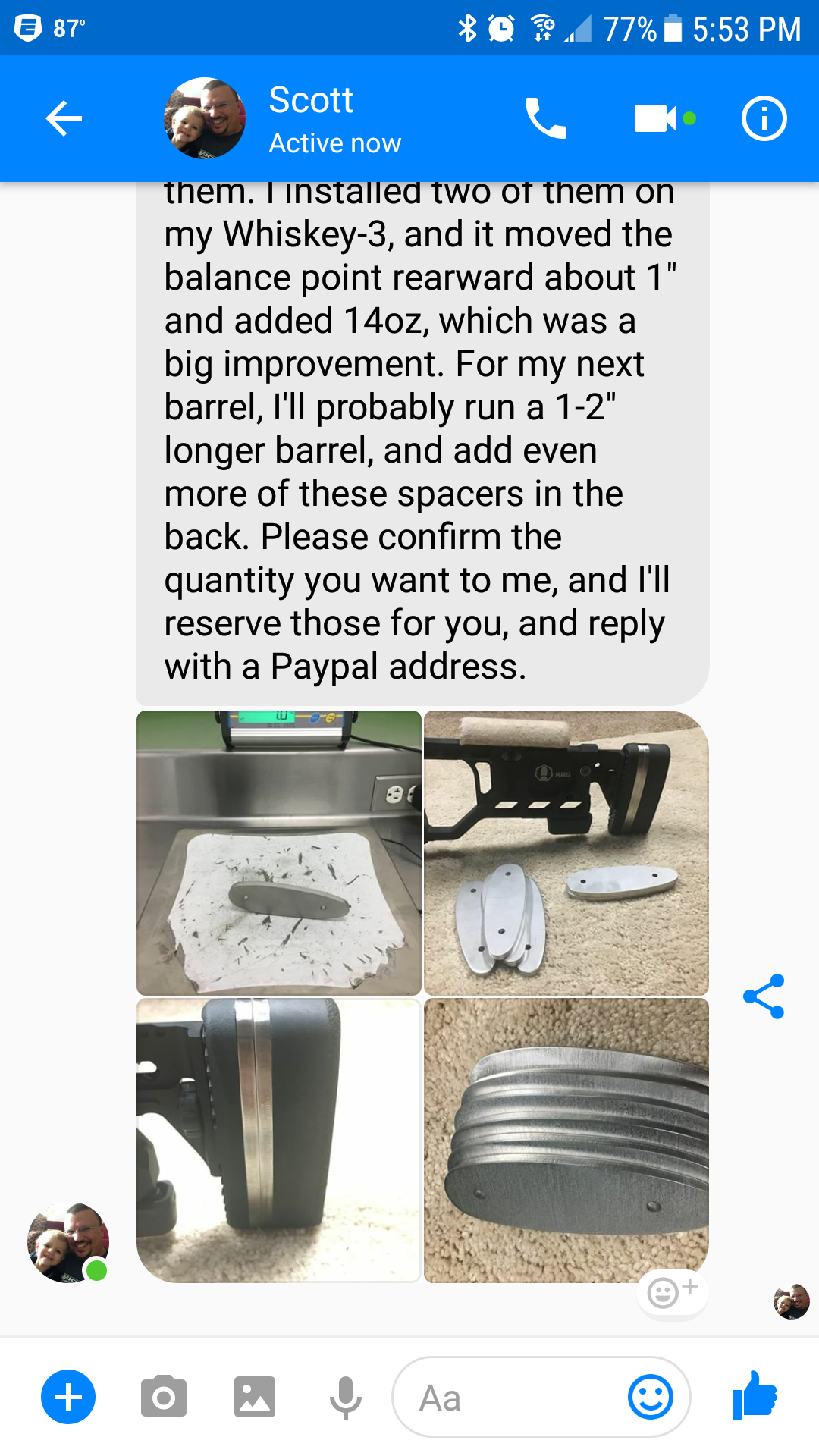

    My buddy Scott Whitehead just sent me a message yesterday about him making weighted spacers for the rear section of the W3/xray/bravo.
    Well there you go, that's what I was looking for! Good idea on a less permanent way of adding weight. Thanks for sharing, I'm going to play with this idea now.

    I put lead round balls in my .308. Added 2 lbs. filled the grip, butthook, and recoil pad area. I put the lead in small zip lock bags to fill in the dead space and keep them from rolling around and making noise.
    are the spacers 1lb a piece? how much $$ are they?

    I too, pulled the butt pad off and added enough lead to make it balance just ahead of the magazine.

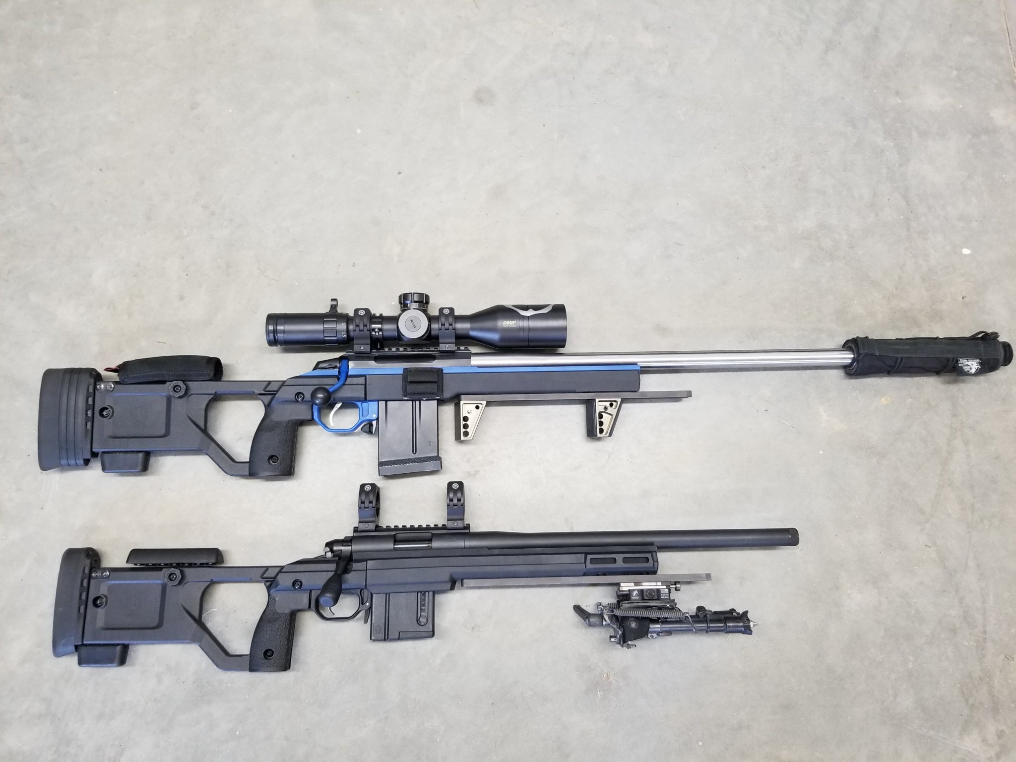

    Not a Bravo, but I have 2 XRay chassis with the Ingenuity Gunworks rails on. To get them to mate up nice to the forend, I had aluminum blocks machined to fill the void in between backbone and polymer skin. Combined with the actual rail, these spacers make my rifle balance perfectly and adds a bit of heft to the front.
    Reactions: 260284
    I was curious about how that rail fixed onto the KRG chassis. How do you like the rail? Do they make the aluminum inserts? Also, do you feel its too heavy out front, and too light in the back? It looks like the stainless barrel is a heavy contour!
    I have never messed with any other arca rails so cant compare, but I love this rail, specifically the barricade blocks. For me they are more stable than a game changer bag and way faster to set up on a barricade (they adjust to fit any width, with a push button and divots every .25" on the rail to lock into), and no messing around with hauling bags from position to position.
    Yes, Paul Poindexter at Ingenuity made me these inserts. It's not on the website, but call him up, hes a great guy and you may be able to talk him into making you some, hes obviously got the dimensions now.
    Where you see the rifle on the barricade is where it naturally balances, just what I wanted. The blocks lock it on, and it's stupid solid. Barrel pictured is a 22" Heavy Palma w/ Harvester can.
    Edit to add, aluminum spacer is secured to the backbone by 2 bolts, this involves drilling holes in the backbone, and the aluminum filler block has threaded holes to bolt into. Rail is fixed to the block by drilling 2 holes thru the skin to line up with the threaded holes on the bottom side of the spacer block.

    Scott's steel buttpad spacers seem to be working for him. We sent him the profile so they should match up and look nice as well.

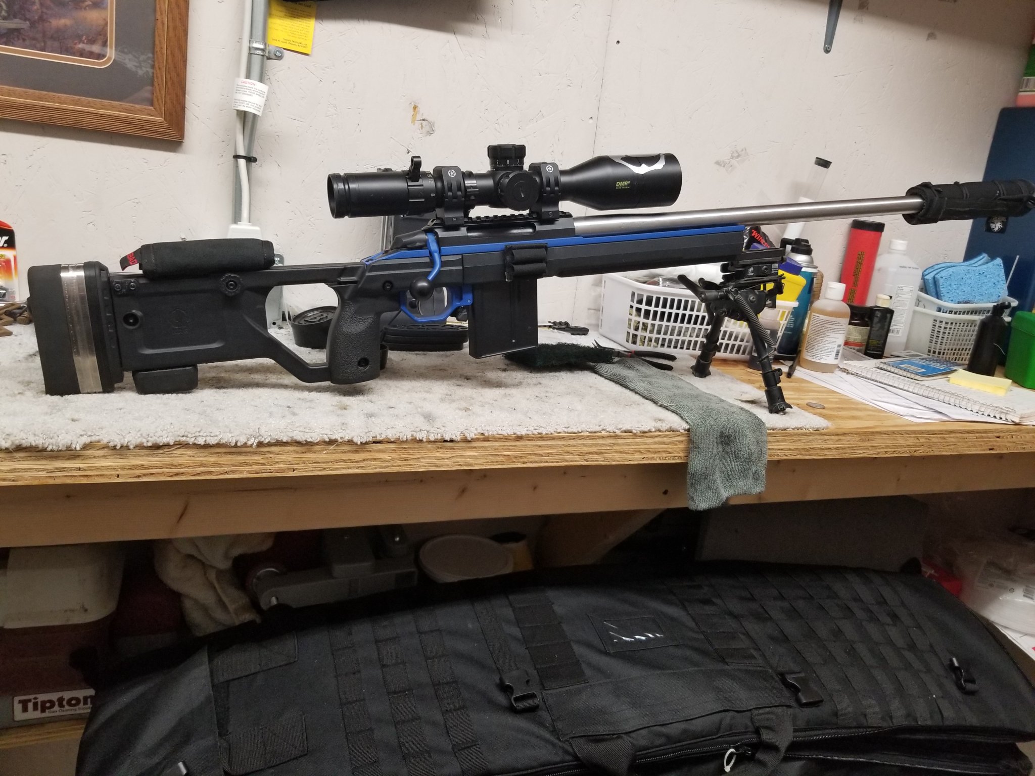

    Alright gentleman, this is my final product after messing around with going back and forth for 2 weeks. Adding weight to rear, grip, and butthook, I lined the cavity with Saran Wrap and took #8 shot from shotgun shells, and covered it with excess Saran Wrap. As for the fore end, I went from adhesive wheel weights, to double sided tape and Saran wrapped #8 shot, to now and ending with lead decoy weights from academy. 3.5 oz each strip and had to trim to fit accordingly. Good thing with this lead, it’s soft enough to cut.
    How much weight did you add totally?

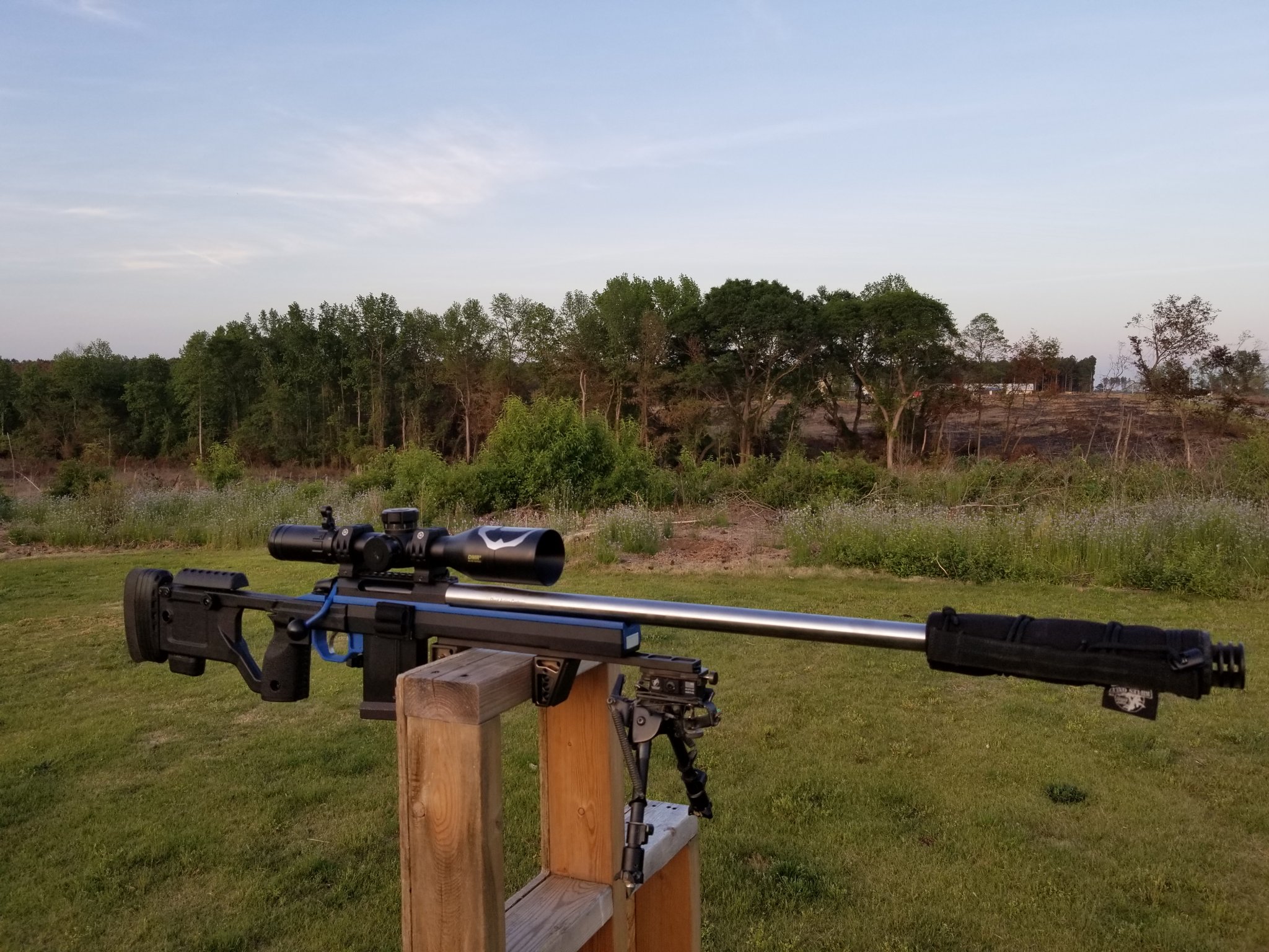

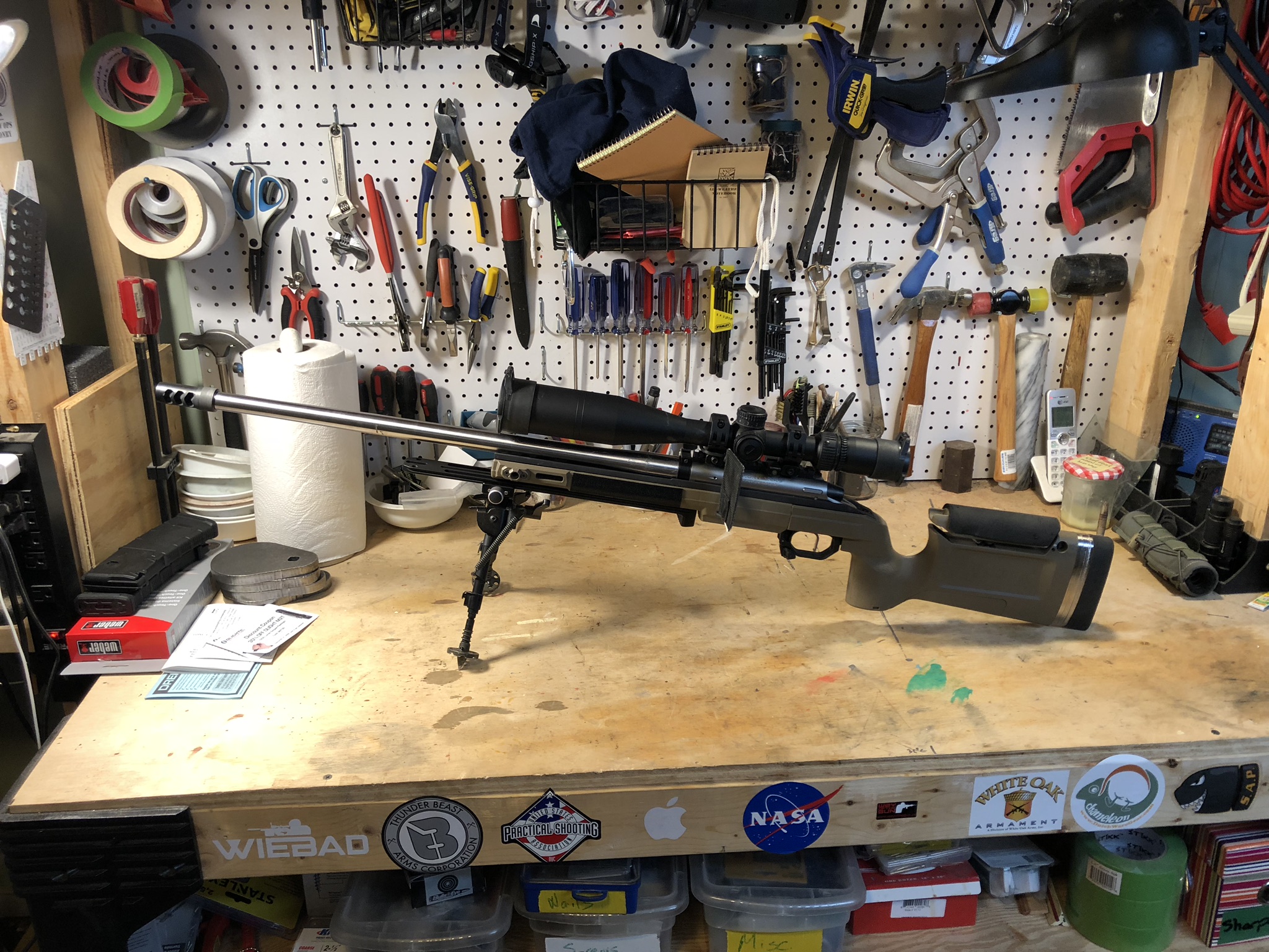

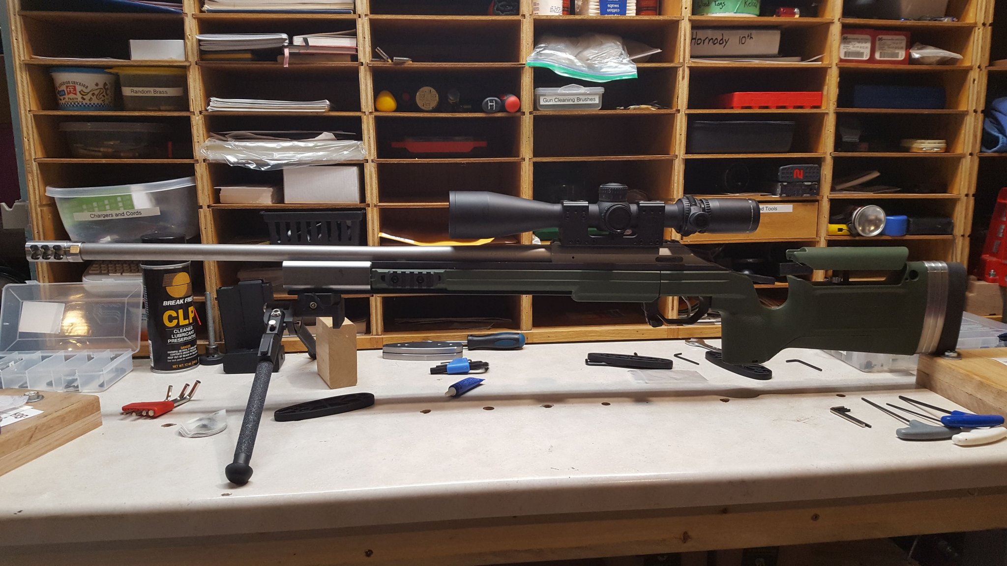

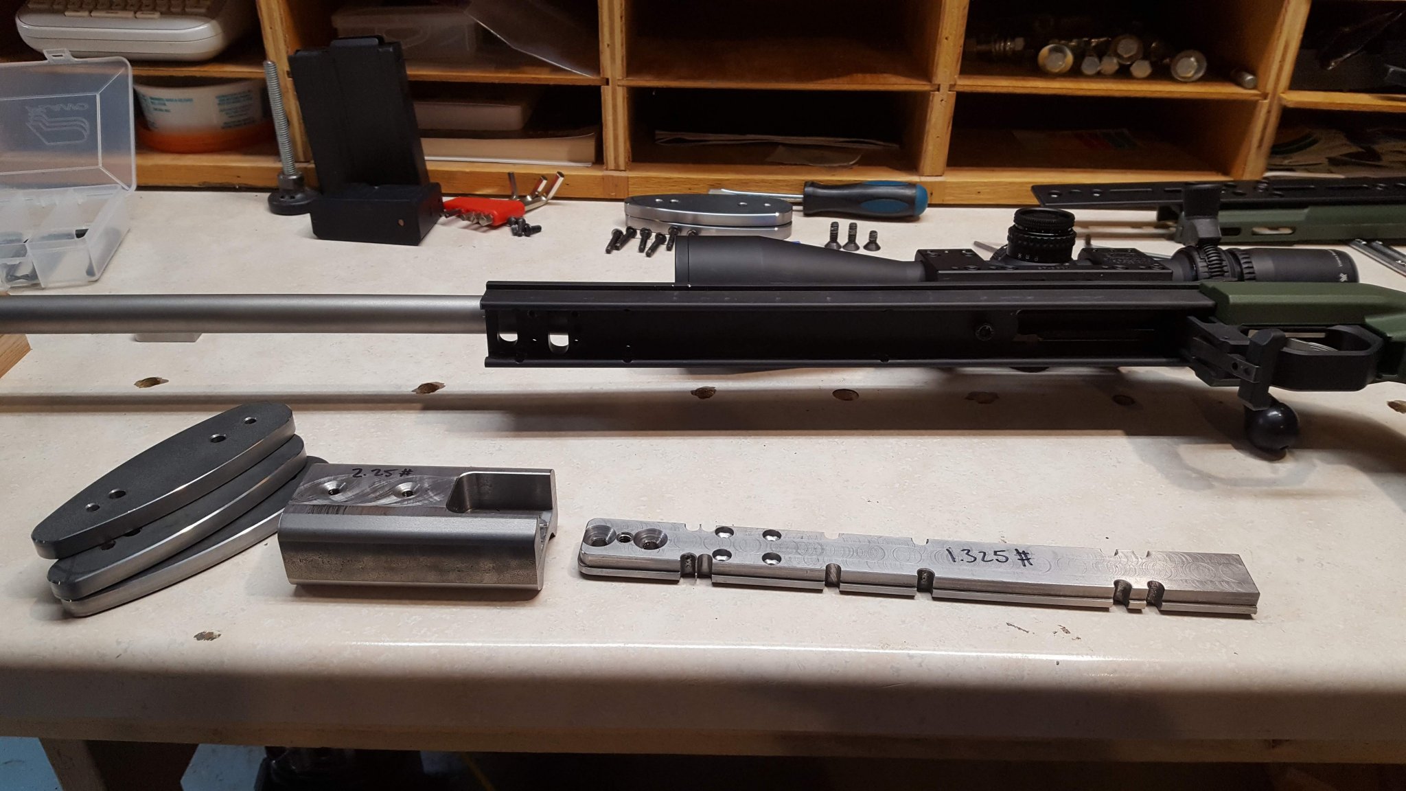

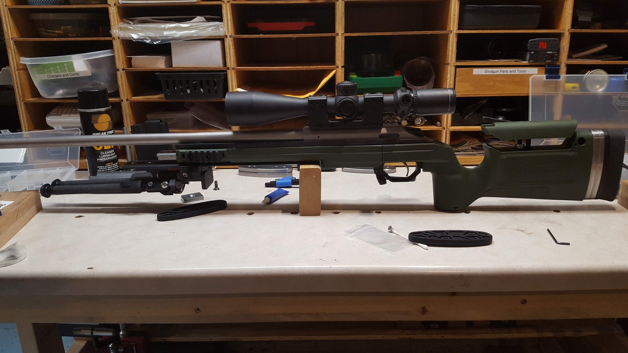

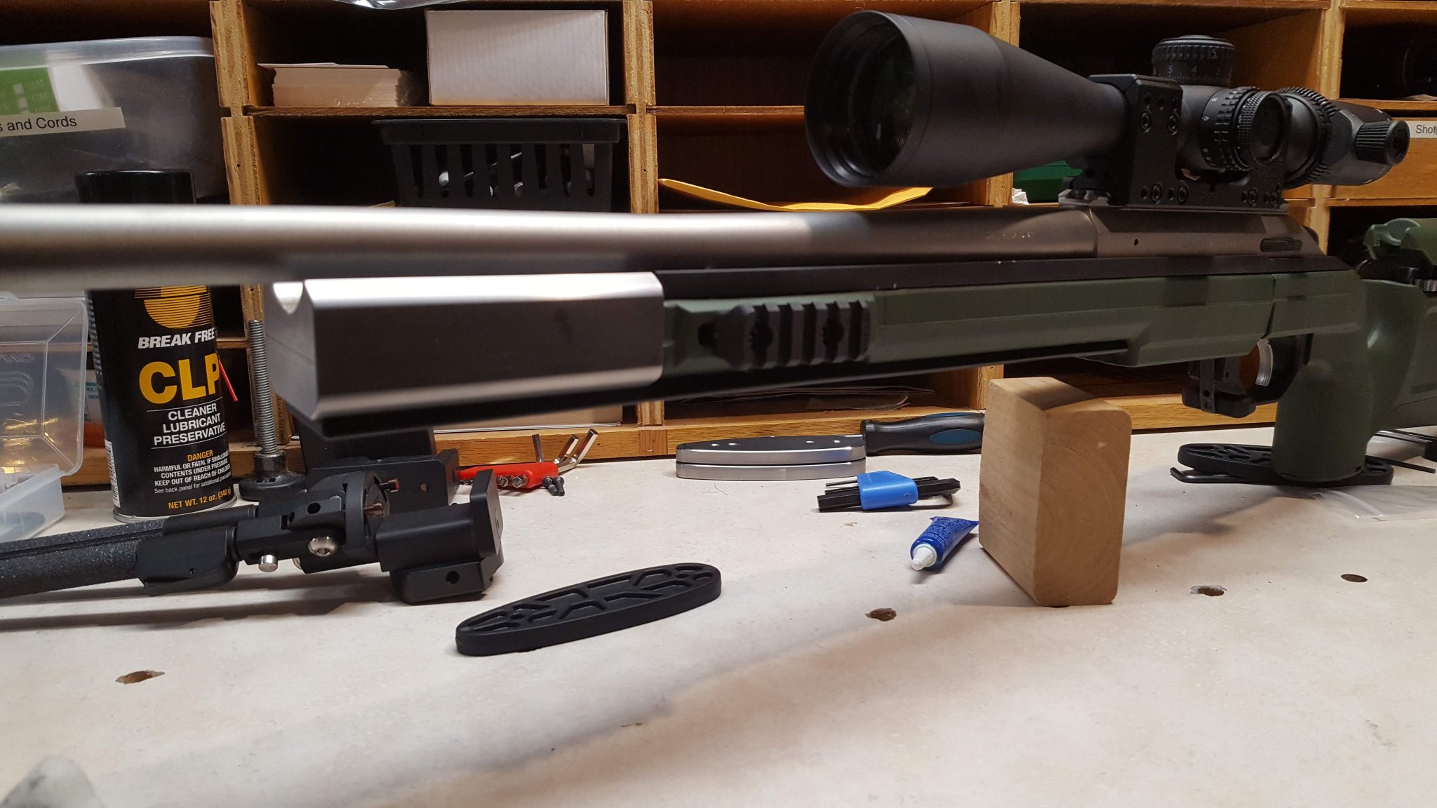

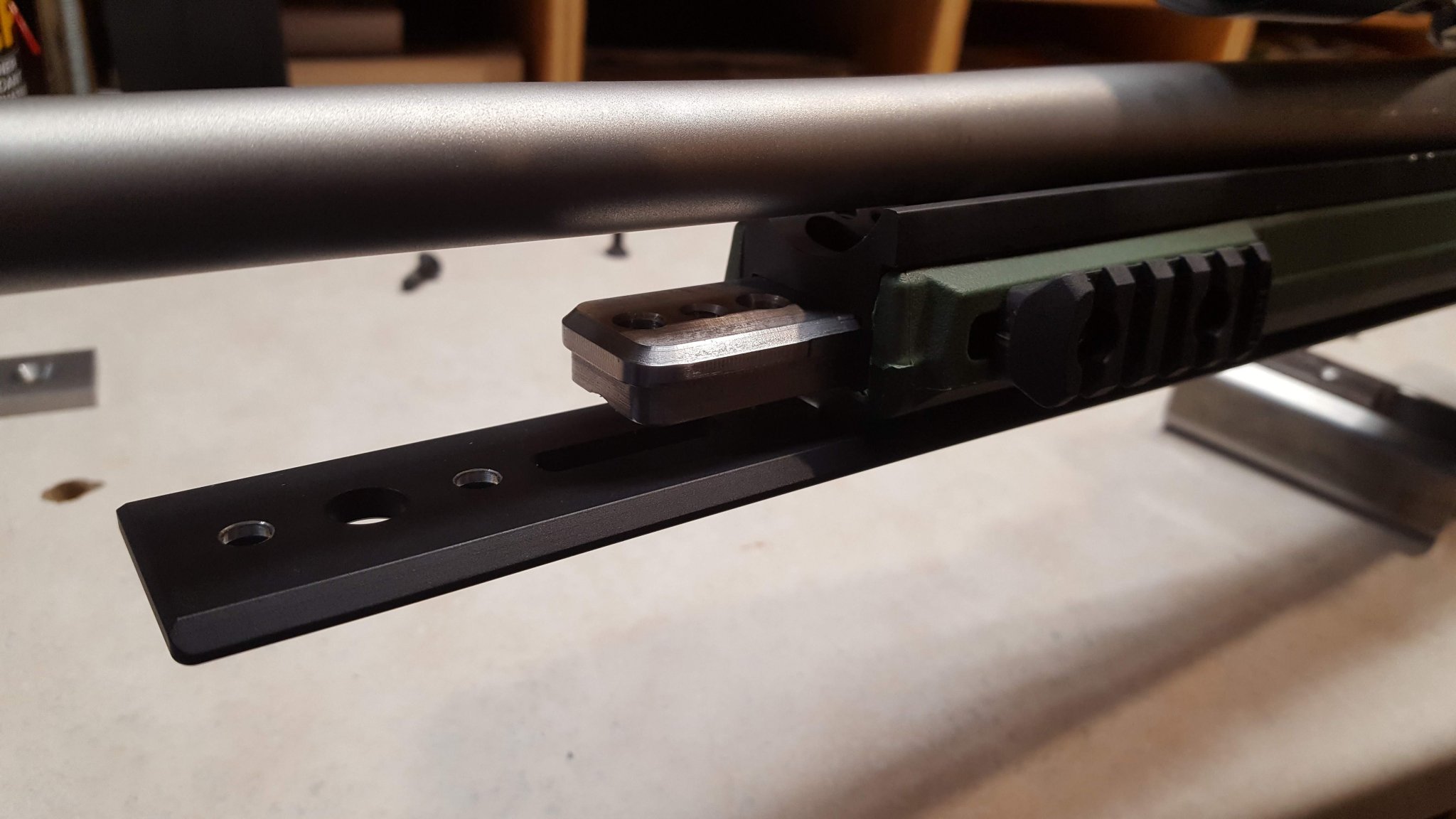

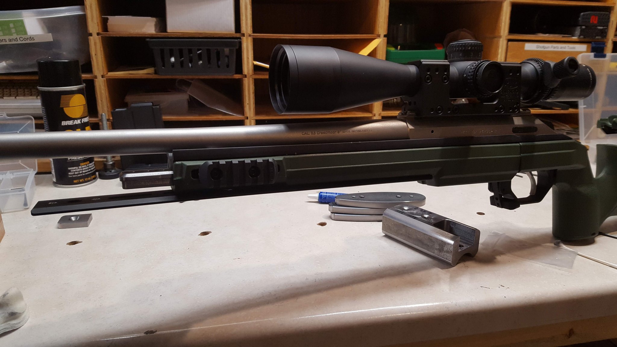

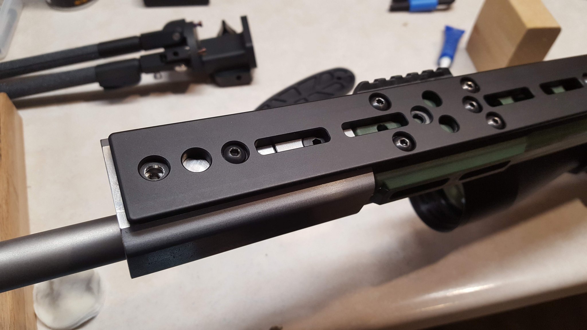

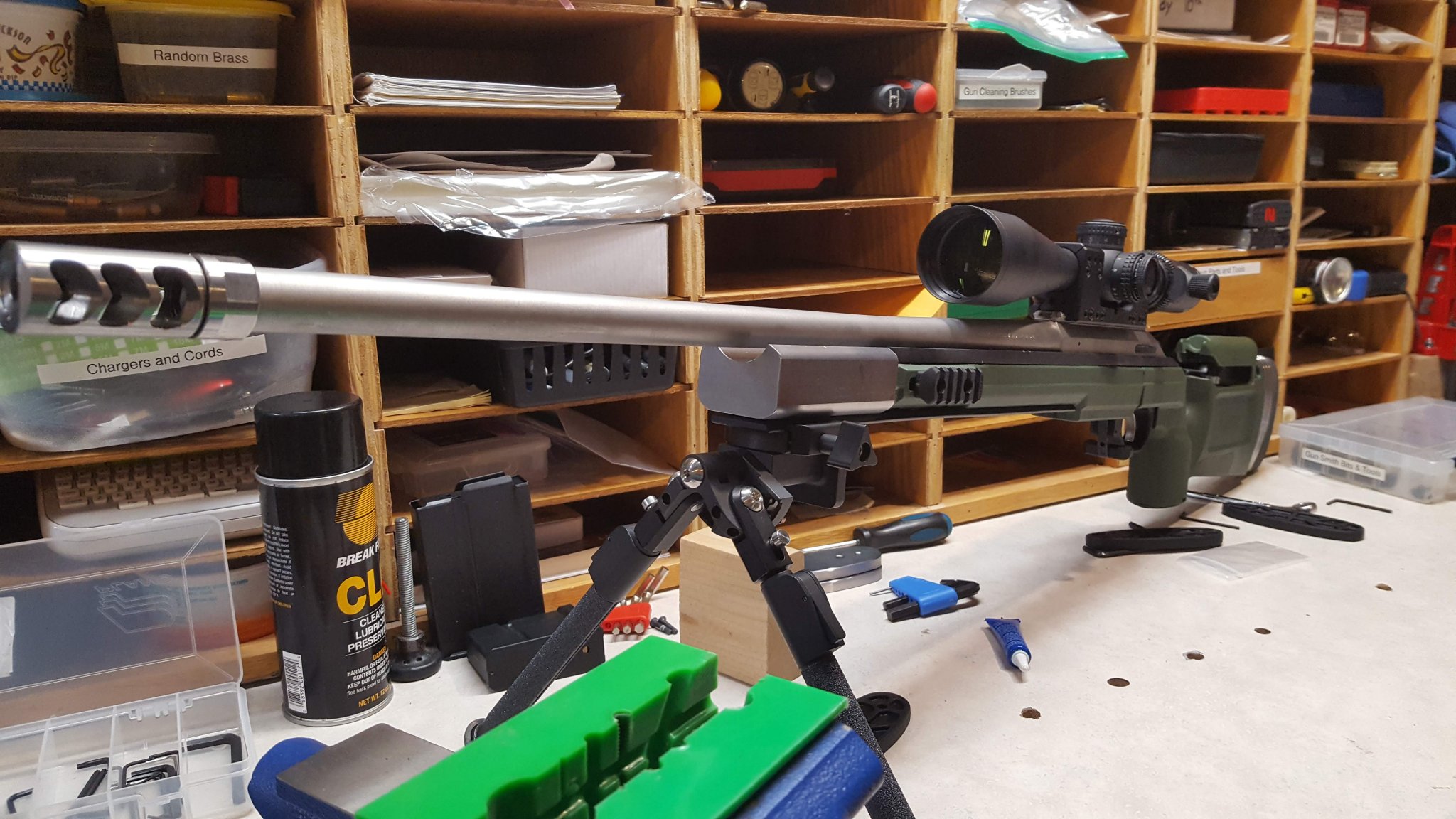

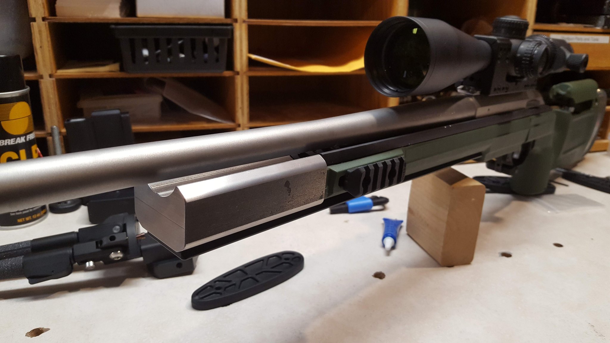

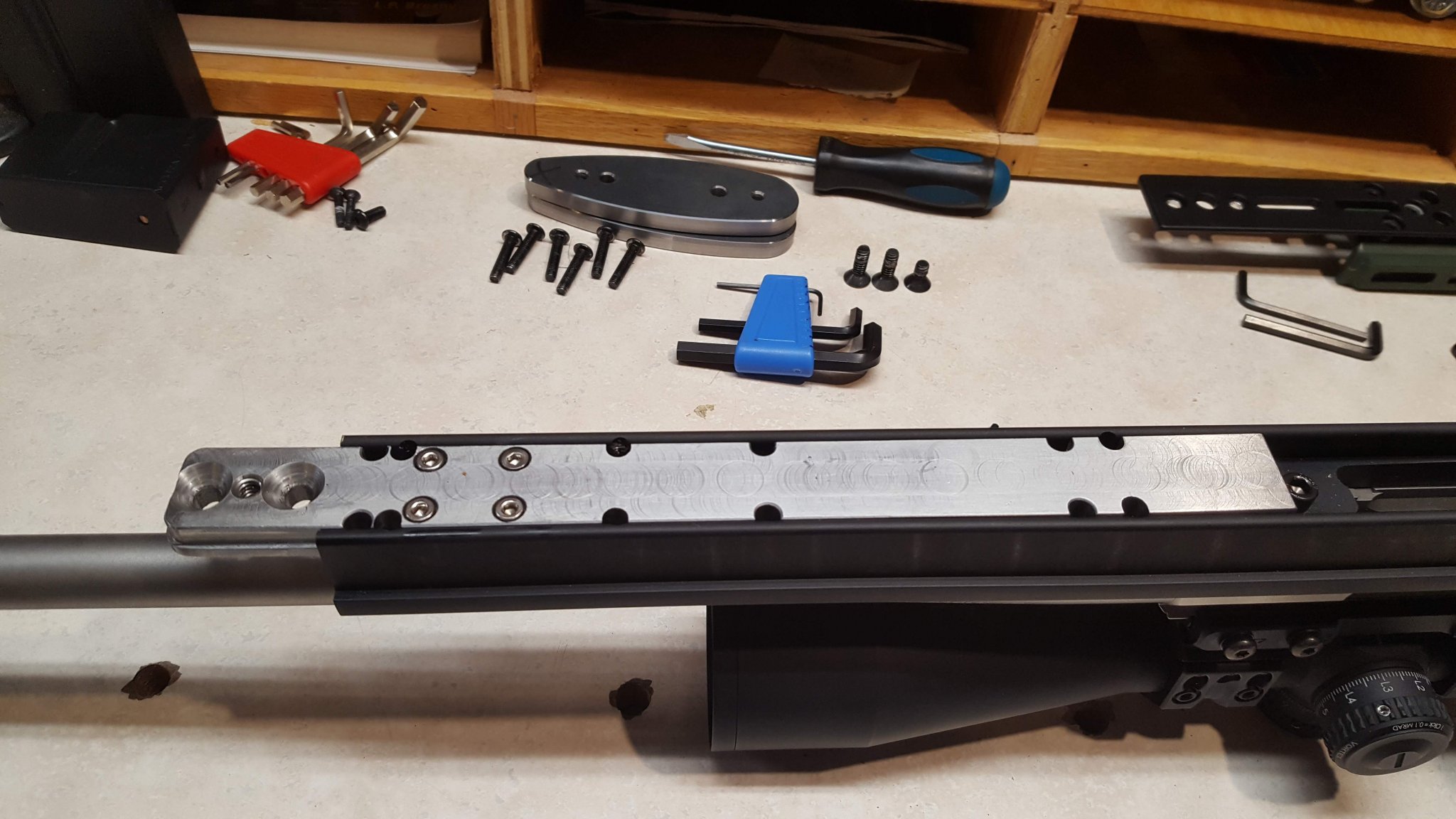

    I built a Tikka CTR in a Bravo Chassis. I added weight to the frame in 2 places, the forend and the butt plate shims. I have a very good machinist friend that help me out this this. If anyone would like the Drawings I would be happy to share.
    I had 3 goals with this weight system.
    1. I wanted to be able to add and remove the weigh to fit the mission. If I go shoot P-dogs with is I will add the weight, If I have to pack the rifle I can make it light. Since the Bravo is designed to be light, why not keep the option?
    2. To be able to Balance the rifle in front of the mag well. Once I shoot this barrel out and re-barrel it, I still want to rebalance it.
    3. To add support to the extended arca rail. I ordered the long rail with the Bravo but found it has to much flex when the bi-pod is mounted on the cantilever section when preloading.
    The system has 3 weights I can add. The first is a weight mount bar. This bar slides into the forend frame under the handgaurd and is attached to the chassis by the 4 mounting screws for the spigot. The second is a front weight that gets attached to the mounting bar. The third are steel shims in the butt plate. My intention is to always leave the mounting bar under the handrail in place and balance the rifle with the but plate shims.
    Weights:
    11.9lbs - Rifle stand alone ( Tikka CTR Factory rifle 6.5 Creed. Vortex AMG, Bravo Chassis with extended arca rail, Patriot Valley arms Jet Blast Muzzle break. no mag or ammo, No Ckye Bi-pod)
    19lbs - rifle, bi-pod and full weight set. (ckye bi-pod - 1.46lbs)
    I was able to add 5.64lbs of weights , plus 1.46lb bi-pod = 7.1lbs total added.
    Balance point
    1 - light setup, no bipod. The rifle balances with the weight bar added and no rear shims.
    2. Light setup with Bipod. The rifle needed two rear shims added. Wt = 16lbs. This is an Ideal weight for me.
    3. Full weight added, no Bipod. The rifle needed 3 rear shim plates.
    4. Full weight with Bipod(far out). With 3 rear shims the rifle balanced about 2 inches in front of the mag well.
    I won't say this is prettiest thing in the world but it sure did work. I will get it Blued (black) this supper.
